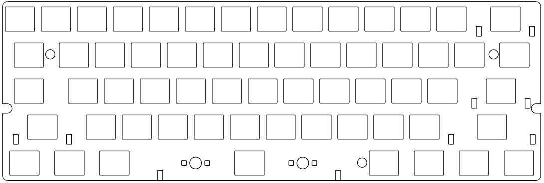

Does anyone have a loose Dell AT101 plate lying around? I am working on a AT101/SGI 60% plate and would appreciate if anyone could measure a few things for me.

Actually I am working on an AT101W plate as well. For that I need measurements for the space bar's bottom two stabs, distances that is, the ones right below the circular stabs.
For the AT101, I'm just trying to get measurements for the various space bar stabs, so a Focus or Northgate or anything with a 7u space bar might work too, assuming the stabs are spaced the same.

Can you be a bit more specific for the exact measurements you need on AT101W. I took this measurement for orientation purposes - http://i.imgur.com/i7uJaZK.jpg, this is the distance between two wire stab inserts on their wider parts. I took a couple more, but I doubt that is what you're after - http://imgur.com/a/JeeVD

The first image is what I am looking for, and perhaps also the measurement of one of the stabs relative to the circular stab above it. It might help if you could remove those two stabs and take a measurement of the holes. It's fine if you can't.
Please correct me if I am wrong, but according to the first image, it appears that the two stabs are approximately 86 mm apart?
EDIT: Whoops, it is actually ~90.4 mm, isn't it? :? I am also working under the assumption that the two stabs are spaced equidistant from the space bar switch mounting hole.

I took some more measurements. I took the circular stab out, but I couldn't manage that with the wire stab. Here's the pic:
  • Red line - 90.6mm
  • Orange line - 91.8mm, this is practically the distance between holes, as plastic here almost doesn't overlap with the hole, and I pushed the stabs to the side when measuring
  • Orange line up to the yellow line - 14.3mm, this is not that precise though
  • Green line - 4.1mm
  • Blue line - 10.5mm
Edit:
Yes, they are equidistant from the switch hole.

I should have the design done in a bit, would really appreciate it if you tested the space bar stab placement (the two circular ones in particular) on a test printout or something.
EDIT: Could you also perform one more measurement, if you do not mind? I am trying to confirm the distance between the two circular stabs, as were provided to me by BlueNalgene. This is what I believe he gave me:

I have the above distance measured as 63.25mm. Could his measurement be from an AT101, sans W?

Okay, it appears your measurement might be the correct one, I will adjust it to match. It might be for the AT101, but he told me it was for the AT101W, weird..

Okay, here's the (hopefully) finished plate:
It is especially important that the two circular space bar stabs are tested to make sure they are spaced correctly.. I am hoping stuff that was generated by Swill's plate builder like the distance between switch mounting holes is also correct..
Thanks again for your help, alh84001! :mrgreen: Now I just need to do the AT101/SGI plate... And perhaps I should just start another topic in the Workshop subforum for this. :roll:

So I printed this pic, and at 100% it just fits on A4 landscape page. Here is the printout right next to the plate
http://imgur.com/a/HITUT
Now, I don't know if it is visible from the pics because of the perspective, but it seems to me that the left circular stab should be moved a tiny bit to the left. The right one should be moved even less or not at all. The wire hooks seem to be a bit too far spaced apart. I took the measurement of the distance between them on the printout - from inner side of the lines closer to the switch mount hole and it measured some 92.4mm as shown in the last pic.

alh84001 wrote: So I printed this pic, and at 100% it just fits on A4 landscape page. Here is the printout right next to the plate
BTW, have you tried contacting BlueNalgene on GH. I bet he could help you with a lot of this.
Some pics in this post https://geekhack.org/index.php?topic=81 ... msg2157691. And I see you've been posting in that thread :)
Thanks for checking. I am not sure what to say or do about the discrepancies. The measurements for the stabs are what you gave me, for the bottom two stabs, they are 91.8. Perhaps it is the print out itself? I am unfortunately relatively inexperienced with CAD so I am at a bit of a loss.
I did speak to BlueNalgene about this, he's helped me a bit already but he seems to be rather busy with real world stuff so I don't want to bother him for now. :oops:

I did the measurement again,this time a bit more carefully, and it comes to 92.1mm between insides of the lines, and 91.3 between outsides of the line, so I guess it fits better.
