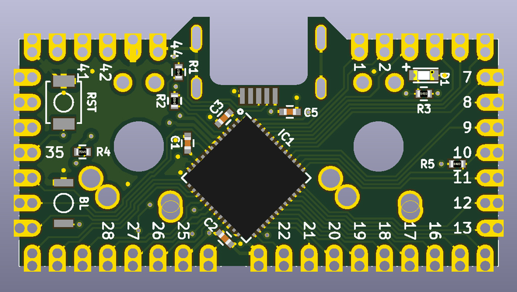

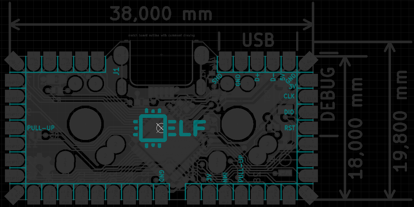

pomk
27 Jan 2017, 12:53
Cleaned this up and changed the font to something more explicit in regard to 1 vs I. Also corrected two typos.
edit:
and new button footprint for bootloader plus a bit more rigid USB 'peninsula'. I decided to keep the old footprint for the reset button, as the larger pads are easier to work with if one wants to do stuff with them.

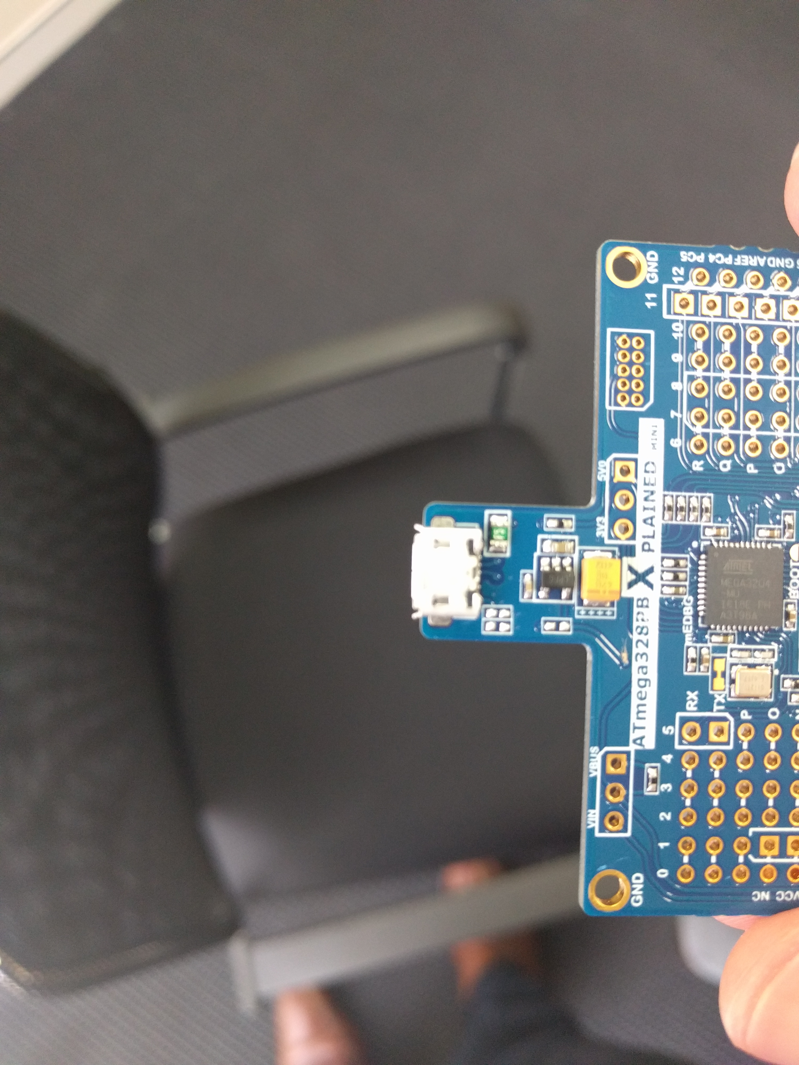

Sythe
27 Jan 2017, 13:34
On the USB connector feet through holes, I think you will want to increase the pad size on the top side of the board to pick up enough solder during SMT.
I have an Atmel board at work I was going to show as an example, but forgot to take a photo of it. Will try and remember Monday.

pomk
27 Jan 2017, 14:44
Sythe wrote: On the USB connector feet through holes, I think you will want to increase the pad size on the top side of the board to pick up enough solder during SMT.
I can enlarge the front holes, the inner ones are a bit cramped for space :?
(edit: they are exactly according to molex spec though)
Sythe
27 Jan 2017, 15:16
Yeh saw that. That might work well enough. I'll try get the photo of the board on Monday to show you what they did.
I work with SMT assembly in my job and showed your board layout to the design engineer at work who does our PCB design and he also didn't think there would be enough surface area for solder paste application during SMT. For hand solder, this obviously isn't an issue.
pomk
27 Jan 2017, 18:17
Well it's good to have professional opinions on these things from time to time :)
I'll try to adjust the design accordingly where possible.

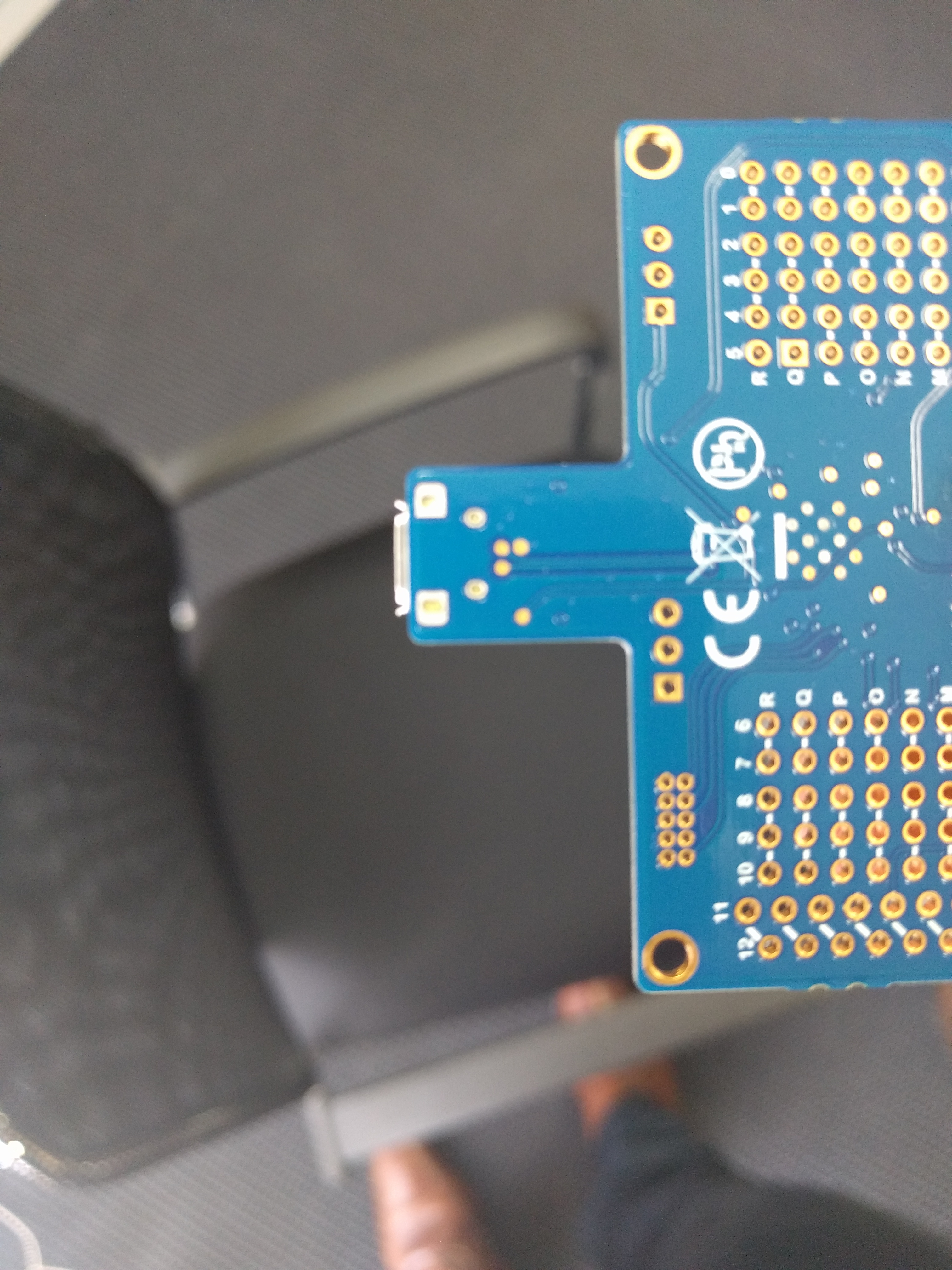

Sythe
01 Feb 2017, 06:43
Image quality is absolute arse as my phone's camera wouldn't focus.
But you can see how they did it, they increased the pad size on the outside of each hole(same footprint top and bottom) but SMD is only top side, so all solder it picked up from top side pads.
Even on these boards, we have seen a couple that didn't have a heap of solder on them and the bottom side looked quite bare with very little solder touching the through hole feet on the connector.

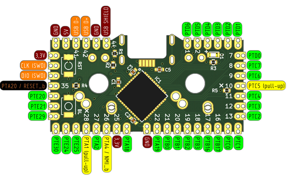

pomk
03 Feb 2017, 13:23
So last communal check before I generate the gerbers again for matt3o.
I modified the USB pads as suggested:
I added the pin descriptions on the top side for all pins that have some special considerations.
Lastly I rotated the corner pads by 45 degrees and adjusted the outline to match. With this change the board should no longer be as pointy in your fingers as it was before. ;)
tentator
03 Feb 2017, 14:49
Wow!!
Sythe
03 Feb 2017, 15:17
Looks great.
I would suggest you look at doing the panelising yourself, so its done right.
Especially since you have pads all the way around the edge you want to be safe.
For panelising, look at doing it with breakaway tabs.
I think something like larger tabs around usb and clear section opposite side and small tabs near corners should work.
pomk
03 Feb 2017, 15:40
I have no experience in panelization, so I think it would be ill advised for me to begin practicing with this project. The first prototypes had no cosmetic problems from the panelization applied by the company who built them.
