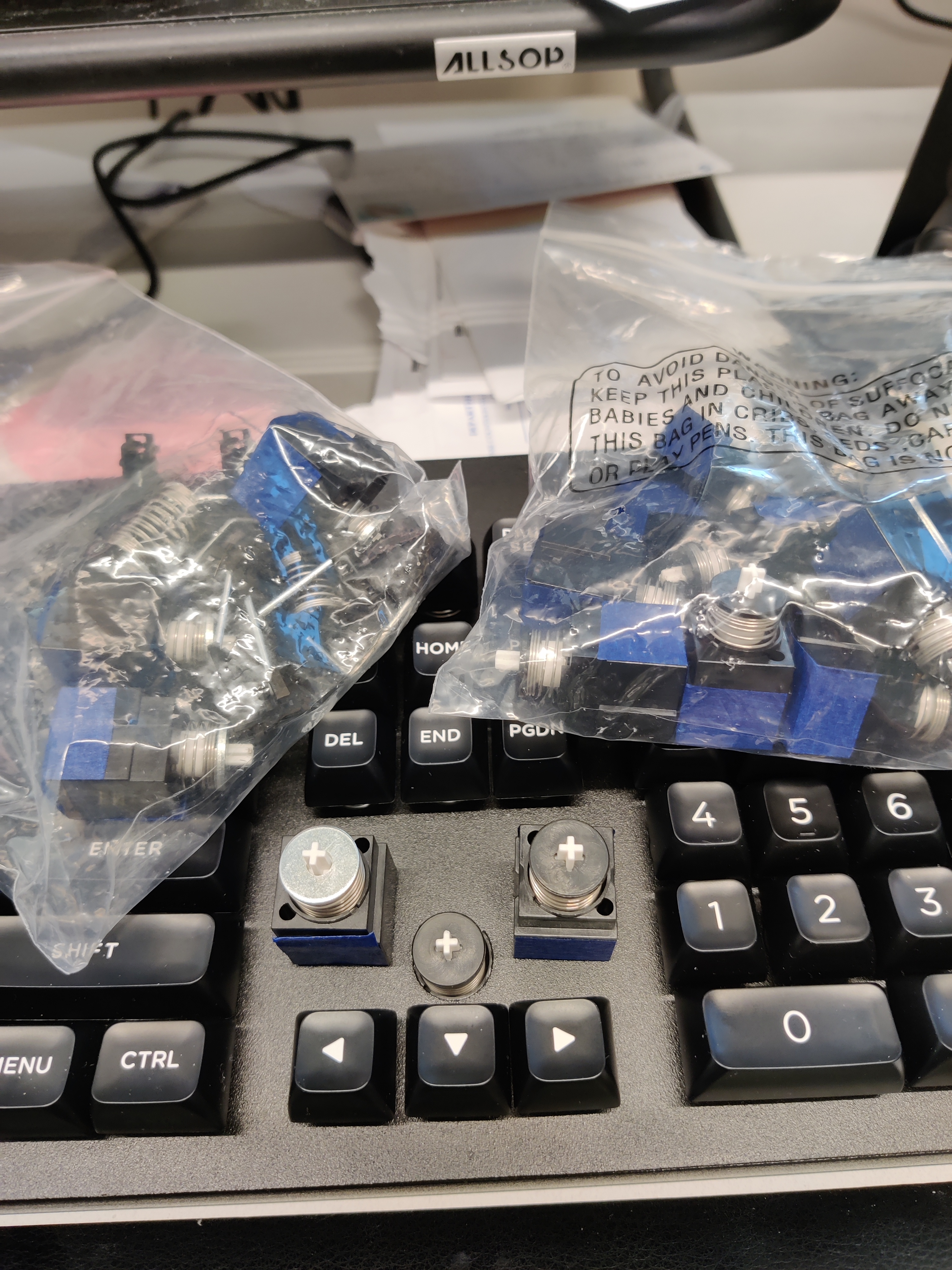

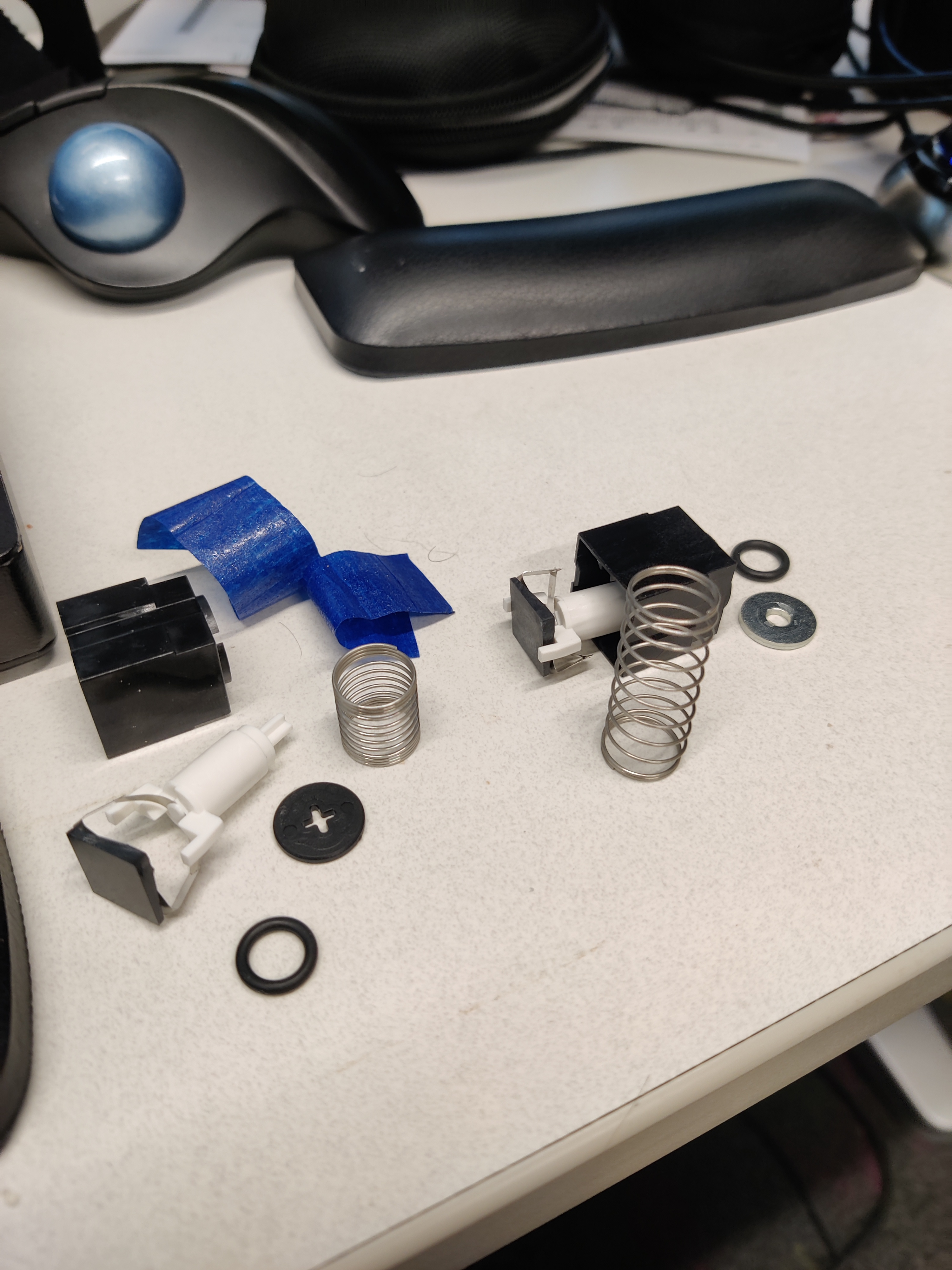

Good afternoon, I have received my B104 Round 1 keyboard, keycaps et. al. Working great so far, just a few keys suffering from sticking and needing the wiggle method.
However, I think I may have to tune most of the keys as they do not have the snap sound I associate with the beamspring from your videos (and Wendell's). The keys all work, but have a more "clack" sound instead of a crisp snap/click. Several were very mushy and had bent beams as you covered in your video manual. Some more experimentation on a "test" module suggests that a spring gap very near the 0.5" spring gap is needed for the crispy snap, and that over or under compressing the beam leads to the clack sounds.
Ellipse, the installed keys all had plastic washers on top with an 'X' hole to fit over the key stem, while the spare keys shipped as 'standard' in the accessories bag had metal washers on top as in the youtube videos. However, the extra bag of spares you recommended we purchase for peace of mind and the future had plastic washers w. 'X' again. What should the keyboard have shipped with? I just read the press fit washers above, so I am fortunate to have a partial upgrade as my keyboard is a round one. Would it be possible to get four press fit plastic washers so I can get maximum use out of the 4 spare shipped with the keyboard?
As feedback on the press fit washers are far easier to work with than the glued springs, just invert the key module over a flat and hard surface, gently push down and the plastic washer comes off allowing for very easy disassembly and reassembly.
[Also one of the modules with a metal washer had a far stronger spring than any of the others - maybe for a space bar? But you included extra springs anyway so that is not a problem.]
Ellipse
19 Feb 2024, 23:47
Glad your keyboard arrived mattaw! Everyone can easily use the press fit washers on both the first aid kit modules as well as the original modules, which is why there were no extra press fit tops included (but if you add an order note with your next order, I can send a few extra press fit washers with your next order but it is not really needed to use the extra modules and swap the washers).
As mentioned in the manual some folks do go all in and take apart each module to fine tune the sound as shown in the ~20 minute beam spring setup video.

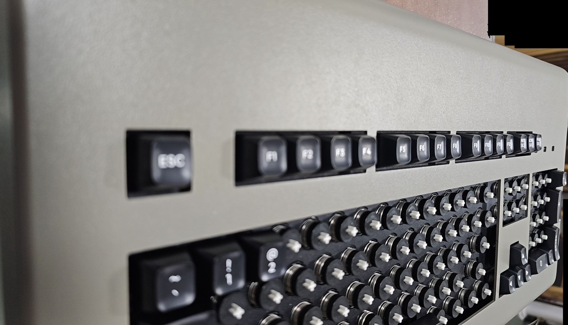

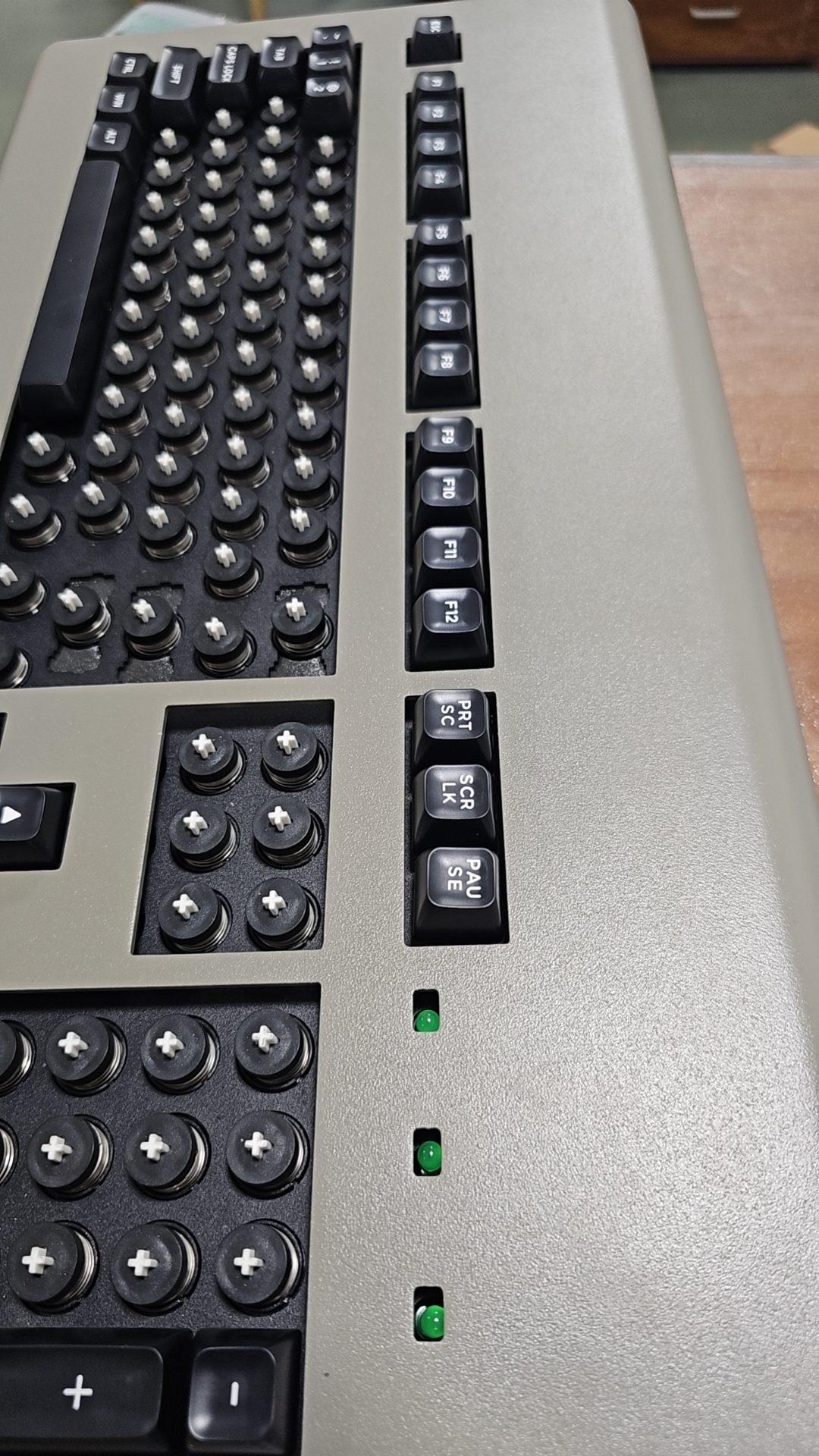

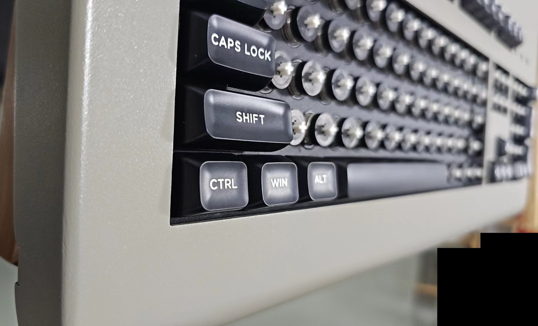

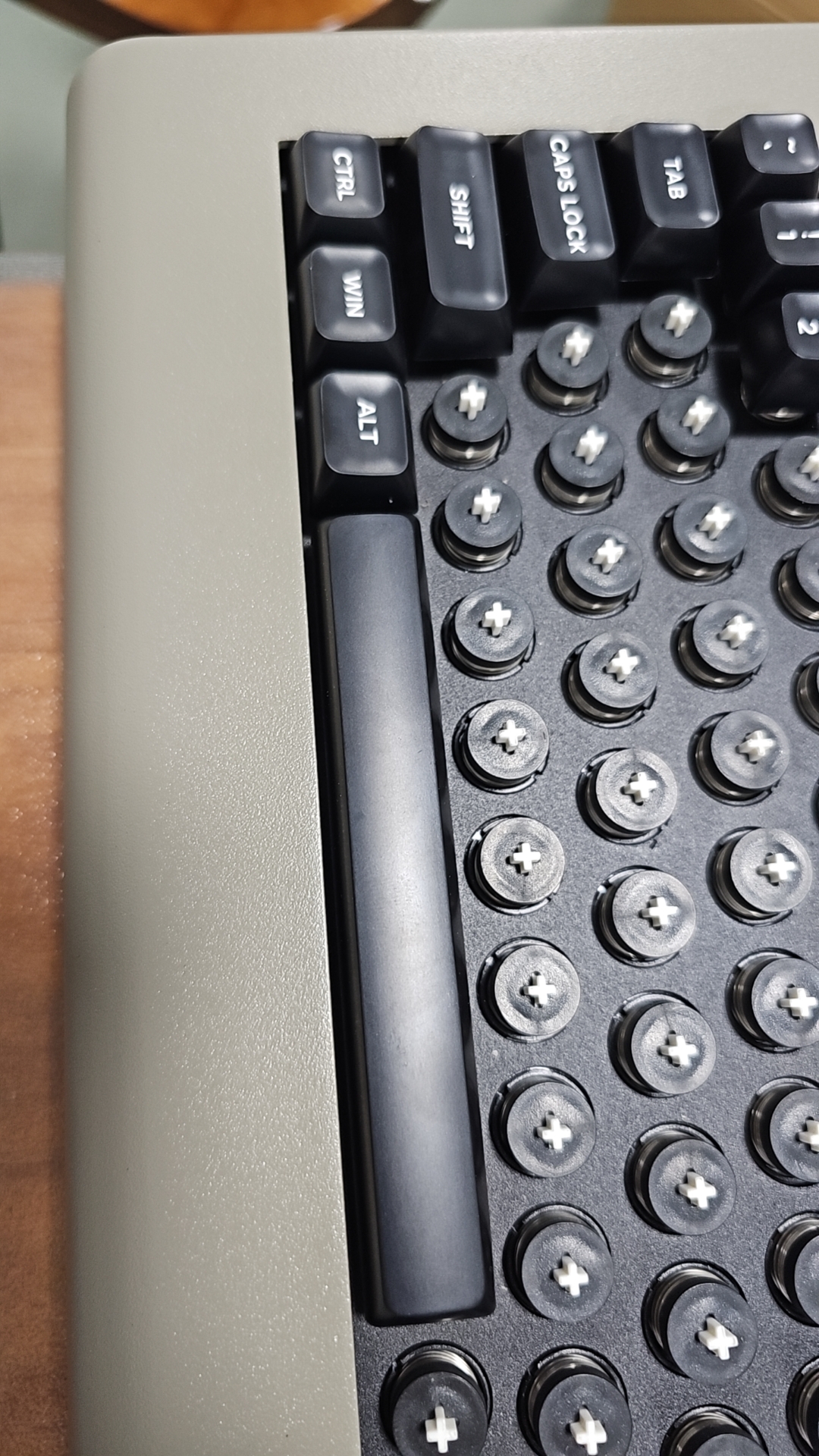

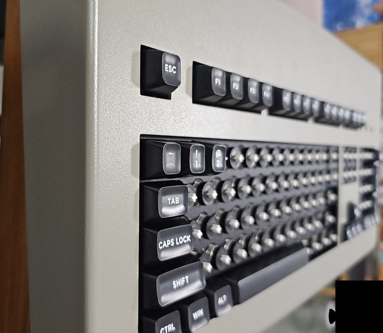

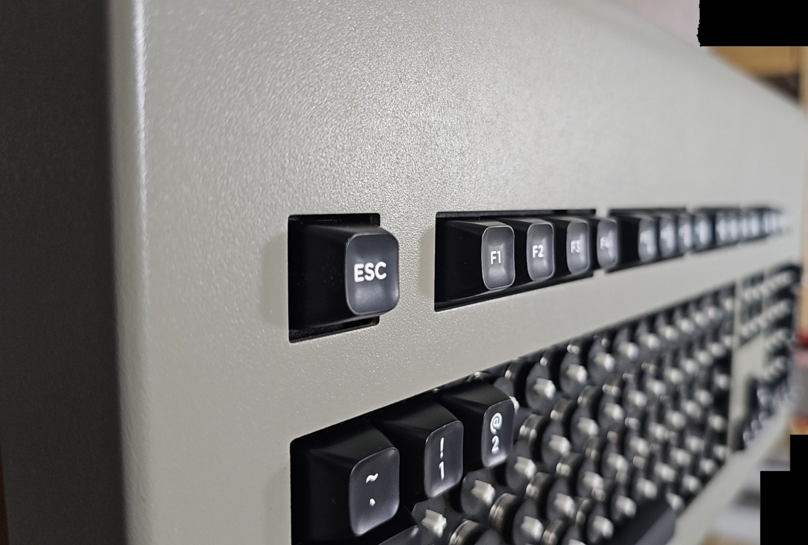

Here are some photos of the updated sample case with the (hopefully correct) Industrial Gray powdercoating. They will be sending this board to me for approval later this month and then making samples of the other remaining boards. Mass production on the modules was approved last week. This board has a nice alignment of the keys and the top case from what I can see.

Looks very nice to my eyes, and wow that's an impressive forehead on that guy. Would have loved to see it with the white alphas too but I can imagine how it will look and I'm thrilled for these to ship. I'm assuming these are the same keycaps that will be shipped with the completed R2 boards? Love how the profile looks. Love everything about this. So happy I waited for the second round even though the main reason for doing so was getting an ISO layout even though I've switched to ANSI since then.
