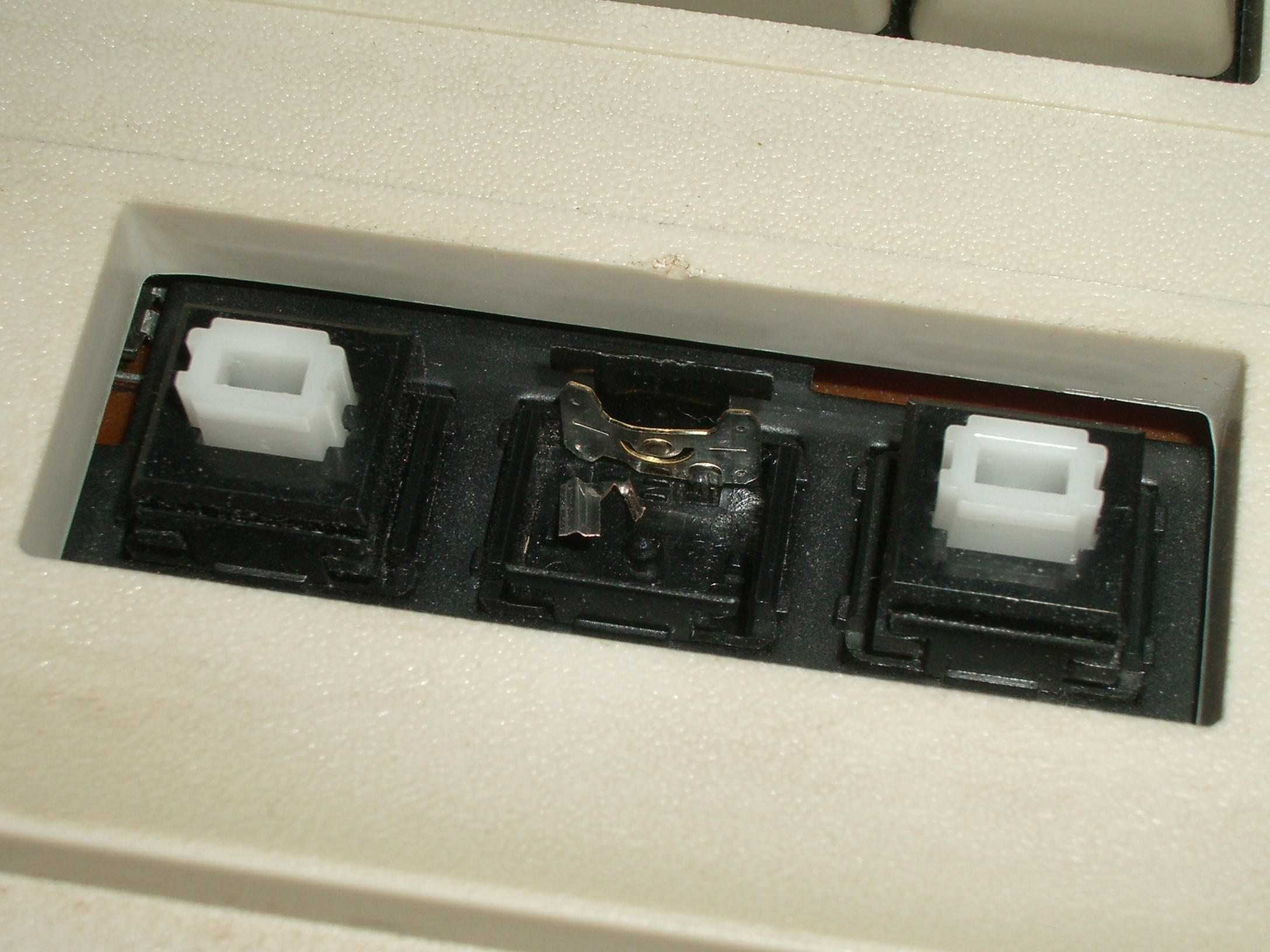

I can't tell if the writing on the white ones is north, or whether it's just soldered the other way around (or the top shell is just on backwards). This is the problem with using numbering for identification — it's so hard to capture and make out in photos.webwit wrote:At first sight, the only difference appears to be the code on top of the casing and mounting direction on the pcb: the whites have the code on the north side, the yellows south. They appear to be of same activation force and clickyness.

I haven't checked yet if it's really soldered the other way round, will open it up this evening or tomorrow for a closer look.

You should post some photos of that board showing the switches, both white and yellow.
I'll add a note to the page tonight that the F key switches are yellow, not white. I'd probably seen that before, but I'd forgotten when I rewrote the page :(

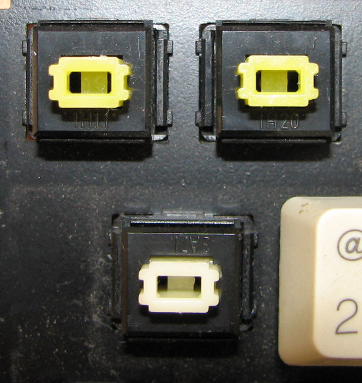

I took a closer look, casing is the same except the code on top, but of the six switches I exposed (4 white, 2 yellow), they all had different codes on top of the casing. Yellow switches are indeed mounted the other way round. I measured the function row (yellow switches) and numbers row (white switches) using my wit-o-meter, and the yellows activate at 66-68g while the whites activate at 70-72g. Little difference, but it's consistent.

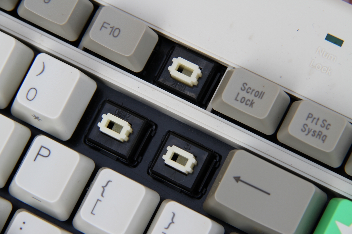

It's alive!
Case codes are 4 characters, most center aligned.
- Daniel Beardsmore
- Main mouse: MS IMO 1.1

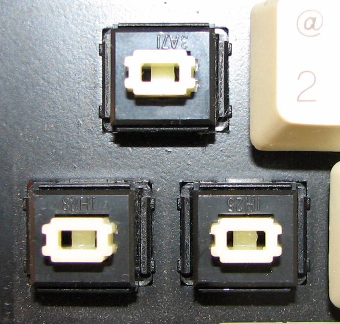

Fascinating! See your 3A71 that's off-set to one side? That's in Alps.tw's gallery as type T4. T4 is basically a later Type IV simplified with a copper leaf. Also, Type IV (Alps.tw code OA1) shows a switch with code 1B25, and you have, there, 1A25. I'm now convinced that Type IV moved from steel leaf to copper leaf.
Any chance of a photo of the internals?
I'd like to verify whether yours are Type IV or Hua-Jie. If they have Hua-Jie internals, then the Type IV will be an older Hua-Jie, and Hua-Jie would have kept the same shell moulds. If they're Type IV internals, I shall go back to Monterey and ask if they bought from someone other than Hua-Jie.
We're getting close to cracking Type IV, my Number 1 Mystery Switch.

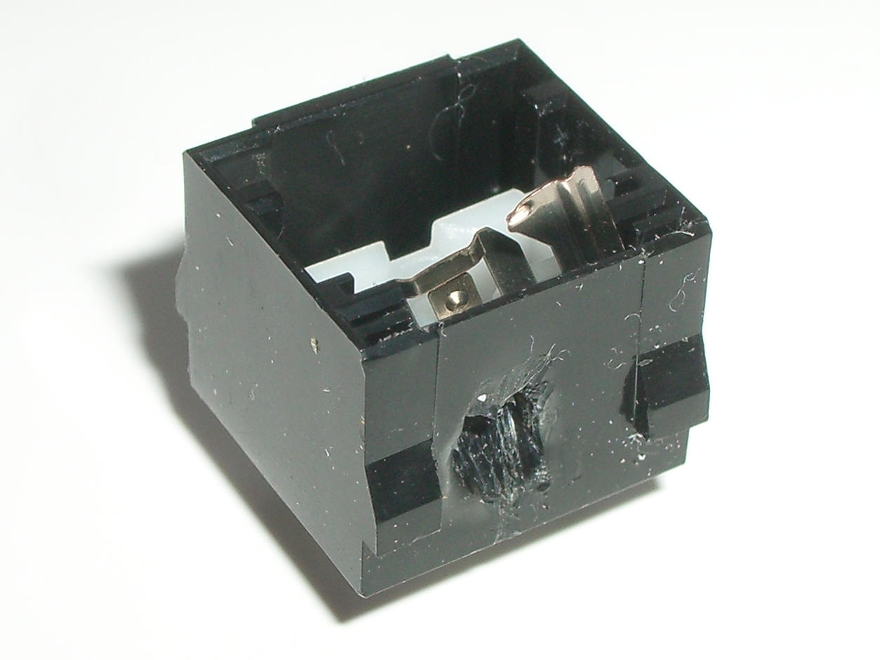

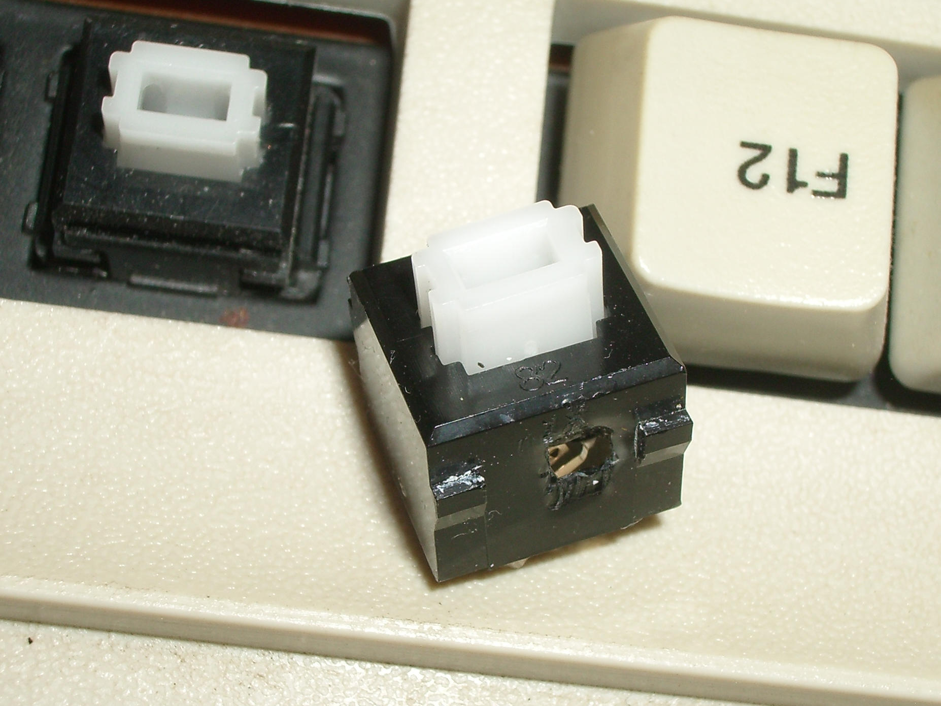

I'm also curious about my Nan Tan board — the switch internals are almost Type IV (the click leaf has angled corners, which is strange), but the numbering is plain numeric.
I also managed to destroy the contact mechanism and tear a hole right through the shell trying to get it apart!
I also severed the end off my old plastic letter opener in the process, which is a nuisance, as it was an ideal tool for opening switches, especially Cherry MX, KPT and Omron.
I suspect I have another clone from someone else, and one that's incredibly hard to get back together (the support grooves in the shell are too tight).
(I did manage to open and reassemble one before, twice IIRC, but this switch wouldn't play fair. I suspect they're all clones of APC, and APC switches are a doddle to work on.)

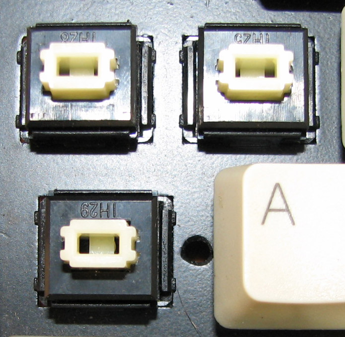

Alps.tw type OA4 has an "83" shell, exactly the same numbering scheme as my 82 above.
T9 (a weirdo switch) has the same numbering as T1, and a Xiang Min rear contact plate.
T8 is a yellow switch with the same numbering as T4 and OA4.
There's a huge amount of crossover between a number of these designs. It almost seems as though Himake (Hua-Jie's switch factory) was burning through design ideas.

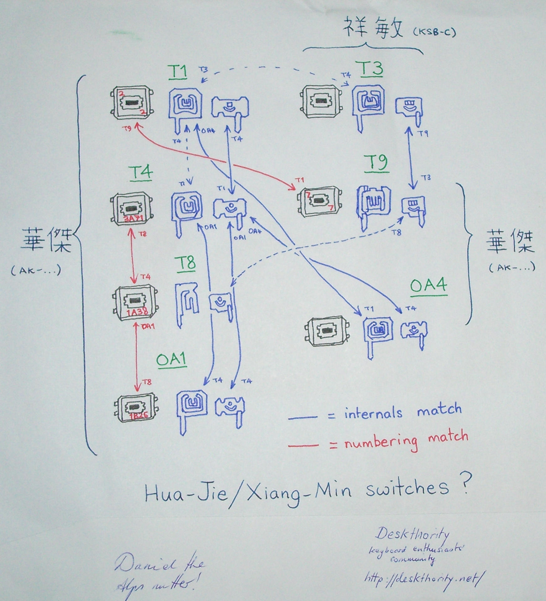

Here's my badly-drawn diagram. Going to send this to Channing along with Alps.tw's photos:
Nothing is conclusive, but every one of those switches has a very visible tie to at least one other.

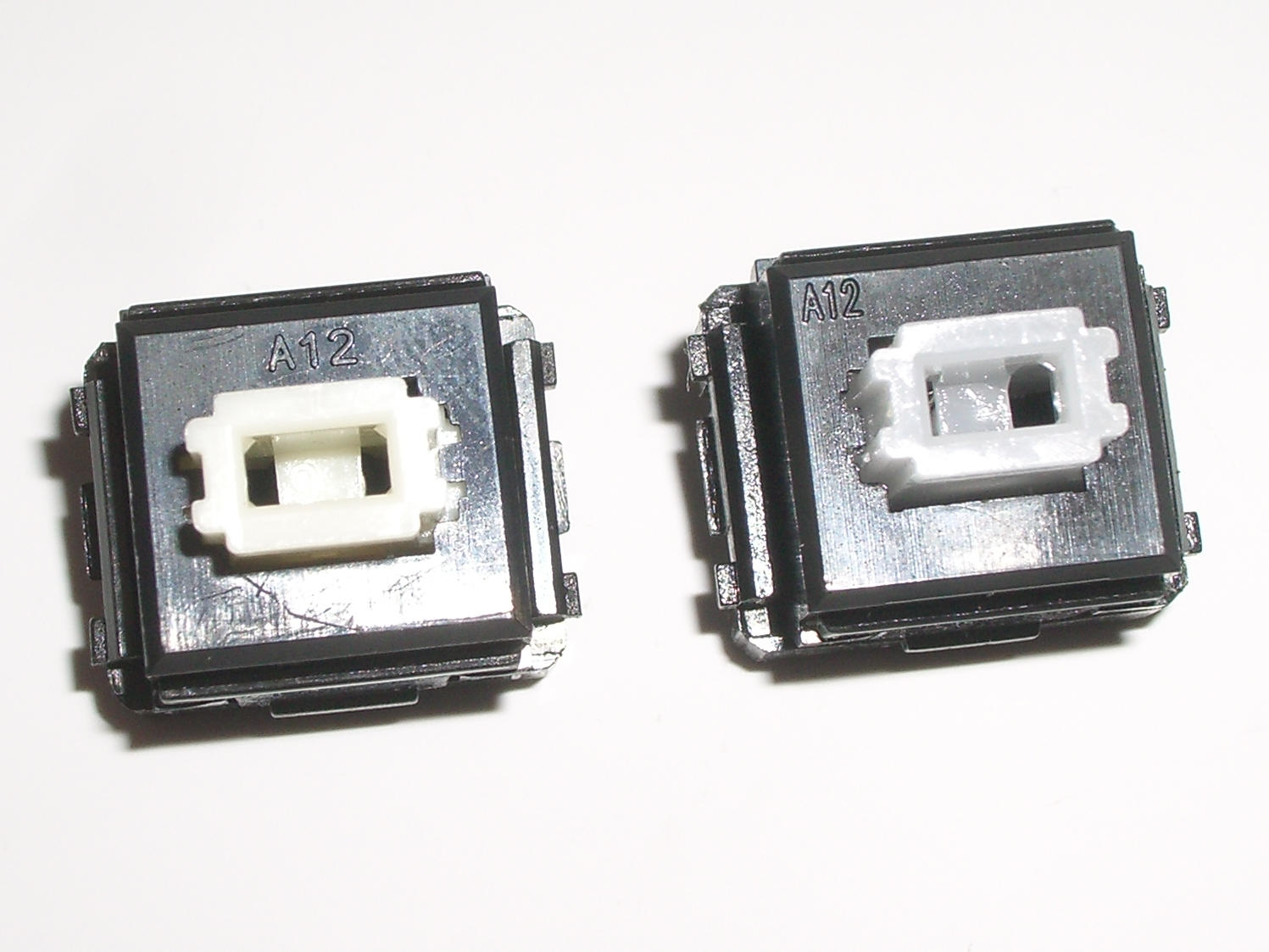

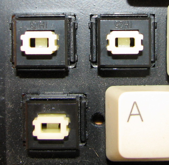

Shit Daniel I think I lead you astray this morning on IRC. I believe that I said the Monterey I was typing on had the same number format as webwit's. What I meant to say is the *minitouch* I was typing on had that number format...sorry
In any case, here is a picture with a few keycaps popped off. This morning I randomly chose the Num Lock and the hyphen keys which happened to have the 4 digit numbering. Seems the neighbouring keys aren't quite the same...

Pretty sure I knew you meant MiniTouch (which is of course a Monterey board), as you confirmed to me that yours, unlike webwit's, doesn't have the yellow top row switches.
Your photo is really interesting — you have the #A## numbering, and the ## numbering side by side. Again, this means that either Hua-Jie did both types, or that Monterey used two vendors (which, if we have reason to suspect this, I'll just ask them).
Do the two types have the same internals?

Now I might have to send webwit his keyboard back :-) Or I'll keep it, minus one spring :)
I forgot to put the numbering on OA4 on my diagram above (not the only mistakes!) but OA4 is shown with your numbering (and a different style), your contact mechanism, and a steel leaf. Yours is the copper leaf version. Several designs appeared to go from steel to copper leaf, including APC, Type IV, and the MiniTouch one.
Some months back, I speculated that all these four-tab clones were "XM" switches, whoever XM were. Strictly speaking, this is false, but I think my hunch may have been right from the start: Hua-Jie looks to have been the big cheese in clicky switches in the 90s, since all the common clones appear to be theirs. (I have no expectation of cracking all the rare ones, like ATW and D-TRNS, though; with that said, ATW internals are a lot like KPT … including that unique click leaf design)
Hua-Jie samples look like they're on, too.
Great photo, most grateful!

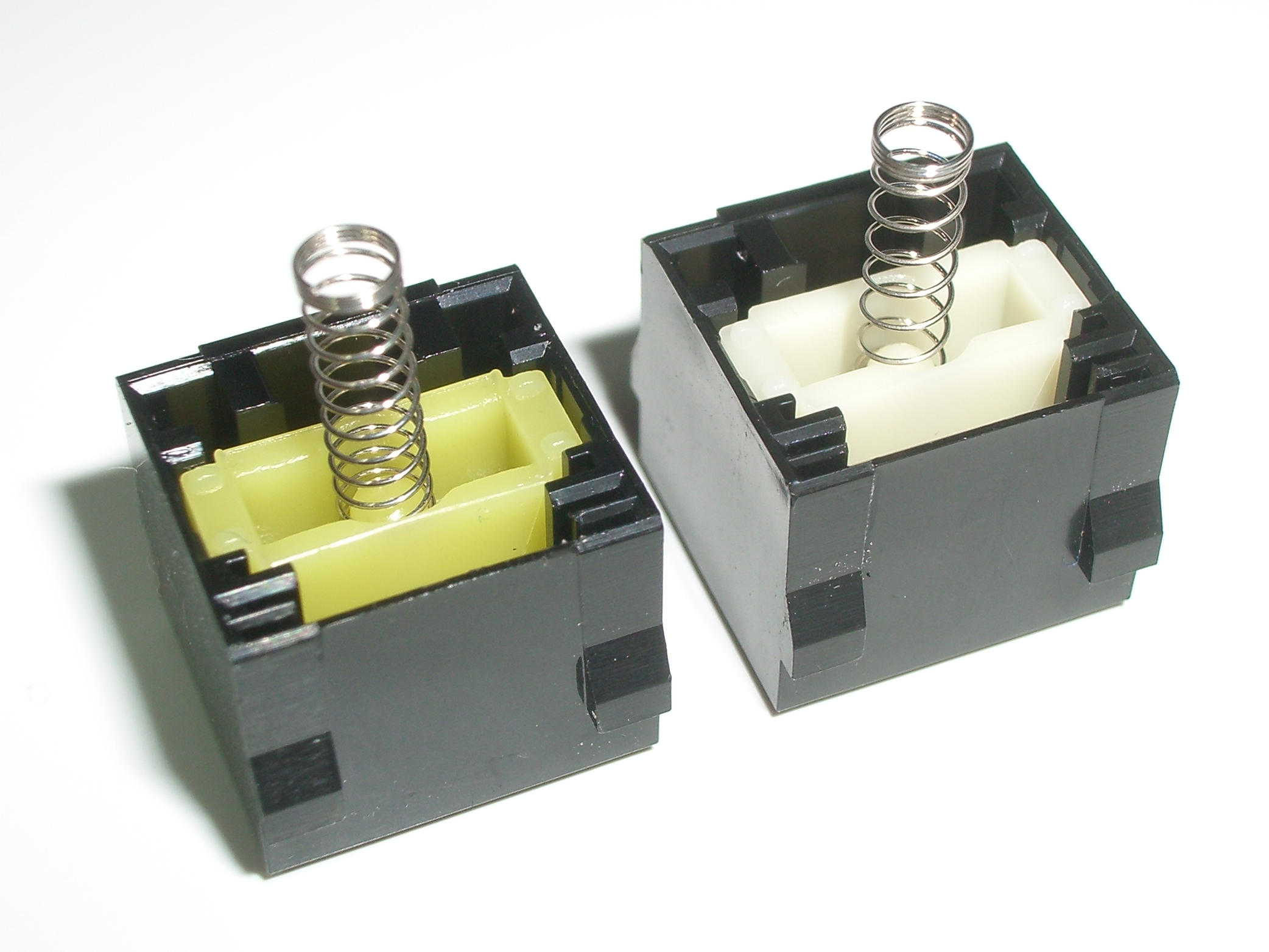

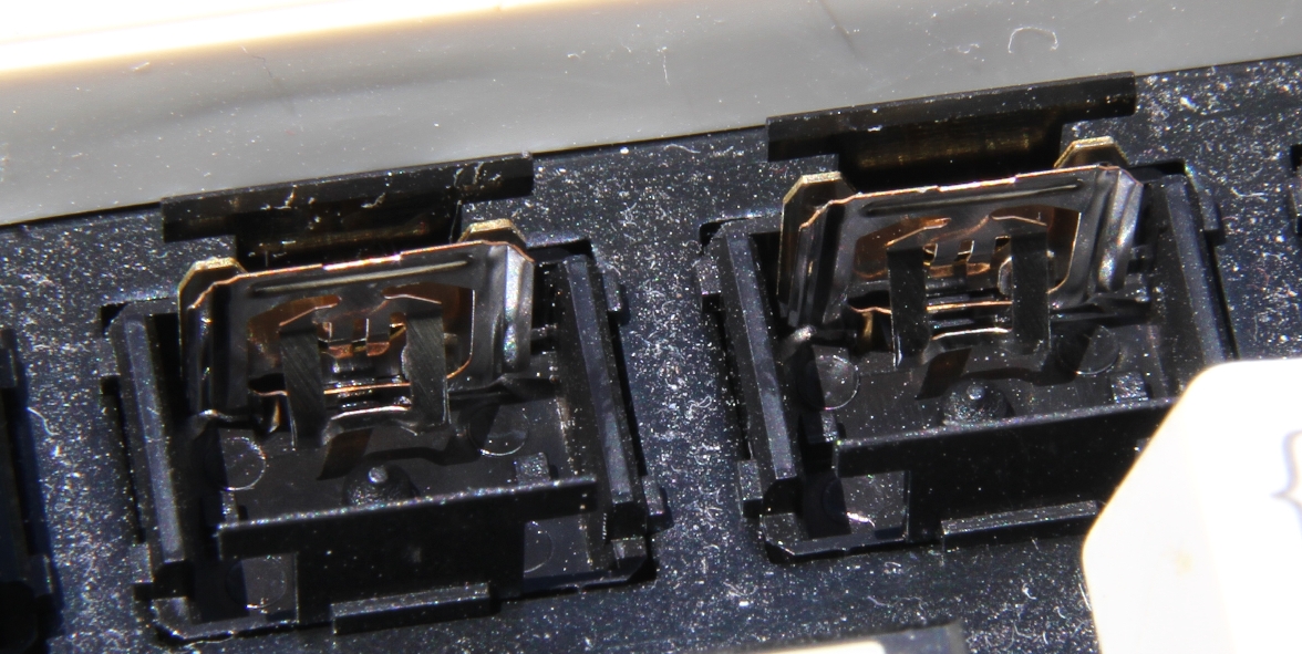

MiniTouch from webwit arrived. Surprised how easy the Hua-Jie switches are to get apart, once you know how :) Remove three keycaps in a row, lever away the T retainers front and back, and then grip the switch and pull — you need the keycaps cleared to get a good grip. Reassembly is harder, though, with these; we shall see.
Findings:
All clone shells are virtually the same from the top, regardless of the manufacturer. The only difference is the mould numbering.
On the inside, comparing all the structures that support the slider and leaves, the upper shells are as follows:
• APC — no match
• Normal Xiang Min — no match
• MiniTouch Hua-Jie "Type II" and my Nan Tan board Type IVs — identical aside from a minor change to support the narrow click leaf (the latter has the purely numeric codes in the moulds as seen side by side with alphanumeric codes in 002's MiniTouch)
• Xiang Min KSB-LE and MiniTouch Hua-Jie — virtually identical (one small leaf support block is taller)
By identical, I mean every last angle, dip, chamfer, everything. 100% spot on.
Sandy believes that the plastics and the internals come from different companies and different factories; the plastics manufacturers (Hua-Jie, Xiang Min) would be subcontracting out to internals manufacturers. Doesn't explain why Xiang Min labelled their samples with Hua-Jie part numbers though.
In any case, I feel pretty confident that Type IV = Hua-Jie.
Maybe the subcontracted internals explains why they vary so much.
As for white vs yellow — the springs are different. The yellow switches have far more turns in the springs. I can't gauge the difference by feel.

Yellow vs ivory:
Ivory switches in the MiniTouch are around 4 mm travel.
Yellow switches are around 3 mm travel.
There are small protrusions in the base that stop the slider; in the yellow switch, these are 1 mm taller, to shorten the throw. One of the springs is also longer. I just noticed this reduced travel when I tried to reassemble two of the switches (which is really hard!) I thought the switch wasn't assembled right, but I compared it with the others and found that none of the yellow ones would fully depress, by design.
As to why — don't know. Maybe it will become clear when I finally reassemble it.

OK, samples from Hua-Jie arrived.
Internals are the same as Xiang Min, sliders are both ivory (not green for the linear as per Xiang Min), and the numbering is very similar to Xiang Min's KSB-LE, i.e. the one that we think has Hua-Jie internals.
I've had one more go at trying to get this confirmed with Hua-Jie, but the evidence is strengthened that they're related.

OK, here we go. I noticed that my samples were labelled with "(2)" in the part number. Paydirt :–
AK-CN2/AK-DN2 — Hua-Jie as found in the MiniTouch
AK-CN2(2)/AK-DN2(2) — Xiang Min-style version
