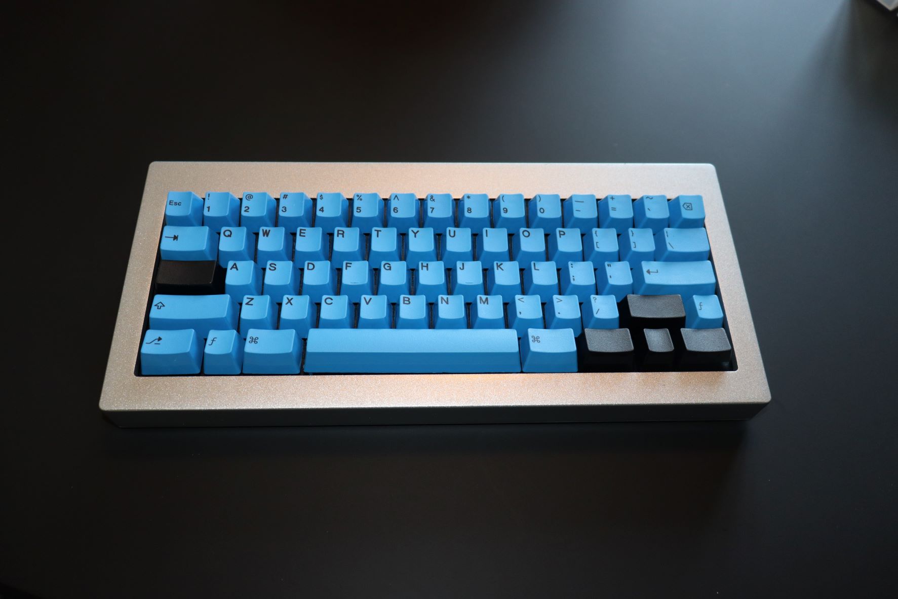

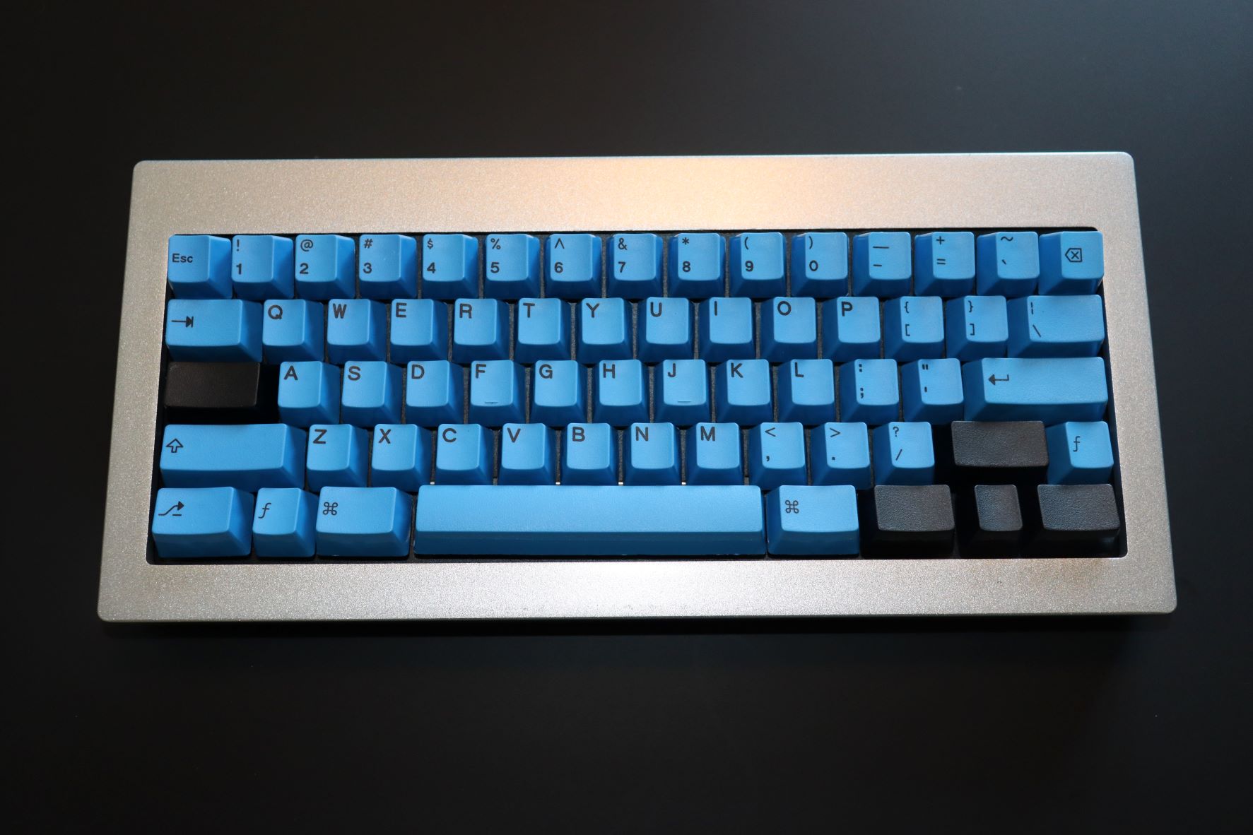

Someone asked for pictures of a Mopar Blue set on a keyboard lately. I have received my F62 compact design today, so I thought I add a set to it and paste it here.
