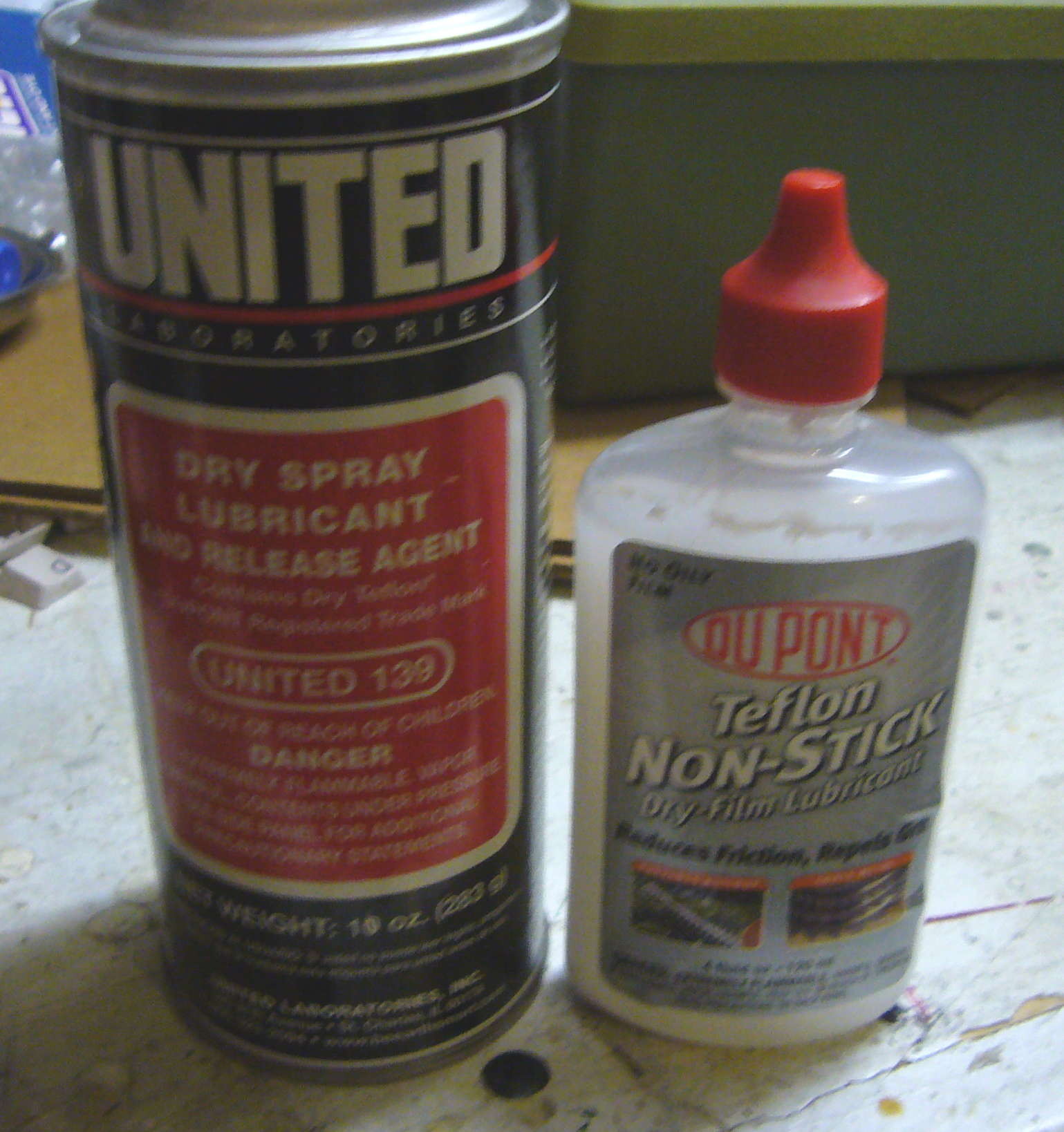

I am getting close to embarking on a new Dell AT101W-based project.
I already have my 4 "primo" Alps keyboards, full-sized and TKL, 2 of each (Northgate 101, Dell AT101W, Filco Zero, and Ducky 1087XM) with my 2 fave switches, blue and orange (stock switches but all decked out and whatnot), and now I want to look for the "ultimate family-friendly" full-size keyboard that is at least minimally tactile but quiet - including, if necessary, modding switches, which I have never really done with Alps.
The chassis will be a Dell AT101W again (in a black case with a weight bar and padding modded in) and I have a set of Dolch-repro doubleshots for caps (and plenty of beige and black spares to fill in gaps if need be, including Apple PBT that is dyeable for WASD, arrows, etc).
So, I have hundreds of black Alps, at least a hundred orange, at most 100 white (1st gen SKCM), ~100 old creams from a Wang 725, a small handful of blue, around 60 Matias Quiet clicks, and a couple each of odd things like locking switches from CapsLock. I also have a least 1 AEK2 that I could cannibalize but I would just as soon keep it intact. I don't mind mixing switches if they are close and there are a couple of dozen around the perimeter that I use a lot less than the others. Certain ones, such as CapsLock and Numlock, can be full clicky if need be.
What I am seeking are distinctly tactile switches but as light and quiet as possible. Sound means nothing to me but feel means everything.
This is a conundrum and a frustration because the best-feeling switches are so often the loudest.
In this instance, I am willing to sacrifice as much sound as necessary but would prefer to keep as much tactility as possible.
For the first time, I plan to disassemble the switches, clean them thoroughly, lube (and mod?) them, and re-assemble them to get the optimum fresh start.
Since no one has seemed willing to belly up and recommend a lubricant, I am probably going to go with the DuPont pictured here. I also have Krytox 103 but I am reluctant to use a wet lubricant for fear that it will attract dust, except in the wire stabilizer tabs, of course.
I am down to semi-click-modded (2 tabs bent or removed from the leaves but not all 4) orange or creams for the main body of switches with clicky blue or white when I want to be notified of something (such as CapsLock) and orange, black, or Quiet Clicks for those odd ones that I rarely if ever use.
My primary questions at this point are whether I should use the oranges or the creams (these are the old Wang ones, not the dampened Apple ones) and whether the 2-tab mods will give me adequate tactility without unnecessary noise.
TL;DR I understand, but don't answer unless you have something constructive.
Thank you very much! Harry
