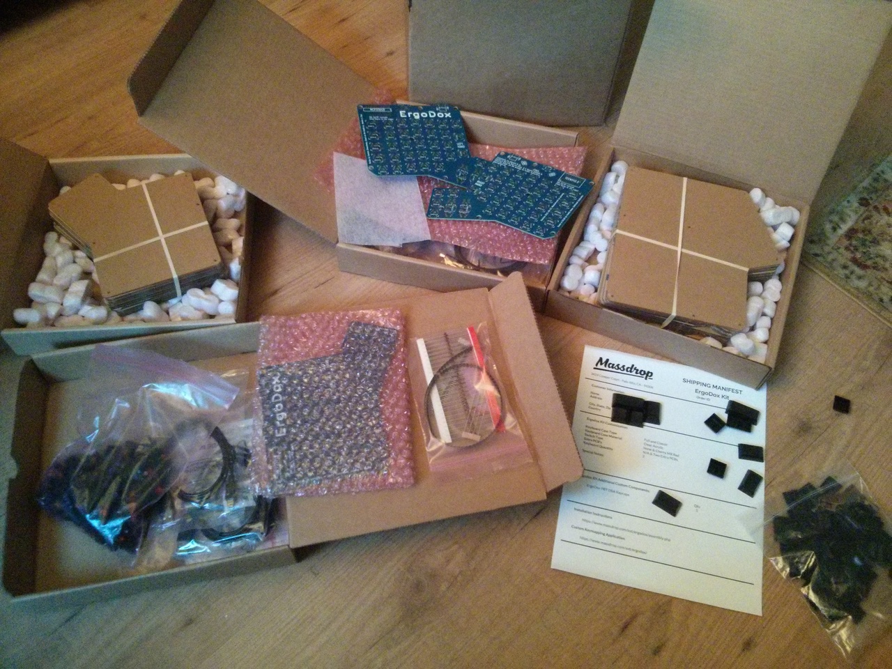

My order just arrived !!! Keycaps and all !
Unboxed ergodox order
ironman31
28 Mar 2013, 03:12
did they send you an email before shipping them?
sordna
28 Mar 2013, 03:30
No they did not, however I checked my order status on MD earlier today and saw a tracking number.
So for those who ordered and want to check, click your username -> My transactions -> recent transactions on massdrop.com and you'll see a tracking number if they shipped yours.

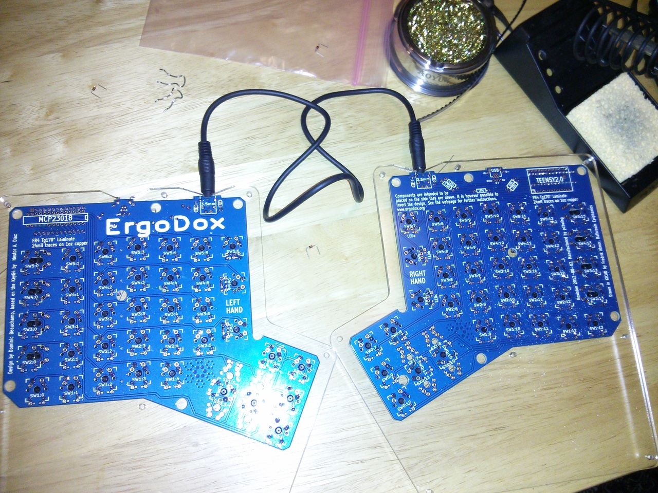

BTW the assembly instructions have been revised, and suggest to solder the diodes on the underside of the PCB, to avoid touching the switch plate. The kits came with both hole-through and SMD diodes, you can see that in my photo... but I'll be using switches with built-in diodes, like the ones on my Advantage LF.

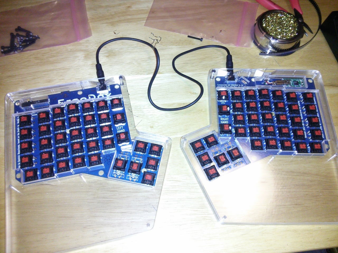

Finished one of mine, couldn't wait till the weekend. I used switches with pins and integrated diodes. For the 3 switches with the LEDs I opened the switches, removed the diodes to make room for the LED's and soldered the diodes on the underside of the PCB.

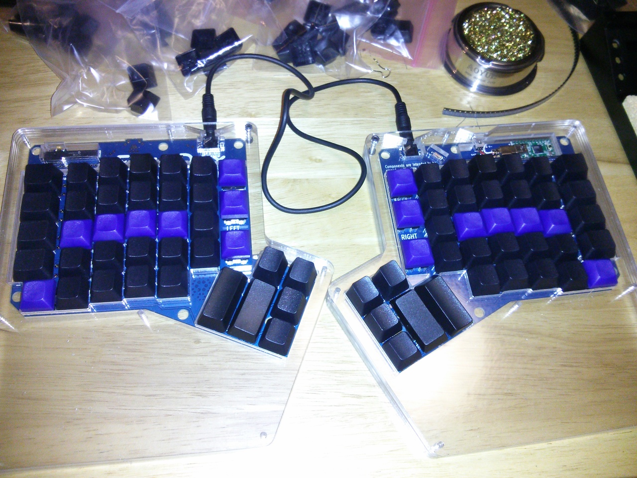

I put a blank Kinesis set on it.
eviltobz
02 Apr 2013, 11:46
ooooh, that looks pretty tasty with the kinesis home row keys, me like :)

Say, I remember there was a step about bridging 2 soldring pads together, on the corner of the MCP chip, you can see it here, next to the capacitor (ic07 photo from page 17) of this thread
What is that step for? The new instructions I followd didn't say that so I didn't and the keyboard works fine.
