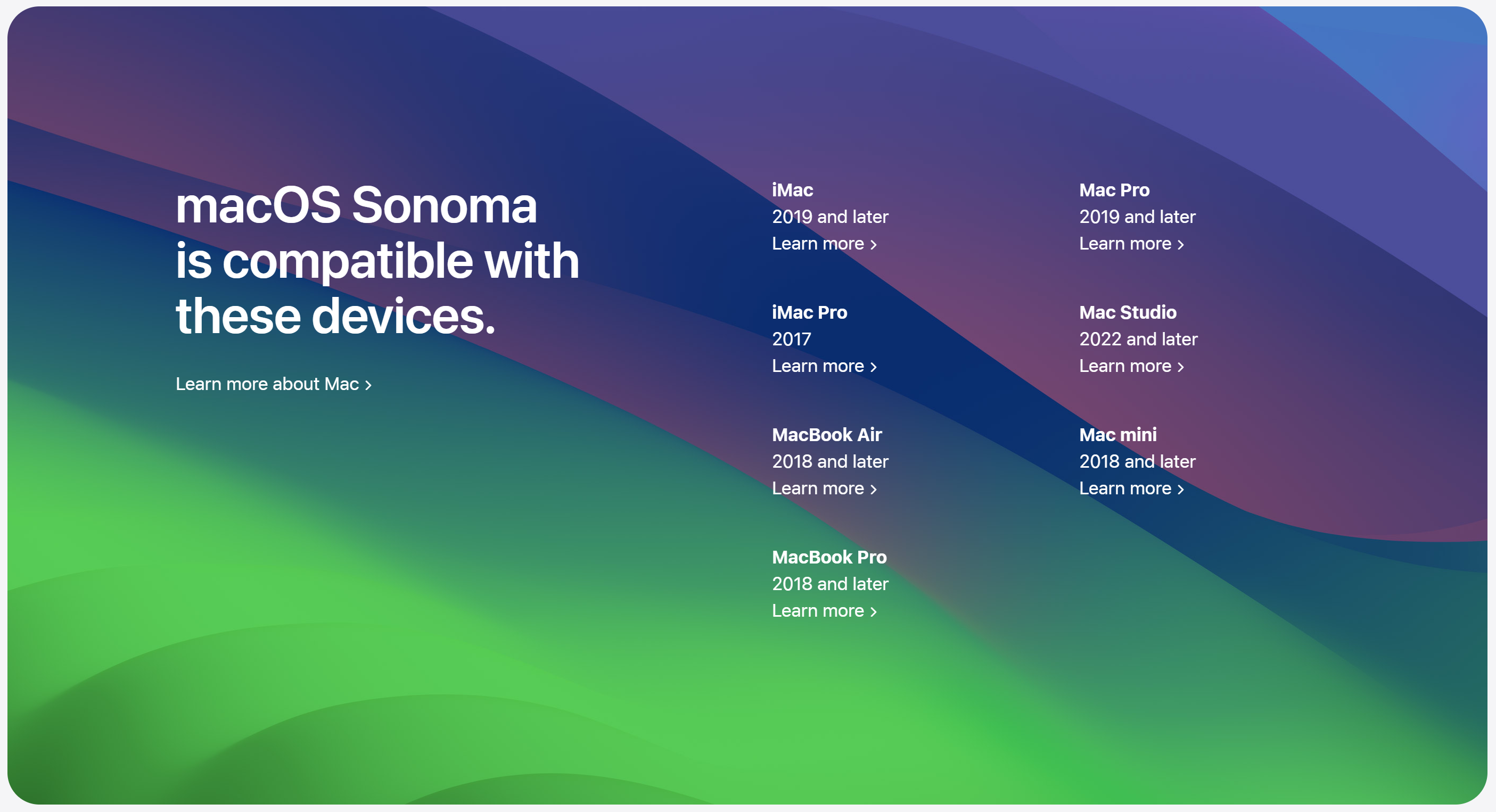

As for transitions: Apple’s following the same path. Seen any new Intel Macs since the M1? They’ll be as dead to them as Motorola in no time.

Muirium wrote: 05 Sep 2023, 10:58As for transitions: Apple’s following the same path. Seen any new Intel Macs since the M1? They’ll be as dead to them as Motorola in no time.
Oh, I'm not disputing that at all. I just remembered Jobs' comment, forgot about the quad G5, and thought it was funny. But I'm also recognizing that this transition is quite plainly taking longer than the last one. For example, MacOS only went through 1.5 versions that were dual-platform before PPC got the rug yanked out from underneath it (Tiger had already been released at retail before the Intel transition was announced; Leopard was the only retail upgrade disc that supported both platforms on one disc...now, Apple was not exactly running on their one-major-release-per-year cadence/release-cycle for MacOS yet by this point, granted!). But this go-round, MacOS has already seen three full version releases (Big Sur / Monterey / Ventura) where both x86-64 and aarch64 are still supported side-by-side, and we already know that the one about to come out (Sonoma) still retains Intel support, too, so that's *four*! And since they only stopped manufacturing their last Intel machines (and not just any model, but the freakin' Mac Pro!) a couple of months ago, I'm not so sure that they won't have at least one more version of MacOS that supports both even after Sonoma. Which means Intel hardware support likely won't be killed off until MacOS 16 (2025), which quite possibly also means that Rosetta 2 won't die until MacOS 17 (2026)!

06 Sep 2023, 01:06
I don’t have an Xwhatsit (firmware) powered board among my little fleet of Xwhatsit (hardware) powered IBMs to test this. Kinda says it all, really. It was a godsend but contained a curse. Then Pandrew came along and bettered it completely. Even Arkku’s firmware didn’t last long on my IBMs as it was having (different) issues. These boards are much too important to me to accept anything less than 100% reliability.
NathanA wrote: 05 Sep 2023, 11:21 Which means Intel hardware support likely won't be killed off until MacOS 16 (2025), which quite possibly also means that Rosetta 2 won't die until MacOS 17 (2026)!
I’ll check in on this when they do drop Intel. I expect it will be soon. No love lost there at all.
NathanA
06 Sep 2023, 01:25
Muirium wrote: 06 Sep 2023, 01:06
I guess it all depends on what one considers to be "soon". I am predicting 2025, but the absolute *soonest* that they could possibly drop it is late 2024. We *know* this to be the case, because Apple has already publicly committed that MacOS 14 "Sonoma", which is currently in beta right now, will continue support Intel. New major versions of MacOS typically come out of beta in October/November. So they literally can't drop support for Intel (without going back on their word, at least) until October/November 2024, with the release of MacOS 15. So if "over a year" is considered "soon", well...I guess that's one possible interpretation of "soon"? ;)
06 Sep 2023, 23:06
Something like that. I wouldn’t count antique OS version history as any guide—Tiger was one hell of a long lived cat—as Apple switched gears to annual releases, come what may, after the Leopard debacle. “Leopard = Longhorn” really was a thing on nerdy lips back then.
Anyway, I’d just build it for the current OS version (and its two architectures) and forget all about Sky High Sierra and Yosemite Sam. Any Mac user nerdy enough to play with QMK is running current software. My two older Macs run Snow Leopard (a 2006 Mac Mini) and Tiger (my original Mac: a 2003 PowerBook 12 inch). I’m not seeking support for them, the M1 can do the job quite nicely.
NathanA
06 Sep 2023, 23:58
Muirium wrote: 06 Sep 2023, 23:06Something like that. I wouldn’t count antique OS version history as any guide—
It's not really even a matter of me looking at the past to use as a guide for this instance. I'm looking at what Apple has publicly communicated about their intentions for MacOS Sonoma. This yet-to-be-released version still supports Intel...this part isn't even up for conjecture or dispute. So unless Apple decides to break their very public promise, the software support for Intel continuing on for the next 400ish days is already in the bag.
Therefore, Intel support might extend further out than one more year, but whether or not that happens, we already know for a fact it is going to be at least one more year. That's all I'm saying.
Muirium wrote: 06 Sep 2023, 23:06Any Mac user nerdy enough to play with QMK is running current software.
If this were GH, that statement would probably be true. And likely even for most people here, it's true. But I do get the sense that the DT audience here is made up of a larger cross-section of people who are also at least tangentially interested in "vintage tech" when compared other online keyboarding communities, and I guess that's to be expected given that there is just a plain larger interest in vintage keyboards here relative to elsewhere. After all, right now we are talking to each other in a thread that's largely about reproductions of keyboards that were made in the early 80s and freaking weigh nearly 10 pounds. And even I get a hankerin' on occasion to use my "new" F boards on some of my older machines.
The way I looked at it was, if I can extend the range of base OS compatibility with minimal effort in order to benefit the widest possible set of users, then why not do it? Also, the app we are talking about here is just a debugging/troubleshooting app anyway, where I would argue the "aesthetics" are absolutely secondary to its utility. It's not like we are talking about the Vial app here. (Oh dear, that gives me a very, very sick idea... :lol: )
Add to all of this that my own collection of Macs only contains machines that are at least a decade old already. So my own options for machines to both build and test on is limited. If I want to test on an Apple Silicon Mac in person, I have to borrow a friend's. My "newest" Mac that I own? Retina MacBook Pro 2012. So...
Like I said, I'll look into building a native aarch64 release. It's just going to take a little time given what I have to work with. I do have a functioning Catalina install on the rMBP, and I believe Xcode 12 (latest version of Xcode that will run on Catalina) is when building for Apple Silicon hardware targets was introduced. But I'm also looking into the available tools (e.g., OpenCore Legacy Patcher) for installing Ventura on a Mac of this vintage.
