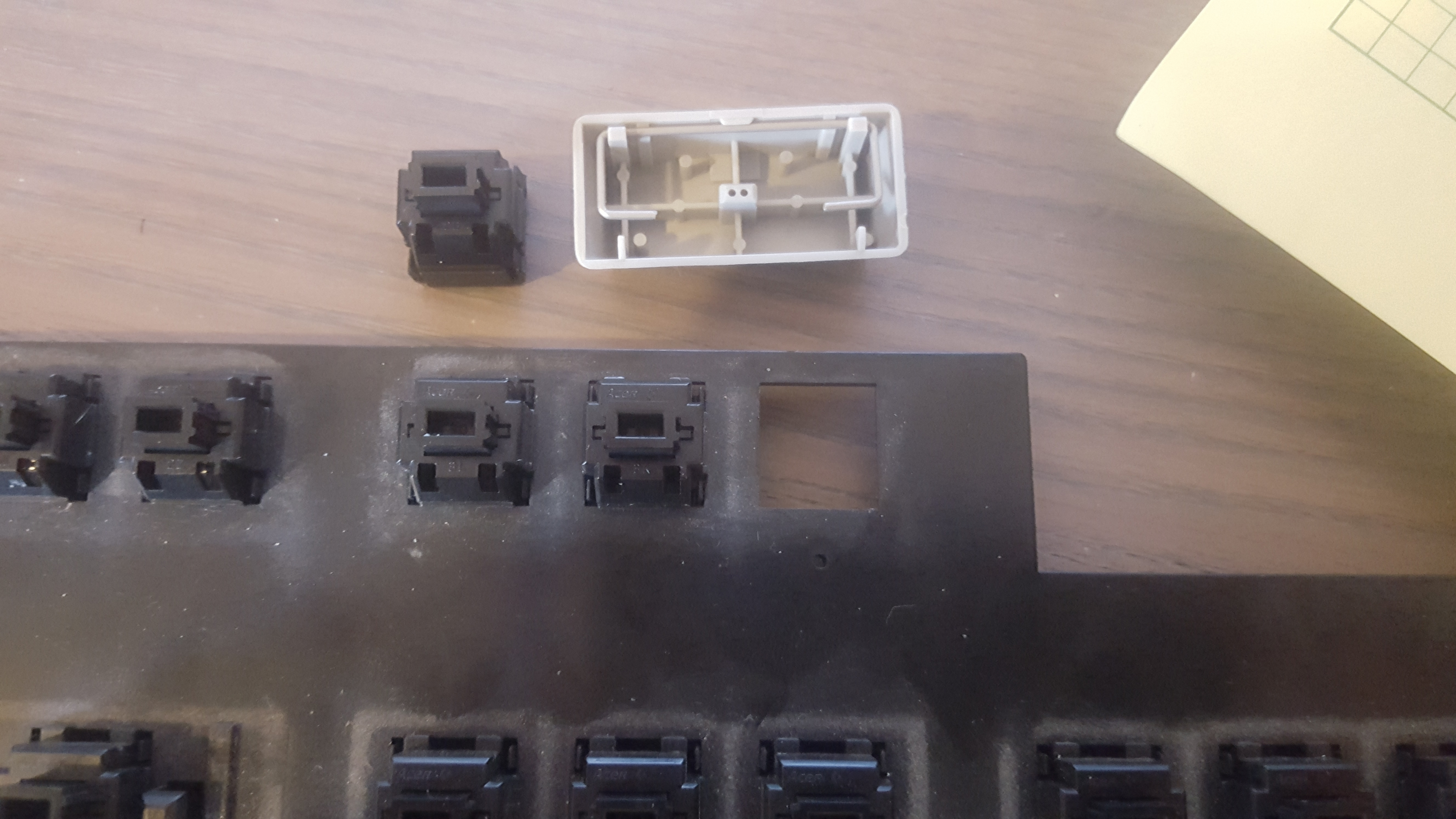

Does anyone have a 6311? I just got one (Data General), but I really don't like the switches (really rough/sharp typing on the keys not on the home row). I just took it apart to have a better look at the switches and plate, to try to use it on a Alps64. The slots are too narrow to accept alps switches (about 1~2 mm too thin) and I don't trust myself to file each slot perfectly enough.
The mods have a really strange stabilizer setup, with the wires clicked into the key itself, as opposed to the plate. The plate, additionally, has fully integrated slots (not removable). This makes it pretty hard to use the mods on any other board, and which would require me to get the mods from another board (which I'd like to avoid.
Does anyone have a work-around? And, if not, are they other caps that have the same profile? I know that the Apple caps aren't the same profile (I tried to put it on the M0116).
edit: Or, I suppose, any help on making these Acer switches less rough?

That 6311 uses Acer switches, which seem to be completely different from actual Alps switches other than the use of the Alps-mount and folded tactile leaves.
I am looking at the wiki page now, and I did not know that they were mounted exposed over a membrane instead of being completely discrete switches with switchplates!
Using Acer switches with an Alps64 is definitely a no-go here.

I have no intention of using the acer switches on a Alps64- the exact opposite. I want to use clicky-modded creams, but I want to use the caps from the 6311. But, my issue is that the modifiers use an upside-down stabilizer system.emdude wrote: That 6311 uses Acer switches, which seem to be completely different from actual Alps switches other than the use of the Alps-mount and folded tactile leaves.
The switches are sorta cool- they use an actual tactile leaf, which feels good individually, but there is friction and some level of sharpness that I can't really describe well that just kills the experience when typing. I would say that the wiki should have a much more damning review than "negative". The membrane feel is just on bottoming out, where it feels almost cushioned. The return (up-click) is even worse than the downstroke.

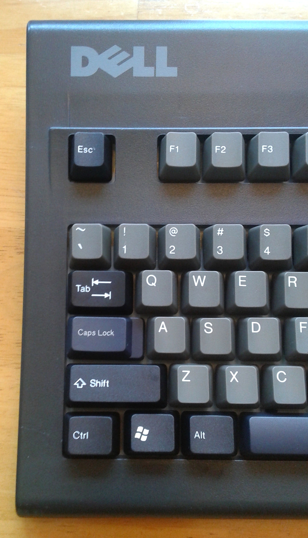

Built my "silent" AT101W today with Matias Quiet Clicks for the most-used keys (I had about 65 of them) and pine creams (non-dampened) for the balance, except for pine whites for a few keys where I wanted to be notified with a click (Escape, Num Lock, Caps Lock, etc).
Damn you, Tai Ho, for not making the proper space bar and Caps Lock!

- Chyros
- Location: The Netherlands
FUCK. That looks sleek as SHIT. I'm not normally too much into the whole keycap thing, but that's one of the most elegant keyboards I've ever seen.
You, sir, have good taste.
