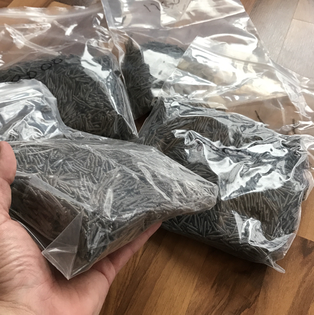

So today I finally got a chance to look at the springs that came in (anticipation awaits). So as a reminder... the goal was to take the actuation pressure from 65g down to 50g. I don't think I ever posted this, but I threw in quite a bit on top of our order and brought our total quantity of springs up to 25k in the hopes of getting this perfect.
First... this is what 25k springs look like. 3 bags of 8k with a 4th at 1.75k (750 extra in weight coverage)

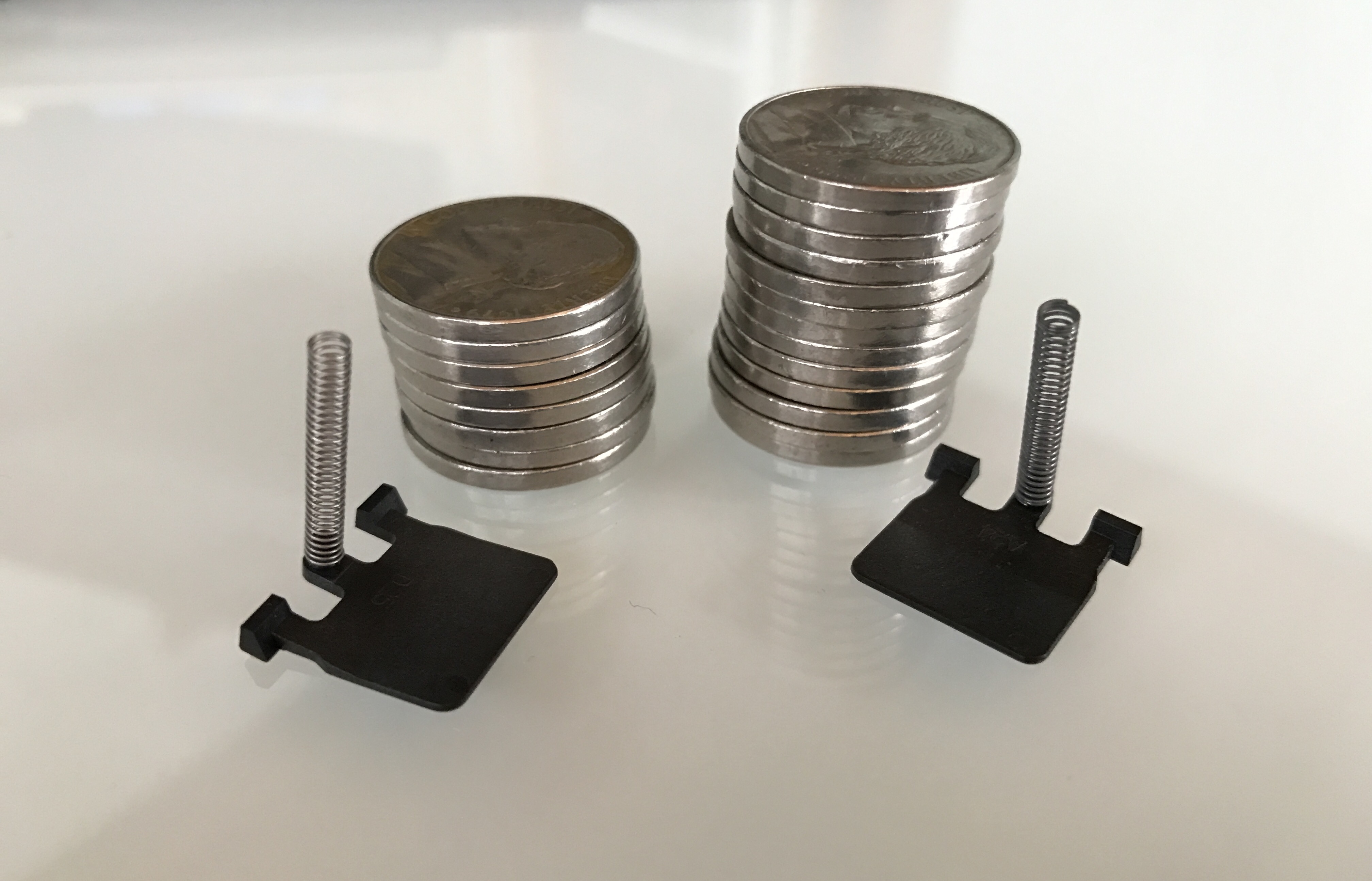

The result... the fit is perfect. I think our dimensions, coil counts, etc, are spot on. Maybe we could add one extra inactive coil on each end, but it really has no effect there on function. The actuation pressure, we overshot by a bit. We are at 40g vs our goal of 50g.
It is a VERY interesting sensation to be honest. One unfortunate part though, we actually buckle now based on the spring shearing WITHOUT an outside trigger. If you followed the workshop thread closely, you will remember that what actually activates the switch is the key stem base putting pressure on the flipper paddle while the spring is essentially "cocked". That breaks the vertical alignment of the spring and kicks off the violent event. This buckles just SLIGHTLY before the key stem strikes the paddle. It's not enough for me to register them as two separate events, but the actuation point is a quieter (less tactile and violent) event, but seems to be at a very consistent point each time. What that really means is that math was off. We were basing the actuation force of the previous spring at 60-65g, when in reality, it is likely closer to 80 since the event is fired by the paddle shifting out of alignment (the spring doesn't buckle until influenced by the outside force).
Moral... would need a complete board put together to really pass judgement on these 40g springs (they are still interesting), but I would have preferred them to be heavier myself. The upside, we learned a ton and I believe I know what we would need to produce these is any increment we really wanted going forward. Also, it should be noted that this was a different metal, so there was a learning curve there to see the differences in behavior.

lot_lizard wrote: Moral... would need a complete board put together to really pass judgement on these 40g springs (they are still interesting), but I would have preferred them to be heavier myself.
Science! Either way, it's good to have the options. An ultralight actuation on a buckling spring key could be an interesting take.

lot_lizard wrote: This buckles just SLIGHTLY before the key stem strikes the paddle. It's not enough for me to register them as two separate events, but the actuation point is a quieter (less tactile and violent) event, but seems to be at a very consistent point each time
So I went back and tried this on a proper curved plane where the base is seated properly. The pitch changes just enough that the key stem/paddle contact is back to being the agent that fires the event consistently. I tried with 8 new springs total so far, and this was the case on each. To rephrase... I think we just accidentally found the lightest actuation spring possible to have the switch still behave as it should in ENTIRETY. I'm back to geeking out a bit about this concept. The feel is growing on me rapidly as well, though a 60-65g is actually my "sweet spot" already. The upstroke is still quite responsive for those that would have that concern. I will assemble the full SSK prototype using the new springs to get a full take. Im not sure it is going to be heavy enough to support the spacebar, but I did try on a 2.75x, and it still functions. In an ideal world, I think we would have SLIGHTLY different weights made to counteract the key weight. Not to be confused with a differential gram based on key location, but a differential gram based on key weight. At least for this UBER sensitive configuration.
All this said, I like heavy switches in general, but I have large heavy hands and type hard. I am not a gamer, but I do think this switch (aside from travel length) is a much more realistic gaming switch now with this light of a spring.
