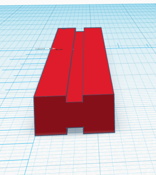

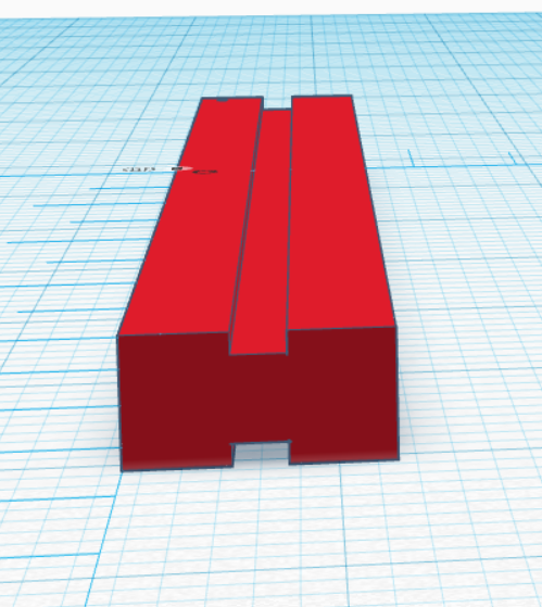

I feel you though, and I made a wiring jig that you can 3d-print.
I'm printing another one right now to test the print quality required.
Basically you just wrap an unshielded solid-core wire around the jig and cut down the middle with some flush cutters. It's basically the right size to just take the Half-square shaped wire and drop it into the holes. Will upload an STL here or thingiverse once it's done printing.
Here's a sample though to get an idea of what it looks like:
Re: Another single-switch circuit board
Posted: 25 Feb 2021, 20:32
by ping
It's not perfect, but it does speed up the process quite a bit (in my opinion).
Here are some images of me using the jig:
Amoeba_wiring_jig.zip
(1.24 KiB) Downloaded 385 times
feel free to use/modify/sell or whatever you want with that STL. Took me 10 mins in tinkercad.

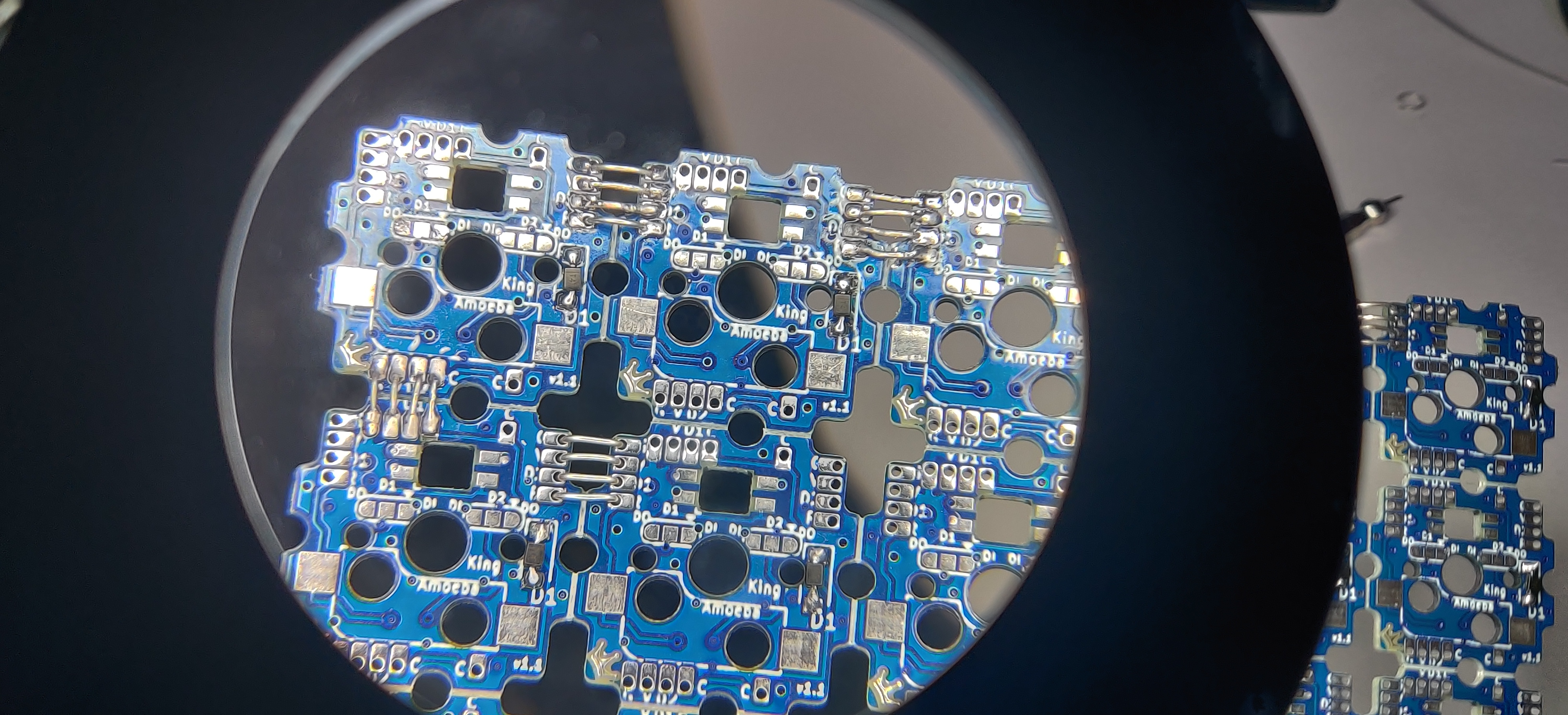

This is what I ordered from JLCPCB:
Ordered 200 of these(reduced amount to stay in budget): https://m.aliexpress.com/item/4000475685852.html
500 of these:
https://a.aliexpress.com/_msnCAuR
Kailh hotswap sockets from kprepublic.
And I reached out to superami and they sent me this to help with wiring:
If you have any other questions, I'll do my best to answer. (And to enable email notifications lol)

Hi I was wondering how the jumpers work for the Amoeba King. Do you have a guide on it?
Hi, I don't have a guide other than the image superami provided.
Consider this to be a 2x3 ortholinear keyboard. Each of the colored lines connecting one pcb to the one right next to it is a jumper. At the end of the row, you'll see a column (on the right side) you'll see where all the black/red/green jumpers connect, but we have a pink wire connecting d2 to d2. That has to be done at the end of each row. All the other non-ending amoebas need the "C" column connected. This will feel familiar if you've ever done a hand-wired board without a PCB, each row and each column needs a wire connecting it all together, and then to the microcontroller.
Hope that helps. I'm not an expert, but if you have further questions, I'll do my best.
Good luck on your build.

Oh so you stripped the insulation? Then bent them using the wiring jig
Posted: 27 Jul 2021, 17:24
by ping
freznel10 wrote: 27 Jul 2021, 17:08 Oh so you stripped the insulation? Then bent them using the wiring jig
Yep, exactly. Those are the "jumpers". The jig just facilitates making them since you need so many.
