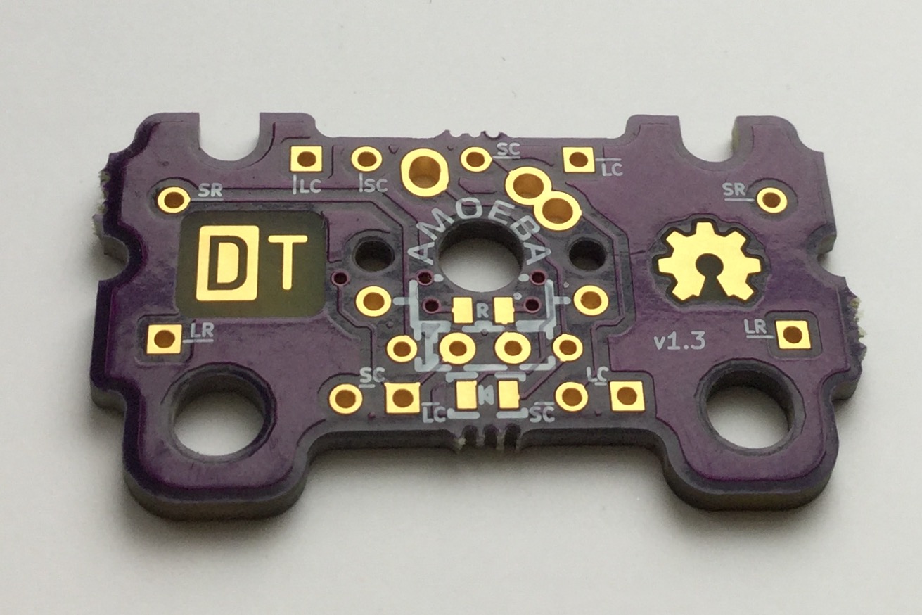

Melvang came up with the original idea for the Enabler, a single-switch PCB that supports Cherry MX and Alps switches. The idea was...
Melvang wrote: ...for people who want a custom layout but:
  1. Don't want to pay for a single PCB or 3 from OshPark
  2. Don't want to or don't have the ability to solder the rows and columns directly to the pins of the switches
  3. Want to have a more secure method for back lighting
  4. Want to try something a little bit different
MOZ designed the PCB and last year a group buy was run.
Hand wiring a keyboard matrix can be a meticulous process, can result in fragile connections between keys, and shorts in the matrix. To help improve the process, I wanted to take another crack at a single-switch PCB that offers the following benefits:
  1. Ability to connect the matrix using bare (non-insulated) wire. Creating hundreds of short jumper wires is a huge pain, and a PCB should be able to overcome this by eliminating the need for connection wires to overlap.
  2. Ability to mount the PCBs to the switch plate for structural reinforcement. Key cap swaps and switch modifications carry the risk of pulling the entire key switch away from the plate, possibly breaking matrix connections in the process. Mounting the PCB should prevent this.
  3. Support for through-hole components (LED resistor and n-key rollover diode), in case hand soldering SMD components is not your thing.
The above items do not come for free, however. Unlike the Enabler, the current design only supports Cherry MX switches (no Alps) (Alps support added! See updated renders below.), and the overall dimensions are larger than an MX switch.
I've ordered some prototypes from OSH Park and will test them out before looking into larger quantities. Here is the current original design (updated design posted later in the thread):

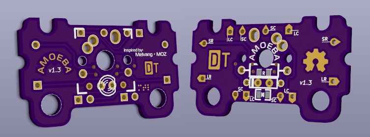

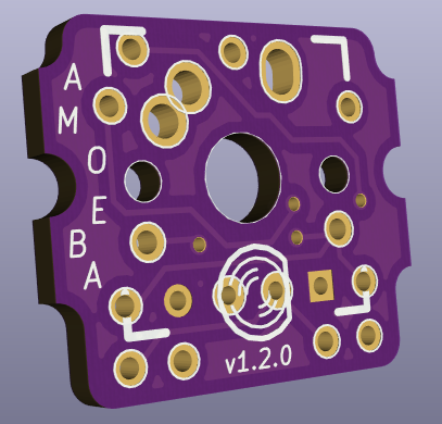

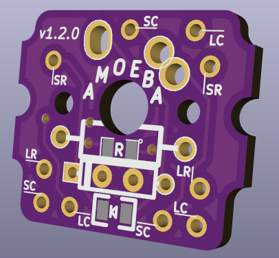

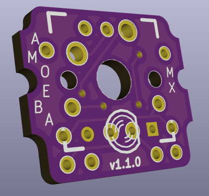

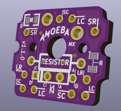

PCB renders (latest):
1u:
2u:
PCB renders (original):
Front:
Back:

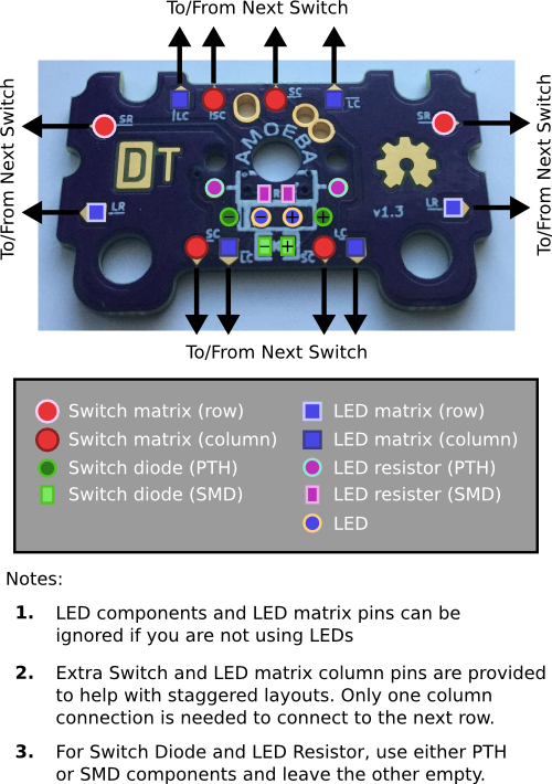

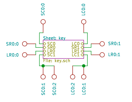

Note: SC = Switch column, SR = Switch row, LC = LED column, LR = LED row. The bottom of the PCB has extra SC and LC pads to make column wiring easier for staggered layouts.

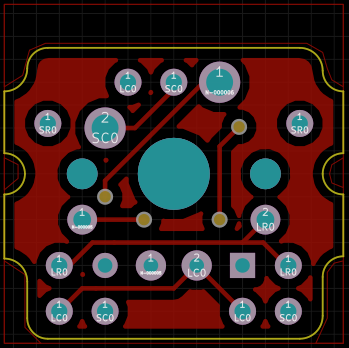

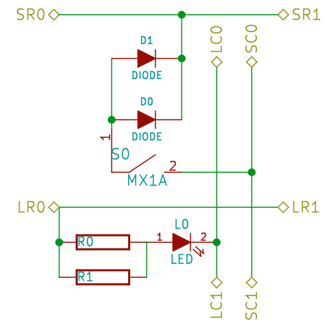

Schematics:

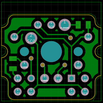

Board:
Key:
Circuit design:
Front:
Back:

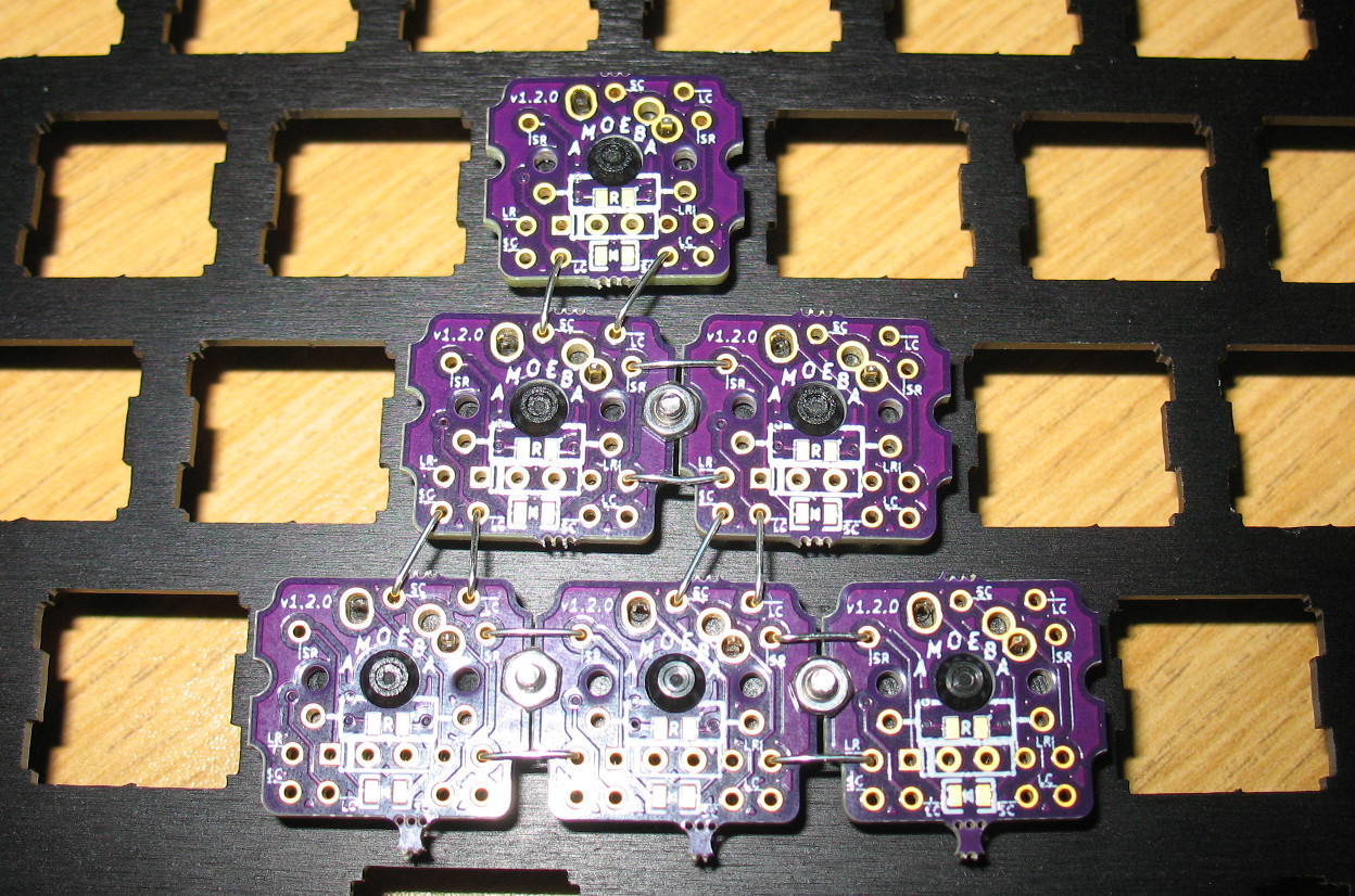

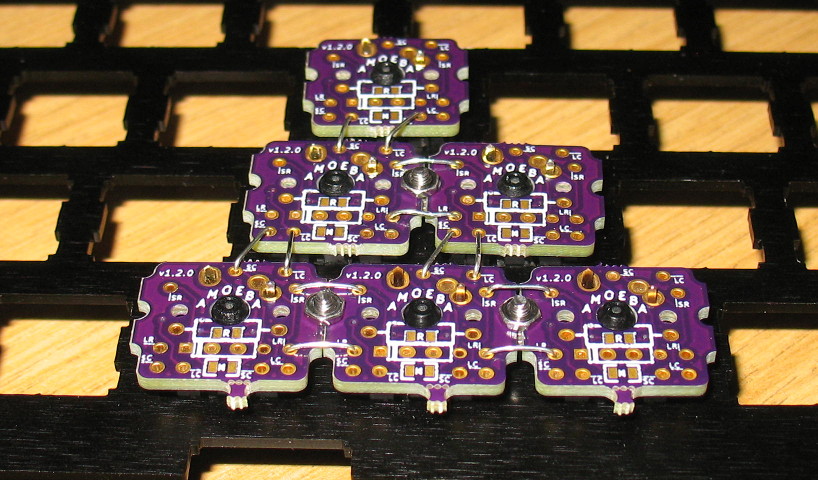

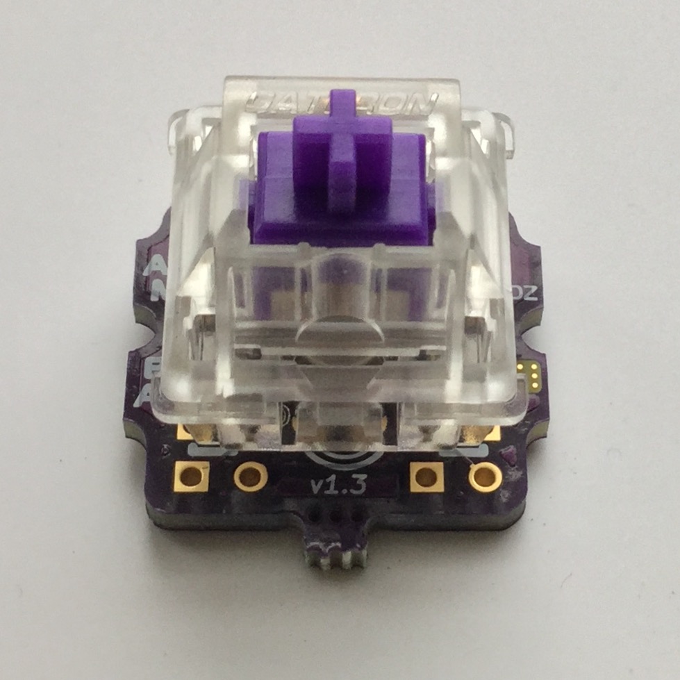

mtl
13 Sep 2015, 22:30

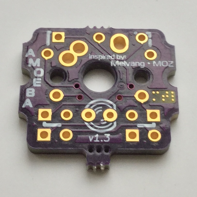

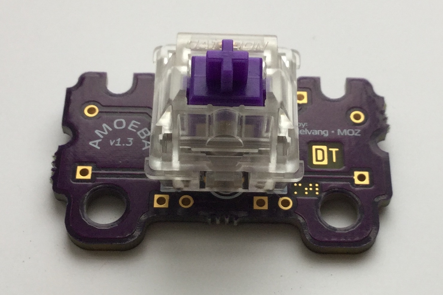

Prototypes are in! Actually I've had 'em for a while but have been super busy. Only had a small run of 6 made, but you can start to see how they would wire together as a matrix:
Note you only need one set of connecting wires for the switch matrix. The double wires going between switches form both the switch and LED matrices.
I've made a couple of improvements for v1.2.1:
  1. An extra SC (switch column) pad at the top left where the version number currently is. This will make wiring non-staggered layouts easier.
  2. The lower-left SC pad was left unconnected in the circuit design and has been fixed. :)
Also, I have some 3mm length M2 spacers purchased on eBay.
These are a good fit for between the PCB and plate. The Phantom plate in the pictures is just being used for testing, but ultimately I'm thinking to have a plate made with holes between the switches for mounting these PCBs, and the spacers will help ensure the switches stay put. I also ordered some brass stand-offs for the same purpose, but they haven't arrived yet from China.

Here's the current design (v1.2.1), now with square pads for the LED matrix:
Not sure if anyone noticed, but the top-left wire was connected wrong in the above prototype pictures. :) Differently-shaped pads for each matrix should help prevent that mistake!

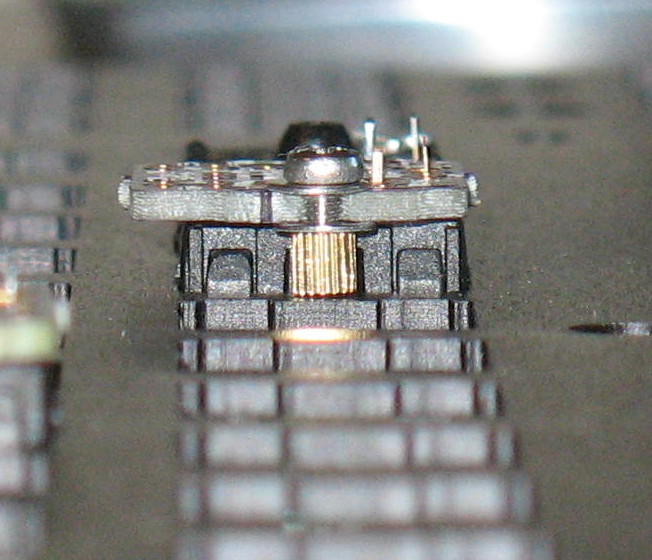

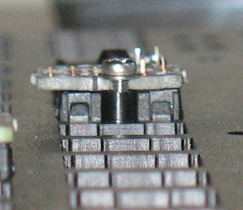

Also, the brass spacers arrived. Here are comparison shots between the brass and nylon:
Assuming a plate thickness of 1.5 mm, there is a gap of about 3.5 mm between the PCB and plate. The brass stand-offs are 3 mm exactly, but with a washer come out to about 3.4 mm and are a good fit. The nylon spacers are around 3.3 mm. The brass are heavier, but they're threaded and therefore won't move around. The nylon spacers do not fit the M2 screws tightly, so there is a chance they could rattle a little bit. So you have your pros and cons. ;)

Added updated renders to the first post, including a possible wide version to support Cherry stabilizers (and move the mount points further out to support Costar stabilizers).
Does anything need to be done special for Alps stabilizers? I think the wiki said some Alps boards use Cherry stabilizers. In any case, I don't think I have any Cherry stabs to test with.
If anyone has Alps switches and Cherry stabs and is willing to test the PCBs for fit, please let me know!

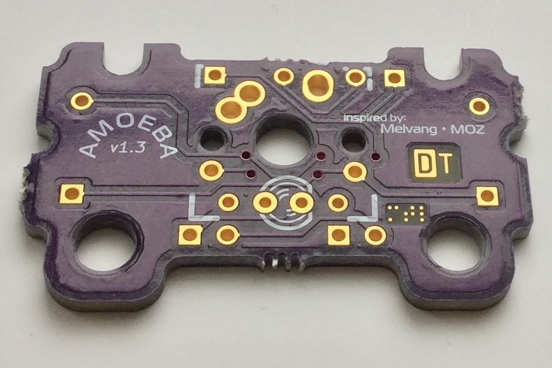

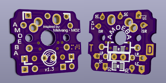

25 Nov 2015, 14:00

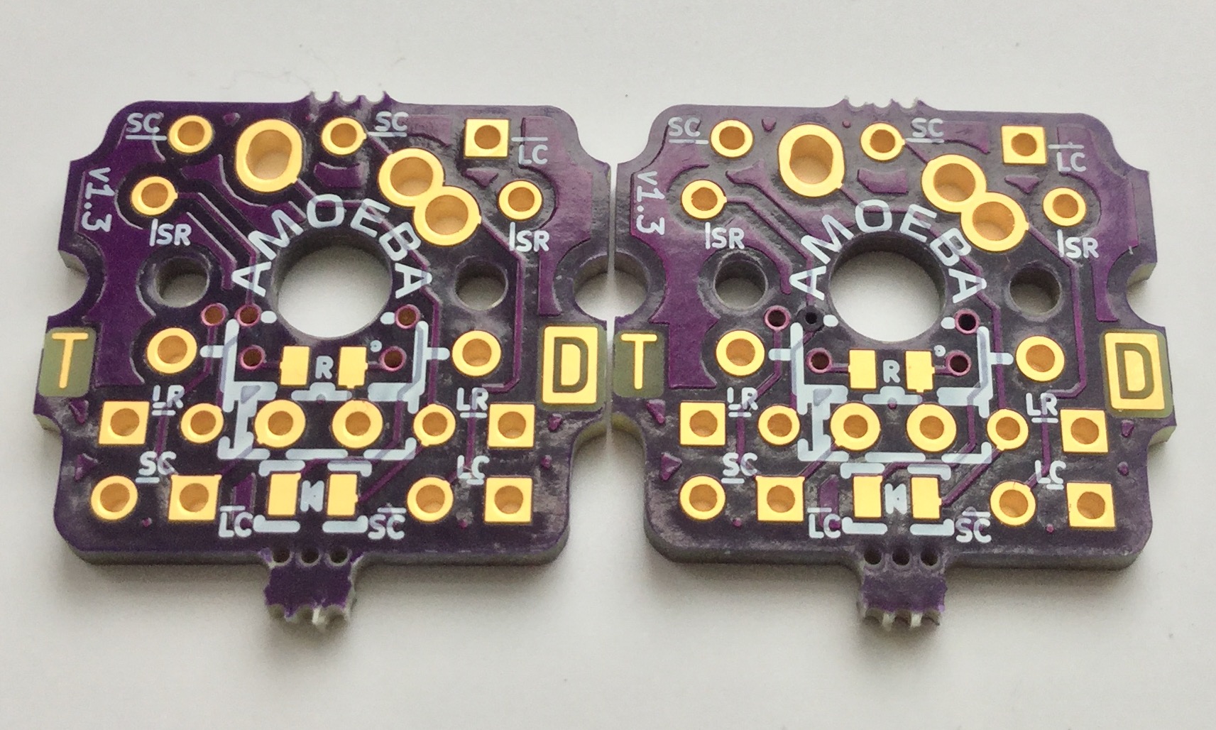

Here are some pictures of the latest batch. I got bored designing an actual keyboard for these so have spent too much time tweaking the PCB design in KiCad. :lol:
There is a prototype version of the 2u board, though I need to find some Cherry PCB-mount stabilizers to test the fit. Also, I've widened the PCB-mount holes by 0.1 mm to accommodate Zealio switches. You can see OshPark is challenged by the angled slot for the Alps/Cherry shared hole. It fits a Cherry switch fine but I don't have an Alps on-hand to test it.
The OP has been updated with new renders showing some other minor improvements, such as arrow-shaped solder pads for the row/column pins and tighter solder masks around the graphics.

mtl
05 Jan 2016, 02:46
pcaro wrote:I wish to see conections between items, etc
Sorry I cant see it in http://deskthority.net/workshop-f7/anot ... ml#p253525
Do you mean the connections between components on the PCB? Does this help?

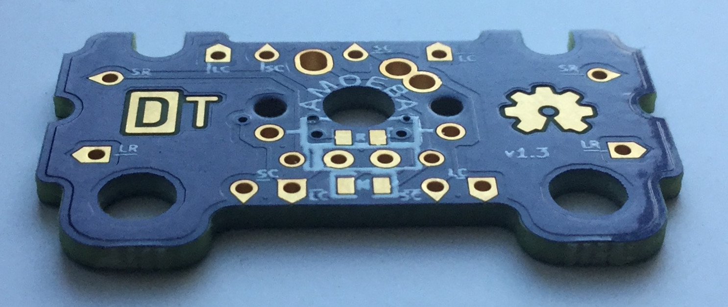

This is probably the final design (sorry for the bad lighting), unless anybody points out something that needs to change. It's mostly aesthetic improvements over the last prototype, including arrow-shaped pads to make the matrix connections really obvious and tighter masks around the copper graphics. The version number has been bumped to 1.5, latest project files pushed to github and design shared on OSH Park. :)

flabbergast
25 Feb 2016, 12:11
Just to report that I've used your amoebas for a CM switch tester. They're really great for doing things like this, it simplified the work, and more importantly the mess of wires, enormously!
Some more photos
