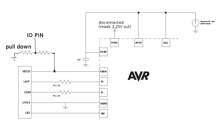

fun with uvcc.jpeg (24.42 KiB) Viewed 7432 times
(Works if UVCC is disconnected.)

Wait, so you're telling me, if UVVC is connected to VBUS and USB is not connected, you get a reading of 3.25V on the UVCC which pulls your detection pin high?
phosphorglow
30 Mar 2016, 23:13
Bingo! Exactly. :D
mohitgarg
31 Mar 2016, 10:04
But....That doesn't make sense (or does it?), the UVCC pin is supposed to be an input pin to the internal regulator?
phosphorglow
31 Mar 2016, 12:17
...until you connect UCAP to the external 3.3V regulator like the datasheet says. ;P
(Which is probably why they say to disconnect UVCC in that scenario.)

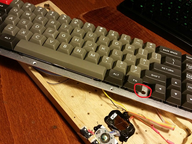

14 Jun 2016, 23:59
uhm.. do you think one per side might be needed? uhm.. one side would be enough imho.. to the right :)
at least that's what I'm confortable with after years of thinkpads!! but problem would be where to put that stick since it would usually be exactly on where the keyboard is splt.. not to speak where to put the mouse buttons..
but on a variant of brownfox I'm building I'm trying to position the stick between the right control and the left arrow of the arrow cluster since there is a 0.25u "space" just there available.. and the buttons still a bit messily put on the side of the case..
tentator
15 Jun 2016, 00:04
right there:
tent:wq
