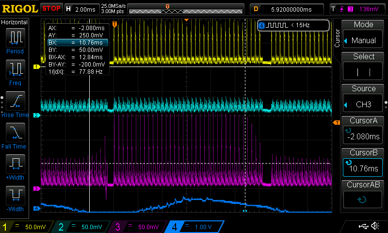

Progress:
I made away with interlaced reads today - just scanning all the columns in a single pass turned out to be enough (will commit today/tomorrow - need to remove resulting hairballs from schemata and code, and describe what was there to warn future me not to go that way anymore). Interleaving is handled internally by switching ADC to a grounded pin every other step - and it works, debouncing is not needed!
BUT when you flick the dimmer lying on the table 1 foot from keyboard - it registers a keypress. And, immediately, release, because spikes dimmer produces are very, very thin. They look like this (channel 4 is "freestanding piece of wire connected to a probe", to show, for lack of the better word, "background radiation"):
as opposed to normal course of events (The only difference is that key is depressed on channel 2):
Notice that the Disturbance in the Force is barely wider than one ADC reading cycle - so you can have just one key from the whole row affected by it.
This can, most probably, be fixed by IIR filter triggering on rolling average of last, let's say, 16 samples. This will delay response by, worst case, 16 cycles (which, at 3029 (measured!) scans per second is ~5.3 milliseconds - twice that if using cheaper, single-ADC chip), while preserving order of key presses down to 300/600 microseconds (I'm lying here right now, because current USB send routine waits for ACK from the host for every packet it sends - this pauses everything for ~1ms. But nothing prevents me from making proper USB send routine or even moving the matrix scanner to ISR). Look at the pretty picture - that's what happens on keypress and release. I'm not a good touch-typist and cannot make a keypress less than 13 milliseconds long - so the picture is a bit crowded horizontally. Channel 2 is the adjacent key - this gets a pretty good idea of magnitude of the crosstalk. Channel 1 is actually the leftmost row at rest - it gets a HUGE signal boost because its' trace is so short.
/me also thinks about using a long PCB trace on a controller which is connected to midpoint of large-value resistor bridge (so that it's easily overwhelmed by external noise) and has 2 comparators connected to it - one sensing going over 2.5V+??mV, and one for going under 2.5V, and discarding data if any of the comparators triggered. This way even a very short spike will be detected. If comparators' input capacitance won't kill useful signal, that is. Directly sensing Disturbance in the Force is somewhat more elegant, but then if it originates on a farthest point from the controller, we can just miss it.
So IIR filter should be just fine (unless you're that HAM operator sitting directly under 1200W shortwave transmitter, of course. I don't really know what to do in his case, frankly. )

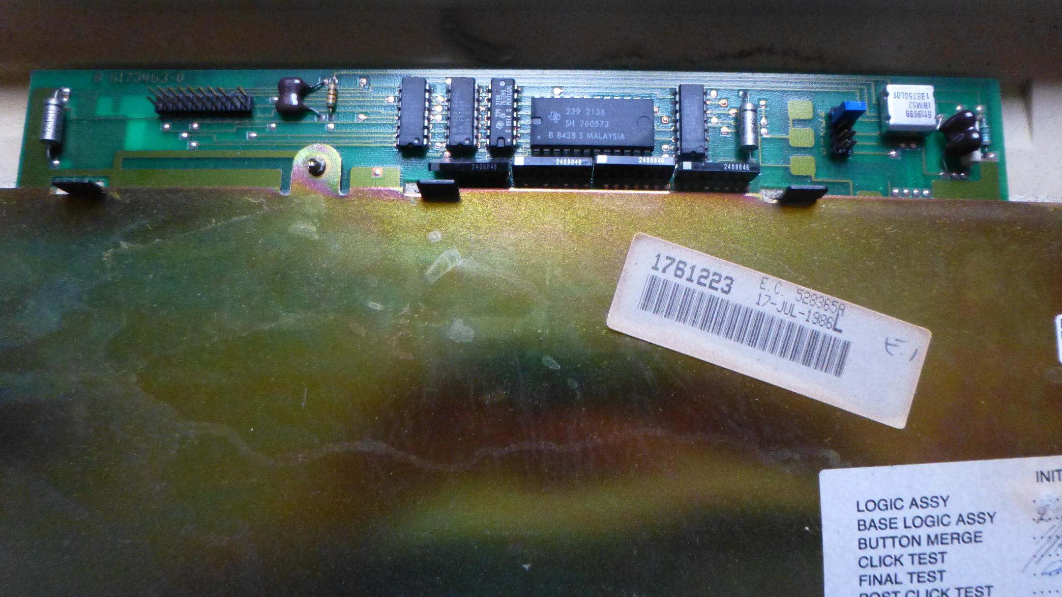

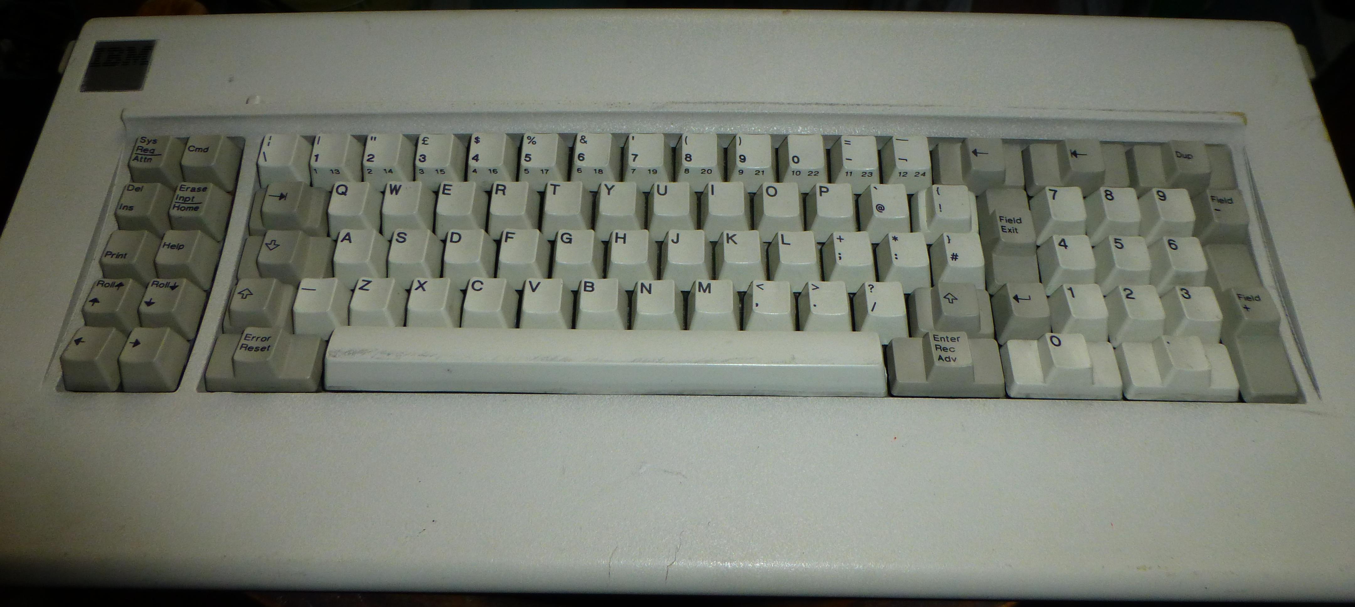

So, my Terminal F arrived
- but it seems to have just a single PCB, with both the capacitive pads and the sensing circuitry on it. :S
Looks like I'll have to either hack it up (cut away the PCB part with the sensing circuitry - or at least cut the traces and graft my own connections on), or perhaps in fact procure a different model with circuitry not integrated onto the PCB if I want to develop a plug-on controller.
Any suggestions?

HuBandiT
04 Jan 2017, 16:26
Techno Trousers wrote: I thought that was the point of the exercise--to develop a better alternative to the xwhatsit controller, which is a direct replacement for the Model F and beamspring capacitive sensors/controllers? If you're interested in developing a downstream option, isn't that more like the Soarer controller that remaps the keystrokes?
Sorry if I'm being naive-- this is obviously not my forte.
The Model F and Beamspring keyboards have two circuit boards: one board underneath the keys forming a passive capacitive key matrix, and a second board containing the signal triggering and sensing circuitry and the controller (scanning and reporting). The two boards are connected through a board connector. Hence, when modernizing a Model F or a Beamspring keyboard, the most practical (and reversible) method is to disconnect and replace this entire second board; however, this forces the designer (xwhatsit and DMA) to have their own signal triggering and sensing circuitry on the replacement board together with the digital controller containing the key scanning and key reporting logic.
The community feedback was that there is demand for improving these signal triggering and sensing solutions. My intent therefore is to have an attempt at developing an improved signal triggering and sensing solution.
The particular keyboard specimen I acquired for this development however seems to include a signal triggering and sensing circuitry that is not removable (without damaging the keyboard), because it is integrated onto the same circuit board where the passive capacitive key matrix is. This is preventing me from developing my own version of signal triggering and sensing circuitry without irreversibly modifying (instead of just reversibly replacing/adding to) the keyboard.
Because the keyboard seems to be in relatively good condition mechanically and electrically (at least on visual inspection), it would be more valuable to preserve its function and use it as candidate for restoring to original condition (should anyone have an old system such that they can connect it to it), or for developing a modern controller/interface for it that relies on (instead of replaces) its integrated signal triggering and sensing circuitry. (That however would be a digital interfacing project, which is not the project I am pursuing here - although it might be if there is enough demand.)
Therefore, I am quite hesitant to irreversibly damage/modify this keyboard for my development purposes. Furthermore, even if I did decide to modify it for my development purposes, it might turn out to be sufficiently different in its characteristics from the original keyboards I intend to provide a signal triggering and sensing solution for so as to render my development effort performed on this keyboard - with the eventual goal of providing an alternative to xwhatsit's or DMA's solution - moot due to inapplicability to the original keyboards due to the differences between them and this development specimen.

HuBandit cut the traces. There are vias somewhat on the border of sensing PCB. Cut the traces on the controller part, solder your wires to those vias.

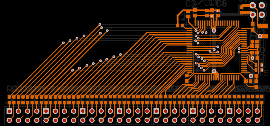

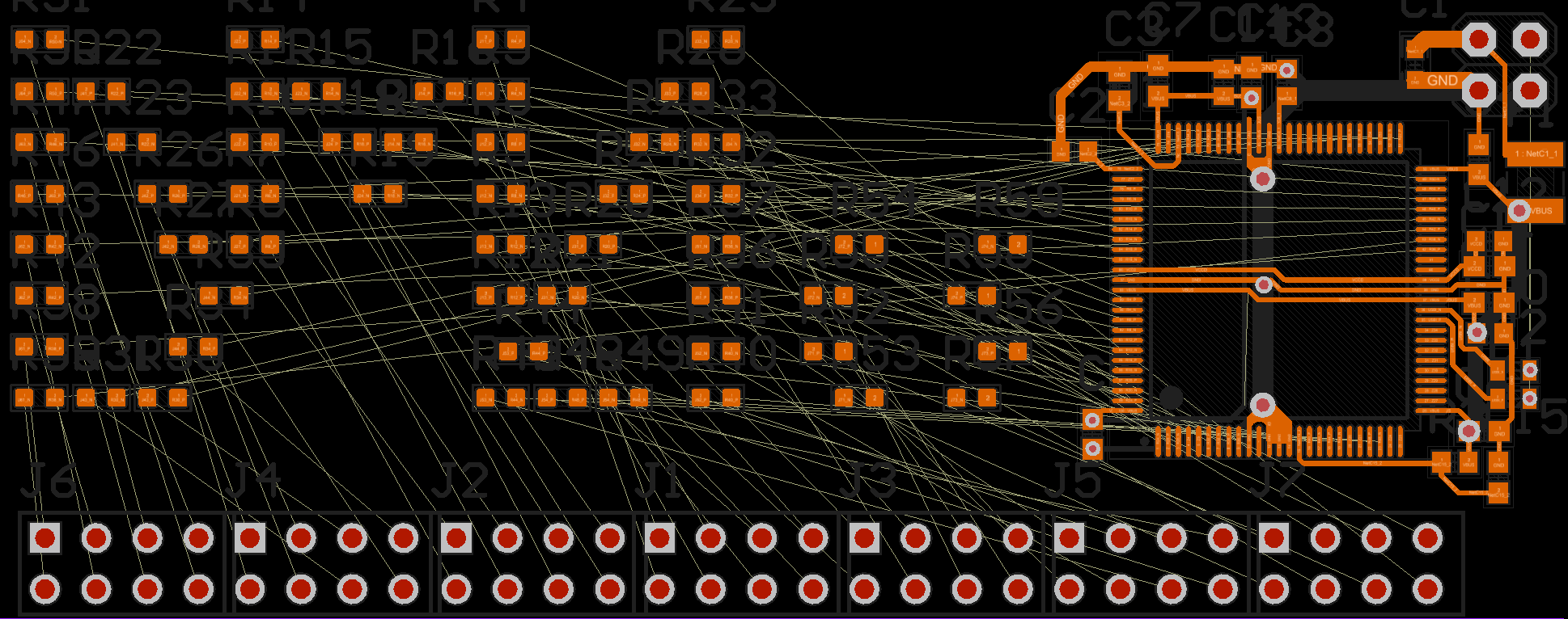

22 Jan 2017, 12:08
Each EDA tool has its place within the Tao.
But do not edit PCBs in CircuitMaker if you can avoid it.
It's practically impossible to abandon the project which posesses you :(
It came to PCB stage. Debug PCB, because 30 GPIOs is not enough if you want differential channels (and you want to - good chance it will improve external noise immunity). You need 48 for that. Well, for beam springs you need 56 - don't have any of those laying around, but why not layout for it, may be I'll just find one laying in the gutter or something. The controller supposed to be universal, after all. Just a tiny strip of FR4 to convert to 0.12/0.2" connector pitch is all that's supposed to be needed for the more esoteric keyboards.
So, CircuitMaker. My favorite for now that it proclaims random PCB regions cursed, and if you try to lay a track there, it shows hourglass for like 5 minutes. For every click.
And it stores all your files "in the cloud". And insults you by assigning the title of "Maker" to your account - which you can't hide or change. Should've chosen kicad, despite horrible ugliness of the fonts. Will do for the release PCB. Just need to fix that kicad stroke font - my eyes bleed every time I see it :(
So. At first it looked like this:
Pretty. Makes autorouter so miserable it shoots itself in the head. And manual routing.. No thanks.
Now it looks like this:
Autorouter failed even on the connector part. But it was somewhat easier to manually lay out.
Tomorrow I'll strip the silk from the texts (because it's a mess, at least around the connector) and figure out how to do those golden insignias on the PCB (If you sign your job - do it in style. Thinking of registering "Open Drain Hardware, LLC" even.). Then it goes to OSHPark, and BOM goes somewhere else. Then !!SCIENCE!! (and two of those, I hope, will find a place in my model MFs. Can't wait!)
Those pads besides the connector are resistors in series with the line. Or diodes between the line and the ground, to protect the controller from the 1200W transceiver guy. It's a debug PCB, and I'm doing my best not to order another debug version. Boy one-off things are expensive.
If diodes will make sense - will probably need to go four layers, because it's a bitch to layout 50+ GPIOs in limited space, let alone routing every one of them thru 3 discrete components, 2 of which are grounded.
But that all somewhere in March, may be even April. Going to Moscow for most of the February - to hunt down some very rare specimen to HaaTa, among other things. Then new job, I hope - which also takes time.

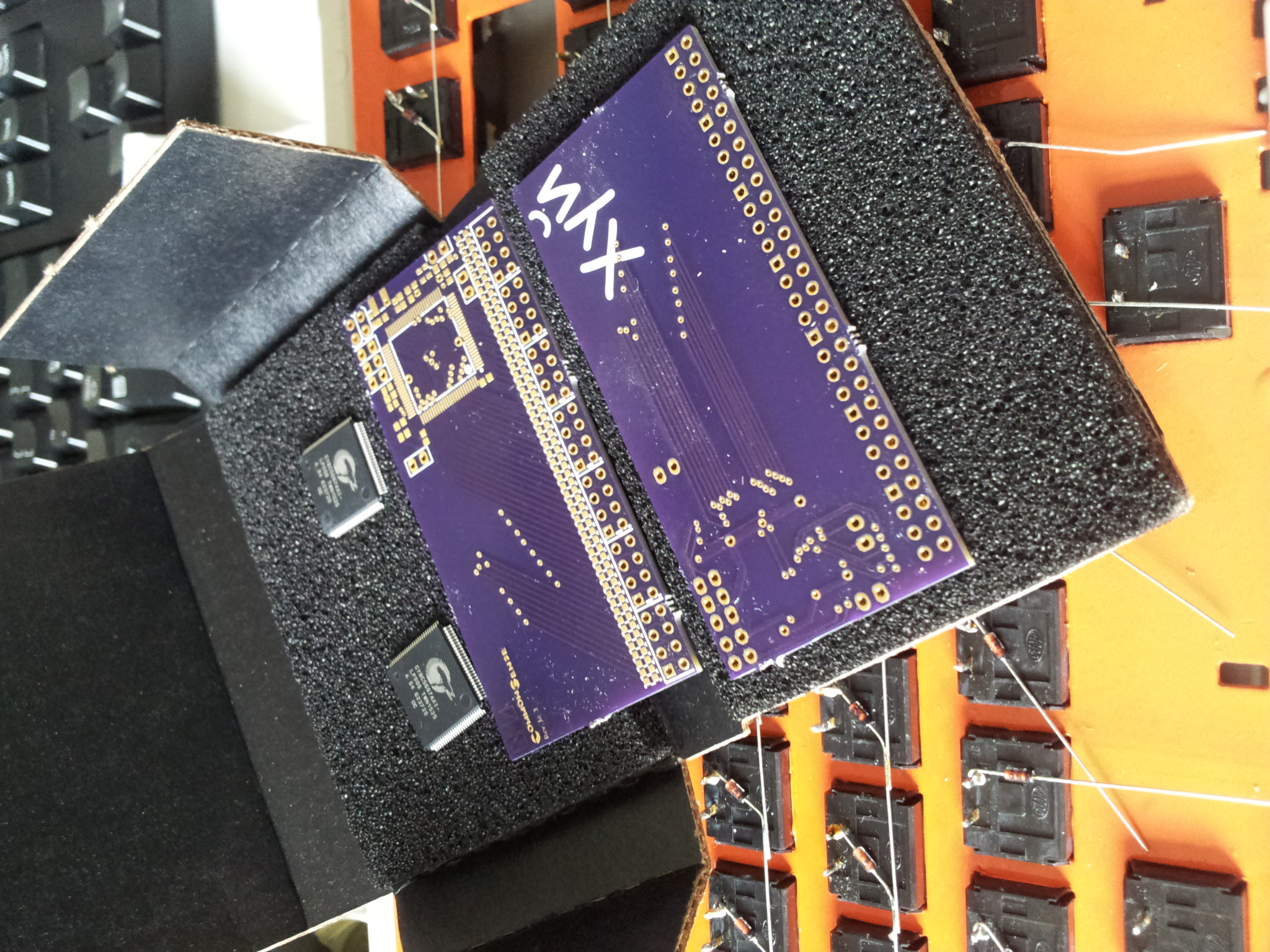

DMA
03 Feb 2017, 00:07
tentator
03 Feb 2017, 01:34
ha! really looks funky! love it! :)
but don't tell me you will solder that nightmare by hand..
DMA
03 Feb 2017, 01:37
tentator wrote: ha! really looks funky! love it! :)

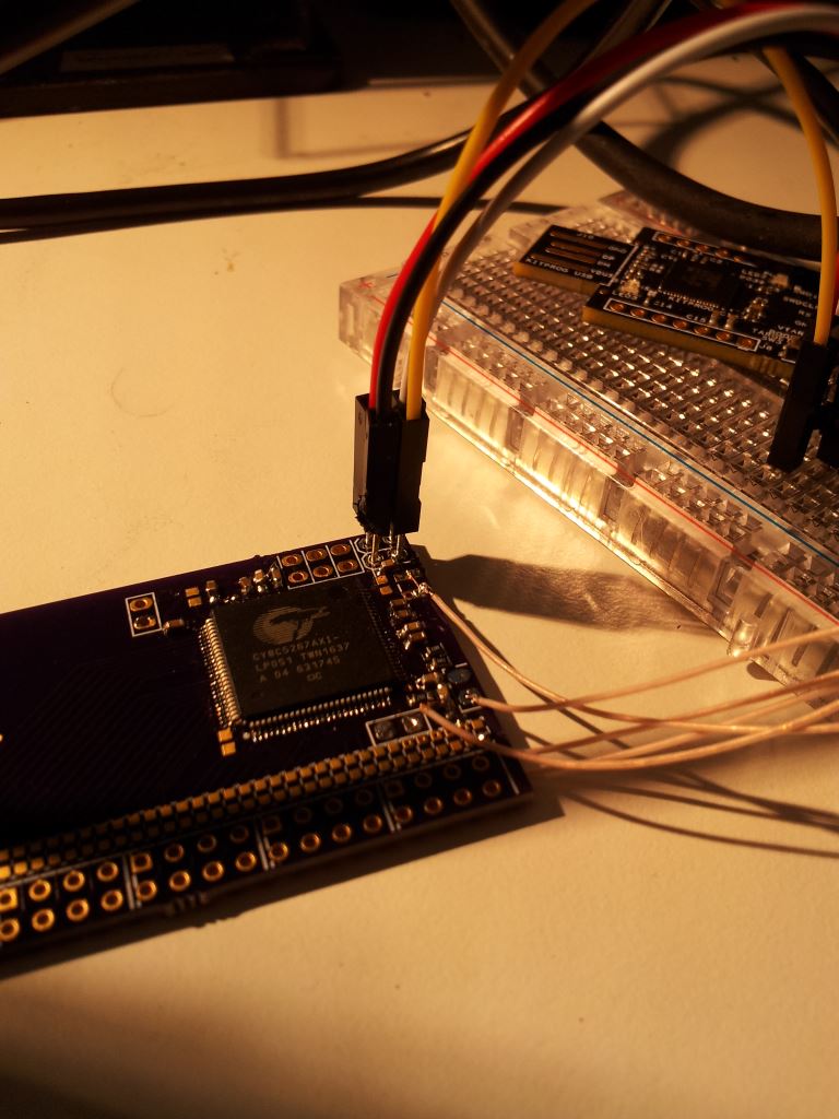

..and already soldered one chip 180 degrees of what it should be. Too nervous :(
Luckily I have 2 more chips and PCBs.
The chip was the more expensive variety though :lol:

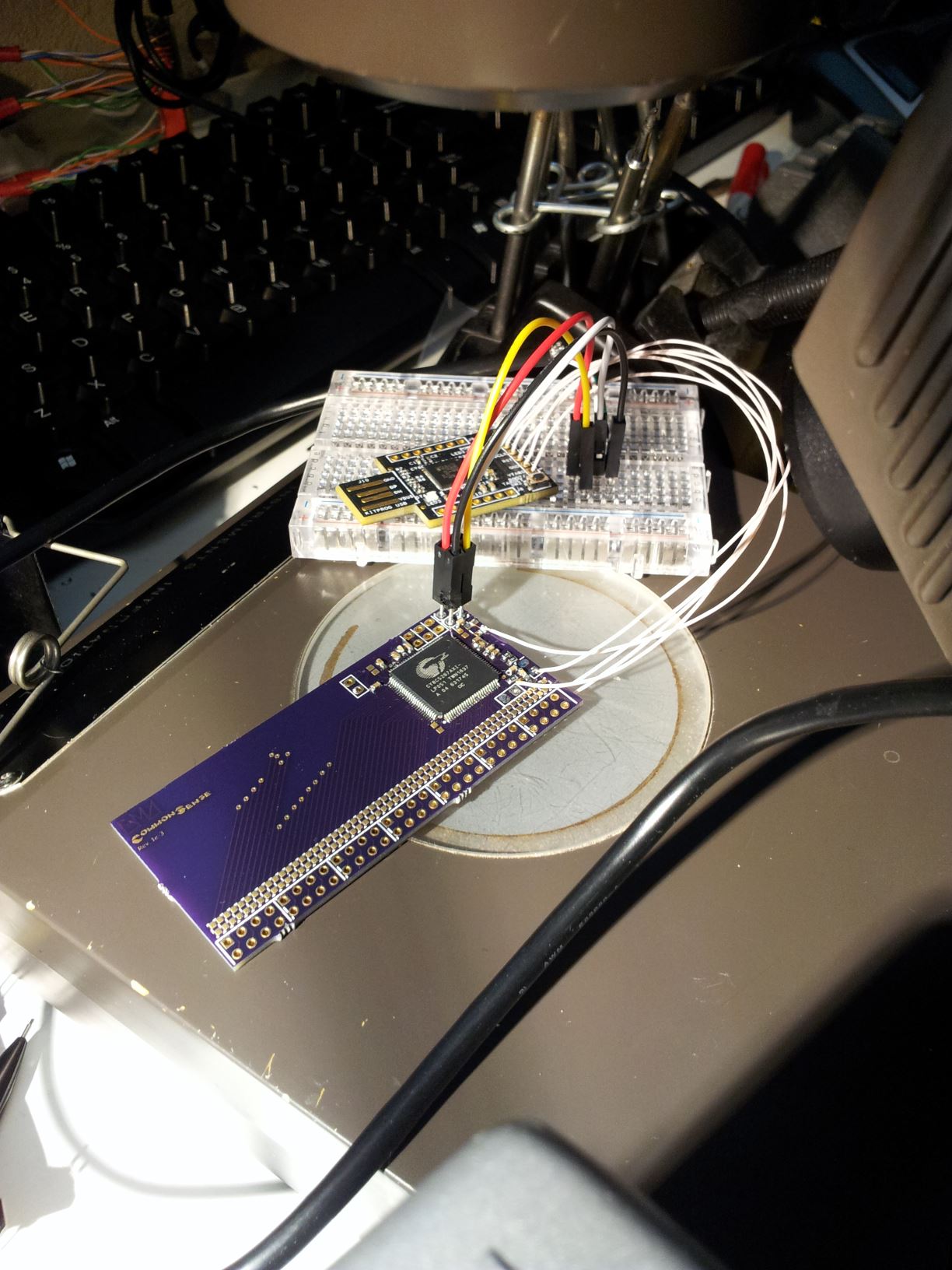

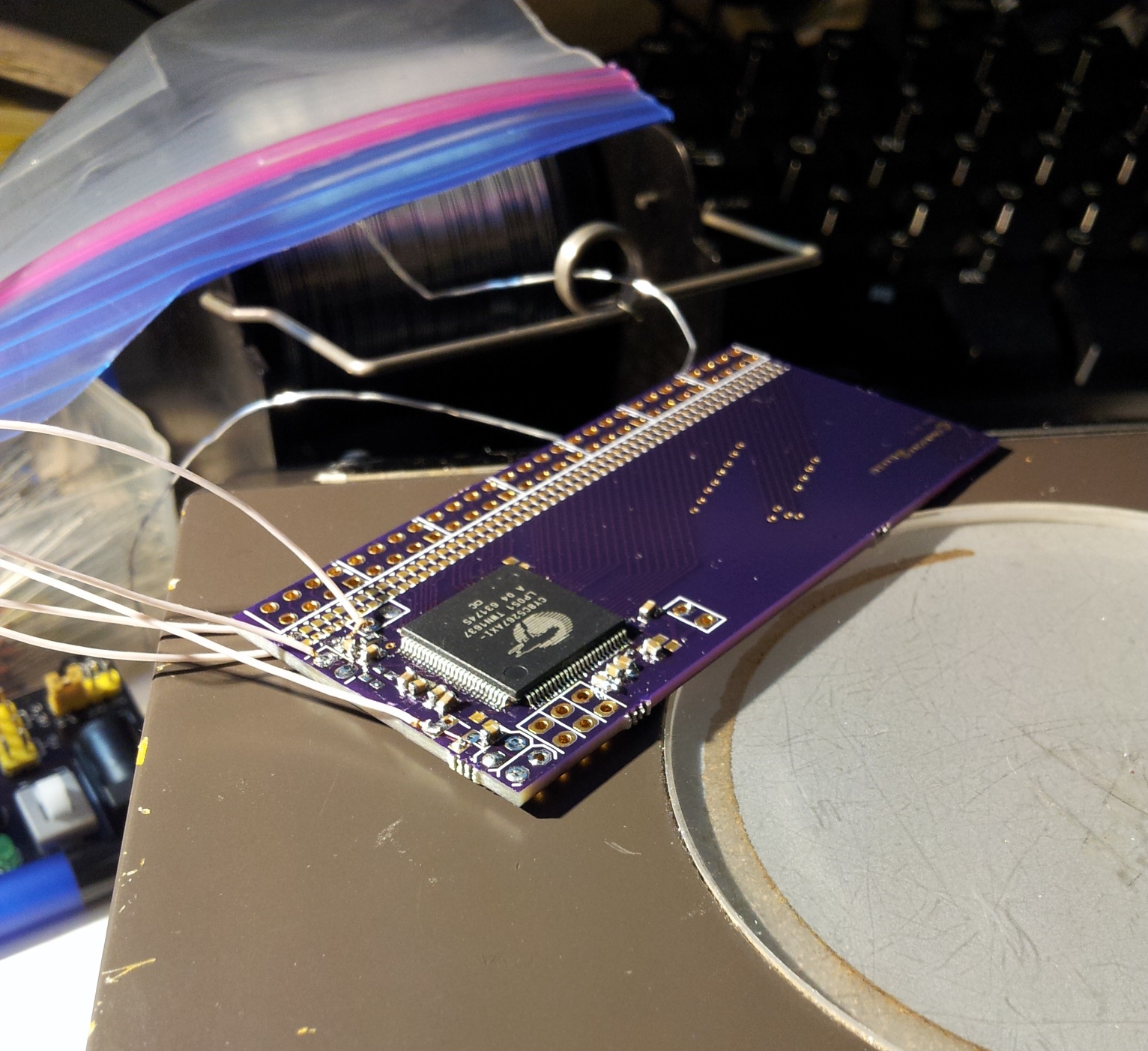

DMA
03 Feb 2017, 07:46
Device 'PSoC 5LP CY8C5267AXI-LP051' was successfully programmed at 02/02/2017 22:28:56.
This thing is surprisingly picky about quality of the juice. 7 capacitors is the bare minimum it wants to be programmed.
Boy I hate myself for choosing 0603 over 0805 SMD parts.
Butbutbutbut! I have USB bootloader flashed. Just need to solder USB on.
hbar
03 Feb 2017, 08:08
DMA wrote: ..and already soldered one chip 180 degrees of what it should be. Too nervous :(
Don't worry, some flux and a hot-air gun will do the job. I've done it all in the past (soldered a QFP the wrong way, more than once -- after all, your chance of getting it right is one in four unless you think beforehand).
Good progress though, I wish I were that far.
DMA
03 Feb 2017, 10:53
It's an USB cable.
We call this "rabid prototyping". Like all good things, it comes at a cost. HUGE cost.
And this is when you order 200 pins, but zero sockets. But you have a breadboard. And a basic arduino kit you bought when that radioshack liquidated their store across the street.
It actually works - USB, bootloader, firmware. Host utility talks to it. It even senses something if you poke those gold contacts with your fingers.
Tomorrow it would finally be time for !!SCIENCE!!.
That row of square pads supposed to have resistors soldered on. I have 100R, 1K and 10K ones - will see how it affects sensing - especially sensing of noise.
Will also try to solder antiparallel diode pair clipper between sense lines and ground to see how that helps with spikes.
All of this will 99% will not go in production, because controller with that will cost twice as much and will have _HUMONGOUS_ PCB, and will only help this guy (and prevent potentially-controller-killing static buildup on sense lines - though I hope that on-chip protection diodes will cover that).
Also need to look at current consumption - if it's low enough, may be it would be worth slapping battery and BT module on.
So. Any volunteers to loan me a beam spring keyboard for a couple of weeks/a month (ideally Feb ~25 to Mar ~7, I won't have much time later :( ) in exchange for the group buy not being model-F-controller-only? Don't worry, you'll get it back :twisted:. With an s/n #0, autographed(if you so desire) beam spring controller even - for your type of beam spring, that is.
The worse it works with existing controllers the better.
I'm in Seattle. Can pick it up and drop off in a reasonable radius (~up to Bay Area). Otherwise you pay shipping and insure it for whatever you feel like. I'm starting to worry a bit about the cost of all this endeavor and shipping hunk of metal that large is ought to be expensive.
If there will be no volunteers - well, there will be no modern beam spring controller 8-)
The hardware will be opensourced as soon as I redraw it in KiCad (making it less hairy than it is now) - because friends don't let friends use altium circuitmaker.

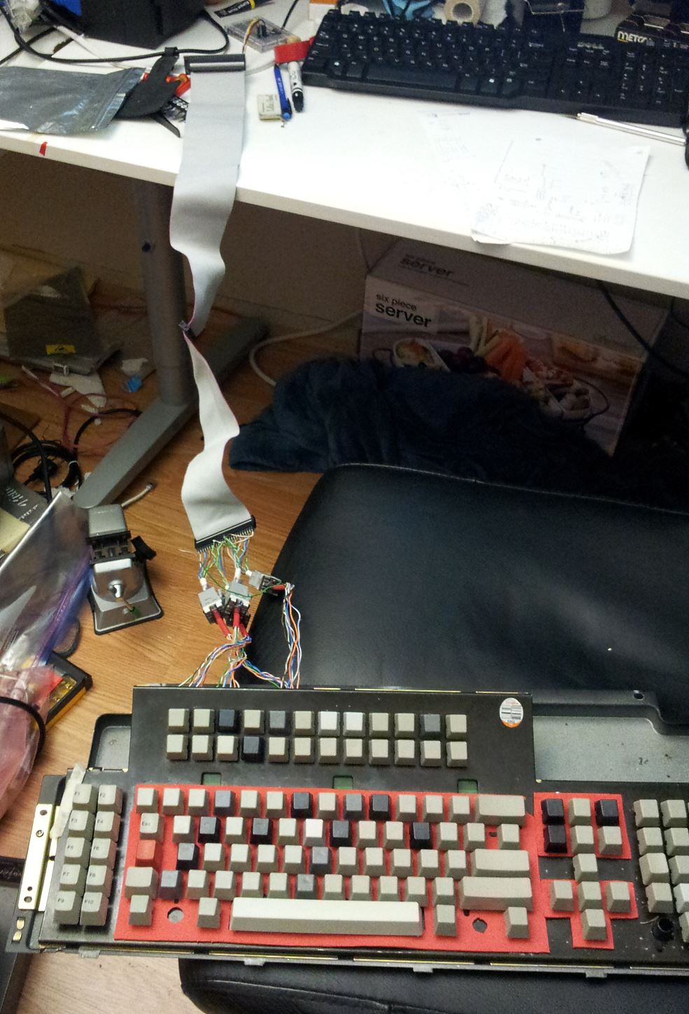

3 feet of horror.jpg (201.46 KiB) Viewed 10914 times
At the end of this vintage 2ft SCSI-2 cable made by "HUNG FU ELECTRONICS CO., LTD" lies the CommonSense controller rev. 1e-3.
It's working.
With 1 feet of the cable-to-keyboard wires and a LED dimmer wire lying under it, it's pretty impressive that the output is pretty stable.
It looks right now that differential signalling is not that much different from single-ended. Resting state is a bit below zero for the most of the keys. Level distribution is practically the same (only negated, so top-left has a hole now instead of the hill) - except couple of keys that look like they stuck in pressed state - only when you press them they go even higher.
The PCB was laid out by some idiot who arranged 8-pin parts of the connector in 4-6-2-1-3-5-7 order (i.e. yours truly). Took best half of the day to figure out pin mapping which is not a rats' nest and yet allows columns 0-8 to go to ADC0 and 9-17 to ADC1 (otherwise there wasn't enough analog buses - analog part of the chip has left and right halves internally, so there's AMUXBUSL and AMUXBUSR. They can be connected together if needed, but only one ADC can access the bus. This is baked in at design, so one needs to be careful).
Anyway, 3 resolderings and countless number of mouse clicks (because one can't edit schemata as text files, it's GUI-only) later..
Tomorrow is scoping time! For some reason I still feel excited every time I boot up the scope.
DMA
06 Feb 2017, 07:53

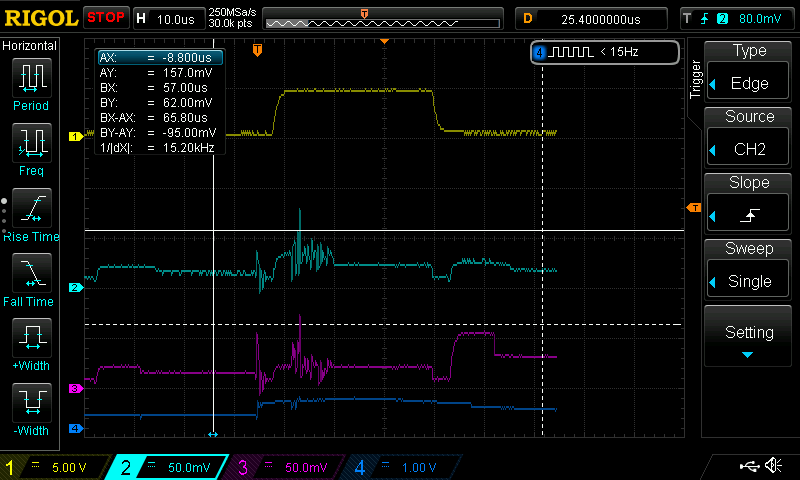

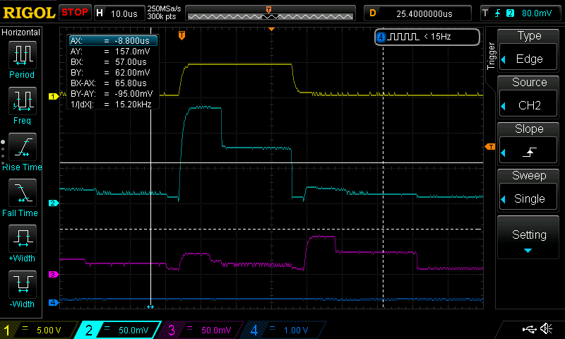

Scope day log.
Diff sensing offers no significant advantage over SE in impulse noise immunity. Diff sensing with _N lines grounded at keyboard side is indistinguishable from SE.
If you try to read over 1m of ribbon cable you will only read zeroes - because the negative conductor will equalize with positive (there will be something on both - it's just *_P and *_N will have the same potential). SE works just fine - SNR is a bit worse because of cable capacitance, but otherwise..
Diff sensing presents it's own set of problems - rows 9 and 10 got very low differential signal on my set despite equal practically everything with rows 8 and 11, for example. SE is juuuust fiiine - and the difference is only firmware, specifically AMUX and ADC input configuration.
You can actually only ground chassis and leave PCB earths not connected - doesn't make any practical difference. Well, ground state will fluctuate a tiiiiiiny bit more there will be small amount of charge leaking to adjacent keys (negligible I'd say), but otherwise everything will stay the same.
Removing all those ground conductors will make routing easier. Unfortunately, single SSK-sized PCB is EXPENSIVE to produce, so feasibility of it will forever remain a mystery. However, I can scrape the existing F122 board as an experiment.
Because of the above I suspect that adding foam under the PCB will make SNR worse - will try to verify when my MF arrives. Because suspending the board in foam might help keep the noise down.
IIR 7/8 filter works pretty well. 3/4 also works fine unless you touch the cable with dimmer wire (7/8 shows some resilience even in those pretty harsh circumstances - it starts depending on the place on the ribbon).
So about the only way to improve immunity with long cable is to run a special sense line somewhere in the sense cable, scan it (syncronously!) by a separate ADC and discard the result if you read _anything_ on that special line.
Because 0.5us spike is all it takes, and it vanishes immediately - previous and next lines are completely unaffected.
It's better to have separate drive and sense cables for purity reasons, but you can even interleave them - it will just affect the ground state levels. For example, if you route drive 5 with sense 3 - you will have elevated (5, 3) cell level. For both states. Activation delta will be about the same, both levels FAR from 2V so wont' saturate anything.
Might as well start designing production PCB. Will wait for my MFs to arrive though so that prototypes are easier to test-fit. Also it looks like I'll have a 3277 and may be another beam spring specimen loaned to me, so there will be a beam spring version. If that loan pans out.
