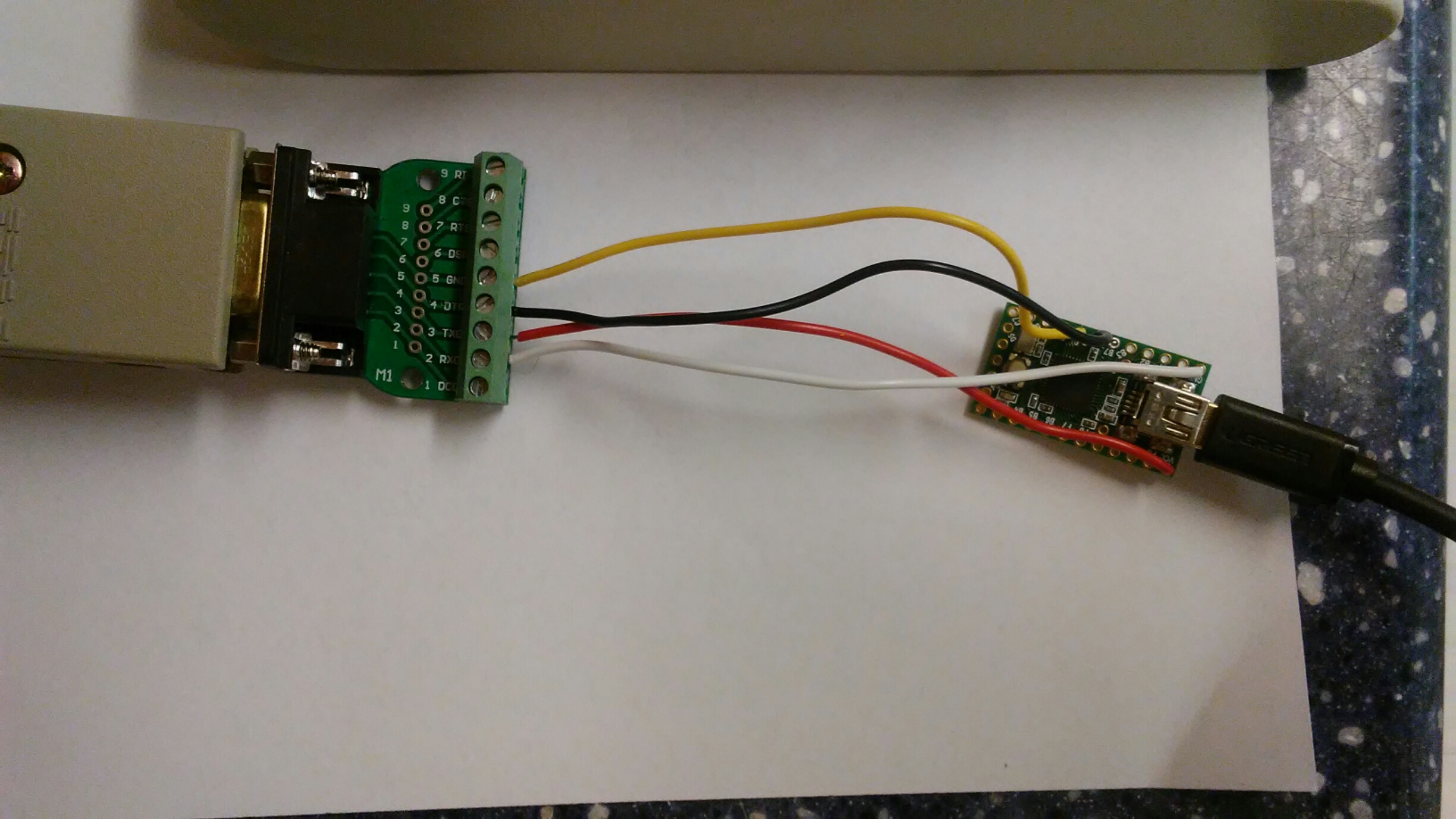

Here's my Teensy->DB9 wiring. Warning: amateur solder job:
Unfortunately, one of the wires has already snapped :cry:
I'll definitely post pics of the keyboard when it's all prettied up- right now it just looks like a plain Pingmaster.

__red__
23 Apr 2017, 19:59
Some soldering advice:
0) You want less exposed metal when you're soldering as they can touch each other and bad things can happen.
1) You don't want to solder the socket while plugged into the plug as the heat will transfer between them and melt the joint inside the plug.
2) That type of solder joint on the socket is lovingly referred to as a bucket joint. Fill it. You want good, fluxy solder and fill it. If I can find one handy later this afternoon I'll solder one up so you can see the technique.
You got it working, that's 99% of teh battle. Now you just need to decide how to deal with mechanical stress. Strapping it down to something solid with cable-ties is probably the easiest to start with and then as you get more experience and/or have your own preferences you'll make up your own.
I'm partial to cable-lacing as you may have seen in my previous images...
https://www.google.com/search?q=cable+l ... 60&bih=537

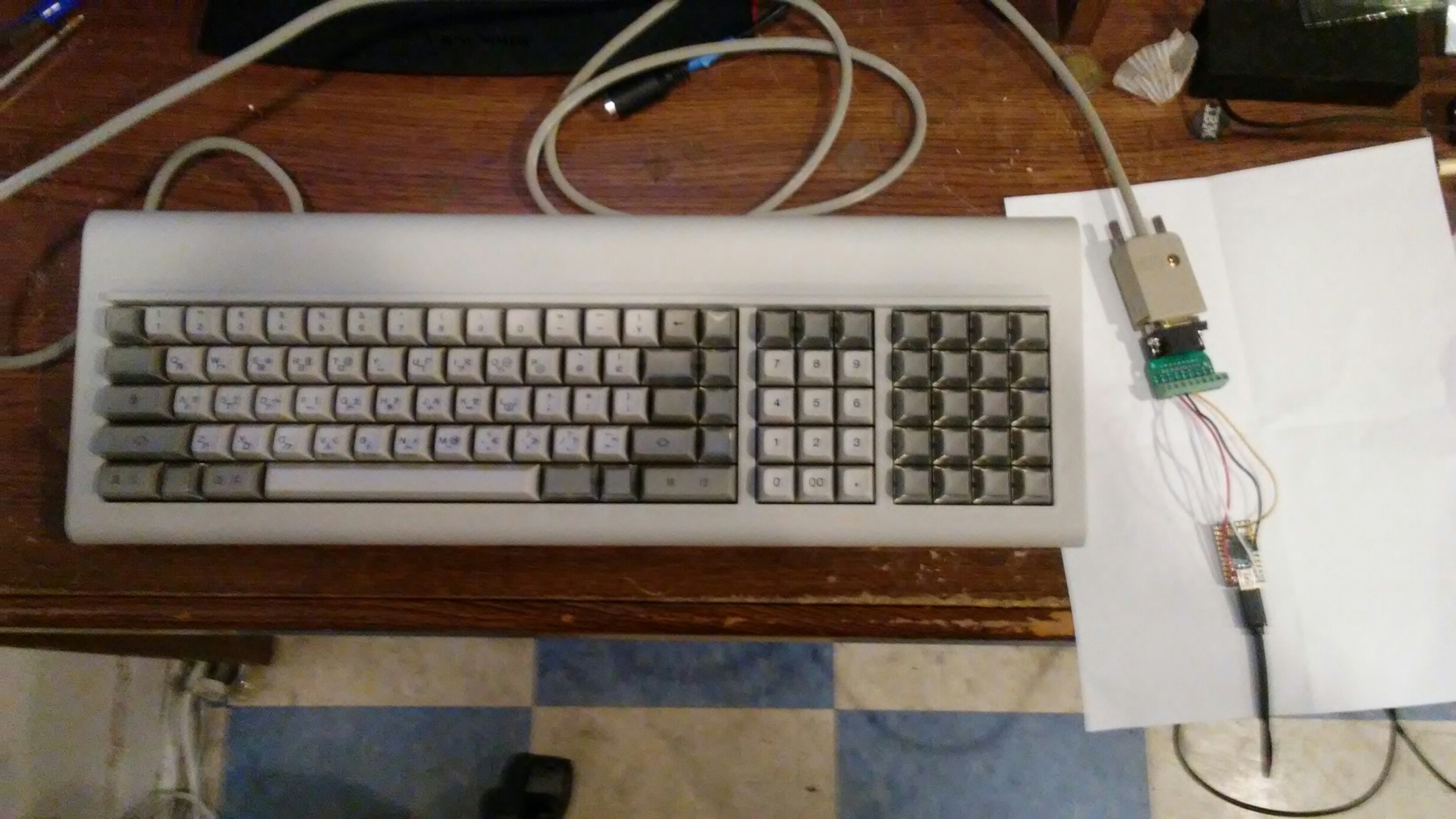

just_add_coffee
23 Apr 2017, 20:39
__red__ wrote: Flash the firmware I gave you and try again. Let's at least see if we can determine if it's a software or hardware problem.
Done. Still getting FB and 7B for that row 4, last column key. I haven't seen the other issues yet.
__red__
23 Apr 2017, 20:41
Show me the key you're talking about... point at it for me.
Found it.I get the exact same code.
What's the problem? Are you having problems assigning an action to it?

just_add_coffee
23 Apr 2017, 20:55
__red__ wrote: Show me the key you're talking about... point at it for me.
Yes. Even your hex file doesn't seem to reassign the key.
