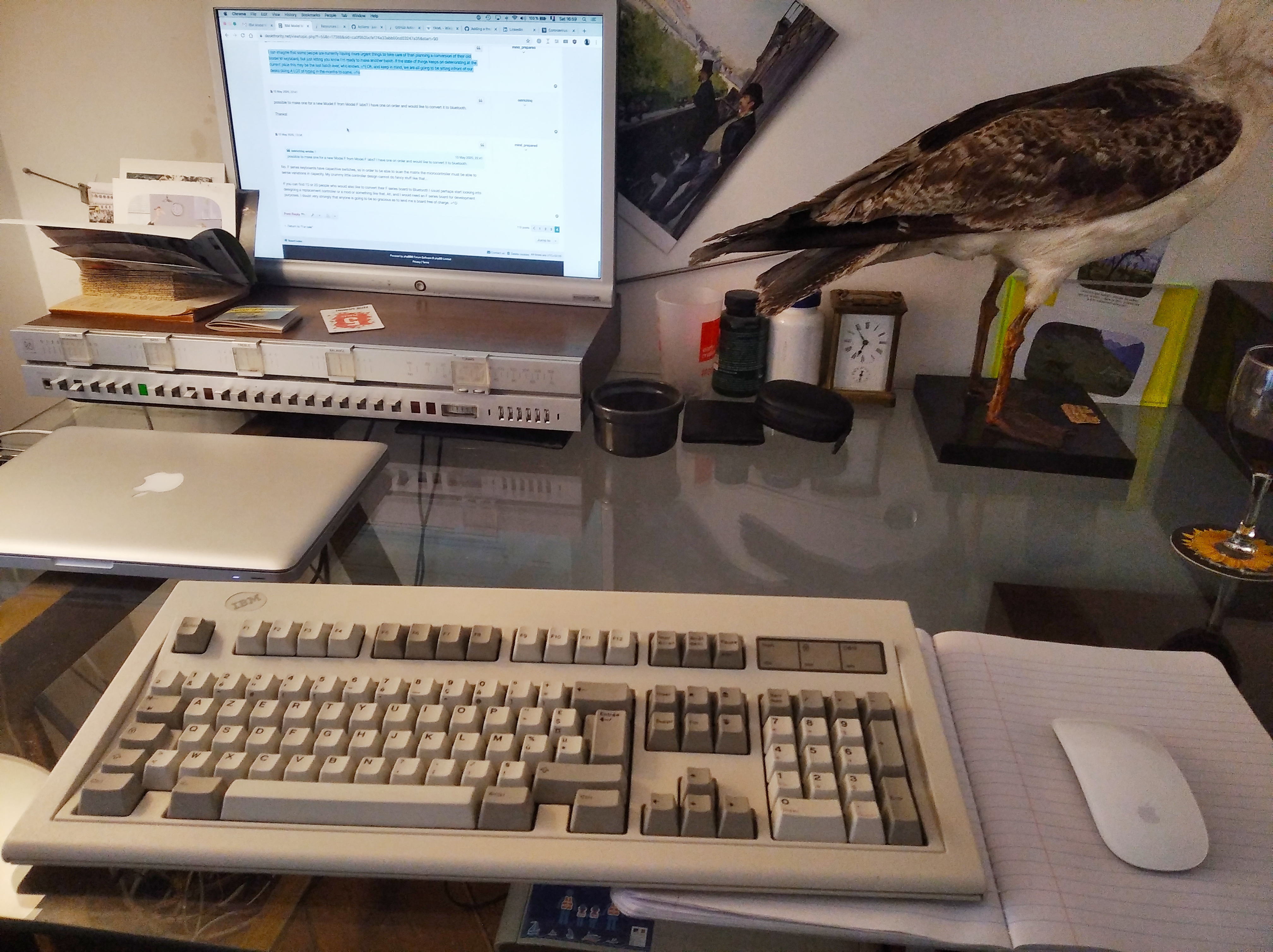

juanitito
- Location: Paris
- Main keyboard: IBM Model M BLUSB
- Main mouse: Apple mouse thingy
Hello,
I wanted to write a quick testimonial. This kit is great, easy to install and works flawlessly. On mac os, after a bit of mapping with Karabiner it is perfect! Jôrn has been super helpful and helped me with every issue I faced. Do yourself a favor, buy one!
- IMG_20200609_191611.jpg (4.52 MiB) Viewed 26473 times
