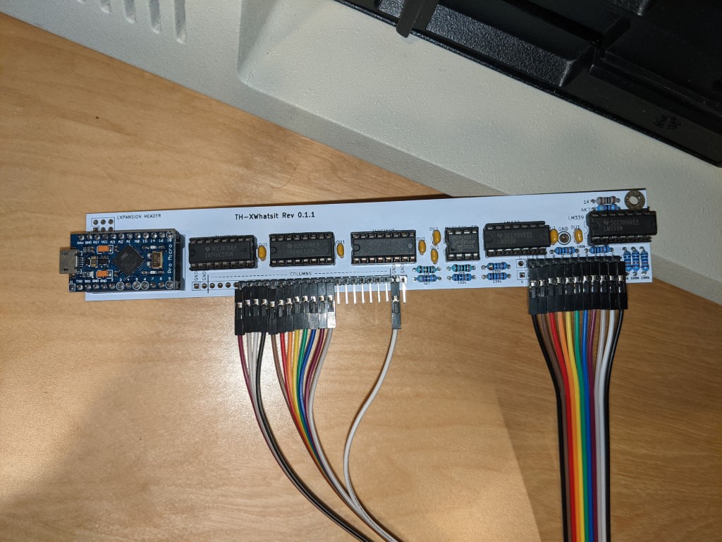

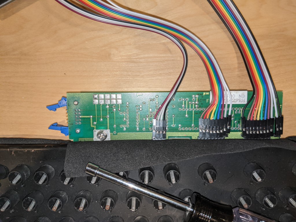

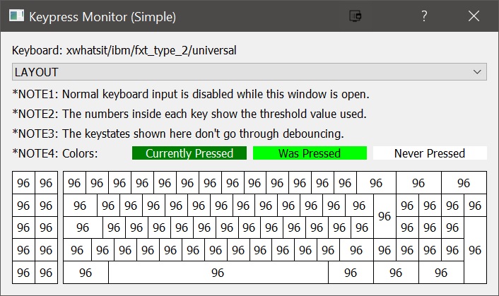

hupshall
06 Dec 2020, 05:38
Here is the screenshot of the Keyboard monitor:
Here is a picture of the controller:
PXL_20201206_043425595 (Medium).jpg (238.13 KiB) Viewed 3998 times
Here is a picture of the PCB
PXL_20201206_043409755 (Medium).jpg (272.35 KiB) Viewed 3998 times
I have good continuity of ground throughout the setup.
pandrew
06 Dec 2020, 05:57
hupshall wrote: 06 Dec 2020, 05:38 Here is the screenshot of the Keyboard monitor
Please send a picture of the "Signal Level Monitor". It's a different button in util.exe, and please press a few buttons too, slowly, and see if it changes.

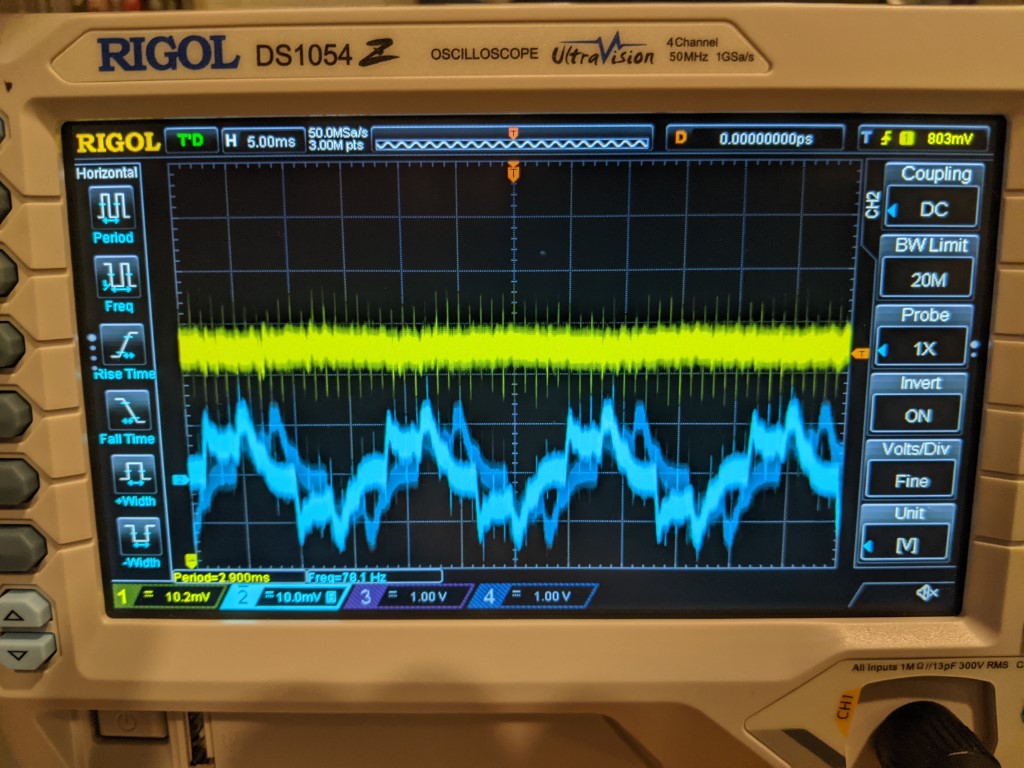

hupshall
06 Dec 2020, 08:08
ok, I hooked up my scope. CH1 is on Row 1, CH2 is on Column 1
Here is a steady state capture:

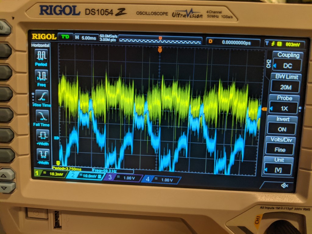

Here is with my finger pressing down on the pad which would be F1:

So the PCB is at least responding..
