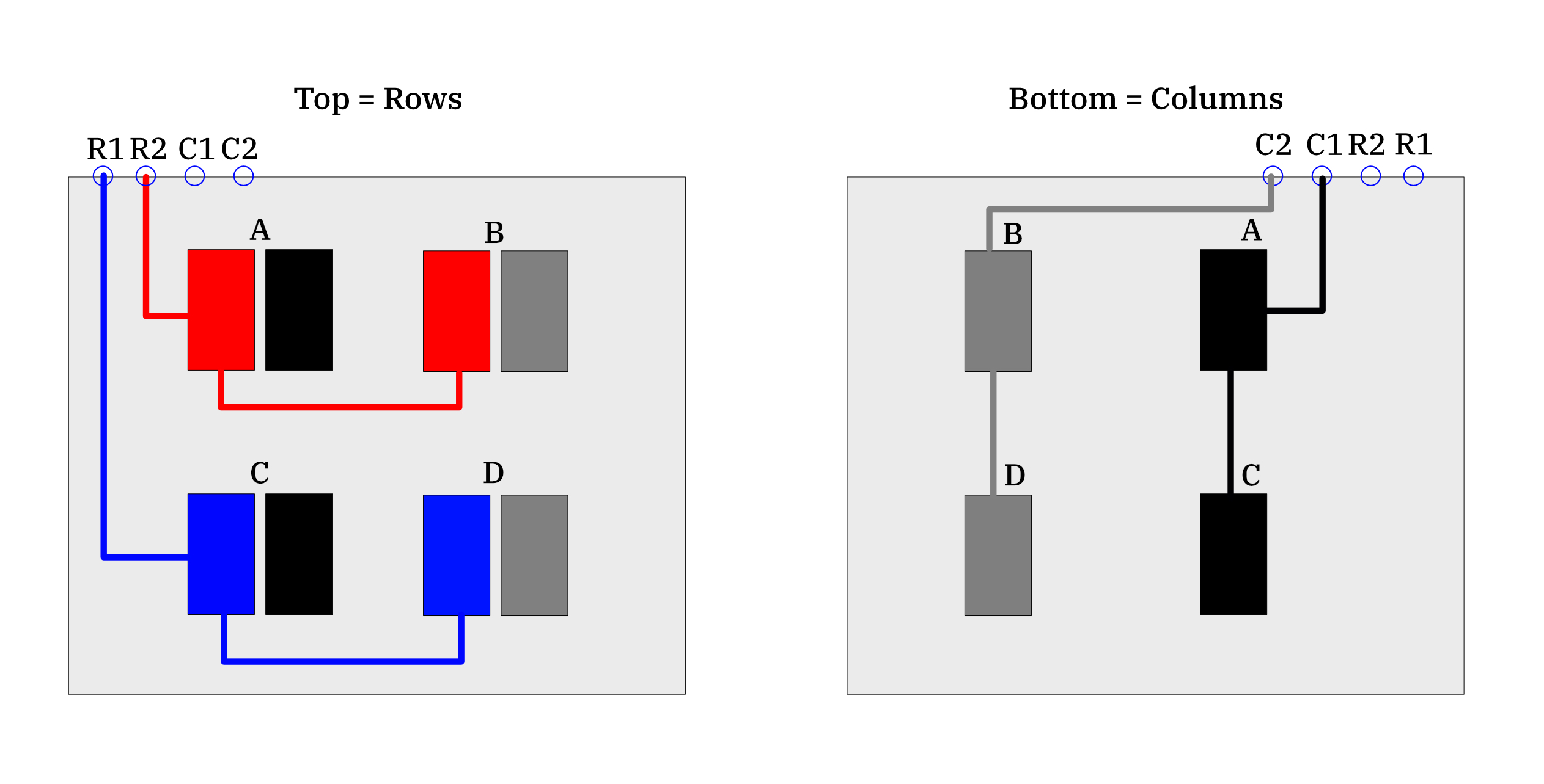

I need technical help to explain (in approximation) the sensing of the capacitive PCB.
To make it easier, I have created a 2x2 matrix with sensing pads on the backside and front side as shown in the picture below.
I want to describe how the sensing would work, if
* key A is pressed
* keys A and B are pressed
* keys A and C are pressed
* keys A, B, D are pressed
What I have read, I would interpret it as sending a pulse current through column C1 and measure capacitance on R1, R2, then send an impulse current through Column C2 and measure then start from R1 again (and doing this 100 times a second). This might be completely wrong, please correct me.
Re: Model F Technical Manual Project
Posted: 23 Oct 2020, 22:17
by Zcool31
Your intuition is about right. The controller sends a pulse on C1, then measures R1 and R2 at the same time. All the Rs are connected to different pins, so they are measured in parallel. Then the controller turns off the C1 pin, sends a pulse on C2, and measures R1 and R2 in parallel again. All the Cs are also connected to their own pins, distinct from the pins to which the Rs are connected. The whole cycle, [C1, C2], repeats 100 times per second.

Zcool31 wrote: 23 Oct 2020, 22:17 Your intuition is about right. The controller sends a pulse on C1, then measures R1 and R2 at the same time. All the Rs are connected to different pins, so they are measured in parallel. Then the controller turns off the C1 pin, sends a pulse on C2, and measures R1 and R2 in parallel again. All the Cs are also connected to their own pins, distinct from the pins to which the Rs are connected. The whole cycle, [C1, C2], repeats 100 times per second.
Thanks! Find attached the 4 pages I wrote around it. Mostly contains graphics that show (in my super high level variant) how the matrix sensing roughly works.

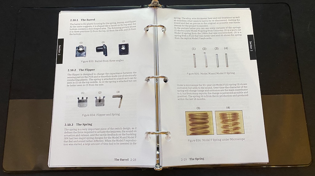

I've uploaded 0.5.16 today with many updates in section 4 (4.8ff) and corrections throughout.
https://www.bucklingspring.com/downloads/
The printout of the first 150 pages for the binder came out quite well, imho. More to come:
