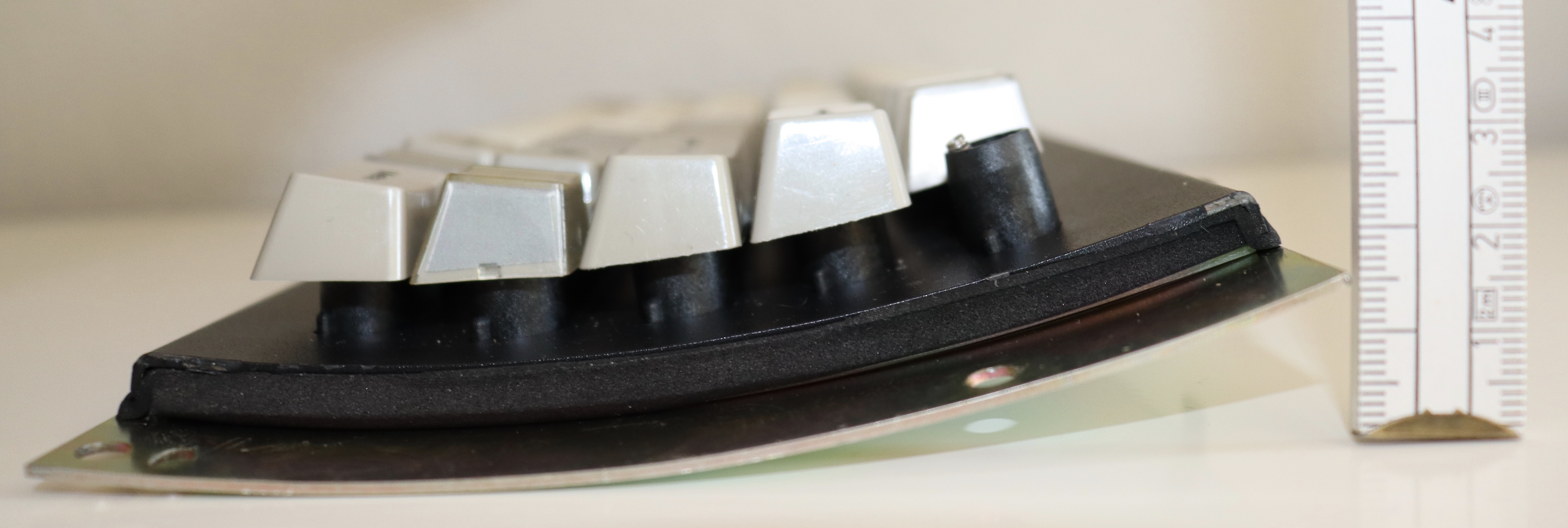

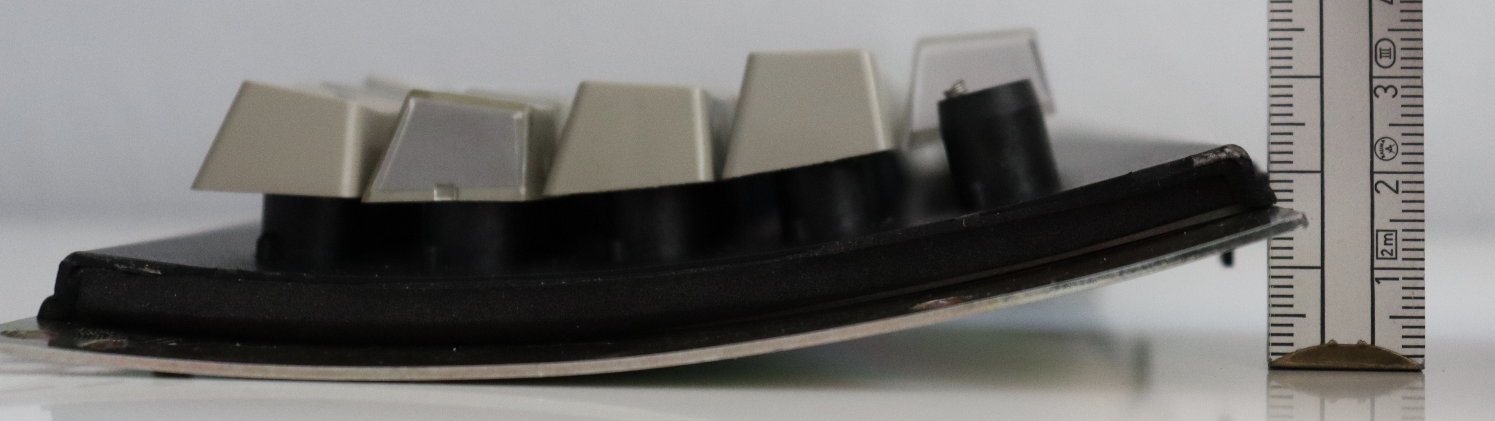

darkcruix
25 Aug 2020, 10:15
Zcool31 wrote: 24 Aug 2020, 20:55 ...
Professional? I wouldn't go that far.
Compared to what I do - definitely!

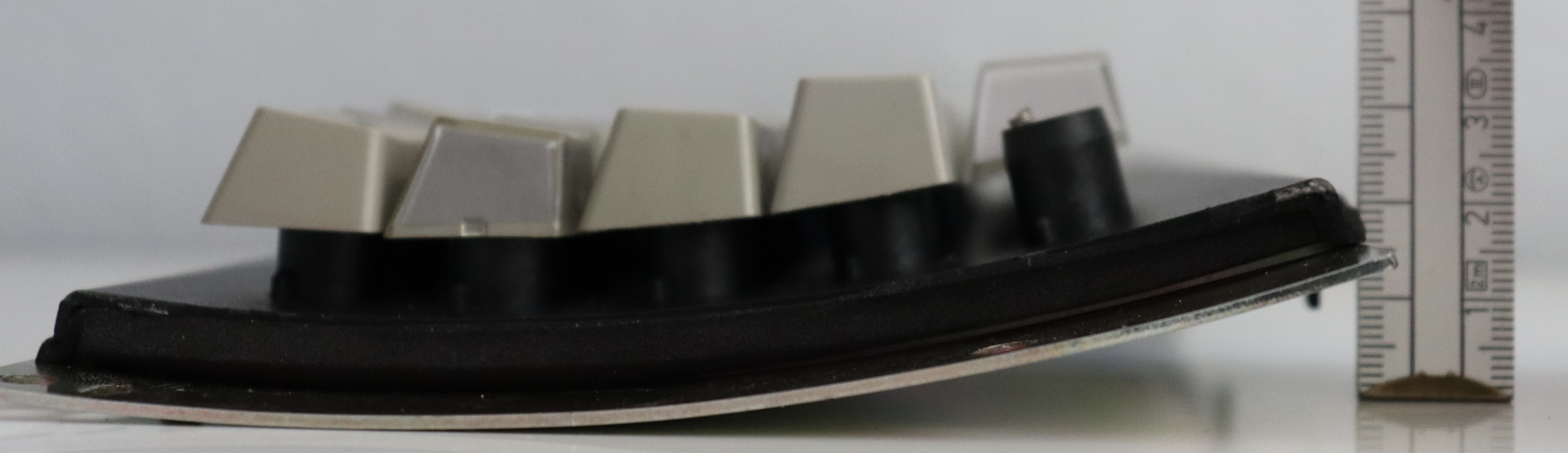

What would really help are direct staright-on photos of the case and the barrel plate, such as these, but with a ruler.
https://geekhack.org/index.php?topic=68550.0
It would also be great if that photo could have at least one of the keycaps removed. Then I could measure the dimensions of the barrels.
Would something like the below photo be of any help?
I measured the curvature of the bottom assembly plate and here are the results:
Arc length: 126 mm
Chord Length: 125 mm
Height: 7 mm
Radius: 283 mm
Zcool31
25 Aug 2020, 12:13
darkcruix wrote: 25 Aug 2020, 10:15 Would something like the below photo be of any help?
Arc length: 126 mm
Height: 7 mm
Radius: 283 mm
That's almost perfect. One minor issue is that the ruler is not co-planar with the edge barrel plate. Due to perspective, this makes the barrel plate and the keys appear smaller on the image. I can adjust for that if you tell me the depth (how much further away are the edge of the barrel plate and the edge of the key caps than the edge of the back plate), and the focal length which which that photo was taken.
How did you measure the curvature?

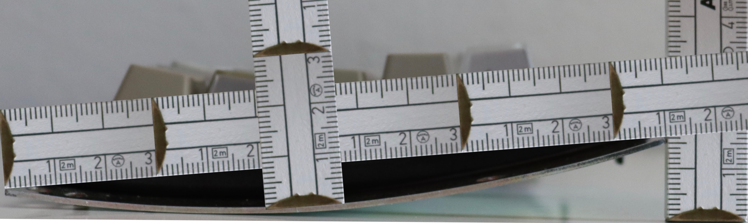

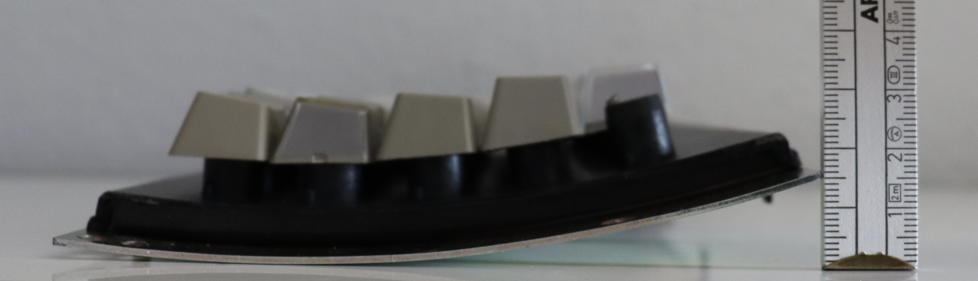

darkcruix
25 Aug 2020, 12:38
It is tough to photograph :)
I tried my very best with the three below. The first has the ruler planar to the edge of the barrel plate, second one planar to the middle of the first barrel row, third planar to the edge of the assmbly plate. To measure the curvature I just drew around the bottom assembly plate and measured the chord length and hight from bottom to the parallel tangent line. Depending on how accurately I measure, I get a radius between 275 mm and 285 mm.
https://planetcalc.com/1421/
Zcool31
25 Aug 2020, 15:05
These are awesome, thank you!
darkcruix wrote: 25 Aug 2020, 12:38 ...
That's exactly the formula I deduced when computing the scoop on all the regular keys and the hump on the space bar.

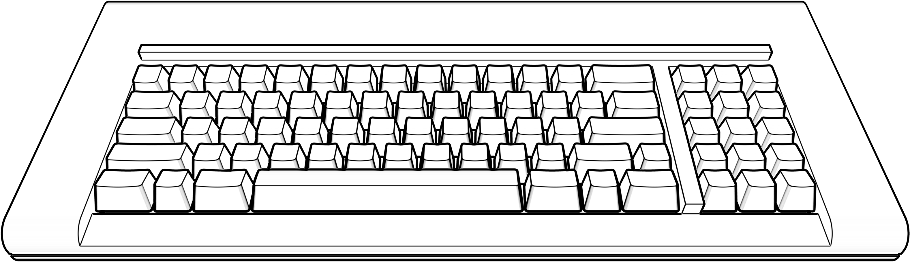

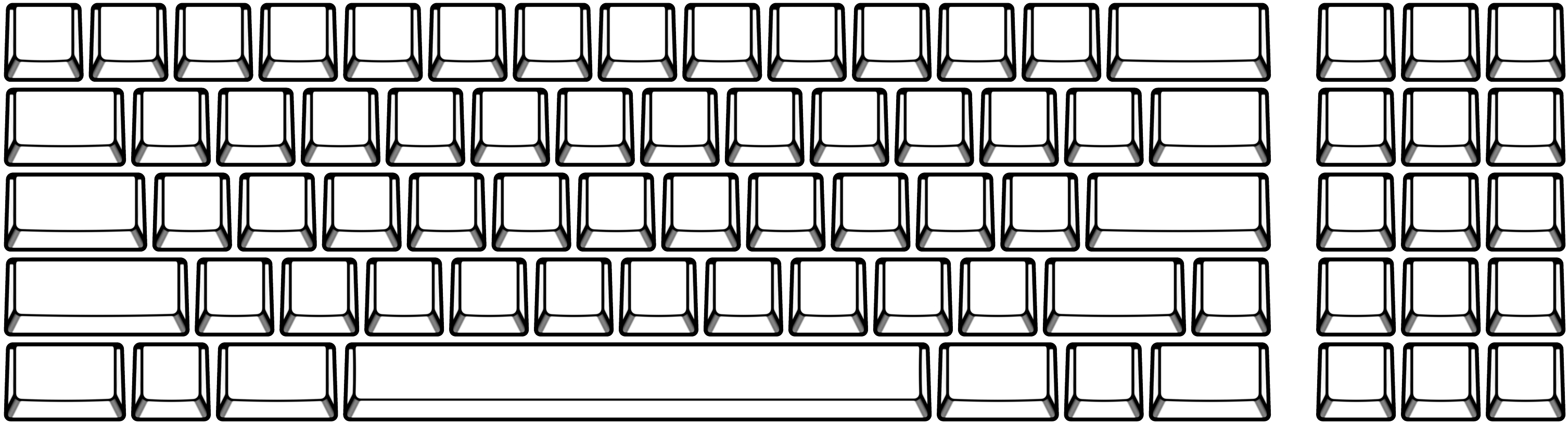

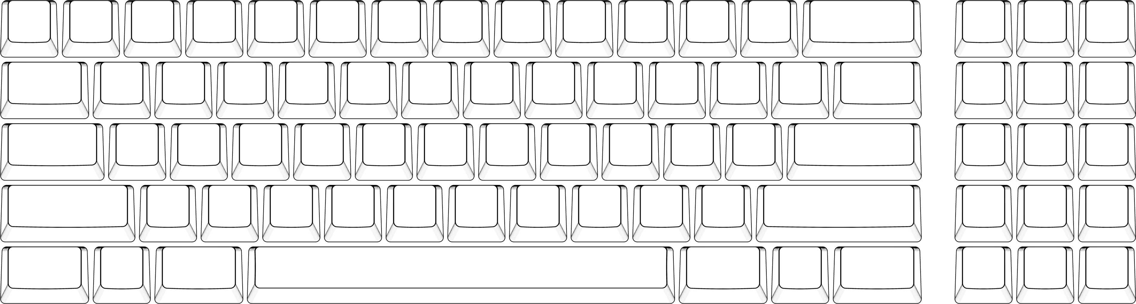

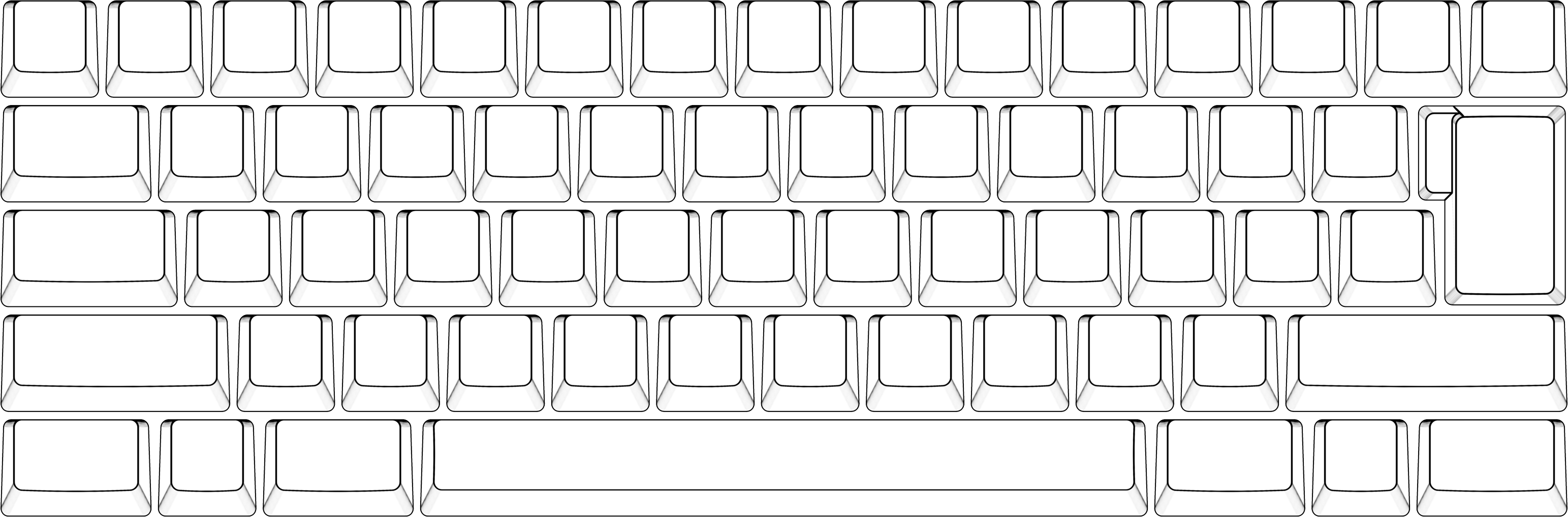

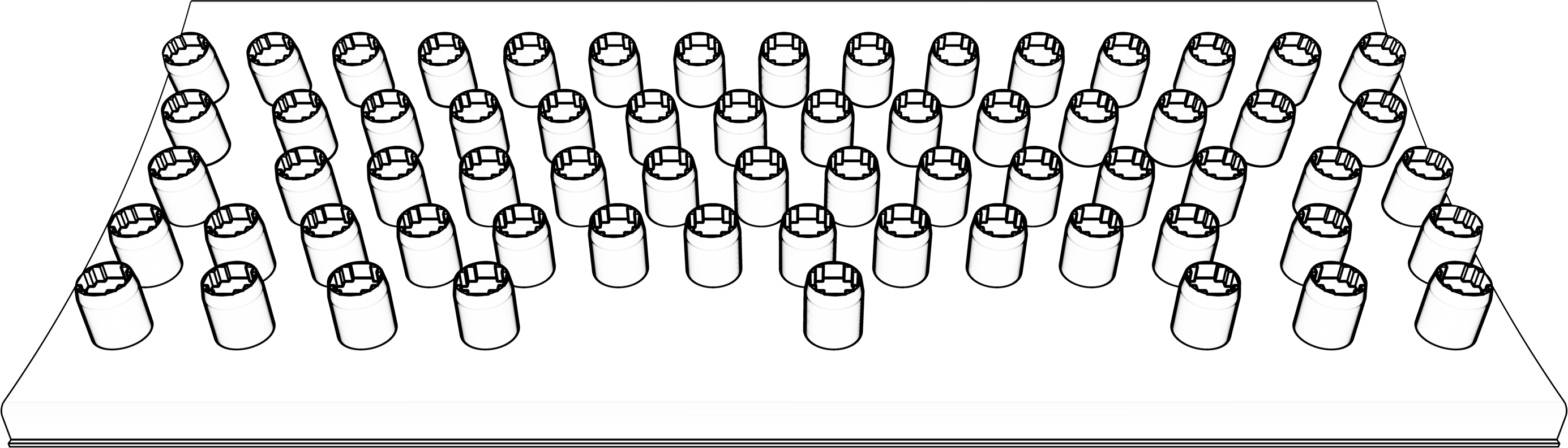

Zcool31
25 Aug 2020, 18:25
Here's the process I used to refine some dimensions.
This is the F77 with more correct case dimensions from your document and more accurate key shapes and plate curvature from your pictures.
Finally, here's an ortho rendering of just the keys. It should have enough resolution for you to zoom pretty close.

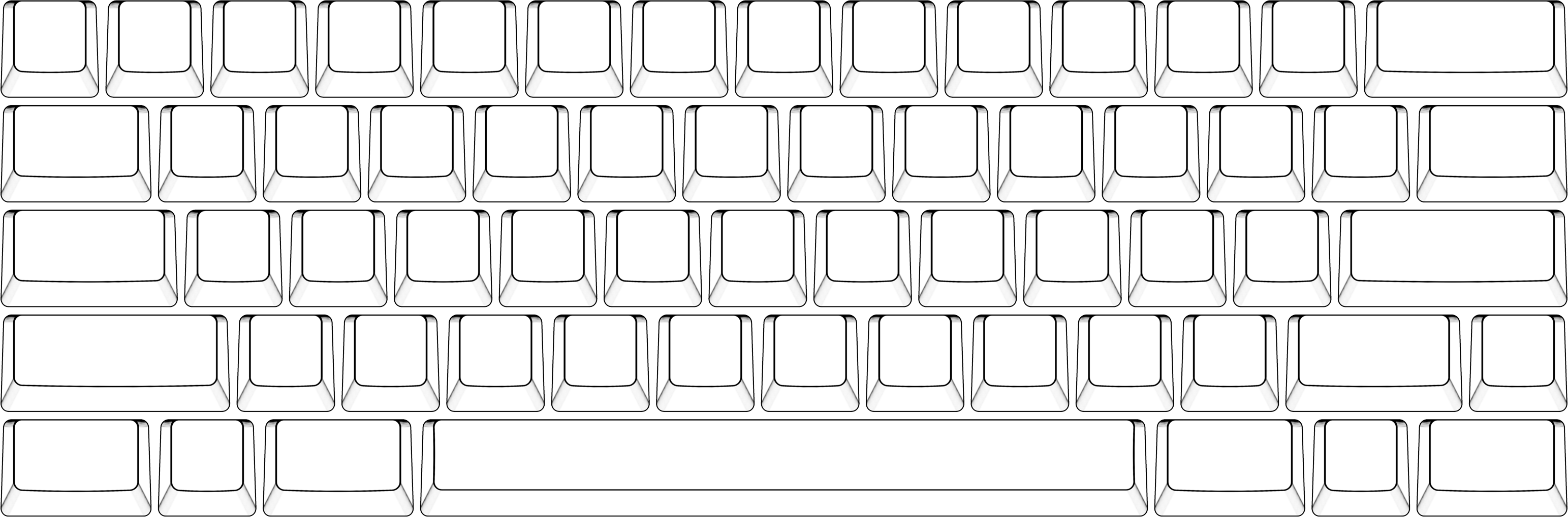

Zcool31
25 Aug 2020, 19:35
Here are the compact cases:

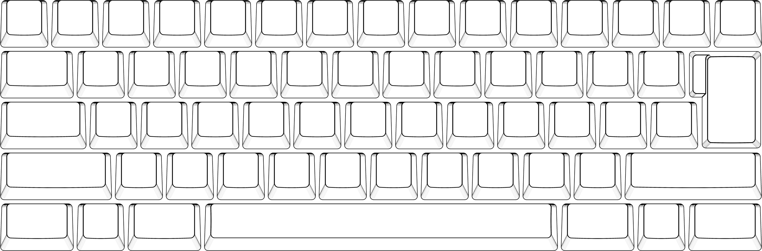

darkcruix
25 Aug 2020, 23:15
And here's for the crazy ones :)
I now have created the keyboard layouts in the Zcool31 - style (and it looks even more beautiful when printed). While I have all the various default split-key configs for ANSI, I would love to get them for ISO as well. A nice render would be awesome. I can still do all the split key things - just need a plain ISO Enter one.
Zcool31
26 Aug 2020, 18:16
Just for fun:
darkcruix wrote: 25 Aug 2020, 23:15 ... ISO Enter ...
Vertical keys are weird. This will take some doing.
Zcool31
26 Aug 2020, 19:57

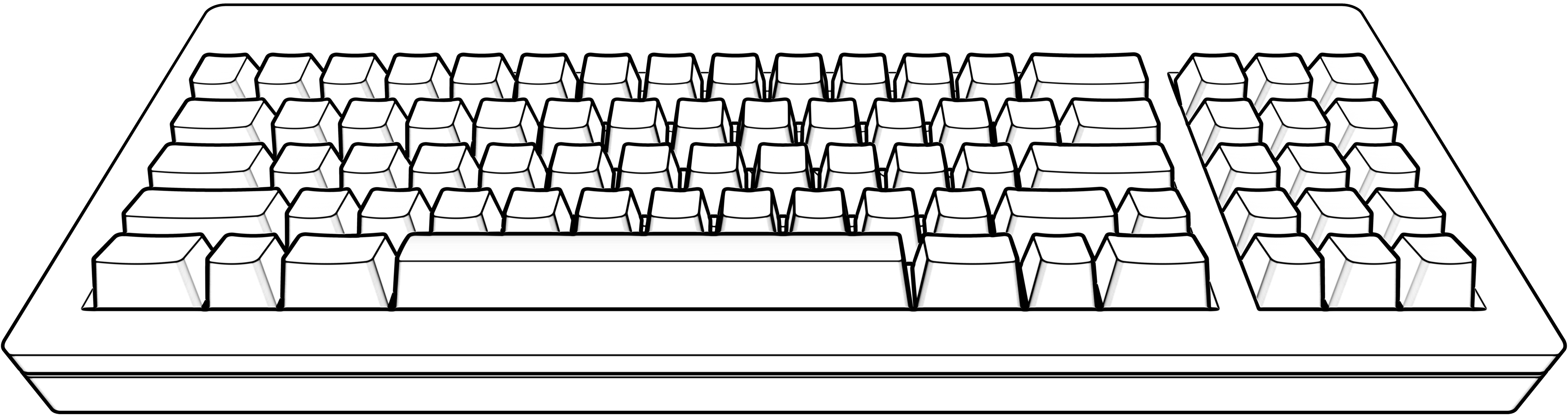

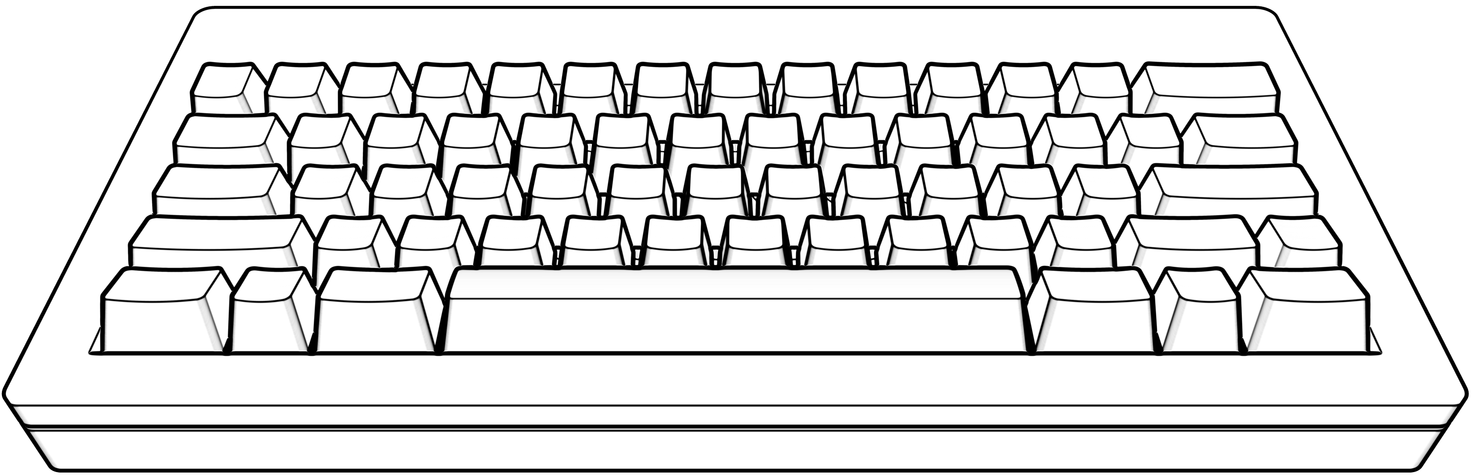

darkcruix
26 Aug 2020, 21:30
Thanks a ton!

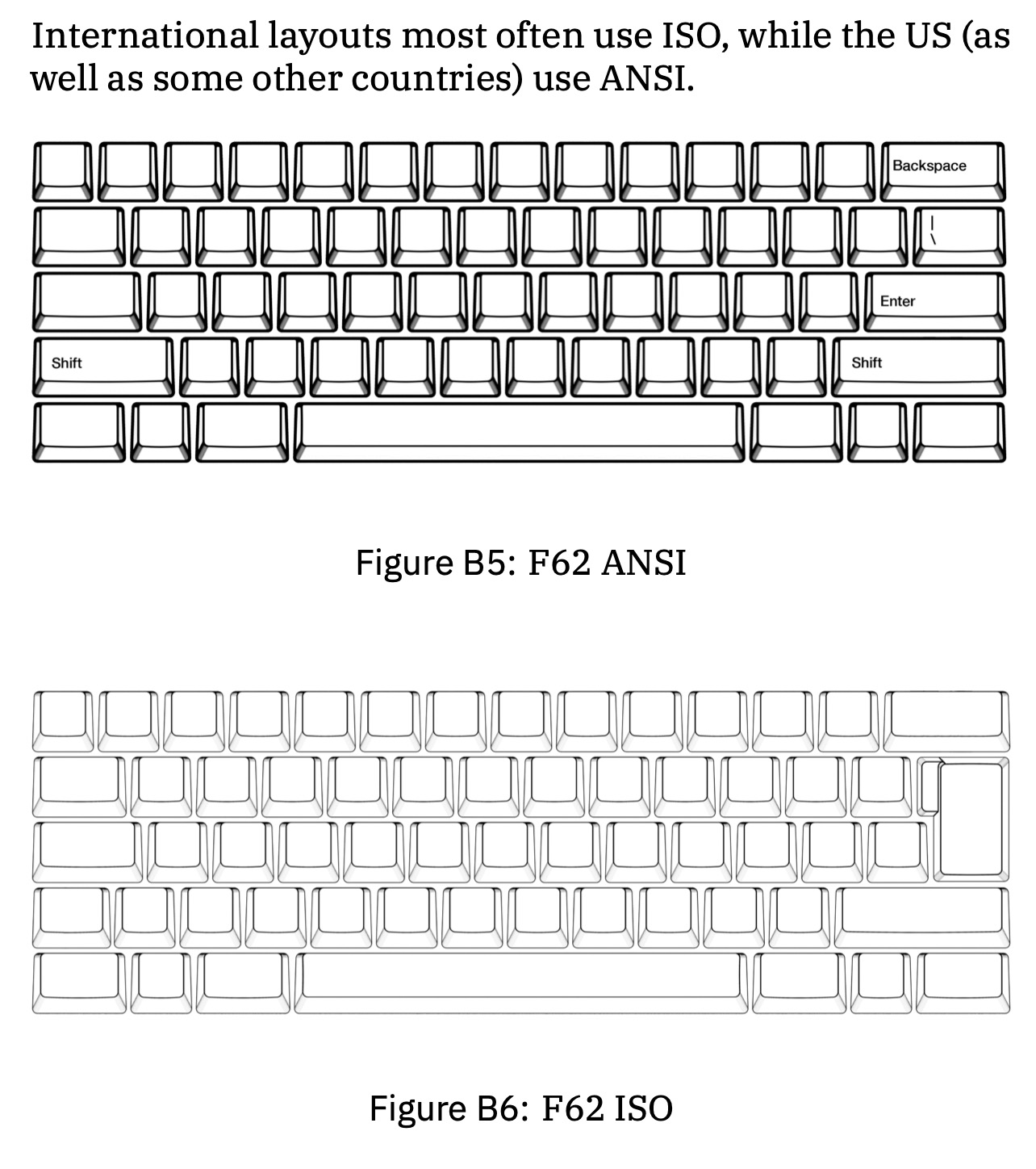

btw: The ISO version is having much lighter lines and feels a bit more subtle. I actually prefer the new style. Can you render the ANSI with the same line width?
Screen Shot 2020-08-26 at 21.28.02.jpg (300.89 KiB) Viewed 19107 times
Zcool31
26 Aug 2020, 22:33
darkcruix wrote: 26 Aug 2020, 21:30 Thanks a ton!
Sure, here are both:
I fixed a minor issue with the ISO enter key. Other than the enter key and different split keys, these pictures should be pixel-identical. You can mix and match ansi/iso split shift/backspace.
Zcool31
26 Aug 2020, 22:42
I didn't forget:

If you look close you can see this model has an extra couple inches on the top bezel, it also has the same feet as the 5251 keyboard instead of the three tiered feet of the bigfoot
