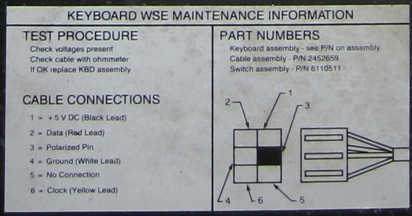

Do you know what the colors would be for the silver tag XT/AT style adapters? I have a few of these and the RJ-45 one was the one that I wanted to try first since it was the only one that didn't have a cut cord. I don't see colors listed on the keyboard babel site sadly.
- Soarer
- Location: UK
- Favorite switch: F

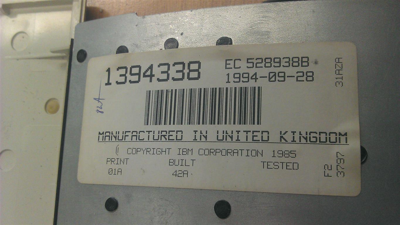

I think they vary... at least, the PC/XT colours are different to the 122-key's.
Let me know exactly which keyboards and I'll check my 'boards to see. Pics of the cable inside the keyboard would help to verify that yours matches mine!
Here's a couple of pics I had handy
Inside a PC/XT keyboard...
Label inside a 122-key Model F...

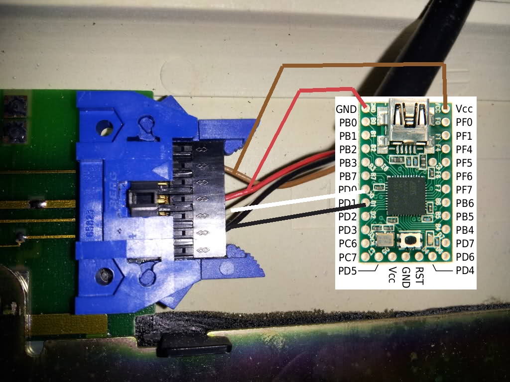

Got mine working but trying to make a USB cable out the original cable.Soarer wrote:
Looking towards the end of the USB and Micro USB ends with the copper traces facing up. I've got the same colour cables and they are in the order Red, Black, White, Brown.
Using normal USB cable everythings fine. Using my botched one the teensy gets very hot very quick!

well typing on it now so no great damage
But would love to know the correct usb pinning for a standard usb to micro cable. Want to reuse the original. Also my layouts not perfect, but as your files iso uk I'll ignore what's on the caps

Teensy has a mini USB socket... wiring. But I should say, even if you get that right I'm not sure how well it will work, because the data wires are intended to be a twisted pair, and they (presumably) won't be in the IBM cable.

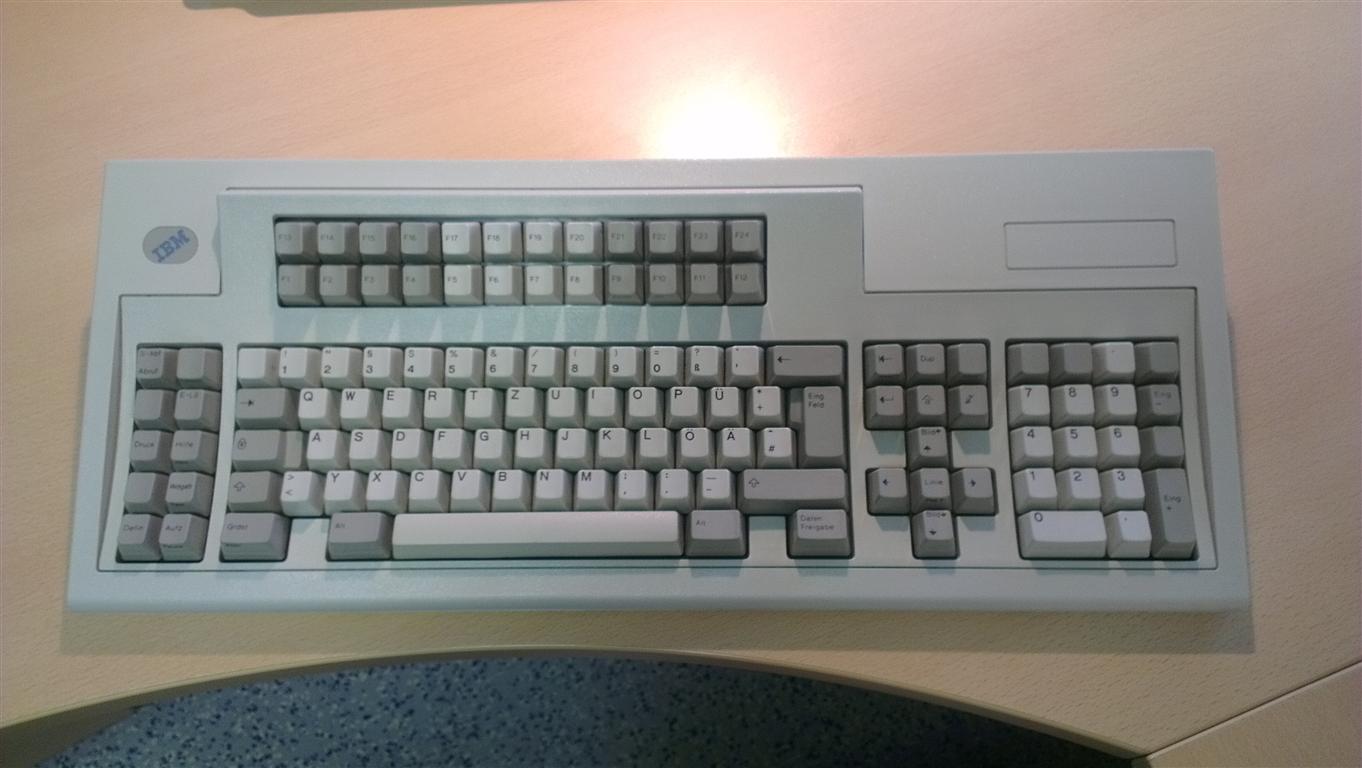

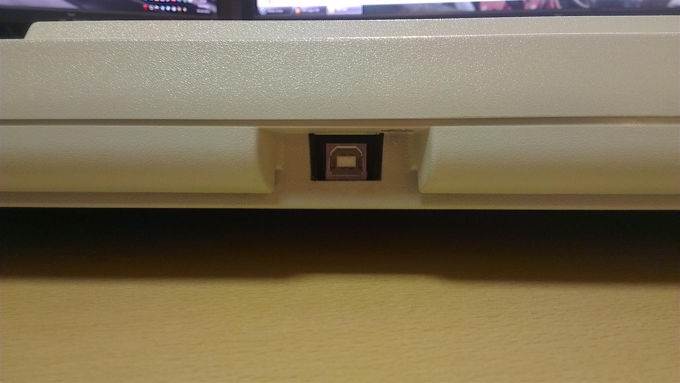

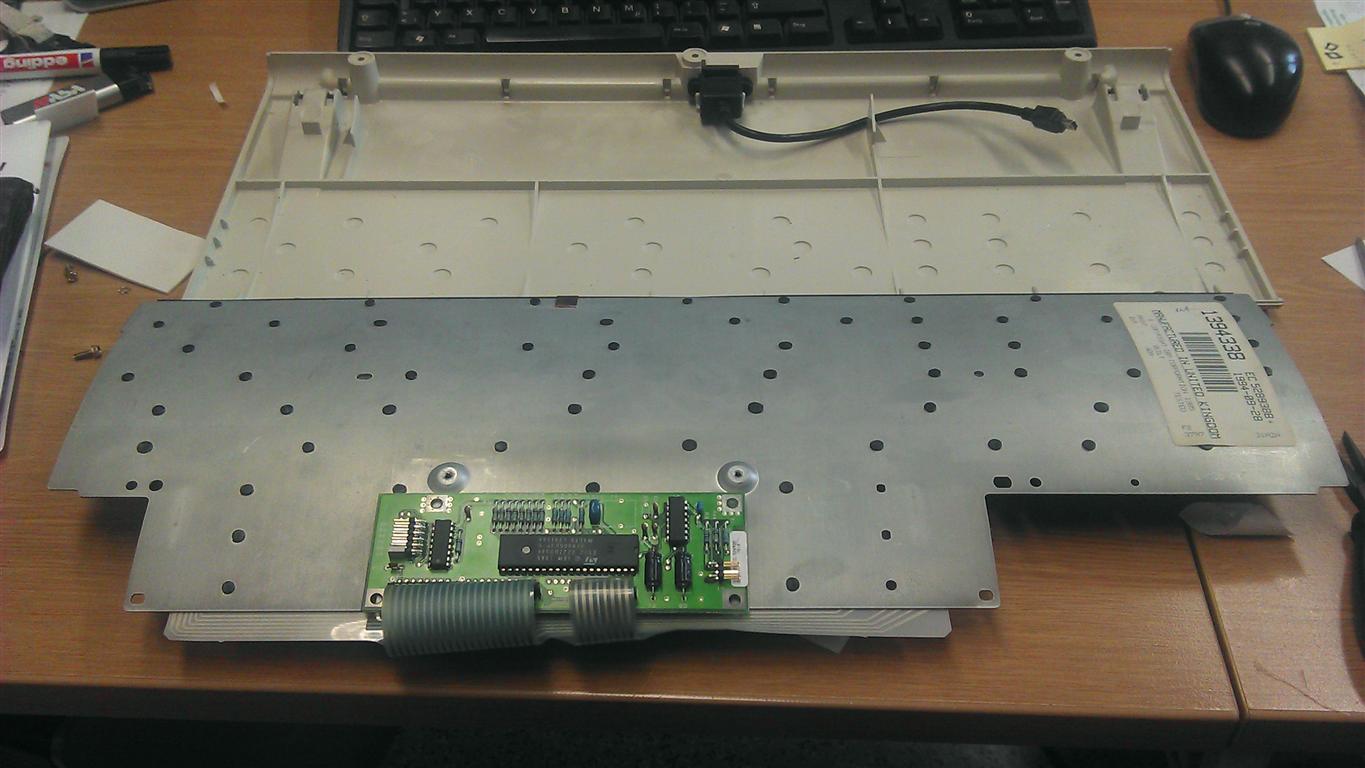

Mikester
- Main keyboard: IBM 3487 + built in Soarer Converter
hi guys,
i just modified my IBM 3487 terminal keyboard with a teensy-board with soarers firmware
Works like a charm!!
I had to relocate the original board a bit inside the casing to make place for the mini-usb extension.
Big thanks to soarer!
Mike
Mike
- IMAG0370 (Medium).jpg (96.8 KiB) Viewed 18950 times
- IMAG0369 (Medium).jpg (138.46 KiB) Viewed 18950 times
- IMAG0090_BURST001 (Medium).jpg (115.68 KiB) Viewed 18950 times
- IMAG0371 (Medium).jpg (148.81 KiB) Viewed 18950 times
- IMAG0089_BURST001 (Medium).jpg (107.74 KiB) Viewed 18950 times
