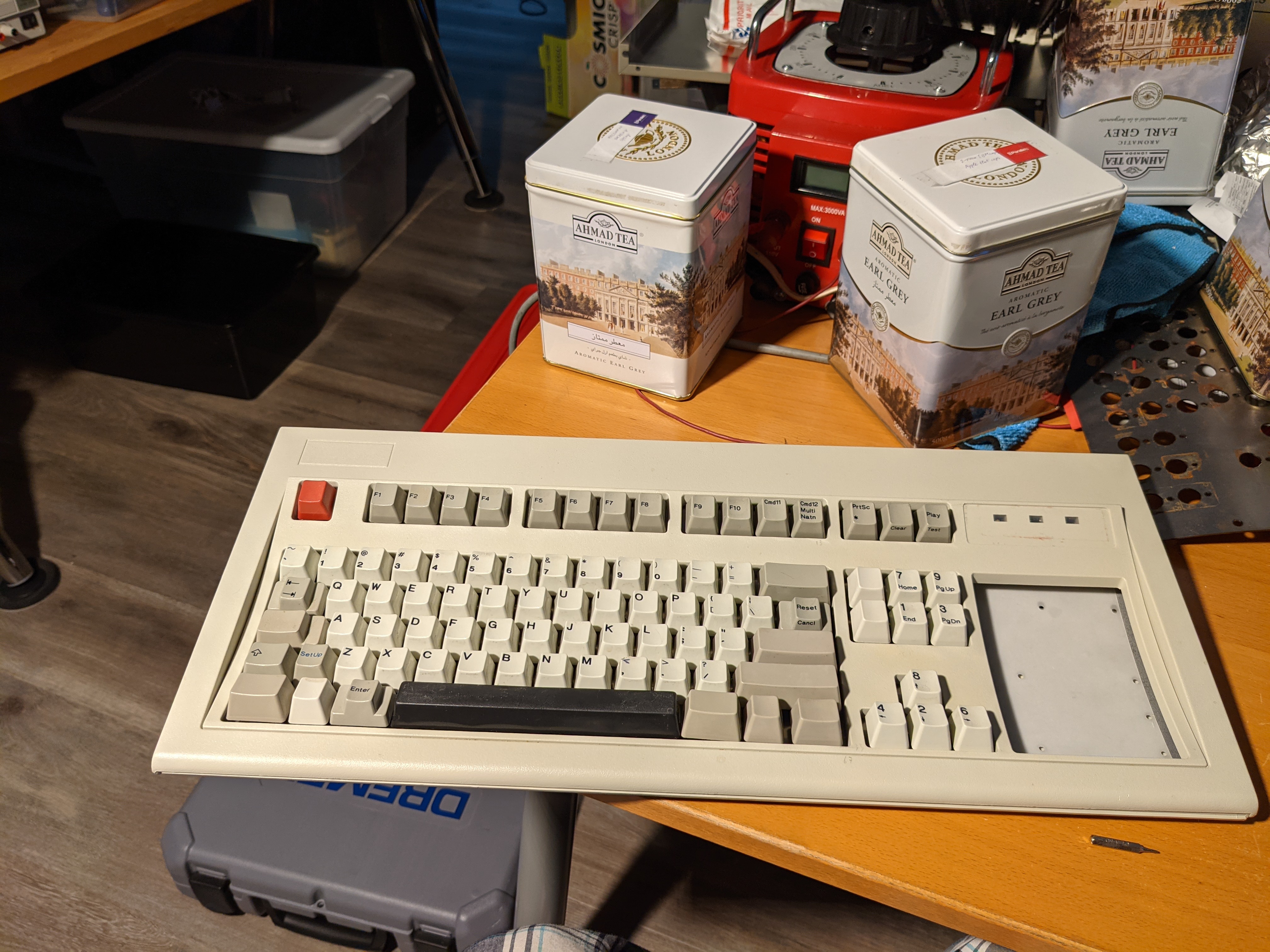

Problem is - my chops aren't that nice. This will require two 8-inch cuts that will be absolutely parallel to each other, and I know for a fact I can't do that.
Upd: although.. there's about enough space for trackpad..

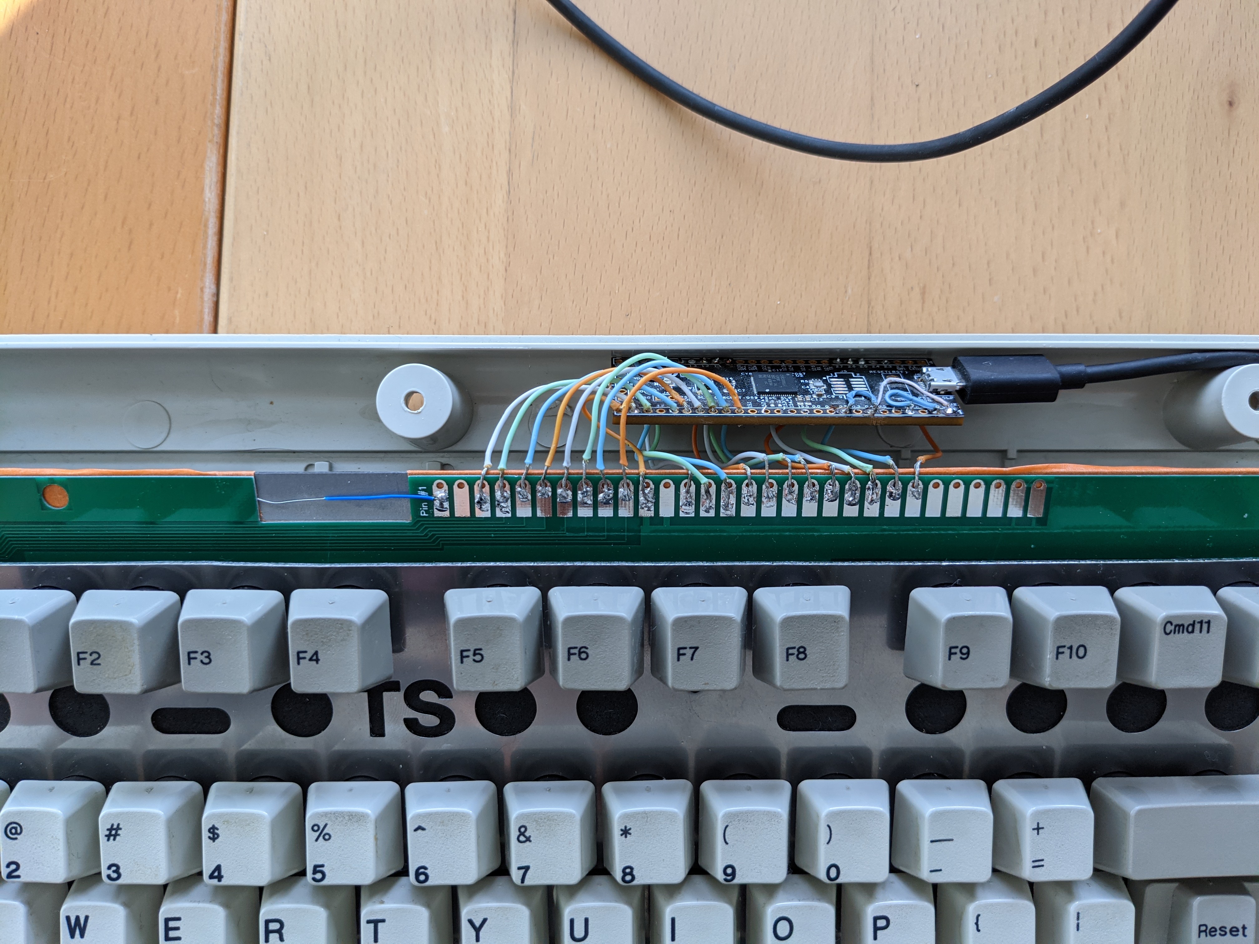

Mmkay, I'm typing it from thhe wired controller. It definitely needs some debounce tweaking,, bbut it works ffine!
Notee thhat ground connection doesn't hhave to bbe especially bbeefy (this is AWG30 wire-wrapping wire) - just _reliabble_.
