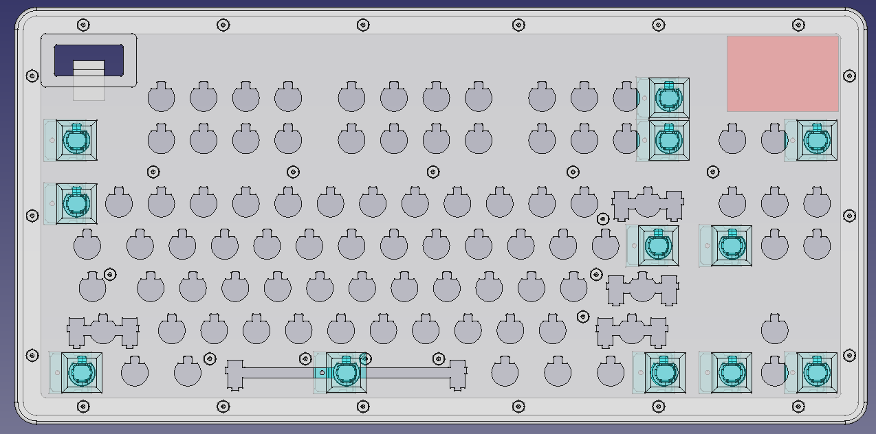

..looks like nobody makes decent-capacity pouch li-ion batteries smaller than ~35mm in width. Which means an airfield above F-keys - about 5 centimeters. 1000mAh battery should occupy space to the right of F12, which should allow for additional 12 (may be even 13, although I'm not a fan of double-barreled Esc) programmable keys.
OR, it can be used as a place to keep your pen, good old-fashioned style.
Any opinions?
Of course, the battery can be put under the keyboard block - but that opens whole new can of worms like cabling into the lower chamber and figuring out how to attach that lower chamber to the bottom plate in a way that won't be shorn off if somebody drops the keyboard from the table - let alone losing that 0 degrees slant capability (which can be quickly switched to more ergonomic negative slant when desired). Plus, that additional pedestal is additional manufacturing - and more complex manufacturing than two metal plates and a flat acrylic insert..
DMA
12 Jul 2023, 01:05
Figured out how to place double F-row _and_ antenna cutout (left) _and_ a battery (red).
Turns out, there are no standard sizes for li-poly pouch batteries - but 10x34x50mm is pretty close to standard for 2000mAh, and 2000 mAh should be enough for probably 3 hours of full-bore LEDs (2x IS31FL3743 (18x20mA each) = 720mA) or probably 100 hours with LEDs off.
12 Jul 2023, 10:40
That’s a Big Boy! What’s the weight looking like?
With that much space on top, you might as well throw in some twiddlers, as are all the fashion now. Maybe a pair of proper vintage analog VU meters, too. Well, that’s just me; wishcasting. :lol:

12 Jul 2023, 12:45
Looks great! I’m curious if there’s a possibility for a ridge to use as a pen holder at the top.

12 Jul 2023, 13:57
Muirium wrote: 12 Jul 2023, 10:40 That’s a Big Boy! What’s the weight looking like?
weight should be around 1.5-2 kg. It's also not that big - something like 380x180mm.
Muirium wrote: 12 Jul 2023, 10:40 With that much space on top, you might as well throw in some twiddlers, as are all the fashion now.
What are "twiddlers"? Rotary encoders? I'm not convinced of their utility. Sure, one can be volume (although.. why?), but more than one..

thefarside wrote: 12 Jul 2023, 12:45 Looks great! I’m curious if there’s a possibility for a ridge to use as a pen holder at the top.
yeah, that's pretty easy actually - something like 5x5mm bar with 2-3 threaded blind holes in it, plus matching holes in the top plate. (pen holder without a ridge is pretty useless, actually - will interfere with top row)

Still very tired but can do stuff for maybe an hour-two a day.
Here's what I found so far:
1) Brother model M and IBM model M stem internal cavities are identical - despite 5 mm length difference and significantly different stem appearance.
2) Buckling spring keys bottom out against key housing - stem never contacts the PCB, there's about 1mm gap. Could've figured that out from lack of contact patches on the PCB (surely stem would damage the silkscreen if it hit it repeatedly - or there would be silkscreen gaps under the key stem) - but alas.
Anyhow, I'm almost ready to go and find out injection molding contractor. Then I'll know how much money to try to raise..
I also want to experiment with letting the stem actually hit the PCB (or silicone inserts to cushion the impact) - but that's impossible without injection molding, as 3D-printed parts bind like hell. Not sure how many people will be willing to do the experiment (OTOH, nobody bottoms out the model F, so there's that..)
