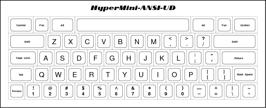

I think we can also do an innovative upside-down layout with the space bar and modifiers on top, number row on bottom. Typing speed might be improved by up to 15%.TheQsanity wrote:Left handed/mirror image layout anyone?
- HyperMini_UPSIDEDOWN.png (20.91 KiB) Viewed 7018 times

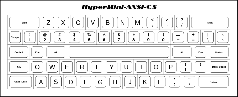

Ok 7bit..... Those are very creative and they made me laugh every time I scroll up to look at, but are you serious?
The second one is soooooooo crazy... how can you type anything....
And the first one can be acquired by simply rotating a keyboard 180 degrees....
I see how the first one can be used left handed. But why is it upside down? and do you really think it would improve your typing by 15%?
the second one is hilarious! Is the whole space bar your home row? hahahaha.
