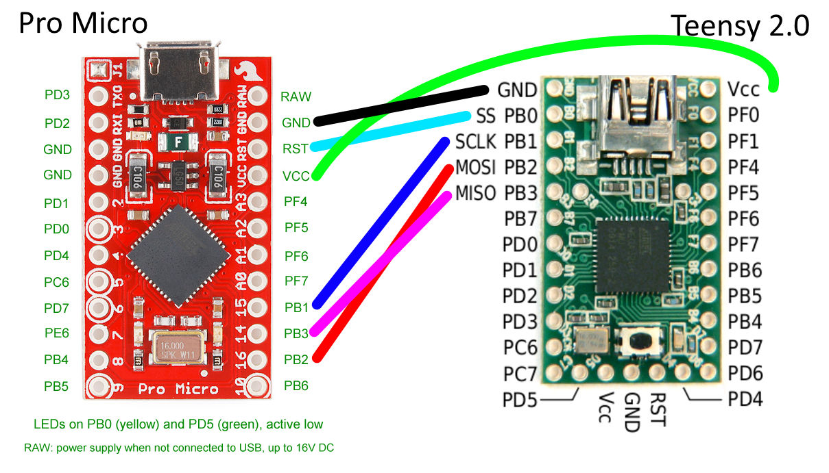

Grendel's BootHID is in that thread. You'll need an ISP to flash it or change fuses. You'll also need winavr or avr tool chain to compile them.
I used my teensy 2 using this and this as guides on how to hook it up and install arduino ide and teensyduino.
I think it should be possible to use a Pro Micro as an ISP, but you'll need to change the pins in 'ArduinoISP.ino' for it to work. This is because the Pro Micro has SS (PB0) connected to an LED.
ArduinoISP.ino from examples in Arduino IDE.
#define RESET     SS
#define LED_HB    9
RESET needs to be changed to another pin and LED_HB can be changed to SS if want it to blink when arduinoisp is on.
