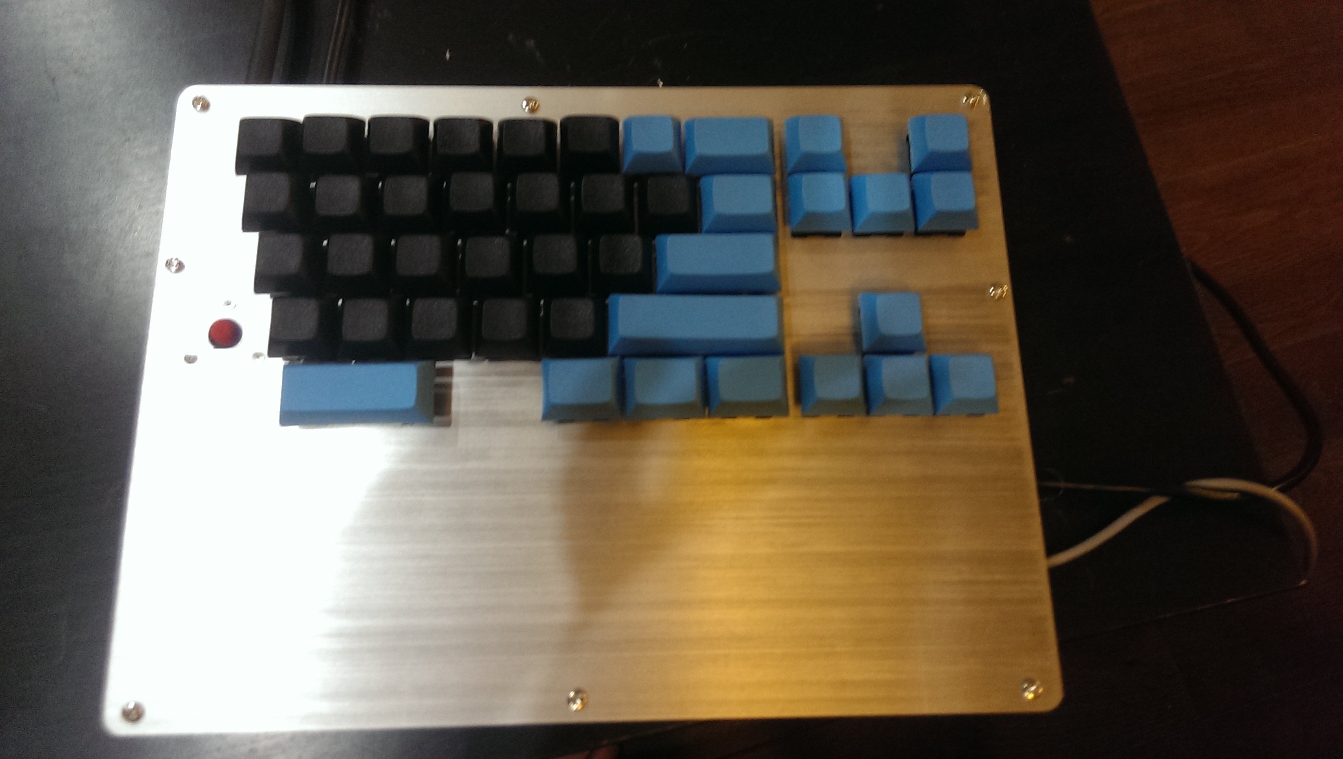

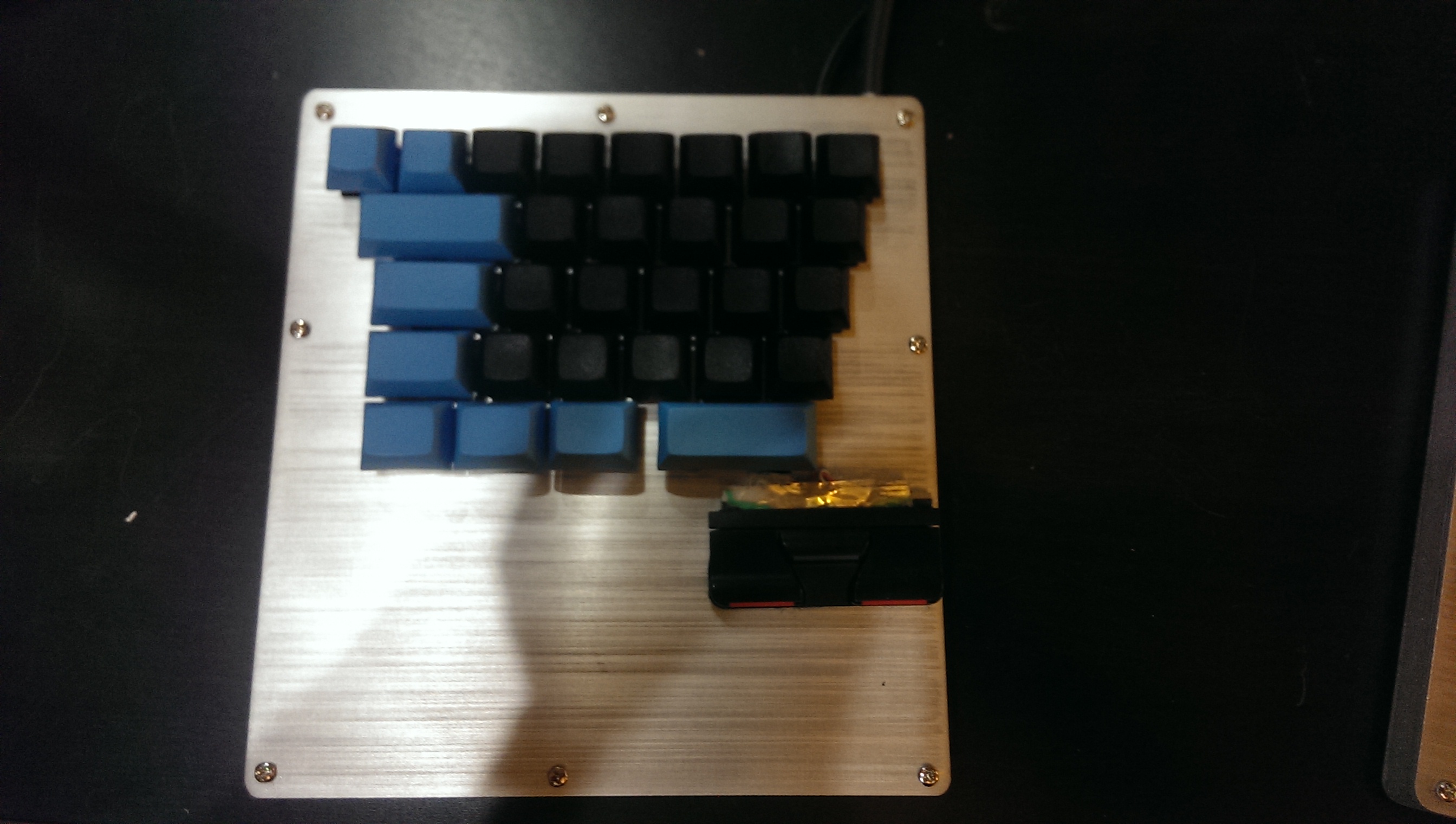

pjmelon
08 Feb 2014, 06:01
Here you go, got a few cosmetic changes but most is good to go.
