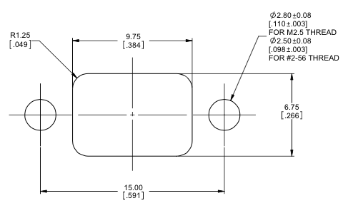

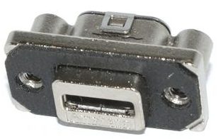

Looks like the opening for the stock cable is only about 3/16 inch (0.1875 inch; 4.76 mm) . The opening for a micro-USB receptacle will require some widening.
I am thinking of using a Mouser Electronics panel-mount micro-USB receptacle.
The recommended panel cutout for this is 9.75 x 6.75 mm.

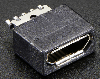

28 Nov 2014, 17:13
Where are you planning on having the seam? The Kishsaver's case is a simple top and bottom half, which join around the original exit hole, unadorned. I reckon a smaller connector could be glued, with appropriate mounting, to the lower half of the case, and occupy that spot with the connector's widest edge lined up with the seam.
Panel mount sockets require more invasive work.

Muirium wrote: Where are you planning on having the seam? The Kishsaver's case is a simple top and bottom half, which join around the original exit hole, unadorned. I reckon a smaller connector could be glued, with appropriate mounting, to the lower half of the case, and occupy that spot with the connector's widest edge lined up with the seam.
<snip>
Excellent point! I was thinking the same thing while looking at my KS. While I prefer to put things together with screws rather than glue, in order to be less invasive, I might want to use something like this micro-USB "glue-in" receptacle from Adafruit:

Today I received a Mouser mini-USB connector with somewhat bigger pins that exit straight from the back rather than pointing downward at a right angle to the connector. It is part number MUSB-B551-O4 Mini B Single Vertical connector.
In any event, it would be somewhat better to use a micro-USB connector. If you would care to share some pics and "how to" comments about how you soldered the pins on your Mouser USB connector in your custom keyboard, that would be great.
