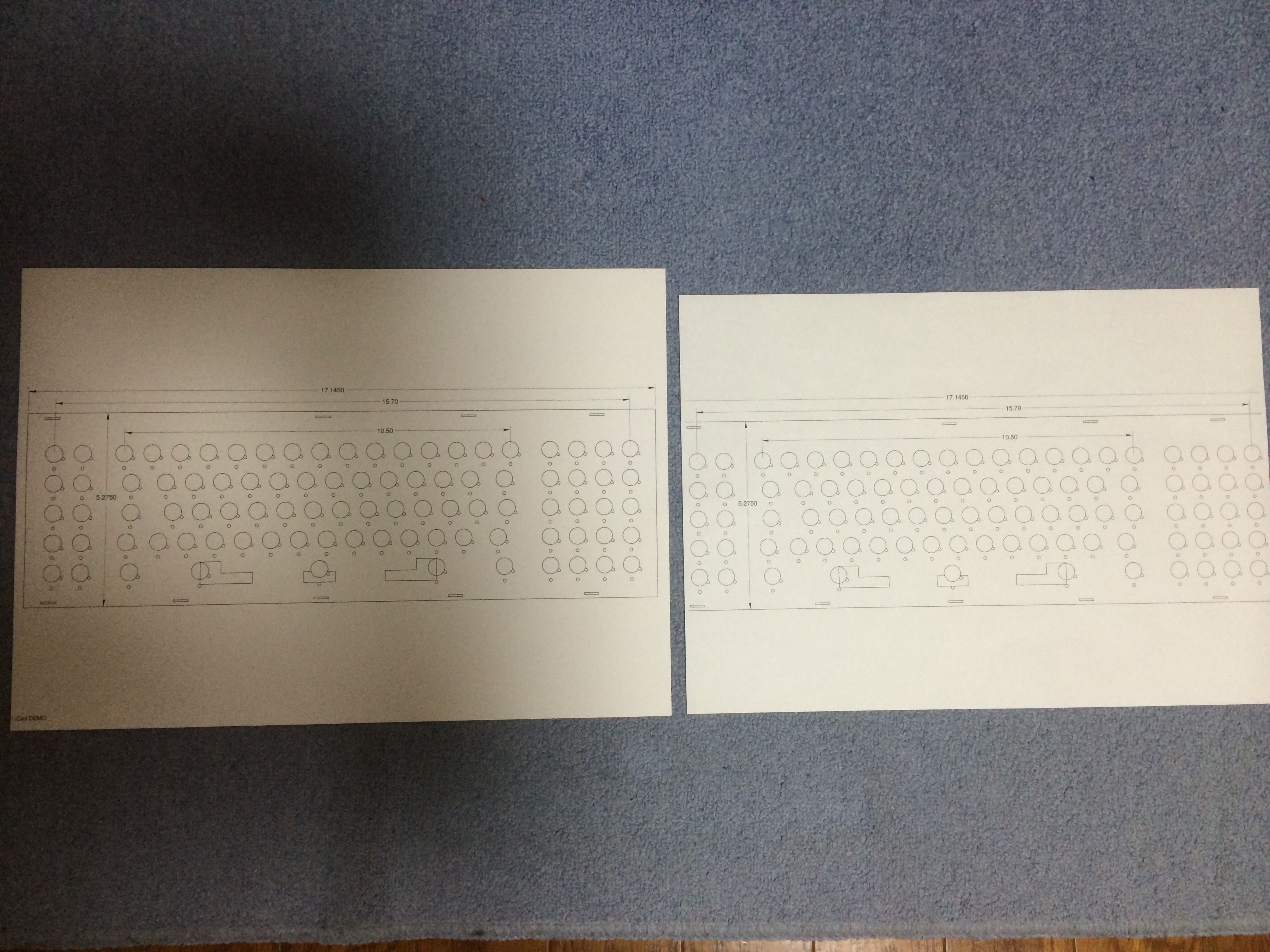

I finally got around to making a template for 122. Due to the size of the pad, i'm publishing it two ways - one uses two sheets of legal (8.5x14) - the other as ArchC (18x24).
Model F 122 pad(legal).pdf
(77.64 KiB) Downloaded 661 times
Model F 122 (archC).pdf
(56.33 KiB) Downloaded 606 times

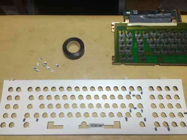

DaCiRo
09 Nov 2014, 10:28

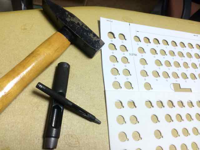

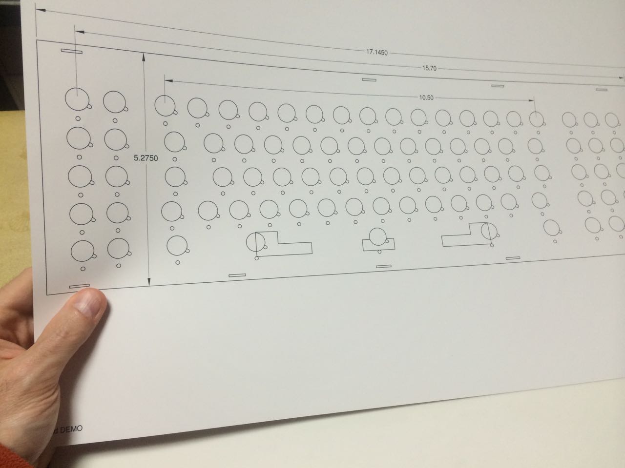

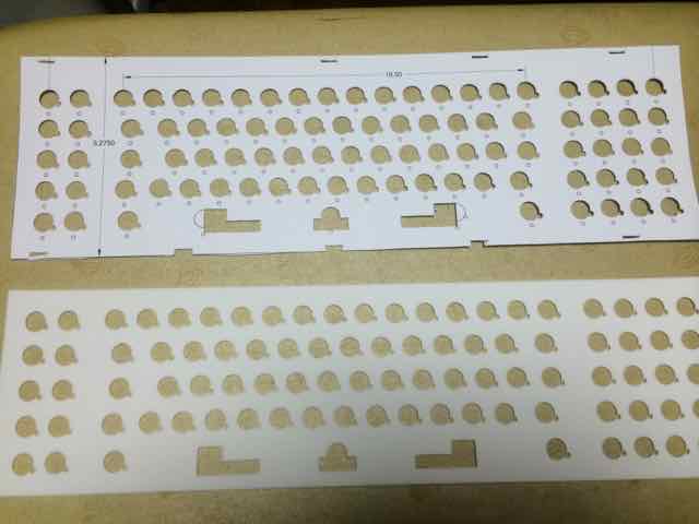

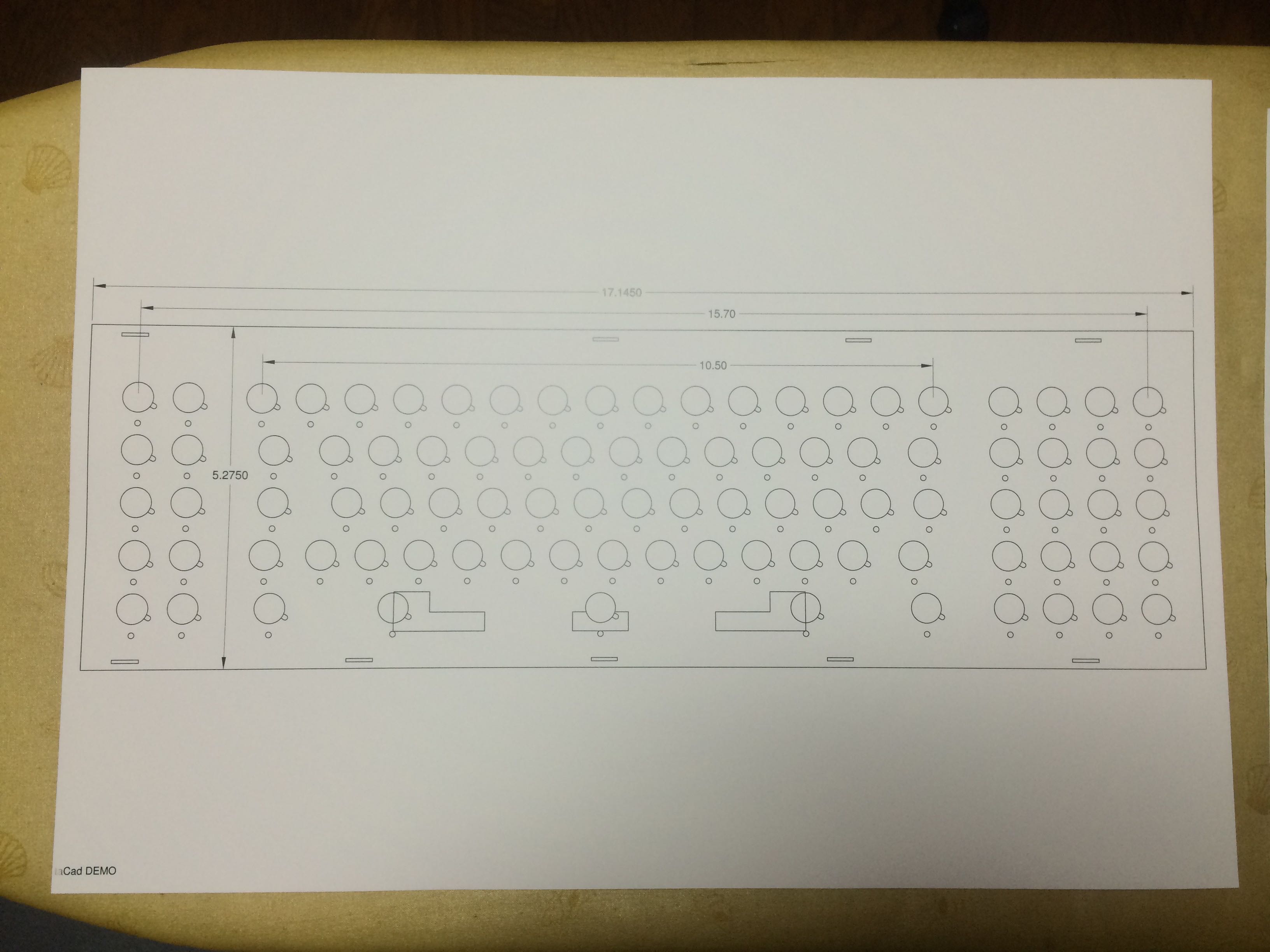

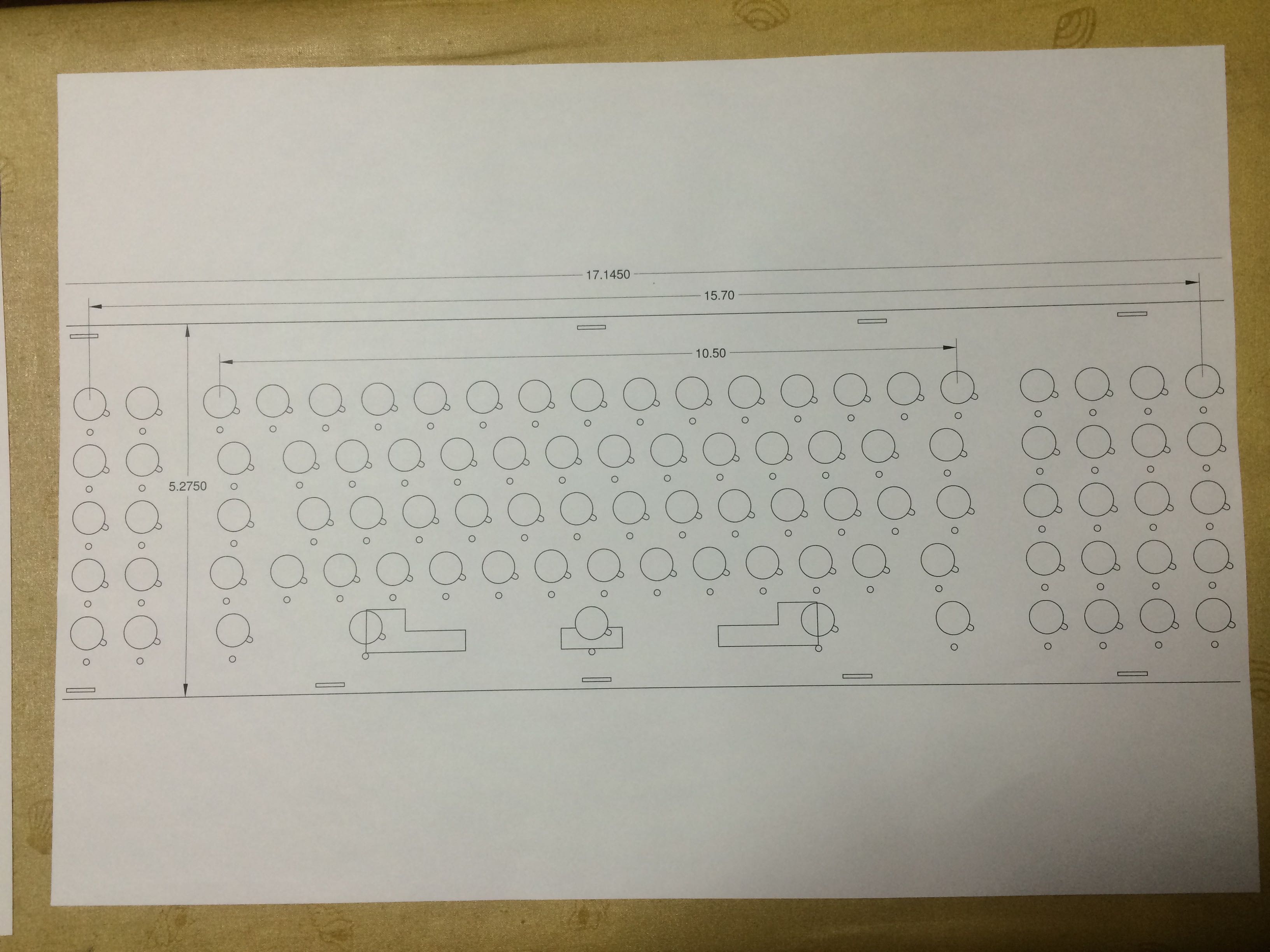

Thanks to Wcass who was kind enough to share the Keyboard template for the IBM Model F AT keyboard I could finally restore mine after few failed attempts of replicating the template in my own by spraying black paint over the old putrid original keyboard foam sheet.
The Spay over foam try never worked, the wholes where never perfectly aligned but Wcass template is accurate to the mm... amazing!.
I used 2mm art foam from a stationary shop in Tokyo city center. and it seem to be the perfect size. I tried to fit in a 3mm on but was too thick. Nothing in between, I wasn't able to find a 2.3mm~2.4mm sizes he in Tokyo, the one thicknesses I came across were 2mm, 3mm, and 5mm

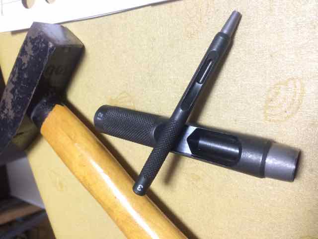

For the holes I used 12mm and 3mm hole punchers, the 12mm for the main barrel hole and the 3mm for the fitting pins. These holes needed to be very accurate as you know otherwise the foam will fold or overstretch when fitting in the barrels. Overall it took me 4 hours to punch the 168 holes (84x12mm + 84x3mm), including preparation and cutting the spacebar shape. That is too much time for such a simple operation but I took my time to try match the hole cuts to the template accurate to +/- 0.5~1mm,....and it really paid off. Some pictures below:
Wcass Template TOP . Foam Cut BOTTOM
AT template - Foam cut.jpg (27.07 KiB) Viewed 15820 times

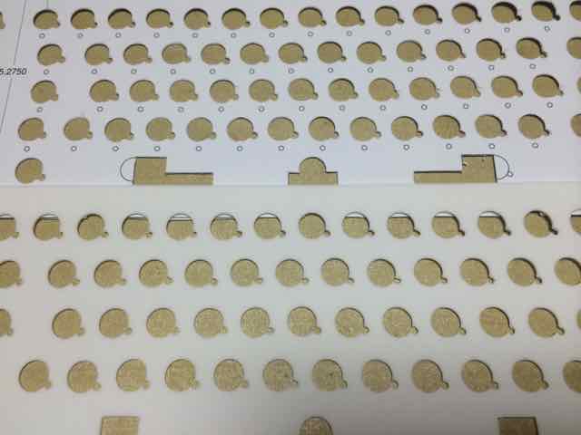

Template and Foam  - Close Up
Template and Foam Close UP.jpg (26.66 KiB) Viewed 15820 times

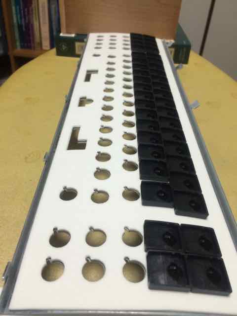

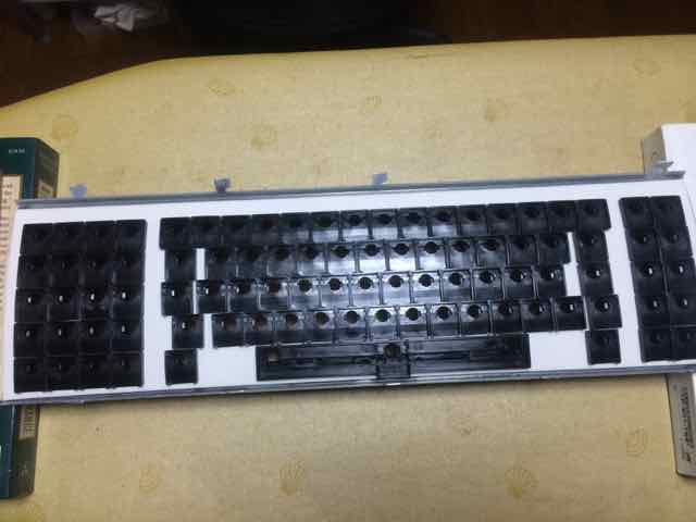

Foam cut set over plate
Foam cut over plate.jpg (23.17 KiB) Viewed 15820 times

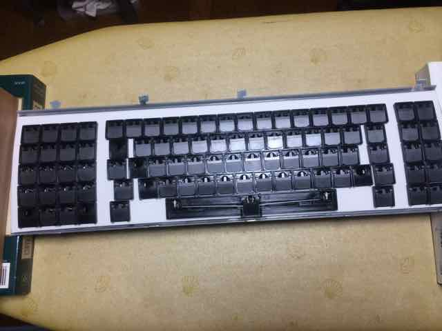

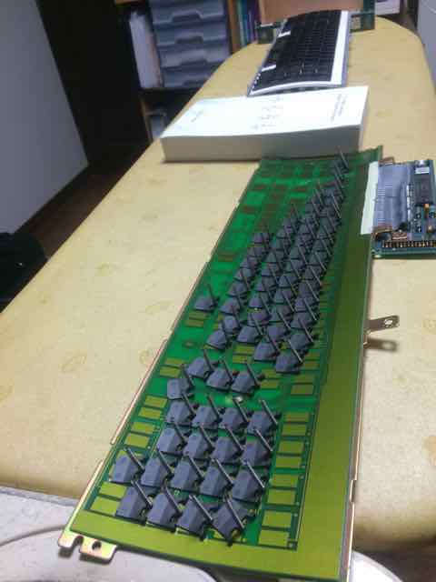

Laying down the barrels
Laying down the Barrels.jpg (24.31 KiB) Viewed 15820 times
All Barrels in Place, next is springs
All Barrels IN - Nice!.jpg (26.46 KiB) Viewed 15820 times
Close up - Perfect barrel alignment
Perfect allignment All Barrels in.jpg (21.47 KiB) Viewed 15820 times
and now the springs
and now the springs
Now The Springs!.jpg (27.19 KiB) Viewed 15820 times
All Springs in - Almost completed
All sprigs in - Almost completed.jpg (27.78 KiB) Viewed 15820 times

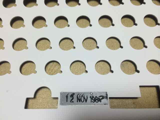

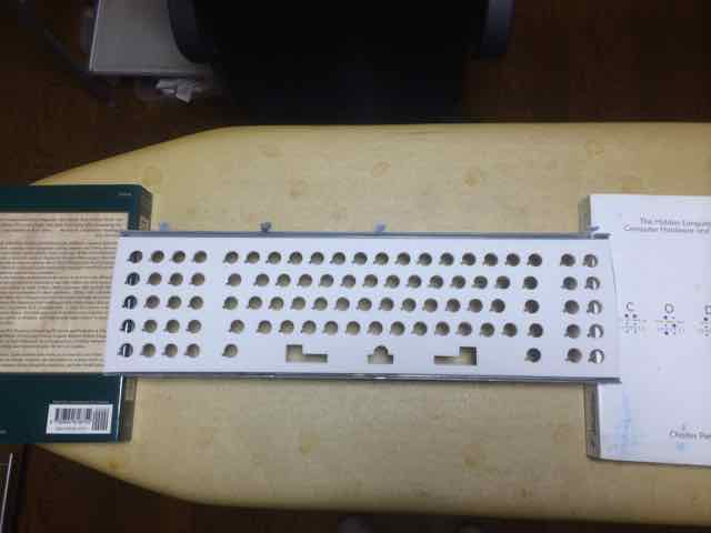

Plate itself - rust free, cleaned, dusted, primered, and painted White
Plate, rust free, cleaned, dusted, primered, and painted White.jpg (26.46 KiB) Viewed 15820 times
Kept unpainted the plate's date - plastic window sticker on top of date
Plate . Kept the original printed date visible protected with a plastic window sticker.jpg (23.8 KiB) Viewed 15820 times
Big Thanks to Wcass for his template which allowed me to resuscitate this beauty

You did a great job on that foam. How did you attach the template to the foam? Tape around the edges?
DaCiRo
10 Nov 2014, 15:13
I simply stapled the template print onto the foam 2cms above to the cutting margins.
4 Staples on Top and Bottom longitudinally and evenly distributed and 2 staples on each Right and Left side. That was enough to keep it fixed without the need to use any glue or tape.

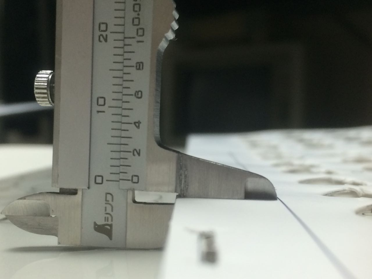

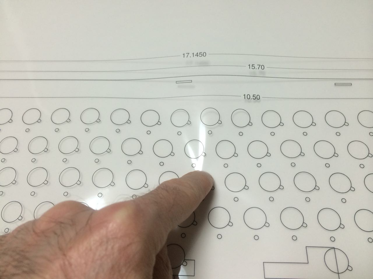

Rather than the fixing method to the foam what I realized it was most important to keep the holes aligned while punching them was for the the template print to be thick enough to sustain the surface deformation of the hammer hole punch with every hit, and to have a thick base board (and I mean thick) to punch the holes on.

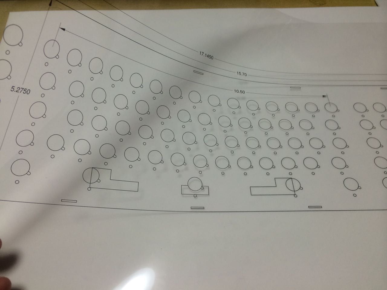

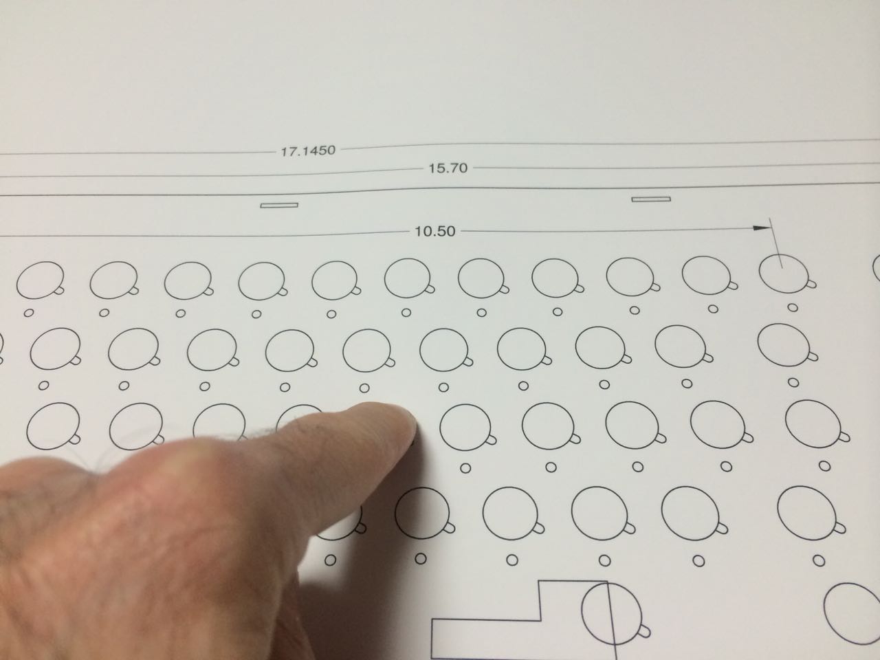

Regarding paper I made 3 prints:
1x Regular A3 paper (0.1mm) - Discarded right away, too thin and too light, even to sustain shape after stapling it
1x Transparency (0.1~0.15mm) - Ok but not really good deformed too much
1x Thick paper (0.3mm) - The best, minimal deformation
Transparency Paper
Transparency Paper
Transparency paper.jpg (93.63 KiB) Viewed 15760 times

Thick Paper - Paper Thickness (approx 0.3mm)
Paper thickness.jpg (70.48 KiB) Viewed 15760 times
The Regular paper and the Transparency deformed too much on pressure to be as accurate as I hoped. See the waved deformation on the top printed lines as a reference. The Thick Paper (0.3mm) turned out to be the best requiring not much strength to perforate the paper and foam in a couple of strokes and with little deformation.
Quick Pressure test - See deformation of the top printed lines to get an idea
Transparency - Pressure deformation
Transparency - Pressure deformation.jpg (91.8 KiB) Viewed 15760 times
Thick paper - Pressure deformation
Thick paper - Pressure deformation.jpg (82.49 KiB) Viewed 15760 times

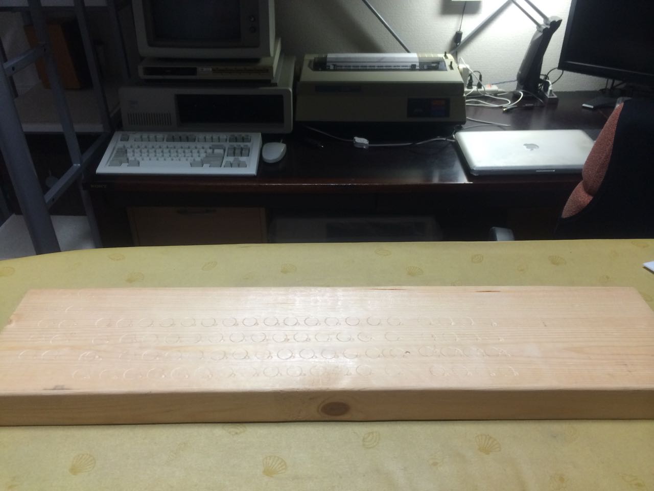

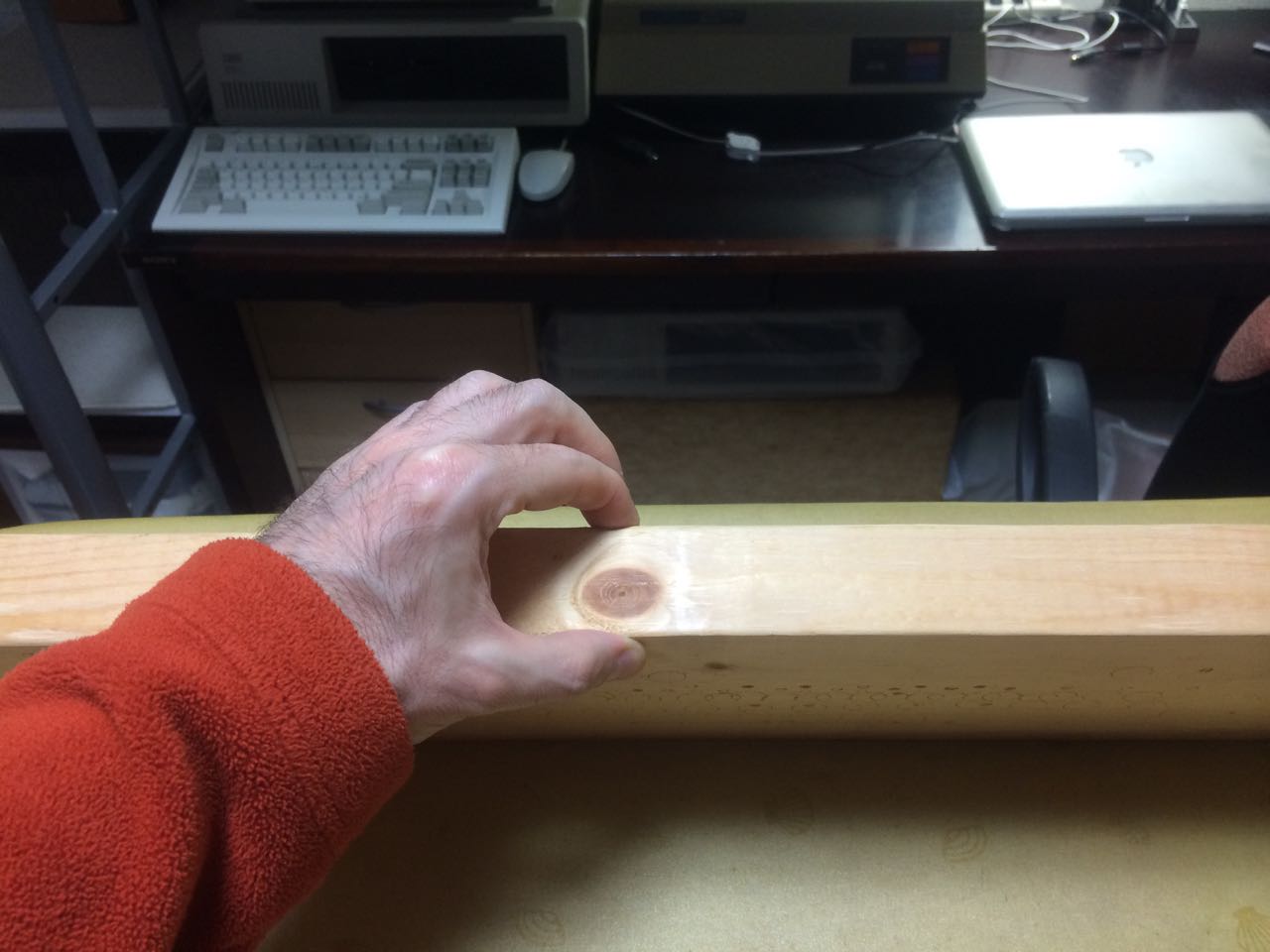

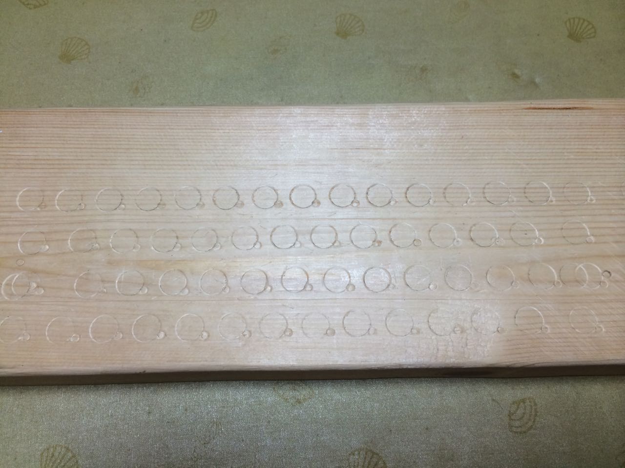

The Base board
The last but not least, A thick base board. I tried using spare shelf trays that were 1cm thick and half the length of the print. It wobbled and vibrated too much with every hit. A big difference when I moved to use a thicker board.
Thick base board
Thick base board
Thick base board.jpg (90.62 KiB) Viewed 15760 times
Base board Thickness - just to get an idea
Base board Thickness.jpg (94.88 KiB) Viewed 15760 times
Thick base board - The Giant Octopus attack
Thick base board - The giant Octopus attack.jpg (137.11 KiB) Viewed 15760 times
Maybe I punched them in too hard :)
quantalume
10 Nov 2014, 17:03
Thanks for sharing all those details. I used a thick piece of soft lumber too, but I used a smaller piece and had to move it around frequently. I like the idea of using a larger board. I have a couple of foam pieces I need to punch out where I've already painted the top plate, so I'll be using the template method. The template is larger than A3; how did you line up the two halves?

A3 print(11.69' x 16.53')
A3 print
A3 print
I used a Tabloid size print (11' x 17') which is perfect for printing the keyboard template real size in one single sheet, including the cutting margins.
Tabloid print (11' x 17')
Tabloid
Tabloid
27.94cm x 43.18cm.jpg (397.85 KiB) Viewed 15709 times
A3 and Tabloid print side by side
Tabloid LEFT, A3 RIGHT
side by side.jpg (737.99 KiB) Viewed 15709 times

Those O-rings are an interesting idea. I was contemplating using a split lock washer myself - but figured their use would probably crack the barrels.
When I rebuilt my 4704 107 recently, I tried 2mm craft foam across the entire plate - found that it wasn't thick enough for the home row. Tried 3mm craft foam across the entire plate - found it was too thick for the top and bottom rows. I then cut the home row strip out of both pieces, and tried the 2mm foam on the top/bottom with the 3mm foam on the home row. This ended up sort of cantilevering one edge of the barrels on the home row.
I went back to the store and picked up one foot of automotive headliner foam, which came on a roll 54" wide - and is about 1/4" or 3/16" thick and very soft. It was a pain to cut holes in compared to the craft foam (don't have a punch) - but it applied an even pressure on all of the barrels across the plate. I also found I much preferred the key feel with this softer foam compared to the much denser craft foam.
