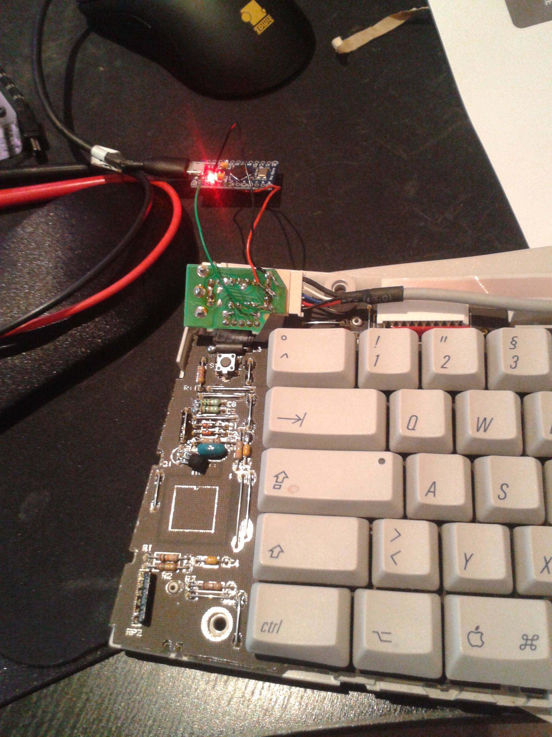

My current soldering setup is:
yellow -> 5 ( I believe the yellow is the CLOCK)
red -> 2 (and this one to be DATA)
Black -> VCC
White -> GND
I have also tried this:
Yellow -> 2
Red -> 3
Black -> VCC
White -> GND
Here is a link to a couple of pictures (with old soldering setup):
http://imgur.com/a/8wJkp
My current keyboard is so BAD it hurts! Please help!

Hi santeri,
I think you are making a mistake with the pin numbering on the pro micro.
I've never used the tmk converter (only the controller), but in the README, in shows that the pins to use are:
Data: PD2
Clock: PD5
If you look at the first page of this thread, you can see that the PD2 and PD5 do not correspond to the pin numbering on the board. In fact, PD2 is "Rx" and PD5 control a led.
So you'll have to change the pins used in the source code.
If right now you have Data on Pin 2, the corresponding register will be PD1. For Clock on Pin 5, it's PC6.
I've had a look in the converter, and with just changing these lines, you should be ok.
to
But I see there are other things declared to use PD1, so if it doesn't work change the DATA to another pin on the pro micro.
Data: PD2
Clock: PD5

santeri
Findecanor: No I have not bridged the jumper. Thanks for the information!
Redmaus: I will look into this, thanks!
keiwop:
So my current CLOCK is in the right pin? Something went right after all
I much rather would change the soldering setup. I had so much trouble with the flashing and don not want to do it again (at least not yet) if possible.
Would it work if I solder the DATA to RX and solder the jumper togehter mentioned by Findecanor?
Thanks for the huge help keiwop!
I am also wondering, where did you guys come up with all this information? I usually try to learn while I do projects like this but this time I think I have learned nothing. This is some dark magic shit to me right now. Any recommendations on good articles to read in this subject?
keiwop:

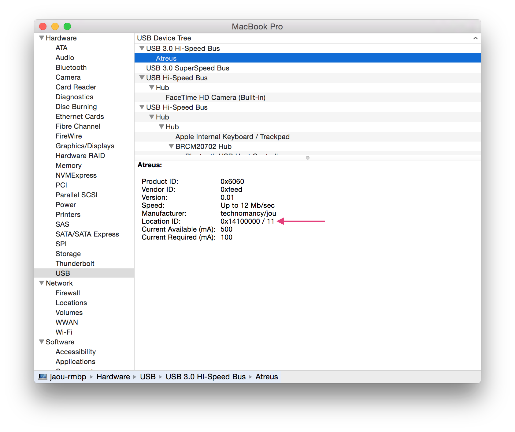

Keep in mind that even with shorting reset twice correctly, the Pro Micro only stays in bootloader mode for 8 seconds. After those 8 seconds, it starts the flashed program.
technomancy's fork of TMK for Atreus has a nice little addition to the Makefile, a `make upload` target that waits until the bootloader device shows up and then start `avrdude` immediately to flash it. See https://github.com/technomancy/tmk_keyb ... kefile#L42 and https://github.com/technomancy/tmk_keyb ... #L142-L144 for the implementation of it which you can paste into your own Makefile. The device name on Linux should usually be `/dev/ttyACM0` (I mostly use Linux via SSH on machines several hundred kilometres away, so I can't confirm it). On Mac OS X, you can derive the device name from the location ID which you can find in the "System Information" app:
Start with "/dev/ttyusbmodem", drop "0x" and take all digits before the first zero and add an "1" at the end. So in my example with location ID `0x14100000`, the bootloader will respond at `/dev/tty.usbmodem1411`.

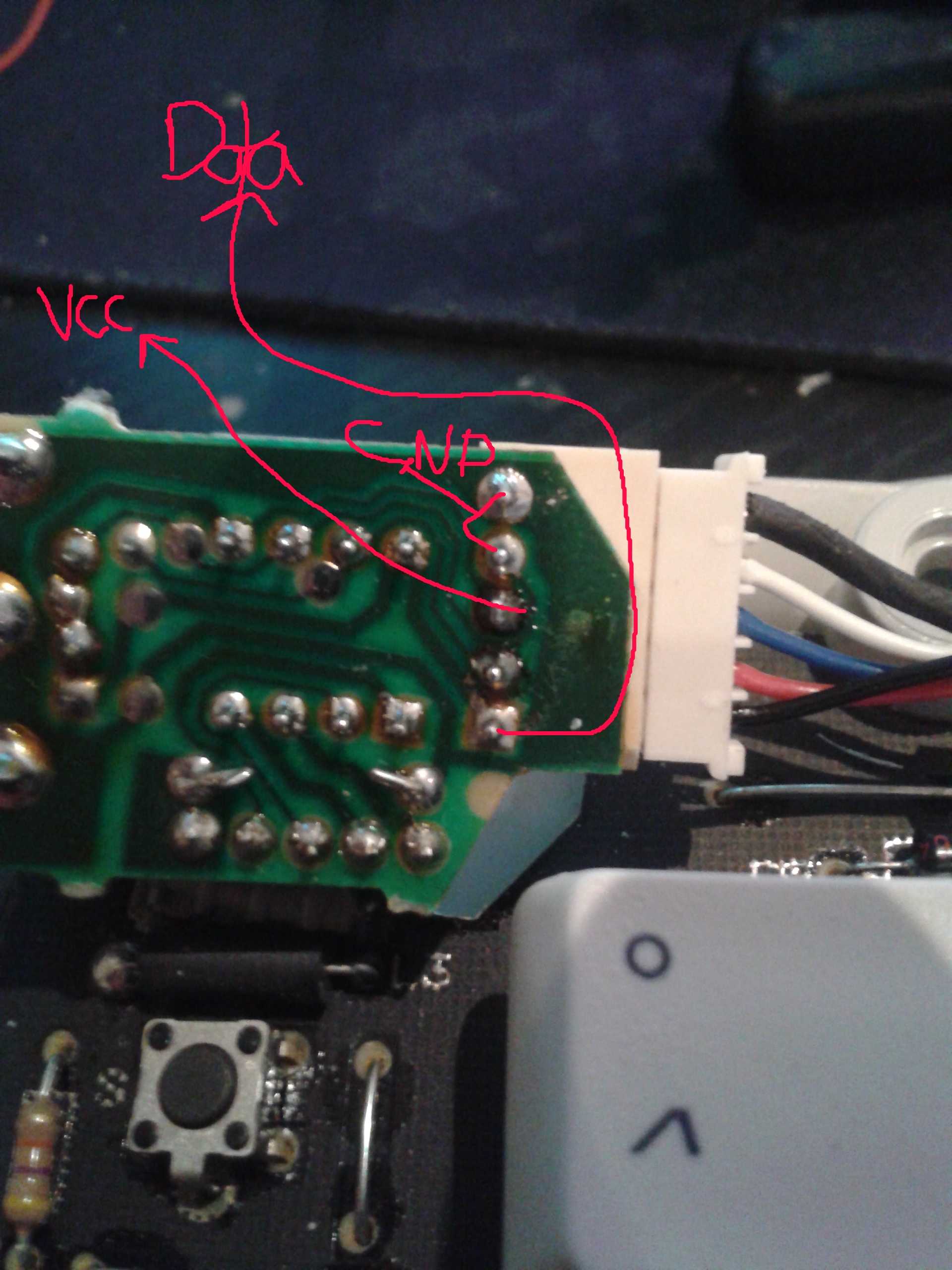

Et viola! One functional AAK using hasu's ADB converter running on a pro-micro
. Very happy with this, going to get it all pretty over the weekend and try it out as a work board. I've also included my super pro wiring diagram incase someone else is planning on doing this
. Also, sorry about the attachment size...
- 20150528_220115.jpg (458.83 KiB) Viewed 14120 times
- super_wiring_diagram.jpg (212.12 KiB) Viewed 14120 times
- scottc
Great work! My crappy inline converter doesn't work now so I'm going to have to keep this as a reference for my own AAK.
