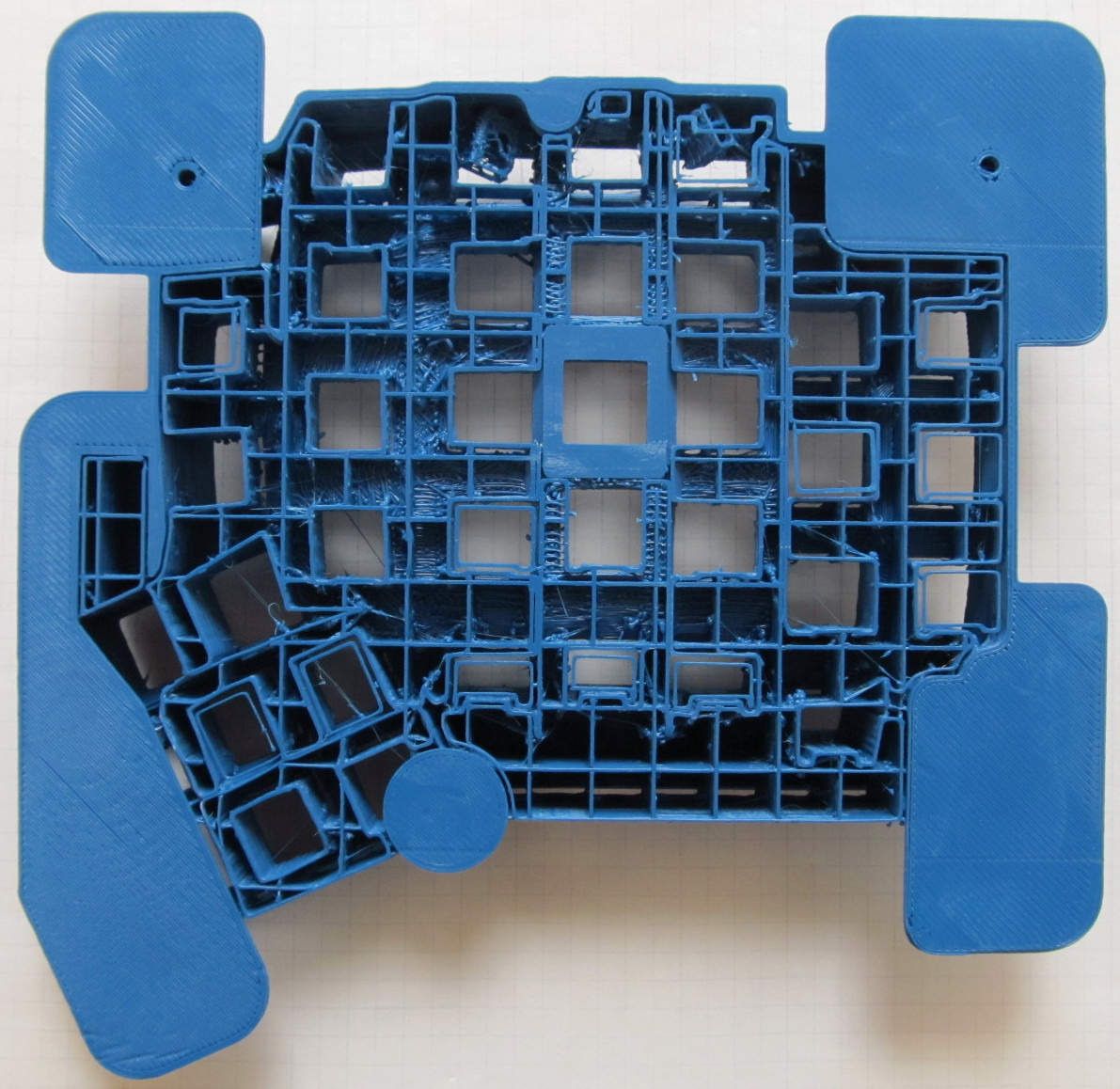

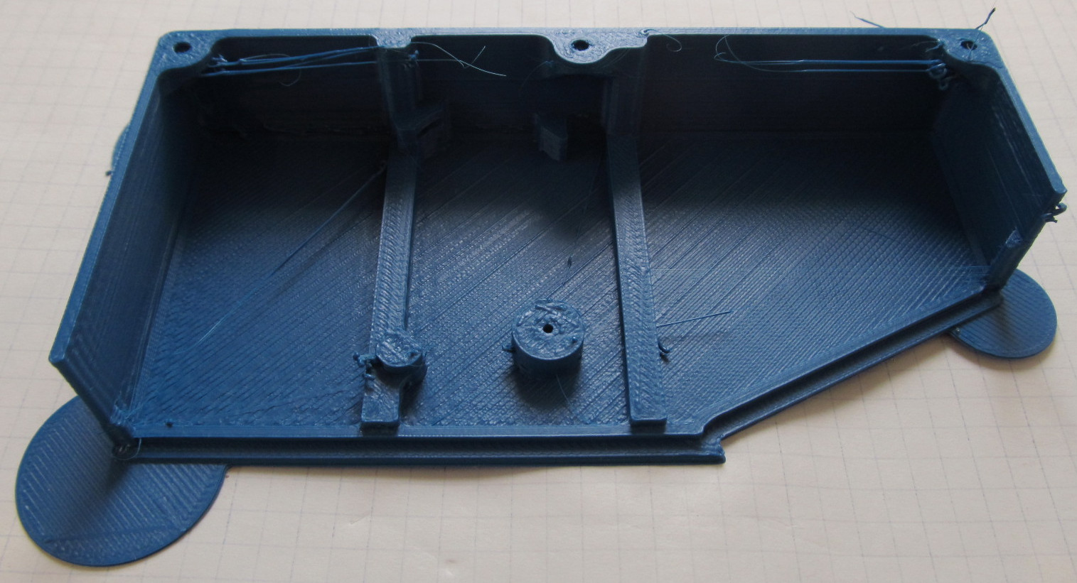

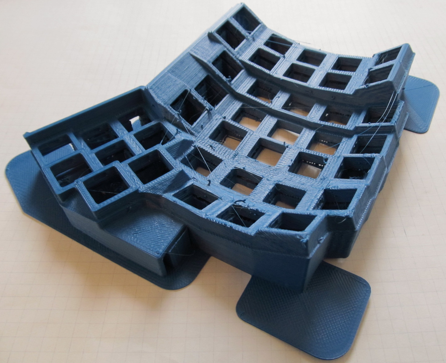

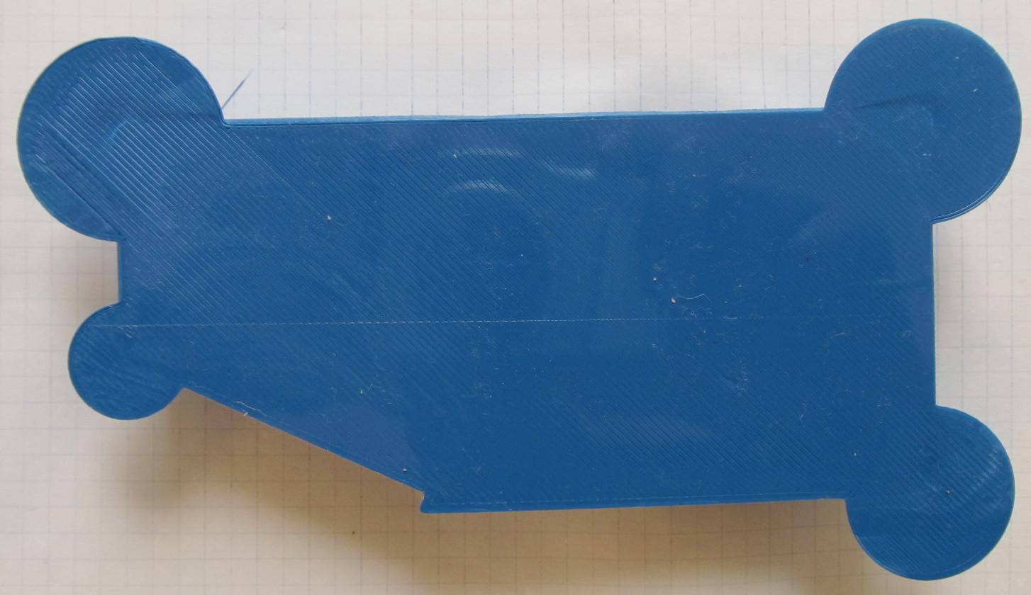

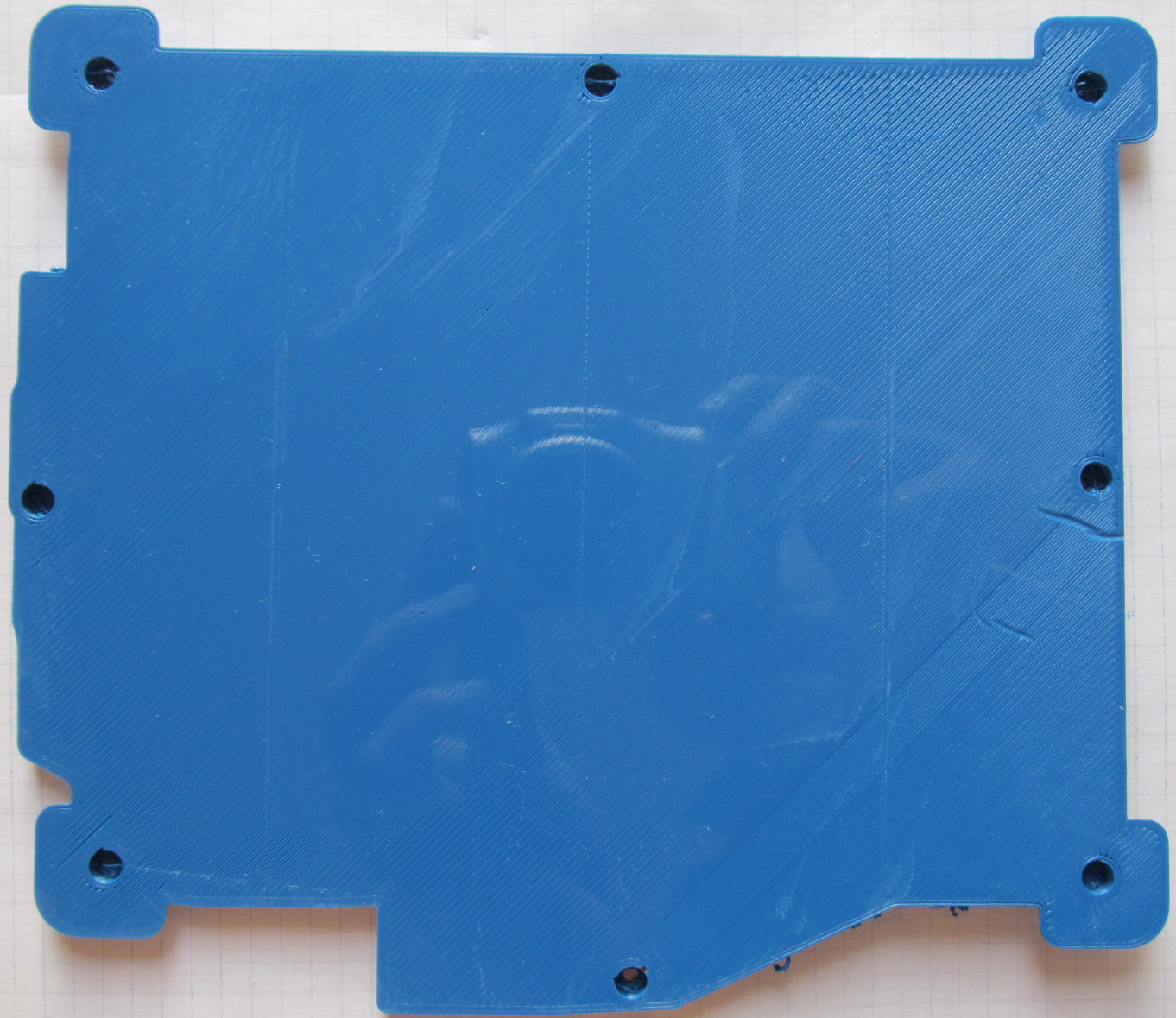

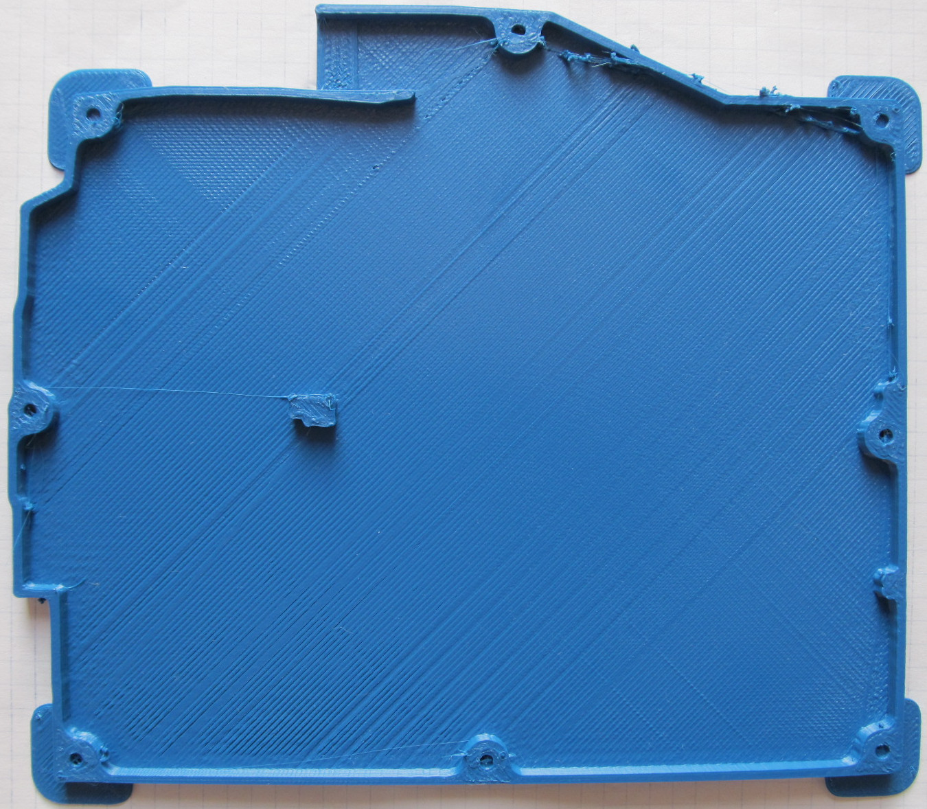

Just an update:
I've tried printing the palm rest twice, and it keeps peeling up from the bed. I might just use them as it (it's a nice gentle roll off towards the back. Almost looks intentional ! :D
If I feel determined, I'll try a full wipe-down of the bed (we used to clean it with Alcohol after each print, but our alcohol bottle walked off :( ), and maybe I'll use an ABS slurry on the bed.
vvp
09 Jul 2015, 22:52
No big peeling is intentional.
My bed is covered with kapton tape and cleaned with acetone before printing. All parts hold well.
Cleaning with alcohol does not work that well. I tried it once and got pealing off too. Though it may have been in times when my bed was not leveled that well leveled.
If it peals off even after the bed was cleaned and If you think some of the adhesion pads need to be bigger or thicker then let me know which ones. I'll modify the model. It would be cool if you can post a picture of the problem.
I often get a slight peal off of corners (maybe by 0.5 mm at most). But only in the middle of the circular adhesion pads. It never propagates behind the circular border of the pads. I ignore these.

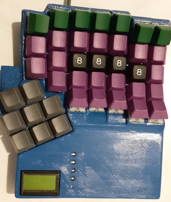

Hey vvp, where do you get your acetone? I picked up some 100% acetone nail polish remover from my local CVS today (as I happened to be there already), and went to town on the bottom plate. It however discolored the print. My bottle list denatonium beonzoate as an ingredient (bittering agent, I know), but perhaps it isn't added to the paint thinner type cans that you can pick up at a hardware store, and that's what's causing my problem. I might be able to hit my hw store this weekend.
Top Side: Image
Bottom : Image
Another thought, perhaps this is caused by the dye used in this batch of ABS? I'll try the acetone on another color of print to check.

Oh shit! I forgot to mention this but also because this problem is not serious on red ABS, it is almost not there on the yellow ABS, and it is not there at all on white color ABS of course.
In other words the darker the color the bigger the problem and you selected the black color. I was kind of surprised with your color preference :)
This is one of the disadvantages of acetone painting as opposed to acetone vapor bath.
Natural ABS color color is white, just as the smuggles you see on your case. Acetone is melting the surface of the part when painting and the ABS itself sticks better to the brush than the color pigment added to the ABS. Or maybe acetone somehow can neutralize the pigment (I'm not a chemist). The more your acetone is contaminated with ABS the more white smudges. Notice how your acetone get whiter and whiter when you paint something with it.
To fix it you need to use clean acetone and "wash" the smudges with the brush. Make light moves over the surface. Do not press. It may be a good idea to scrub the most white places with a knife first (to remove most of the discolored ABS from the surface first). Other option is to paint the case. I do not have an idea what colors are good to use on ABS plastic but I saw same discussions on geekhack (and maybe even here on deskthority) about the suitable paints for ABS. If you cannot find it and have problem to "wash" the white smudges then post a question in a new thread about paints. Somebody will know for sure.
Next time select an ABS with lighter color if you can.

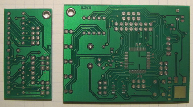

And I forgot to mention. ATXmega64a4u arrived. We put it on a breakout board during the last weekend and we found out that it did not come with a bootloader preloaded.
At Farnell, ATXmega64a4u is always more expensive than ATXmega128a4u, so I do not understand why ATXmega64a4u is even being sold. Maybe it gets cheaper with extremely huge orders (tens of thousands?).
vvp

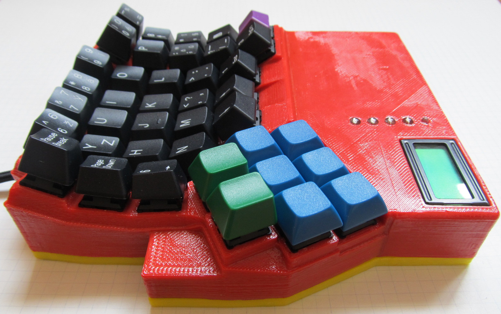

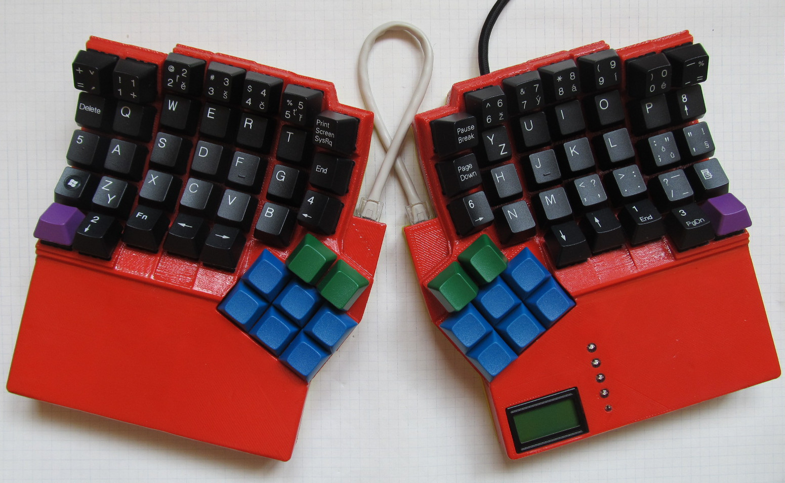

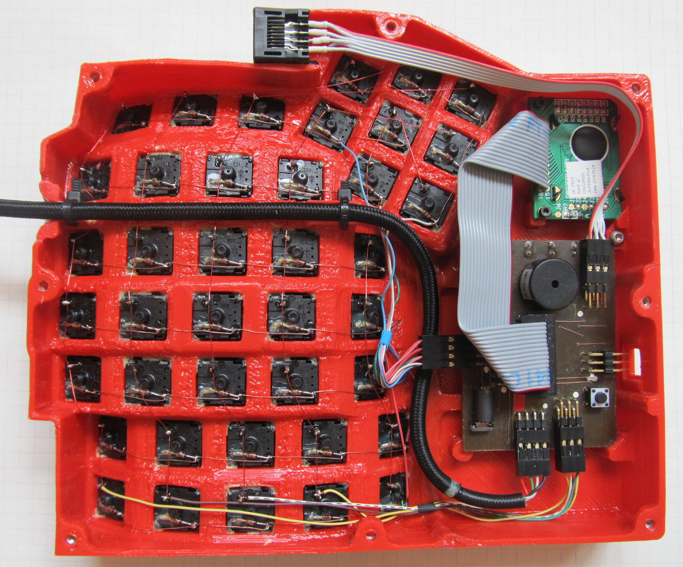

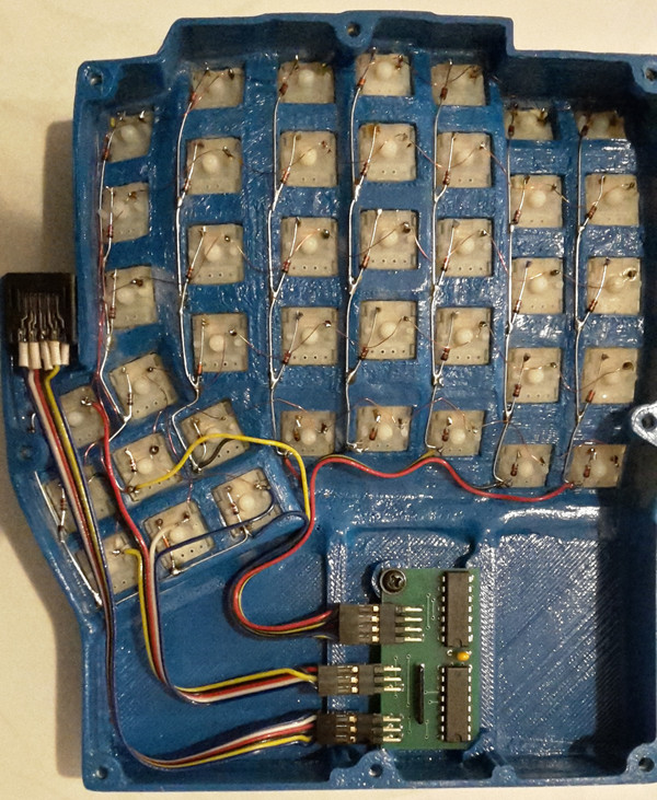

09 Aug 2015, 16:46
I finished my v0.7. Kko's "v0.7" was slightly different (oLoad/iData swapped and small differences in the top row non-pinkie keys).
Anyway, this is the same as the published files. The only difference is that the controller PCB has also the components with reference numbers 10 and higher installed (and not necessarily the same as it is proposed in the schematic). So if you built it then this is what you get:

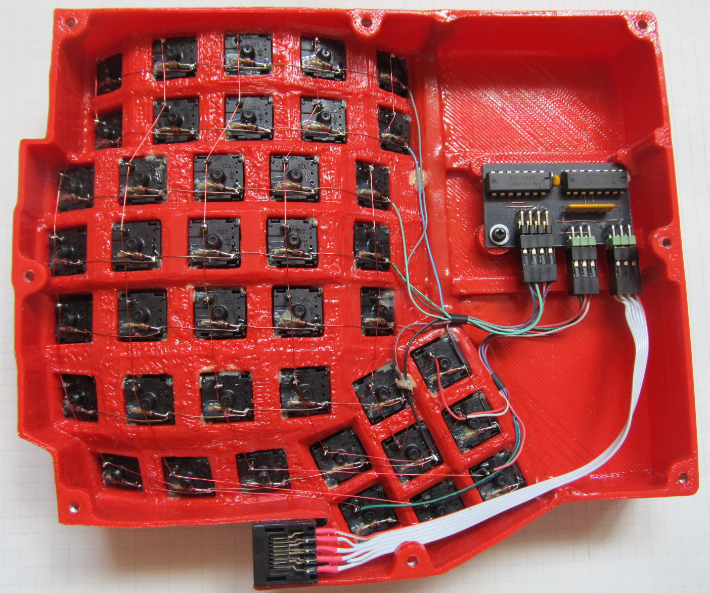

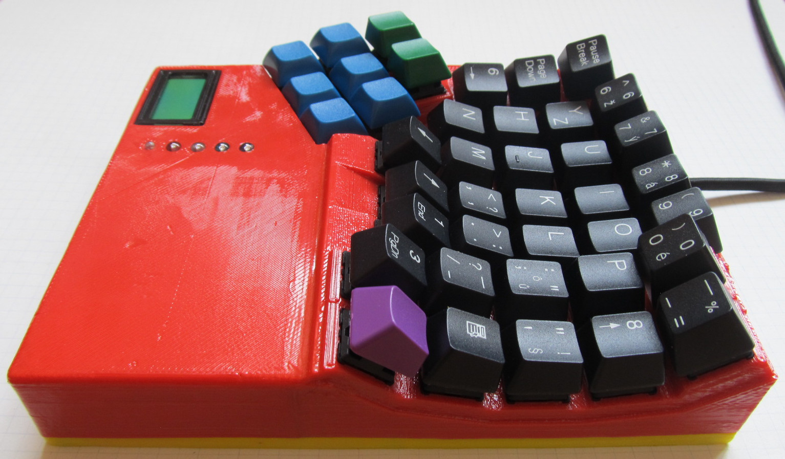

Here it is how does it look inside:

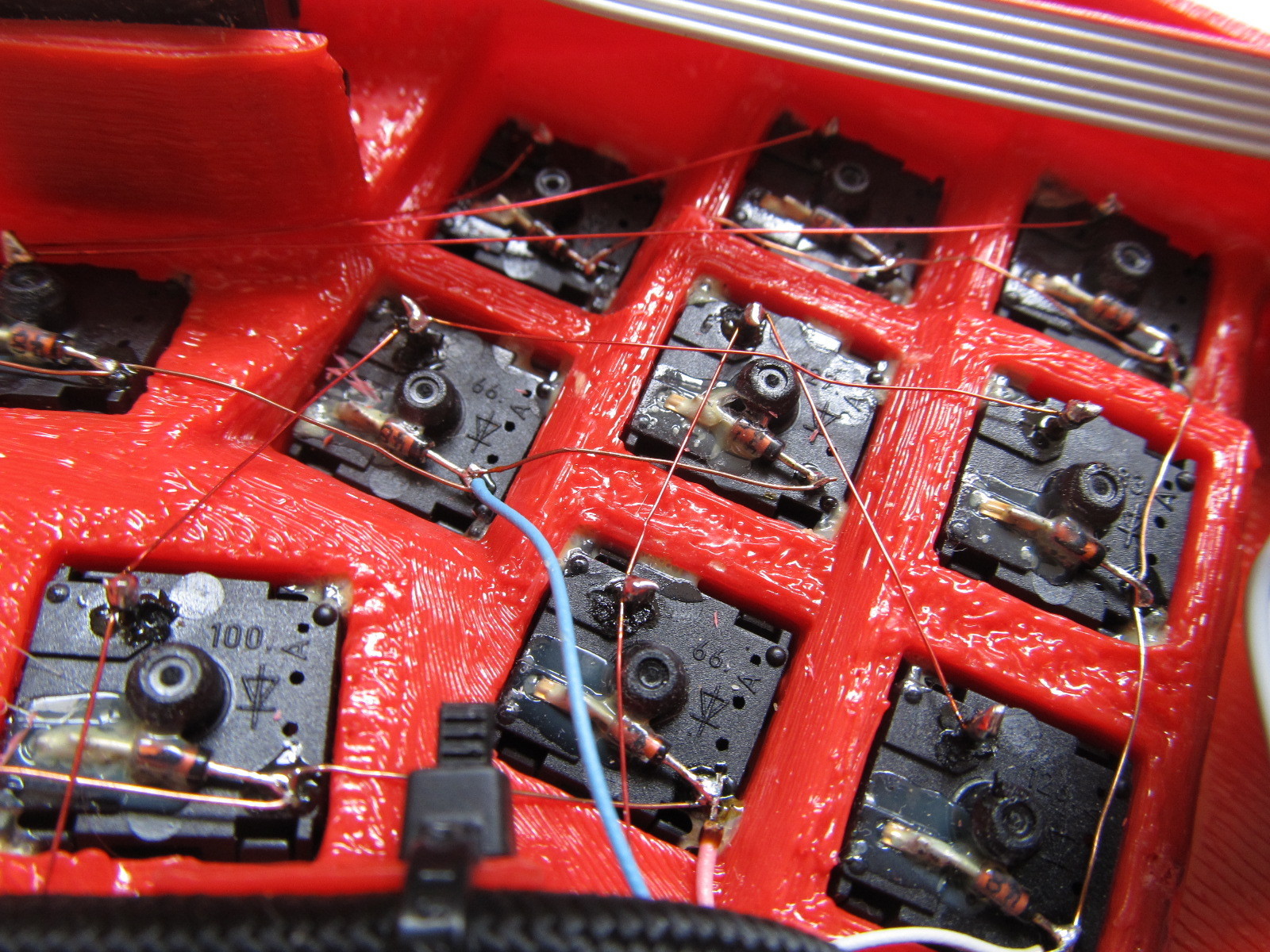

The left and right side PCBs are attached with a Ø 3 x 7 mm screw in one corner (the other corner is inserted into the corresponding slot). The controller PCB has one more optional screw. LCD PCB has metal mounting pads on one side. These were cut away and the PCB corners on that side are inserted into the little slots on the case. The other side is supposed to be mounted with Ø 2 x 7 mm screws (but I did not have screws so I used hex slot bolts). The top and the bottom of the case are connected with M3 x 6 mm hex slot bolts.
Columns of the switch matrix are connected with Ø 0.25 mm bare copper wire. Rows are connected with Ø 0.2 mm enameled copper wire. This way one does not need to bother with stripping insulation.
It works fine. This was written using the keyboard. I was asked to post some reachability pictures. I'll try to post them the next time. Hopefully the next weekend.

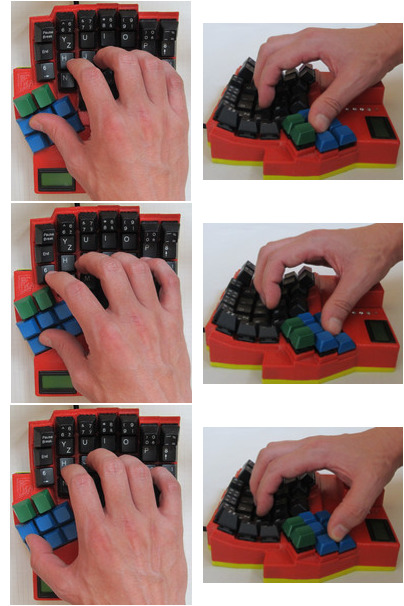

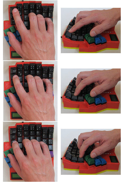

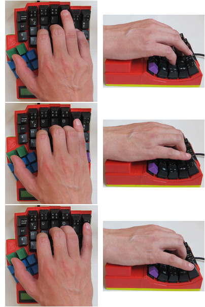

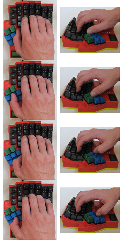

29 Aug 2015, 23:14

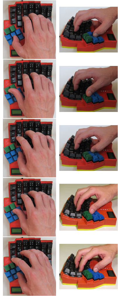

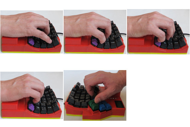

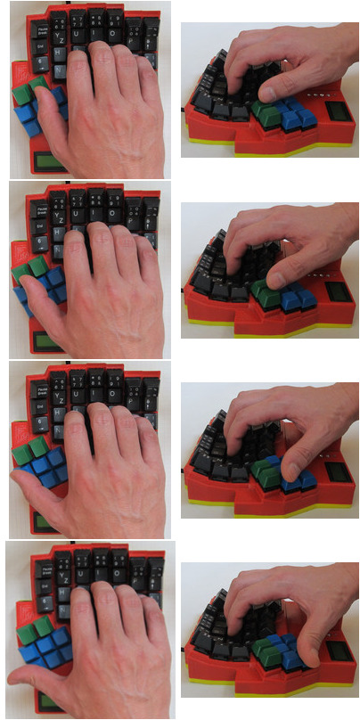

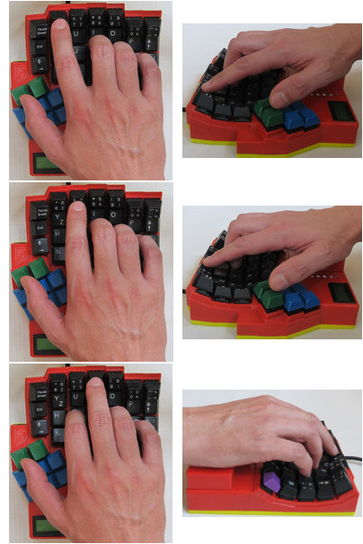

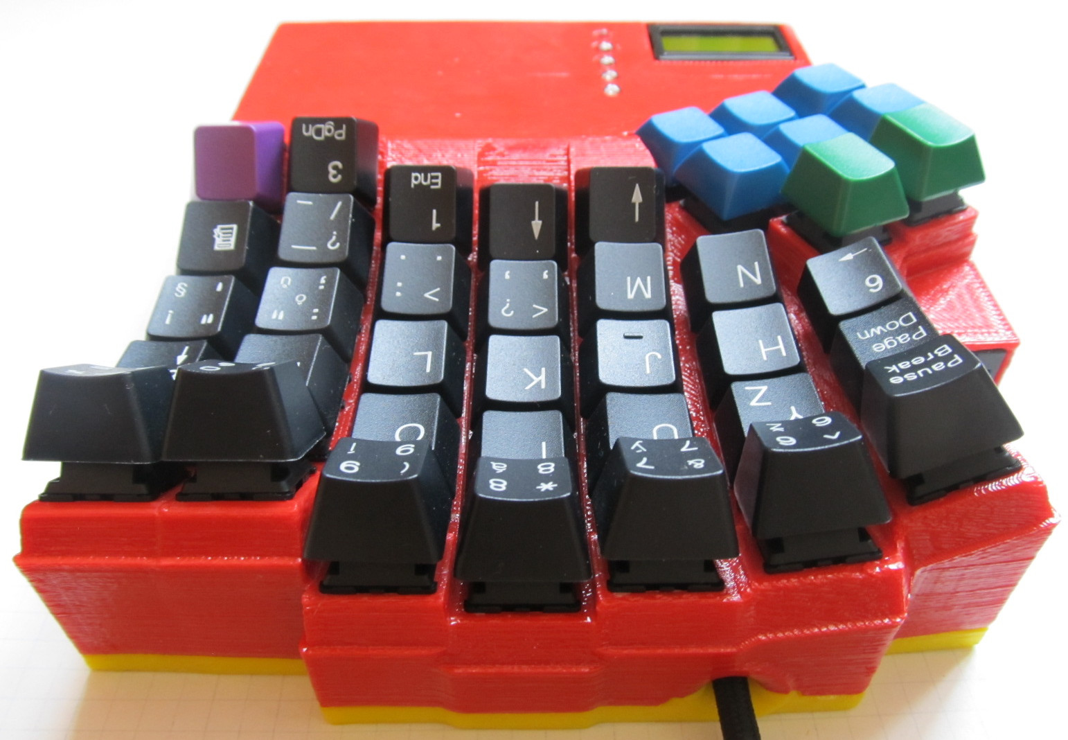

Ok, the reach-ability pictures. If I would know it is so much booring work I would not agree to post them. Me, stupid :lol:

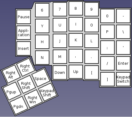

Here is the layout so that we know the positions of keys I'm talking about.
The pictures are done using a hand which has 195 mm from the tip of the middle finger to the first wrinkle on the wrist. So it is probably bigger than average. The home position is at Space-J-K-L-; keys. Despite that most pictures have thumb positioned on the Alt key. It is done that way so that the wrist position is always about the same. I keep my wrist at the rests in such a position so that I can just reach the nearest bottom corner of the Alt key. Well I should keep the wrist just over the rests but I'm lazy.
As for as the comfort to reach a key, the rows are ordered like this (from the most easy to the most hard): home row, row just below it, row just above home row, the bottom row, the top row.
So here are the pictures of the top row reach-ability:
The outer pinkie column. The top two keys are not a problem. No wrist movement needed. The bottom two keys (enter, keypad shift) require a slight wrist rotation.
The inner pointing finger column. Pause key is easy to reach without wrist movement. The two bottom keys (application, insert) require a slight wrist rotation.
The outer thumb cluster keys. All easy to reach without any wrist movement. Of course the alt key is pressed only in the corner but that is not bothering me.
The inner thumb cluster keys. Space key is the home key for thumb so it is the most easy :). Shift key is the second most easy to reach thumb key. Keypad Shift key is easy (still not writ movement). Win key is the worst from the 4 inner thumb keys. I do also a slight wrist rotation there.
I typically do not do chords on one thumb cluster if the chord needs only two modifiers. In such a case, I press one of the modifiers on one thumb cluster and the second modifier on the second thumb cluster. But there are exceptions of course:
More complicated chords on the thumb cluster which use only one thumb (no other fingers involved). From these I use only Win-Shift and Ctrl-Alt. Both of them are easy to do. It would be easier to do LayerShift-Space chord than Win-Shift but LayerShift-Space chord is not useful to me. The keys in these chords have different height. The idea is to press the higher key from a side and with the very tip of the thumb. This compensates for the keycap height difference. I do a tiny wrist rotation for Win-Shift chord.
Shift-Space and KeypadShift-Win chords would be much easier with 3dPrinted keycpas which close the space between them but I do not need these chords so I did not bother with custom keycaps. Both of them require significant wrist rotation and the second one also a small movement. Edit: With the special keycpas, there would not be any wrist movement for Shift-Space chord and there may be a slight wrist rotation or movement for the KeypadShift-Win chord.
Chords on the thumb cluster I never do but that can be reasonably done. PgUp-PgDown chord is actually very easy to do without any wrist movement but it is not useful. Shift-PgUp and Win-PgDown require wrist rotation, the second one quite significant and maybe even a movement.
Extreme chords - i.e. the ones which require more than 2 modifiers. I do all the modifiers with one hand by moving hand to the thumb keys. I use thumb for one key and fingers for the other thumb keys as necessary (one finger per key). The other hand presses the final key of the chord. This way complicated combinations like Ctr-Alt-Shift-F3 (or because of layering it is actually Ctrl-Alt-Shift-LayerShift-3) are easily doable. This is possible thanks to the fact that all modifiers are on thumb clusters. I never regretted moving Shift to the thumb cluster :lol:

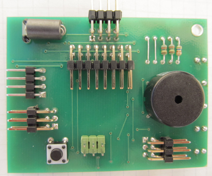

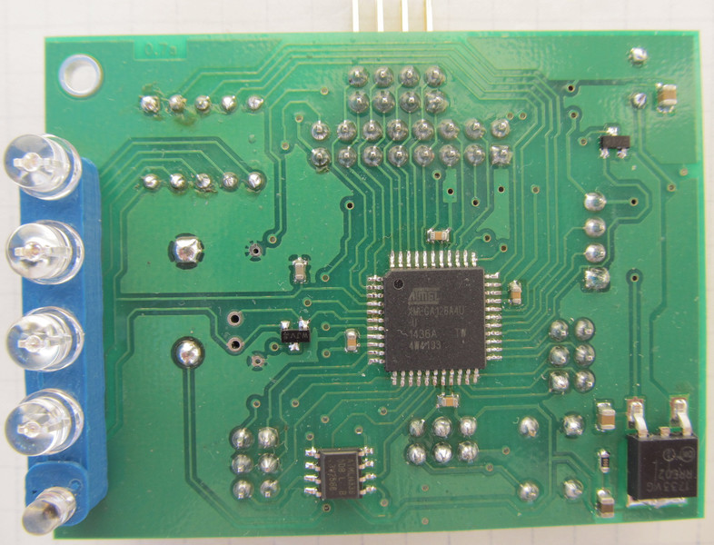

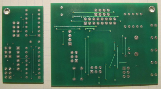

Btw: here are the expensive PCBs (as you can see I forgot to order the silk layers):
As for as the progress. I'm not sure I did anything from my last post. Well the PCBs were ordered and they arrived and I enabled photosensor and the LED brightness is now controlled based on it (this patch is not yet on github).
As for as the layout. One can define any layout one wants. All the keys (except program, and keypad shift/switch) are on-the-fly programmable as well as programmable from a PC application (working on linux only for now). Modifying physical location of program and keypad shift/switch can be done only by modifying the firmware source code. Chrisandreae posted a patch which allows to reassign these special keys from the PC application (i.e. no source code modification will be needed) but I did not merge it yet. As for as the keycaps with proper labels - I do not intend to solve this (definitely not in near time). People who do not care about keycap labels can get keycaps extremely cheaply from 7bit. It can be as low as 0.1€ per piece. Well, at least till his overflow stock sells out.

The controller PCB populated:
It took about 3.75 h to solder parts to the right hand side by a person with significant soldering iron experience and only limited hot-air experience (about 20 h ?). All SMD parts took about 0.75 h using hot-air and the rest was the through-hole parts using an iron (lot of work with splitting pin headers to the required size and clipping the leads). Left hand side PCB took about 45 minutes.
Edit: The photo sensor support is pushed to github.
And the pictures of the raw printouts:
  • bottom part underside
  • bottom part upper side
  • palm part underside
  • palm part upper side
  • key part underside
  • key part upper side
Zekromtor
05 Nov 2015, 06:55
Man, you're still at it :)
Looks great!
CrimsonFlame
05 Nov 2015, 15:40
Awesome! Glad to see you pushing ahead. I've had to shelve mine for a bit, until I've saved up enough to spring for the parts needed (pretty much everything but the printed parts ;) ). Though I finally got my hands on a key tester and found the keys I like.

The buzzer is for:
  • Beeping when a key is pressed. You can switch this on or off. It is somewhat useful when you use linear switches and do not have any audible feedback when the actuation happened. Tactile switches do not need it much (there is a tactile feedback). Clicky switches are loud enough on their own. This beep is rather quiet now but it can be done more audible.
  • More audible beeps when switching between keypad and normal layer and especially when some of the LED state changes (e.g. when caps-lock gets activated/deactivated). This is quite useful.
  • It also indicated some error states. I may have removed this. Or maybe it is still there. I do not remember. The error states are better indicated on the LCD now.

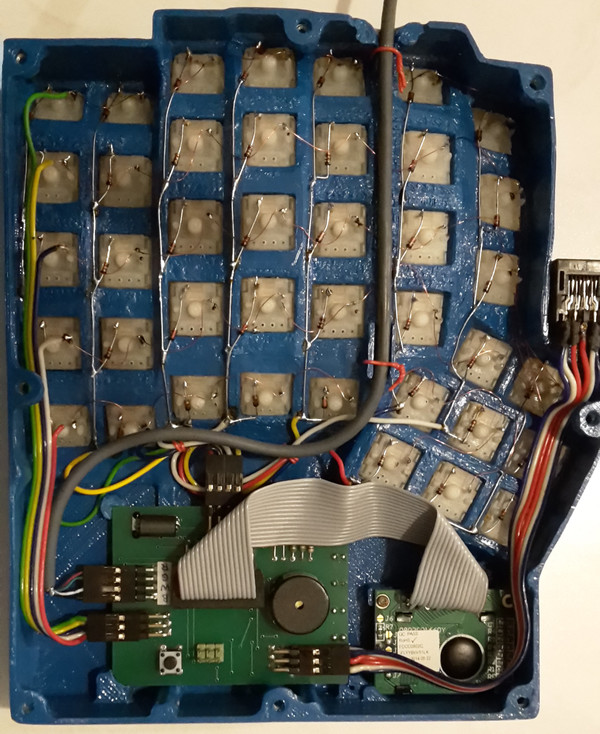

sva (the one with smaller hands) has built his Katy v0.7. I guess it is worth a post since it is the first version which was not built by me or kko. Me and kko do not count since we co-developed it :lol:
Edit: And one more contoured keyboard you can build yourself.
