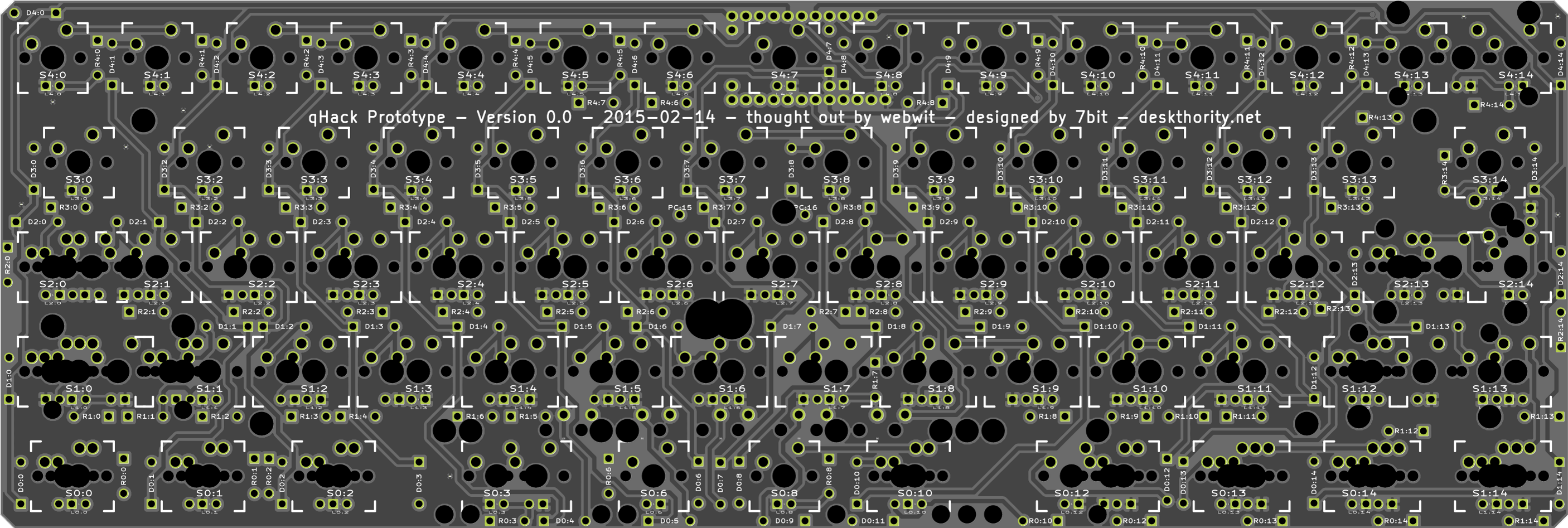

WOW, that's a flexible layout.
I have a question, sorry if this has been explained before: how do the LED circuits work? Seems like the square feet of the LEDs are connected to ground, the round feet of the LEDs are connected to the round feet of the resistors, but the square feet of the resistors look like they're connected to nothing? Is there a third layer or how does this work?
- 7bit
- Location: Berlin, DE
- Favorite switch: MX Lock
- DT Pro Member: 0001
You need to wire them to an LED controller, because the Teensy can't handle so many LEDs and LED support was not the main development goal.
LED-support on the PCB is for the 2 top corner keys and the usual Caps Lock position.

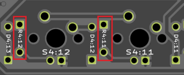

A question from a lazy guy that do not want to reverse-engineer the board that has received at home
Can someone tell me the reason for all these resistors and which resistor shall I use with it ?

jacobolus
- Location: geekhack ergonomics subforum
- Favorite switch: Alps plate spring; clicky SMK
In your picture, there are places for diodes as part of the switch matrix, labeled "D4" (you want 1N4148 diodes for these; some PCBs have a place to put surface mount diodes, but this one looks like through hole only), as well as places for LEDs which should fit through the diode holes in a Cherry MX switch, below the "S4" labels.
- flabbergast
- Location: Southampton, UK
- DT Pro Member: 0120
Just to recall what what mentioned a few posts above: yes there are holes for LEDs and resistors, but they are not connected to anything on one end; meaning that if you do want to actually use the LEDs somehow, you'd need to wire actual wires from one end of every resistor (namely the square pad) to somewhere.
