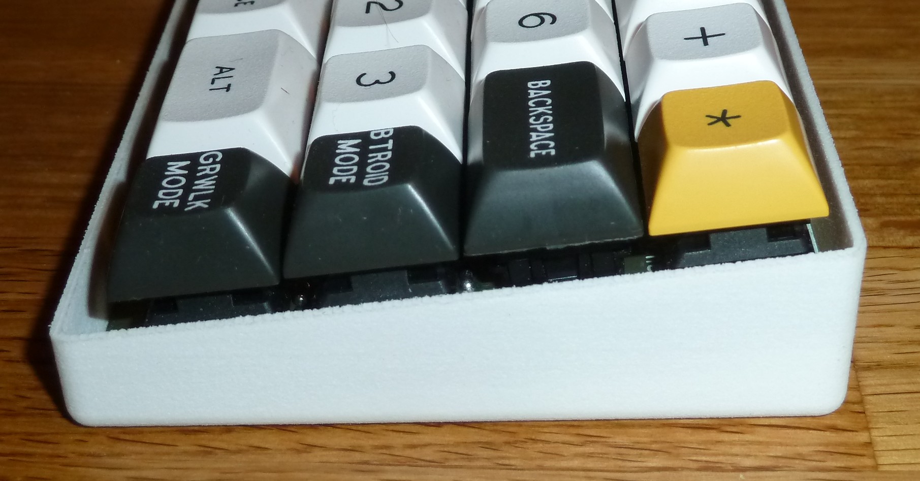

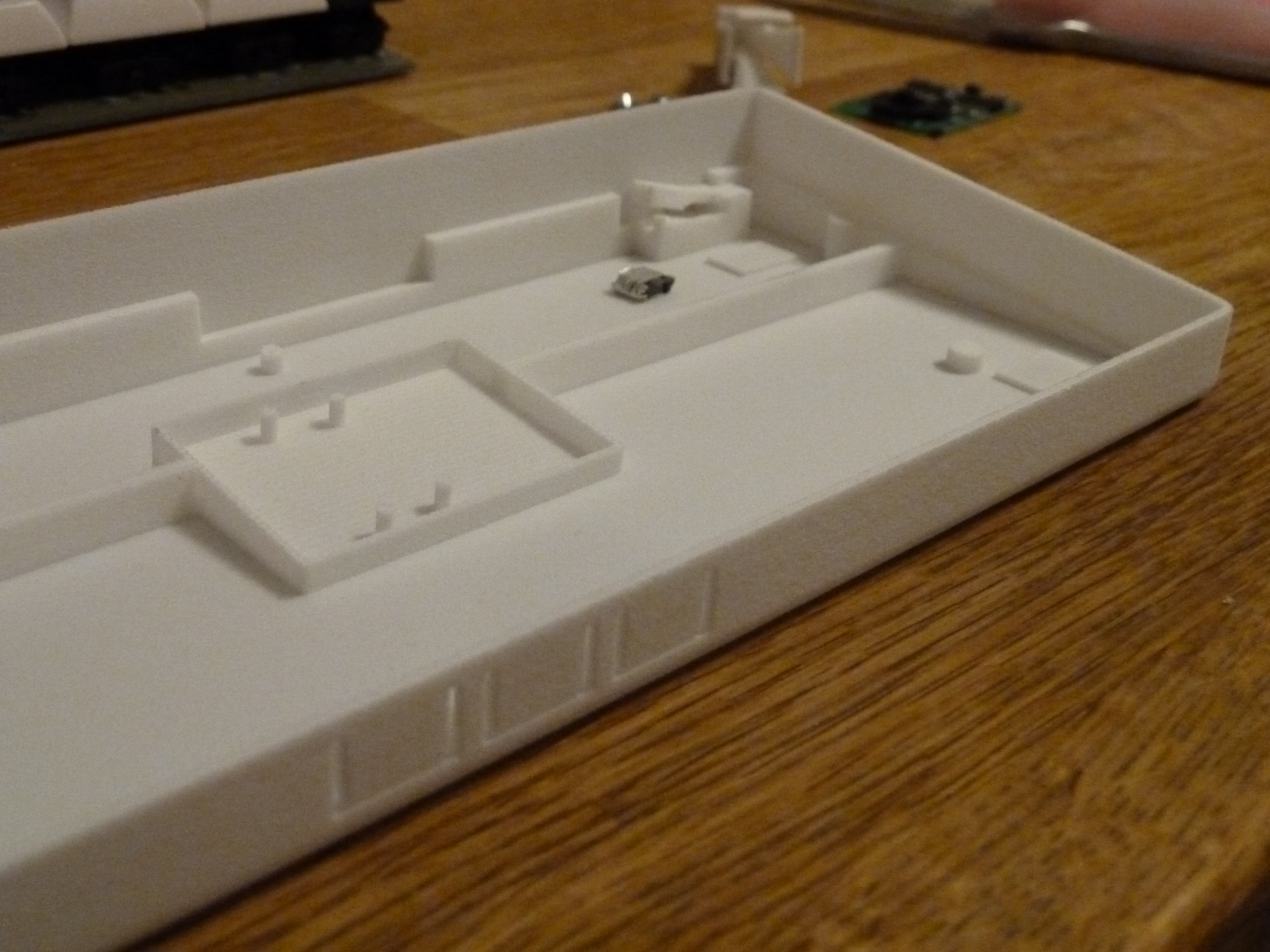

I don't really see the point of a plate with such a tiny pcb - since it is supported by a small ridge all around and further supports underneath there is no bending at all. But of course I plan to fill the gap in the front and any possible free areas to the sides for other switch layouts :-)
But so far I'm glad I managed to build a solid base on the first try so I don't have to carry around that foam mat any more. Some measurements are still a little off but nothing really upsetting or inhibiting daily usage.
Inside with trackpoint holder, micro usb adaptor and support ridges

side view
side view

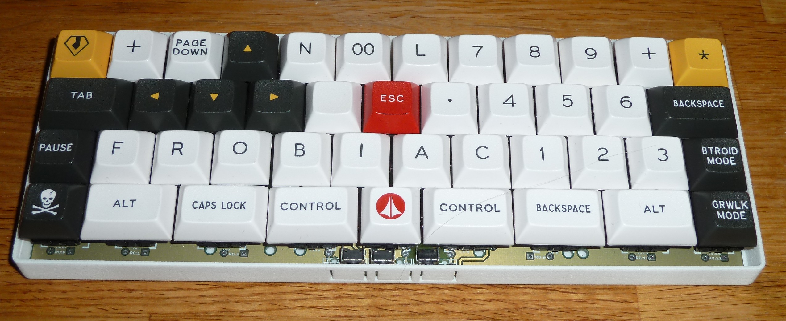

Sorry for posting this so late -- I got the prototype, switches and caps I won from 7bit. Thanks again 7bit! :D Some nice extra caps, too, I'll have to see what I can make of them layout-wise, one should maybe be usable as a space bar. 8-)
Which thread should I read to know what to do to assemble it, especially about the trackpoint? The interest check?
I understand that the prototype has been shown to work ok, right? Any caveats besides the small gaps and the teensy LED?

That case looks great, Suka! Did you 3d print it?

scottc wrote: That case looks great, Suka! Did you 3d print it?
Indeed I did :D

It was built on the same machines as shapeways uses with the strong and flexible material. Once done, I'll plan on also making it available there.

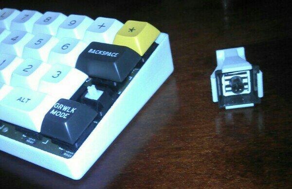

EDIT: the microswitch buttons (mouse buttons) seem to be connected on the PCB so that the circuit is closed when not pressed. Do I have the wrong switches? I tried the microswitches in several old mice that I have here, which all fit mechanically, but they all connect the center contact to one of the outer contacts when pressed vs. the two outer contacts when released.

As for the mouse buttons: just cut one outer pin of the switch and bridge the unused center pad to the side.
