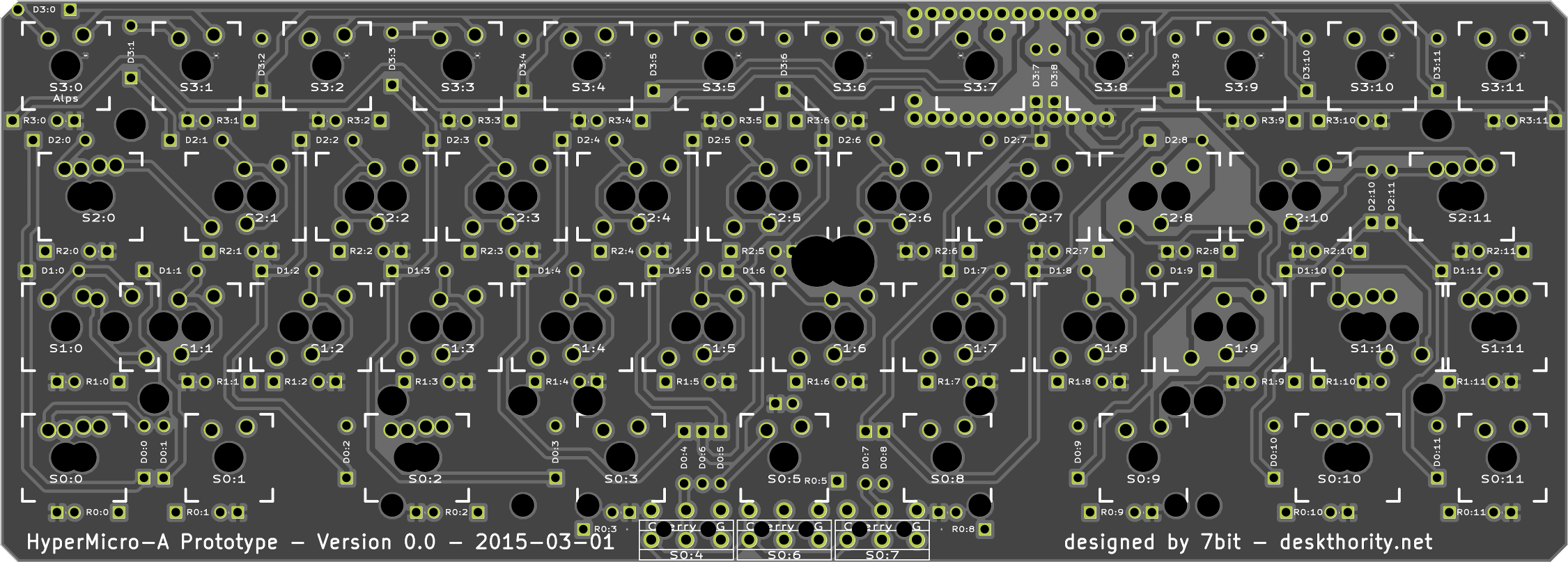

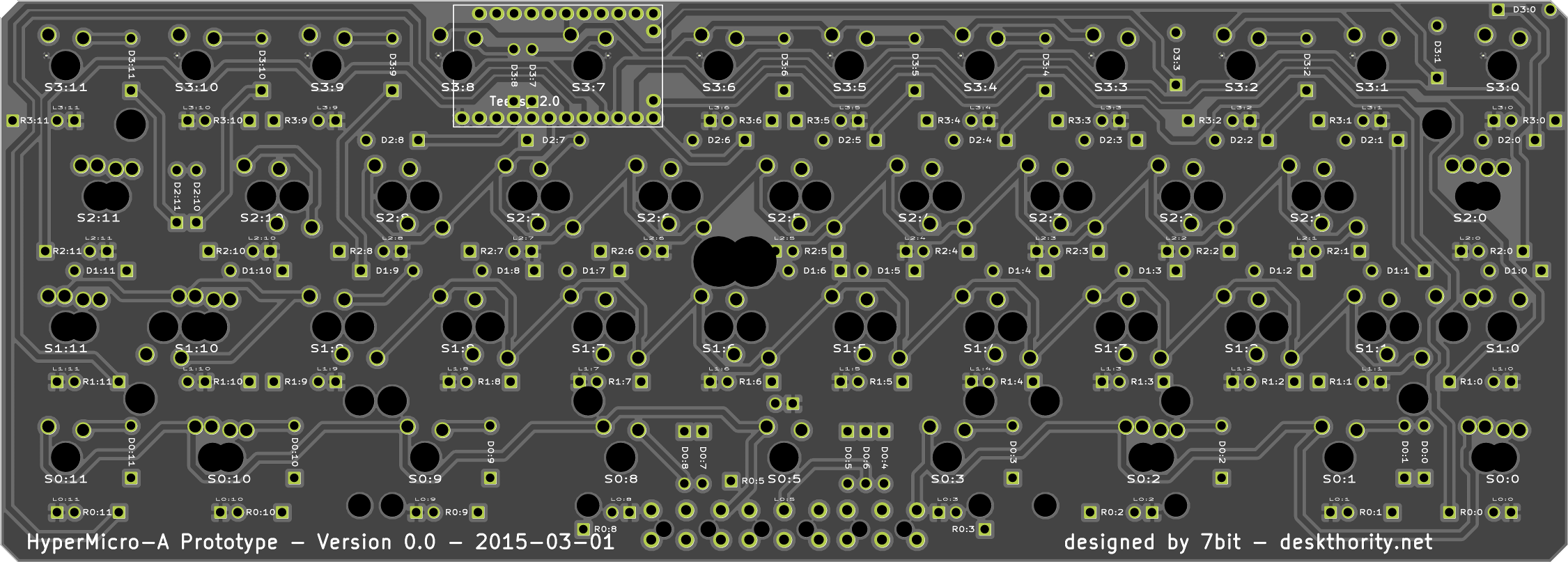

HyperMicro-Alps version:
:ugeek:

Alps? Where?
01 Mar 2015, 18:10
In the CherryMX group buy, you can order ALPSMT and ALPSMC.

Why did you leave the central holes in? Are there Alps switches with pins?

For backlighting LEDs.

Oh, that's what it's about. All I could see was MX-lookalike footprints.
And the stabs? I guess they're pretty optional on this board, and SP's "Alps mount" caps are hybrids anyway so will take MX stabs. Beware anyone thinking of using classic Alps caps though.
01 Mar 2015, 20:46
Most of the layouts don't require stabs anyway, so it's a perfect match for ALPS switches! Apart from, er, the lack of nice caps to begin with...
01 Mar 2015, 20:49
Well that's what I mean. You have to go deep catalogue to find matching mods for a stab-less layout. Who's got exotic stuff in Alps mount like 1.5u space bars and 1u mods?
