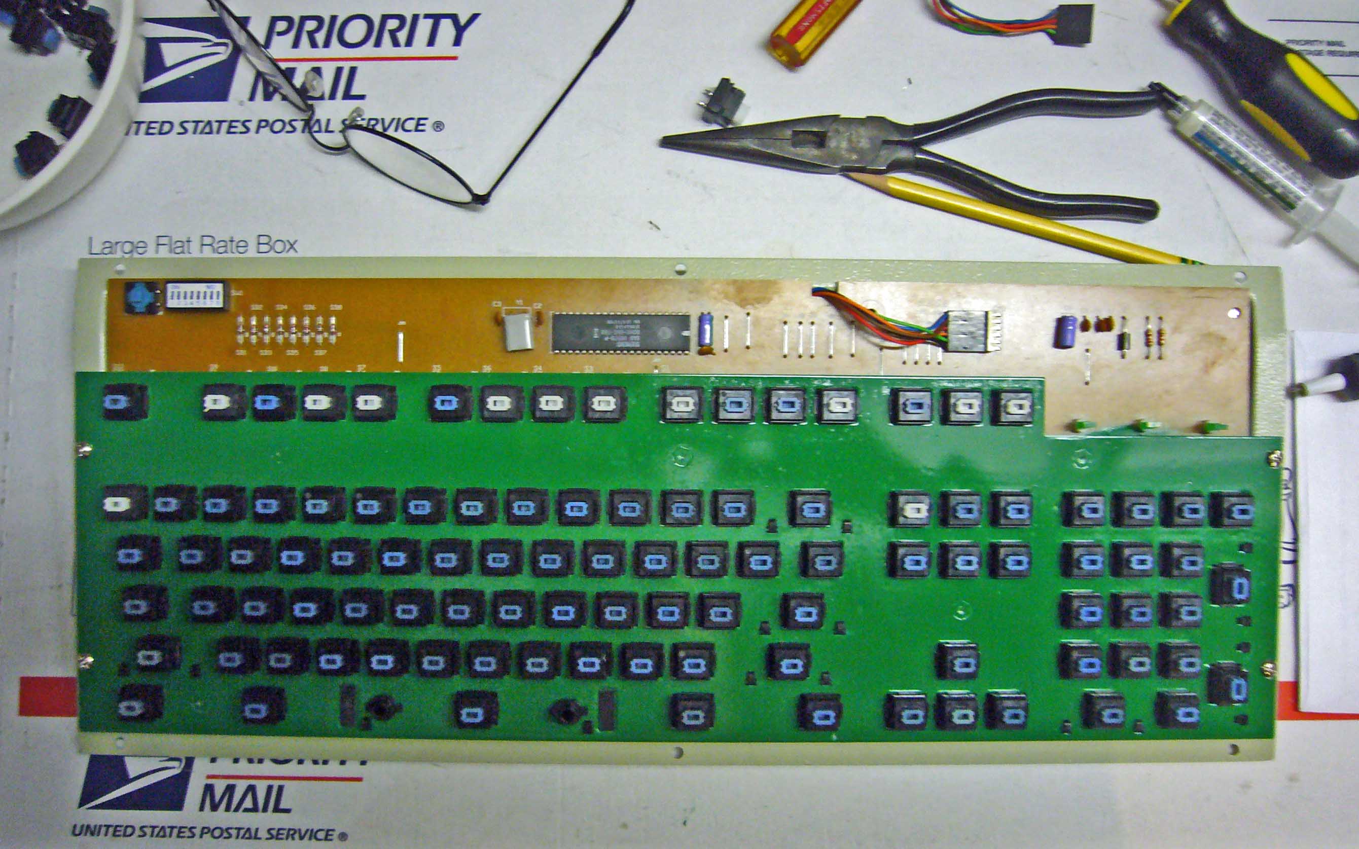

Northgate made it ridiculously difficult to separate the front plate from the PCB, but you can do what you need to do from the top, clean it by wiping and blowing rather than immersing and scrubbing, then slide strips of paper between the parts to mask the PCB from the spray paint. (you can see overspray from my imperfect job around the center LED)
I strongly prefer Rustoleum for iron and steel, it is made to inhibit future rust.

@fohat: How did you protect the PCB from the dust that was generated when you sanded the plate?

To Hypersphere's question of protecting the PCB: I don't know how fohat did it, but if it were me, I would desolder all the switches first.

Well, of course you will need to remove the switches and the stabilizer hold-down tabs.
I did it outside on the rail of the deck, with the plate held upright so that the dust fell downwards. I only sanded the actual rust, using a fine sandpaper and my index finger. Afterwards, I vacuumed and then blew out as best I could, wiped the plate with alcohol, and painted.

@fohat: Thanks for the details about prepping your Omnikey 101 plate for painting. Is the plate in this keyboard especially prone to corrosion, or is this about what you should expect after many years of use? It's unfortunate that a better corrosion-inhibiting coating was not used when these (and other) keyboards were manufactured. Alternatively, it would have been nice if they had made it easier to separate the plate from the PCB. On the other hand, the situation gives us the opportunity to exercise our ingenuity to solve these little problems.
