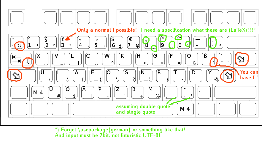

Zehkul wrote:
7bit wrote:OK, here comes NEO (first version). Please don't kill me if it is not what you think NEO should be!
Looks nice indeed! * on the O key is a bit off. Dead keys are missing, too, but I don’t really know what to do about them, either. RC-1140 suggested this.
The different font on ‚ „ compared to ‘ “ and ’ ” looks strange, too, kinda. Funny that SP can’t do ℓ :lol: (And ſ :lol:)
You should give me the LaTeX codes for these many quotation marks. The hand-written l would cost extra and the long s is obsolete since the late 1920s.
When writing Fraktur texts: you always: can use the ``:'' to indicate you don't want the long s!

My svg should help here, all symbols are included as Unicode Text.
The long s is simply sexy! "ſ" And the ℓ is the symbol for litres. One of the great advantages of the Neo Layout is that you don't have to remember all the LaTeX codes for all these special characters anymore, you simply enter them.

There are too many different NEO layout graphics floating around. I think NEO is so confusing that not even NEOists know where to put the labels properly.

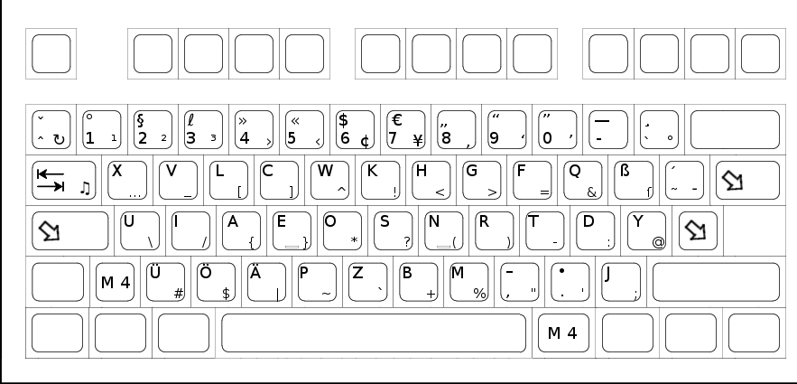

This is my current NEO mock-up with all keys you could ever need.
The third arrow is for ANSIers. Everything else is what you need for the first 3 layers of NEO. I don’t think the compose function on tab justifies another key, though. ^^ M4 would be nice as the standard SP diamond or something like that.
The characters are:
Layer1:
̂ 1234567890- ̀
xvlcwkhgfqß ́
uiaeosnrtdy
üöäpzbm,.j

Zehkul wrote:Friend with Razer BlackWidow: 11, 3... check 9, 8... check
Friend with Razer BlackWidow: 2 key stem holes?
Friend with Razer BlackWidow: ja
Friend with Razer BlackWidow: 2,2
Should be OK, then.
One center mount and two mounts 49mm left and right from the center?
Zehkul wrote: ...
At this low quantity I doubt we can do the arrows. For all kits exists symbol keys which cound be used and would not be so expensive compared to dedicated modifiers.

This forum doesn’t like thẽ kẽỹ dõĩñg thĩs! At least not alone. ̃̃ ̃~ ̃~ ~̃ ̃ ̃ ̃ :-( (See the empty row in my post above)
Symbol keys would be nice, yeah. Doesn’t SP have anything pointing at least a bit to the right? Seems rather standard to me.
7bit wrote:One center mount and two mounts 49mm left and right from the center?
I guess, yeah. The fourth mount on that odd spacebar is not used and there for whatever strange reason I don’t know.
25 Apr 2012, 21:38
Zehkul wrote:...
If I ask for 49mm, it will not be 50 or 48. So mught fit a bit tight if the measure is off too much.
Nevertheless, here is my comment on your layout. The arrows are doable, but they cost extra!

Is ‚ „ ‘ “ ’ ” ̀ ̧ not enough of a code? You can copy&paste it. :P I don’t know a thing about LaTex, sorry. ^^
Doesn’t SP have a single thing in their repertoire that points to the bottom right? 20-30$ extra won’t hurt me though, my order is way beyond any reason anyway. e,e

OK, I will do these all with commas, hope you like it.
20-30$? LOL!
The SVG legend fees are not really relevant compared to prices for low quantities of key caps.
NEO will be the only language kit which will have dedicated modifiers!!!

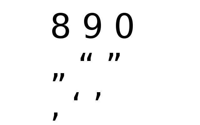

Even if I don't want to buy one of the Neo Sets: Here are the requested specs for the quotation marks.
2nd Layer:
8: "\glqq"
9: "\grqq"
0: "''" (the quotes you get when you place the single quote ' twice)
3rd Layer:
8: "\glq"
9: "\grq"
0: "'" (the quotes you get when you place the single quote ' once. But note that these might result in different quotes with \usepackage[ngerman]{babel})
25 Apr 2012, 22:48
RC-1140 wrote:Even if I don't want to buy one of the Neo Sets: Here are the requested specs for the quotation marks.
2nd Layer:
8: "\glqq"
9: "\grqq"
3rd Layer:
8: "\glq"
9: "\grq"
^^^ ngerman is even worse!
If at alI use german but here I can't, because it would break other things.
Thanks for help, I give it a try.

huh, dunno I would have to google it. And btw. the thingies on 4 and 5 are "\frqq" "\flqq" "\frq" and "\flq"
edit regarding your edit: wut? It's just what is said here: link What does your \myfontkey do?

Remember, those images were originally intended for dye subs where it doesn’t matter at all what keys you print on. :lol:
RC-1140 wrote:0: "''" (the quotes you get when you place the single quote ' twice)
What? Those are clearly angled, too.
RC-1140
25 Apr 2012, 23:15
Zehkul wrote:Remember, those images were originally intended for dye subs where it doesn’t matter at all what keys you print on. :lol:
I was talking about LaTeX. If you place two single quotes behind each other, LaTeX will turn them into the english right doublequote.
