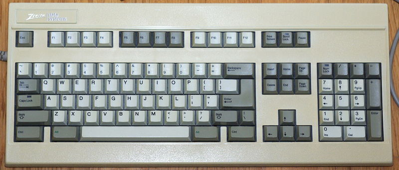

wiki/Zenith_ZKB-2
Hypersphere
10 Sep 2016, 00:13
It's interesting to look at keyboard layouts and trace the evolutionary patterns. The ascending limb of that Return key reminds me of a vestigial organ waiting to be surgically removed like an inflamed appendix, whereupon the Backslash could be free to slide into place and expand a bit to crowd the swollen Right Bracket back down to size. However, I would want to keep a 1.00x key to the right of the Right Shift -- a perfect location for a Fn key. Are the mods on the bottom row 1.75x?
10 Sep 2016, 00:27
Hypersphere wrote: Are the mods on the bottom row 1.75x?
Yes I believe they are. The position of dash under return is also quite unusual. That right bracket is just silly. They also split "0" and "." on the numpad 50/50.
emdude
Model M Apologist
10 Sep 2016, 00:32
I definitely agree about that right bracket key. Zenith should have kept it 1u and went full Big-Ass with their Enter key.
That and the other weird design choices aside, I kind of like that layout because it's more or less the Focus layout.
10 Sep 2016, 00:36
In terms of build quality the Zenith is on another level, the case is sturdy as hell, the metal plate is heavy duty. It's a tank.
10 Sep 2016, 01:40
Yeah, it's pretty much the Focus layout with a slightly less practical enter key and a weirder keyset, which makes it very hard to find a proper replacement set.
The Zenith really is more of a special board though. You can get smooth linear Alps anywhere, and there are other Alps keyboards with this kind of build quality. But the Zeniths just have a kind of zing to it. I'm typing on mine right now as a matter of fact :) .
