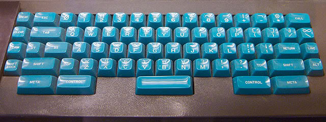

SA? Those are pretty damn tall. A more common profile is the shorter spherical DSA:
DSA has the unusual advantage of being uniform across all rows. You can move them all around the keyboard, and they still feel right. It's the one I'd put on an ergo. In fact, here's an active DSA group buy for the Ergodox among other things.

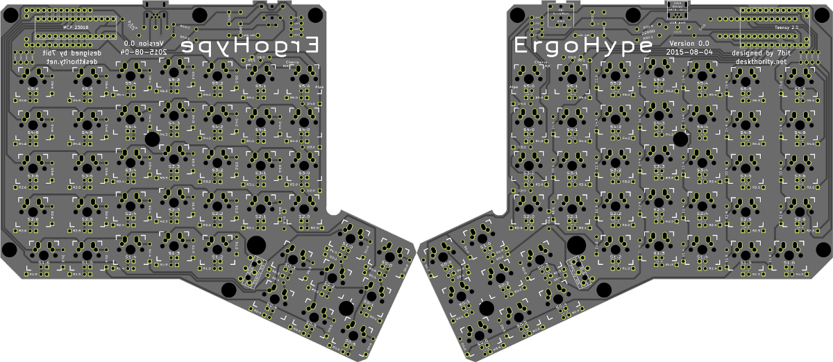

10 Aug 2015, 22:41
I'm working on an improved version of the ErgoDox design, that fits into existing cases.
I've added support for Alps switches, a trackpoint hole and a mouse button.
It is possible to add LEDs to every switch. to be wired to a dedicated LED controller. But there are also some LED-pads that can be connected to the Teensy.
Now my question:
Is it possible to connect LEDs to that MCP23018-thing?
Here is how it looks like:
litster
11 Aug 2015, 01:29
If you do want to change the layout that would require a new case design, I would be happy to make modification to my original ErgoDox case design.
macmakkara
11 Aug 2015, 07:57
HMM.. I believe that only difference at the moment is that trackpoint hole there? And PCB is only for 80key layout.
