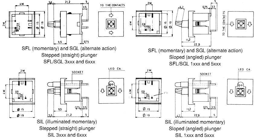

Clare-Pendar SFL Series low profile reed contact switches
These are thought to correspond to pyrelink's TI Silent 700 terminal keyboard.
These fit the Clare-Pendar keytops.
They are not thought to be Cherry MX compatible.
Datasheet: http://www.visualux.com/catalogues/kswitch.pdf
Initial interest check
Please post the part numbers and quantities you are interested in!
A quote request can then be raised to confirm MOQ and costs.
Product availability, MOQ, setup and unit costs are currently unknown.
Switches
Part number format: SxL1203
Switch type:
SFL: Momentary (standard key switch)
SGL: Alternate action (latching on and off - like an MXLOCK!)
SIL: Illuminated momentary - accepts T1 LEDs with adapter or T1 bi-pin incandescent lamps - see options below
Plunger (stem) angle:
1: Sloped [angled plunger] with 5mm contact terminals
3: Stepped [straight plunger] with 5mm contact terminals
5: Sloped [angled plunger] with 3.5mm contact terminals
6: Stepped [straight plunger] with 3.5mm contact terminals
Contacts:
1: 1 form A (SPST)?
5: 1 form A with in-line diode on cathode side
0: None
(Mandatory 0 - unknown specification)
Operating force:
1: 50 grams
2: 80 grams
0: Fixed plunger
Part number examples:
SFL6101 (momentary, straight stem w. 3.5mm terminals, no diode, 50 gram op. force)
SGL6101 (alternate action, straight stem w. 3.5mm terminals, no diode, 50 gram op. force)
SIL6101 (illuminated momentary, straight stem w. 3.5mm terminals, no diode, 50 gram op. force)
SFL5101 (momentary, angled stem w. 3.5mm terminals, no diode, 80 gram op. force)
SFL6501 (momentary, straight stem w. 3.5mm terminals, in-line diode on cathode side, 50 gram op. force)
SFL6102 (momentary, straight stem w. 3.5mm terminals, no diode, 80 gram op. force)
SIL Series switches Lamp and LED options:
T1 bi-pin incandescent lamp: 104577-??
Choose rating:
00: 5V 75mA
01: 12V 60mA
02: 18V 26mA
03: 28V 24mA
Recommended: 104577-00 (5V 75mA)
nb. Check the current capabilities of your equipment! USB isn't designed to drive lots of incandescent lamps!
T1 LED: 104139-??
Choose colour:
00: Red
01: Orange
02: Yellow
03: Green
LEDs also require mounting adapter 104293-00
Switch specifications:
50 million operation lifetime (SFL, SIL), 1 million (SGL)
Tinned silver contacts
0.9mm pretravel
4mm travel
0.5mm overtravel (SFL, SIL), 1.1mm (SGL)
0.5mm release
Contact terminals 3.5mm or 5mm
Panel cutout 15.12mm ±0.1mm, max panel thickness 1.5mm
All switches are frame and PCB compatible with corresponding high profile SF series switches

80g sounds nice, why are the stems angled tho?
@7bit id like a Hyper1800 with these please
EDIT:
Illuminated momentary does this mean they are illuminated and remain so regardless of the switch being actuated AND momentary or they are illuminated when the switch is pressed.
28 Feb 2015, 19:28
It seems there exist both variants, angled and upright, like with some Cherry switches, or the Micro Switch hall-effects.

SL89 wrote: 80g sounds nice, why are the stems angled tho?
The angled stems are to replicate the profile of stepped rows (as associated with older typewriters) on a single sloped plate/PCB. Check out jacobolus on contemporary use of SA keycaps. The keytops all appear to have unangled, level tops and straight stems.
SL89 wrote: Illuminated momentary does this mean they are illuminated and remain so regardless of the switch being actuated AND momentary or they are illuminated when the switch is pressed.
The SIL diagrams looks to have two extra pins for lighting, so the illumination will be independent of the switch function. Well, unless you wire it in series!

What does "5mm/3,5mm contact terminals" mean? Is that the activation point or the bottom out distance?
facetsesame
Mad Dasher
02 Mar 2015, 19:52
Nuum wrote: What does "5mm/3,5mm contact terminals" mean? Is that the activation point or the bottom out distance?
That's the length of the PCB pins, you can see these marked in the diagram. I should have made that clearer, I wasn't sure either until I saw what it was.
There were some details on the switch travel quoted in the specifications:
0.9mm pretravel
4mm travel
0.5mm release
