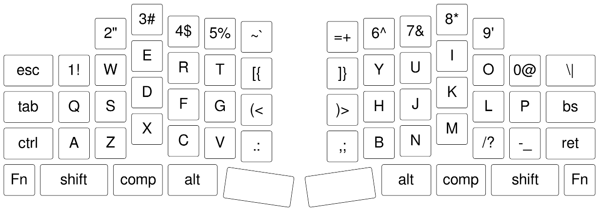

So this is the layout that I currently have in mind:
As you can see, the bottom row is shifted to the right by one, which I find looks more symmetrical than all column-staggered keyboards I've seen so far (which put T, G, and B above each other, leaving much more letters for the left hand to press than the right).
Apart from the letters, I tried distributing the symbols in a sensible manner, but practice will show what layout really makes most sense. Some of it was done by putting missing symbols into empty places, so I expect some changes here.
If I counted right, this makes it 62 keys, just perfect for a 4x8, 5x7, or 6x6 scan matrix per side.

Minimal is a lot fewer keys than you have here. I’d say you can get by with about 40 keys without sacrificing function or needing to learn anything too weird, or easily with 50. You have 62. (Nothing inherently wrong with including this many keys, just saying...)
Any particular reason? For example, are your thumbs injured, or does your hand have unusual shape / lack of flexibility? Otherwise, I highly recommend adding more thumb keys.5. No multi-key thumb cluster. I only expect the thumb to move inward, not outward,
Cylindrical which direction?6. Curved plate. In order to avoid excessive complexity, the curvature will be cylindrical. If required, this can be made up for by using sculptured key caps.
Personally I’d recommend using flat halves with the most aggressively sculptured keycaps you can find.
A cylindrical plate puts the switch axes at angles which make pressing keys more awkward / less efficient. If you want something more sculptured, go all the way and mount the switches at different heights, e.g. in a 3d-printed or milled case/plate (like Maltron-style, but more carefully designed). In particular it’s nice to mount the middle finger switches lower, and the pinky switches higher, than the other fingers, but again with the axes of the switches close to aligned with each-other.
Laser-cut wood/acrylic plate as well, or metal?7. Laser-cut chassis. The plate and its entire support structure shall be made by others (since I don't have the time) so I only have to design and assemble it.
Go for Matias switches rather than MX. MX is garbage.9. Individual switches with widely used mount and stem.
Comments on your proposed design:
- Full 1u of stagger between pinky and ring finger is probably a bit more than you want. My personal preference is about 3/4u stagger there, but in user testing I found several people who didn’t like more than about 1/2u, so that’s what I’d recommend. If you want to improve reach for the pinky column, the best solution is to raise the keys vertically.
- Assuming 'A' is roughly your "home position" for the left pinky, those escape and backslash keys are going to be an annoying stretch.
- I’d recommend less keys in the inner two columns, and maybe bigger ones. hitting those comma, period, tilde, and equals keys is going to be a pain in the ass, and requires reaching your hand. Consider just dropping those and putting some of them on a layer.
- Consider swapping ctrl and shift, putting backspace on a thumb key
- Consider putting numbers and symbols on 1–2 layers near the home row instead of their own top row. They’re much easier to type that way.
- Move the fn keys somewhere easier to reach.
- Do some careful testing to figure out where your thumb naturally lands, and make sure the spacebar is placed there. Most important, consider moving thumb keys away from the finger keys/toward your body by about 1/2u, so you can relax your fingers naturally land on both spacebar and home positions. Place the spacebar(s) directly where the thumbs land, and then place other keys afterward. Consider making the 'alt' key 1u long to make 'comp' easier to reach.

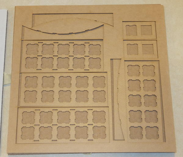

The first test file is off to the laser printer, fingers crossed. (Mu: yes, I'm thinking of something beyond simple layered plane shapes.)

Just a quick update: I got the first test cuts back from the laser cutter, they seem pretty much as expected or even better.
It's a shame I'm away this week-end and can't try them right away. I'm itching to assemble it all and put switches in.

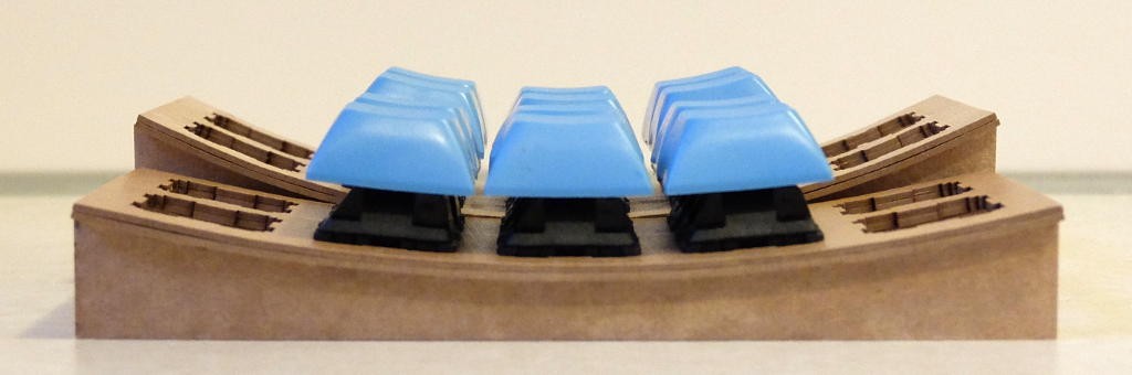

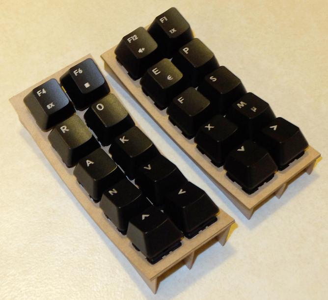

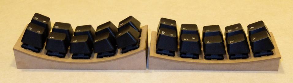

I finally assembled the two test "boards". The fit was perfect, it was only my clumsy glueing that wasn't, so here's the result. I made two in order to find the geometry that I would be aiming for in the real thing.
I hope you can see the two different curvatures in these photos. The cylinder that fits on the top of the keycaps (DSA ones, not these OEMs, but I haven't got them yet) should be 20cm and 10cm in radius, respectively.
After only a few minutes of testing, I immediately like the rather aggressive 10cm "bowl" much more.
Lessons learned so far: the material (made out of timber, apparently) is strong enough to hold the MX switches, yet flexible enough to be bent. My simple scaffolding needs improvement of course, I expected that from the start.

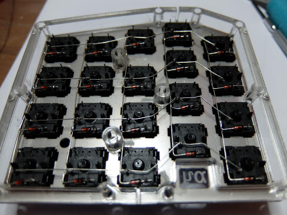

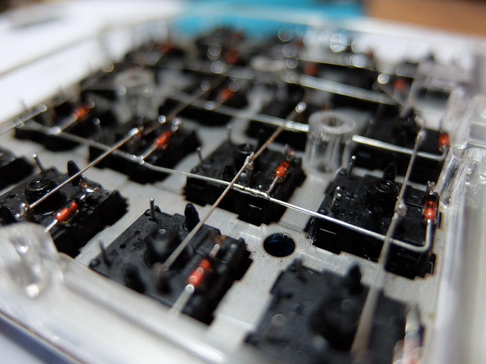

As for as the diodes on the switches. Here are two different approaches how to do it.
I do not believe I did not notice this for a whole month.
- Most people do it like Muirium here.
- I did a bit different way (which I believe is easier) here. Though I switched to an enameled wire for the rows. This way I do not need to use a separate insulated wire to connect rows with thumb cluster. The nice thing about my approach is that the you do not need to hold diode/wire in hand while soldering. You get one hand for iron and the other one for adding solder.

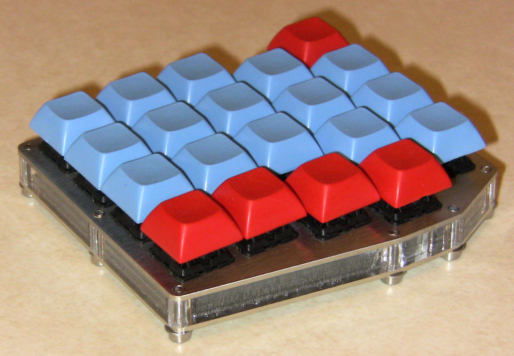

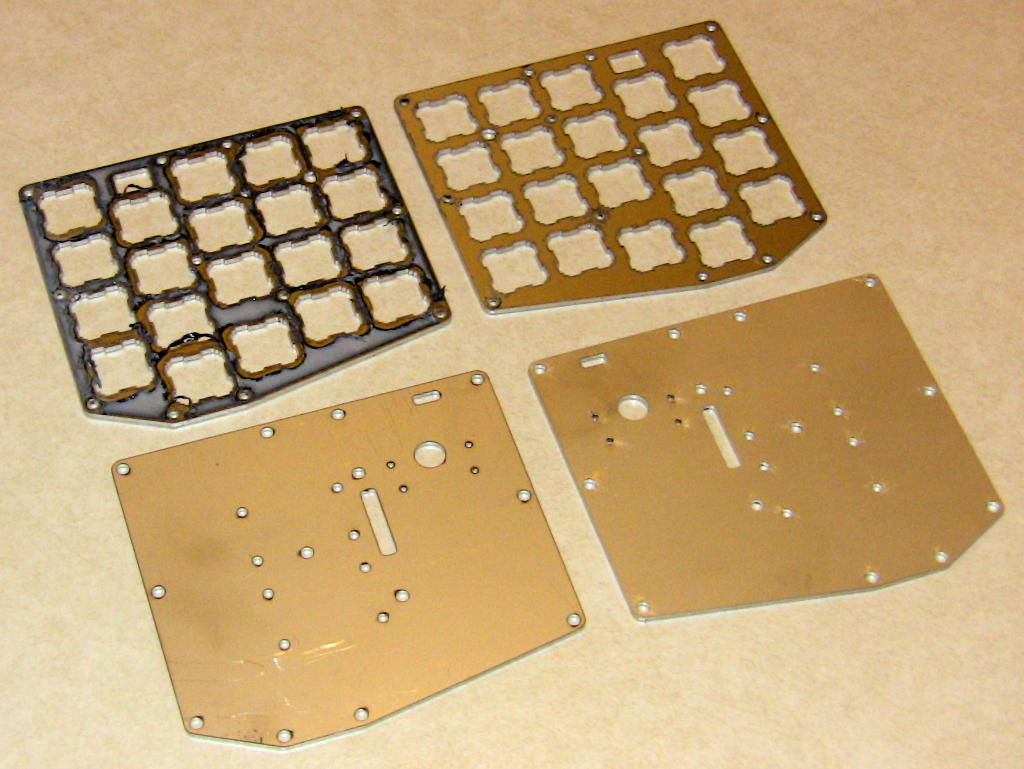

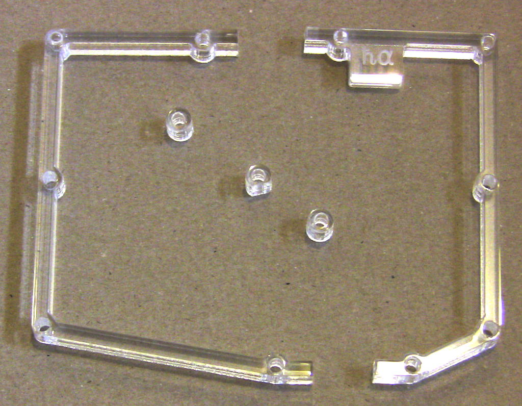

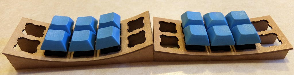

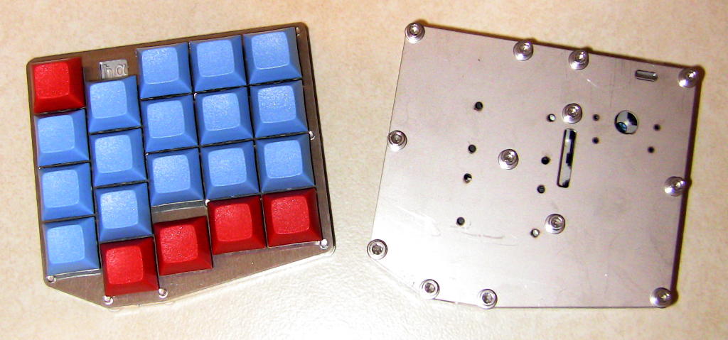

Finally got those DSA keycaps in today, here they are.
Since starting this thread, my plans for the keyboard have changed considerably. Today I learned too things, immediately obvious once I put the caps on those two 2x5 layout testers I made earlier:
First, aiming for a 19.05mm pitch measured at the top of the keycaps was a bad idea, the keys can be moved closer together vertically; the goal is probably to maintain the 19.05mm at the base of the keycap, so that the gap between neighbours is uniform. Second, given that the alpha keys only have three rows now, it appears to me that any curvature in the board is a waste of effort. My first reaction (remember, it's quite late and tomorrow I might change my mind again) is to ditch the curved plate concept altogether. For a flat plate, sheet metal and acrylic are much better materials (stronger and they don't require the scaffold that is hard to design), so I'll probably switch to one of those.

Still, that was a very interesting way to construct a curved keyboard. I have considered laser-cut wood before, but never for the plate.
BTW. If your keyboard is going to be only 3 column-staggered rows plus a row of thumb keys, and no more than 6 switches wide, then a PCB for such a keyboard could fit within 10×10 cm. Then construct it symmetrical, in the same way as the ErgoDox is and you could get PCBs for (approximately) five keyboards made from DirtyPCBs.com for only $25.
The outermost switches on the left and/or right side would hang on the edge, though.

The material isn't wood, it's called "Kraftplex", which is made of wood without added glue or binder, apparently, and mainly consists of cellulose fibres. The type I used was the thinner of the two strengths available (0.8mm, the other being 1.5mm). Bear in mind that it isn't waterproof, so I tested a light clear coat on the 20cm assembly and it seems to work (as in repel water) very well. I expect that normal use would cause it to start looking dirty very quickly unless protected somehow.
What I like about Kraftplex (and what I didn't expect before I handled it myself) is that it's less elastic than wood, so it's very easy to bend and will even stay in place if you do it right. The two layers of the plate on both assemblies I made were pre-formed by hand, then glued together essentially with no tension at all. I used clamps mainly because I (falsely) expected it to constantly want to straighten out, but I think you could easily do without them with a little practice.
I've made PCBs before and I can only say that I avoid them when I can (mainly because every single piece PCB software I've ever seen is a pain to use, and I've seen quite a few -- 2D CAD with Librecad is so much nicer and bears less risk of getting it wrong). A sturdy plate and hand-wired matrix is the way I'm going now. Currently working on the plate design. I've got plans for the next keyboard, though (maybe you can guess its name), which will use a PCB without any doubt (because there's no way around it).
ħ

Two parcels arrived today, containing this (1.5mm stainless, one side brushed):
as well as this (8mm clear acrylic):
Both shipments surprised me: the acrylic came out better than I thought, especially given that I drew holes for M3 bolts to pass through in acrylic 8mm thick. The stainless top plates, on the other hand, have remains of a plastic foil (top left in photo) on the top side, which leaves a very nasty residue (top right in photo) when removed. Currently, I haven't got a clue how to remove it -- any hints anyone can give me?
ħ

Just couldn't wait to see the whole thing assembled:
I realize that I need smaller washers, otherwise there were no surprises.
It's such a shame that the matrix and controller will have to wait until next week at least.
ħ

First question: is none of that wire of the matrix insulated?
and the second: what's your planned layout on that tiny board? I am asking because you don't get both umlauts and basic punctuation on the alphalayer.
Is it even made for general purpose computing? With 6 Thumbkeys left after backspace and space, 6 mods for ctrl, alt, shift and windows (you could skip that mod actually) there's only two left for additional layers, which get quite tight on that small board.

The matrix won't work if there are short circuits between the rows and columns. Hopefully you've got them insulated in some fashion.
- hbar
- Main keyboard: ħα
- Main mouse: ħα
- Favorite switch: Campagnolo Ergopower
Mu: I'm aware of that, that's why there is lots of insulation (about 2mm of air) between crossing wires. I'm planning to route the (insulated) wires from here to the controller in such a way as to maintain that separation, rather than pushing the row and column layers closer together. The rule-of-the-thumb arcing threshold in dry air is 2kV for 2mm of separation, USB only delivers 5V, so that shouldn't be an issue.
I did play with a few methods of insulation but found all of them more trouble than they're worth (remember this is a prototype, nothing I build for somebody else). That said, since my acrylic is only 8mm thick, this causes the switch pins to get very close to the (conductive) bottom plate, therefore I'm planning to add an insulating sheet to that.
BTW, the row wires are made of the snipped-off cathode ends of the diodes.
Ray: My intention is to use a layout similar to what Suka uses on his "RedTilt", which combines some common keys (Return, Backspace, etc.) with modifiers. I have no idea what that's going to be like, ask me again in a few months' time. And, on your list of keys, replace Win (which I have no use for) with Compose Character (which I do use a lot, being used to real computers).

Ah okay, you're not sure about the layout yet. That's fine, just be weary you might spend some time changing it again and again. E.G. on my board ( http://deskthority.net/workshop-f7/my-c ... 10410.html ) I am back to pinky shift, after having it on my left thumb. I really liked it on my left thumb, but I couldn't handle it plus a regularly used layer-shift on the same thumb. And I kind of don't get used to left thumb backspace, which is strange, since even mainstream ergos have that…
And if you have backspace combined with a mod, I find you need nice access to ctrl to kill whole words, since you can't hold the key until it kills it.
