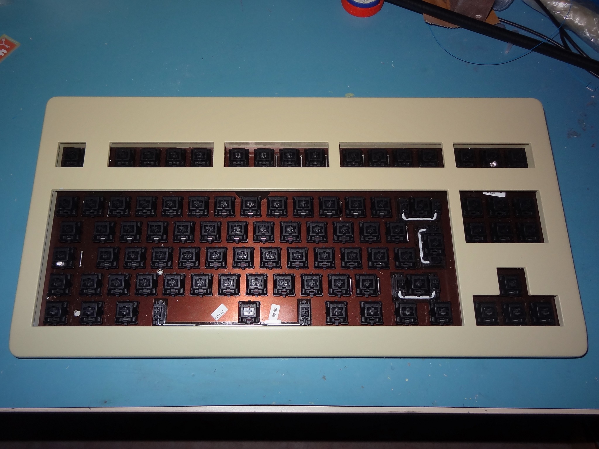

11 Oct 2015, 22:47
I'm really annoyed that I don't have time to post updates more often :cry:
Anyway, here is a quick teaser of the work in progress !
The PCB is cut to size and the missing tracks have been fixed... if is fully functional with a PS/2 to USB adapter. I also moved the caps lock and scroll lock leds under their respective key.
I'm now waiting for my chinese order to arrive, when I have received my arduino pro micro, I'll install Soarer's firmware.
The case has been painted with body filler. In theory, I should now lightly sand the filler and paint it for good... but I'm still not 100% satisfied with the current result :|
One thing worries me, I didn't use plastic primer on the top cover... I later learned that I should have, and I used some for the bottom cover.
Maybe someone has some experience in painting plastic parts and could give me an advice about that?
