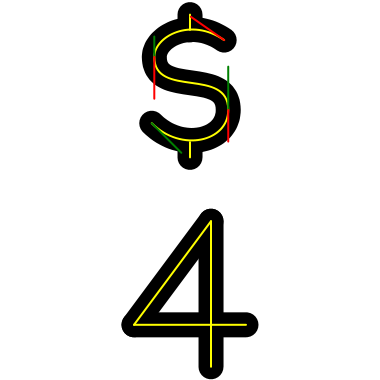

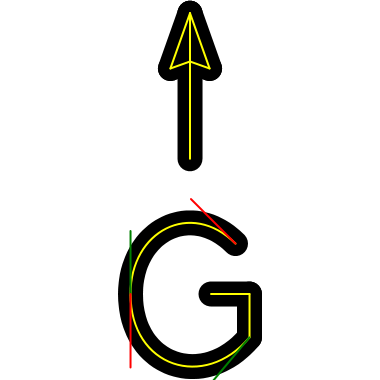

29 Sep 2015, 12:10
I've improved my Perl script a bit to make life easier for me:
:ugeek:
Please do not laugh at my scripting abilities, at least it gets my work done:

val/cadet4.val
$SCALE(0.51)
$CENTER(190,86)
$INCLUDE(smalldollar)
$SCALE(0.7)
$CENTER(190,294)
$INCLUDE(four)
... requires files val/smalldollar.val and val/four.val:
$REM smalldollar
$INCLUDE(smallS)
$MOVE( 0,-140)
$LINE( 0,-110)
$MOVE( 0, 140)
$LINE( 0, 110)
$REM 4
$VAR T= 104
$VAR L=  80
$VAR I=L-50
$VAR U=T-60
$MOVE( I, T)
$LINE( I,-T)
$LINE(-L, U)
$LINE( L, U)
... and val/smallS.val:
$REM smallS
$MOVEB( 67,-90, 145,80)
$DRAWB(-70,-57,  90,40)
$MOVEB(-70,-57, -90,82)
$DRAWB( 75, 47,  90,85)
$MOVEB( 75, 47, -90,62)
$DRAWB(-75, 73, 315,82)
val/cadetG.val
$SCALE(0.7)
$CENTER(190,86)
$INCLUDE(arrow)
$CENTER(190,294)
$INCLUDE(G)
val/arrow.val
$VAR  T=104
$VAR  L=-25
$VAR  M=-35
$VAR  H= 28
$MOVE( 0, T)
$LINE( 0,-T)
$LINE(-H,  L)
$LINE( 0,  M)
$LINE( H,  L)
$LINE( 0, -T)
val/G.val
$MOVEB( 65,-72, 135,90)
$DRAWB(-85,  0,  90,90)
$MOVEB(-85,  0, -90,105)
$DRAWB( 85, 62, 230,100)
$LINE(85,0)
$LINE(30,0)
:shock:

./makesvg.pl cadet4
or with the support lines (the yellow, red and green stuff):
./makesvg.pl -t cadetG
$LINE and $MOVE should be clear.
$MOVEB is for Bezier curves.
$MOVEB(x,y,a,s)
a is the angle into which direction the curve will get off from (x,y) and s is a stretch factor.
$DRAWB(x,y,a,s)
The same thing, except it draws from current postion to x,y, a is the angle at which the curve comes in.
$VAR defines variables. The parsing ability is a×b only, where × can be anything like +-*/.
:shock:
