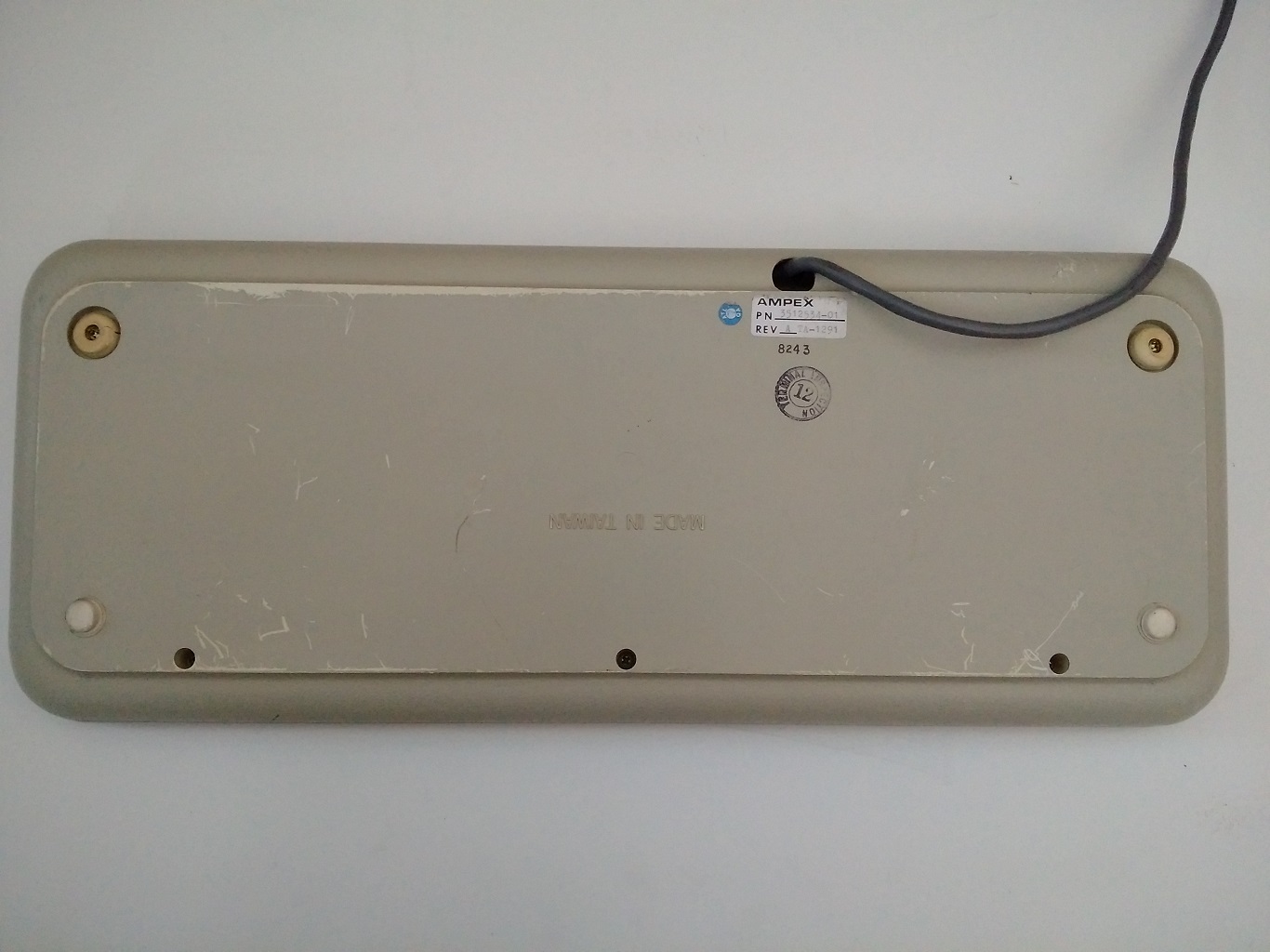

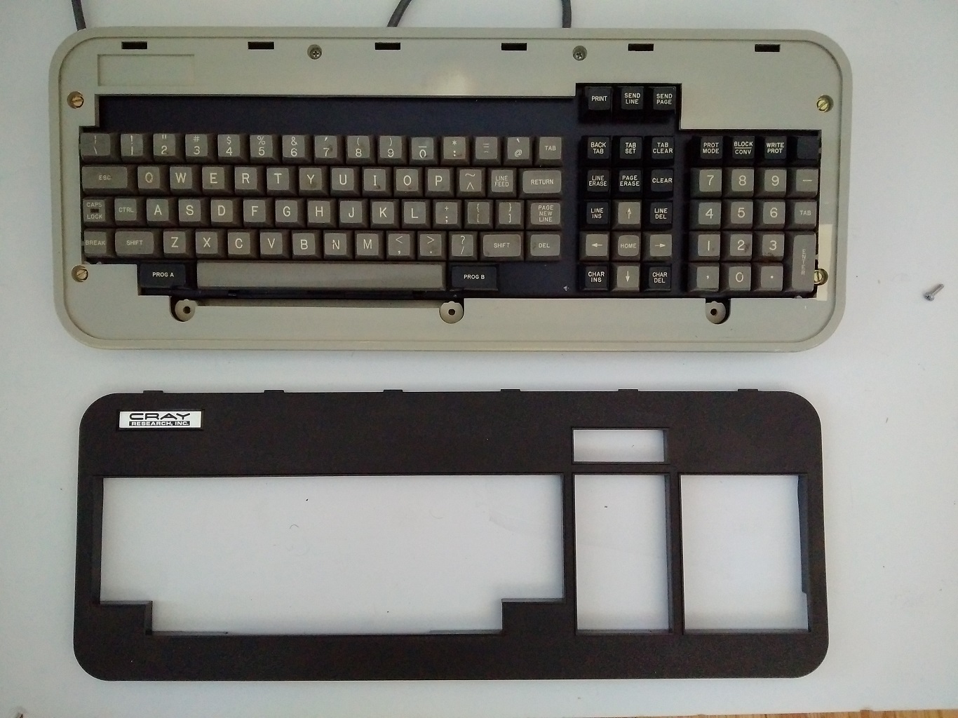

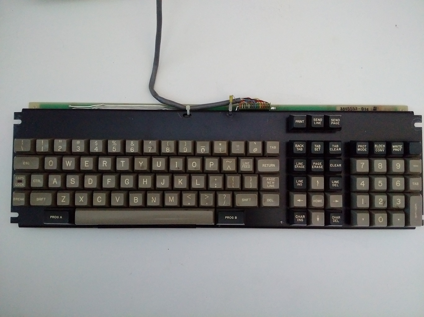

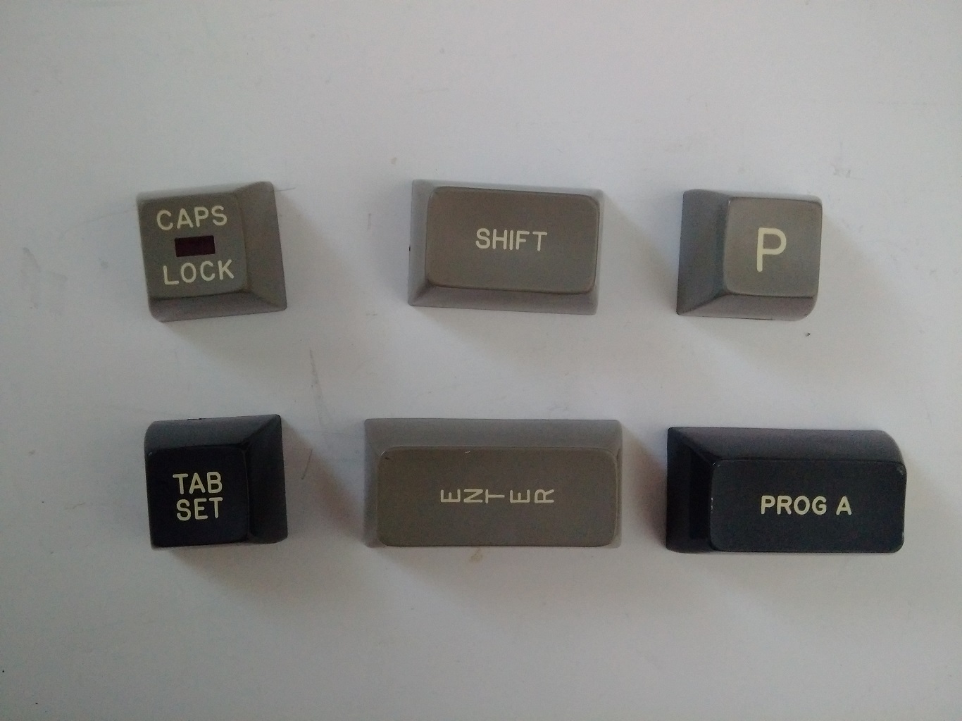

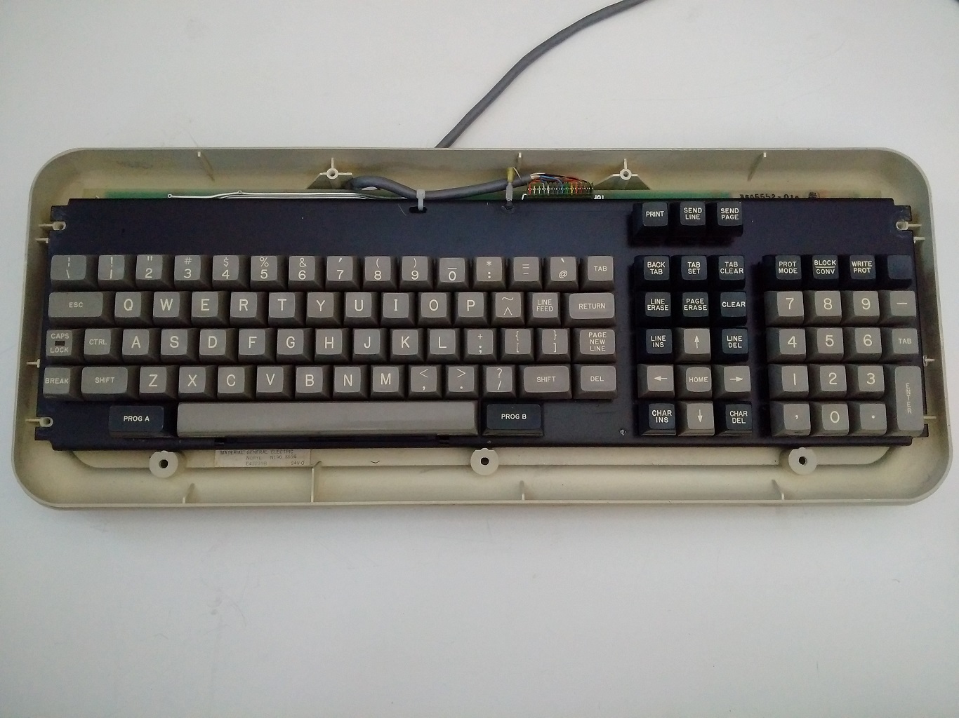

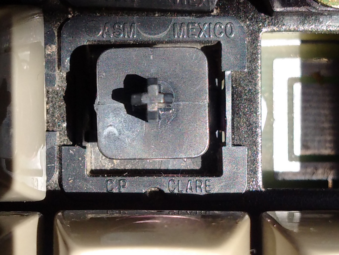

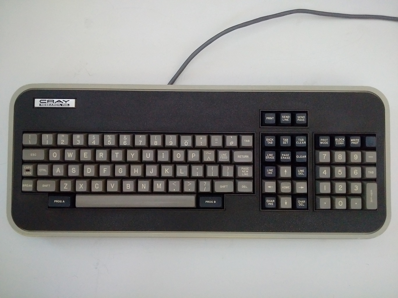

I have a Cray Research Inc. keyboard made by Ampex that has some key switches that I can't find in the Wiki. Can anyone identify them? The key switches almost look like they are beam spring in shape. The PCB view through an empty key switch hole makes it look like foam and foil. It says "CP Clare" on the key switch so I am guessing Clare Pender? It also has "ASM" on it but I haven't found a reference to this.
It is a cool historic keyboard and I had to have this. This is the first keyboard I bought that didn't have a computer or terminal attached :)
Here's the keyboard pics.
Cray Ampex keyboard - top
Cray Ampex keyboard - top.jpg (371.1 KiB) Viewed 9108 times

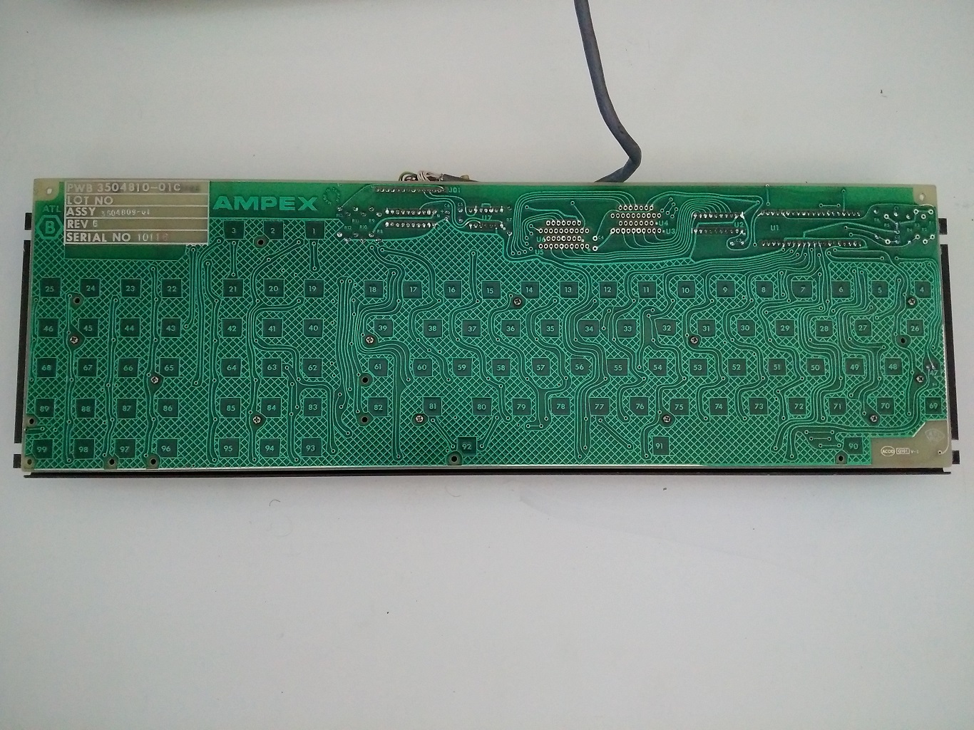

Cray Ampex keyboard - keyboard bottom
Cray Ampex keyboard - keyboard bottom.jpg (284.91 KiB) Viewed 9108 times

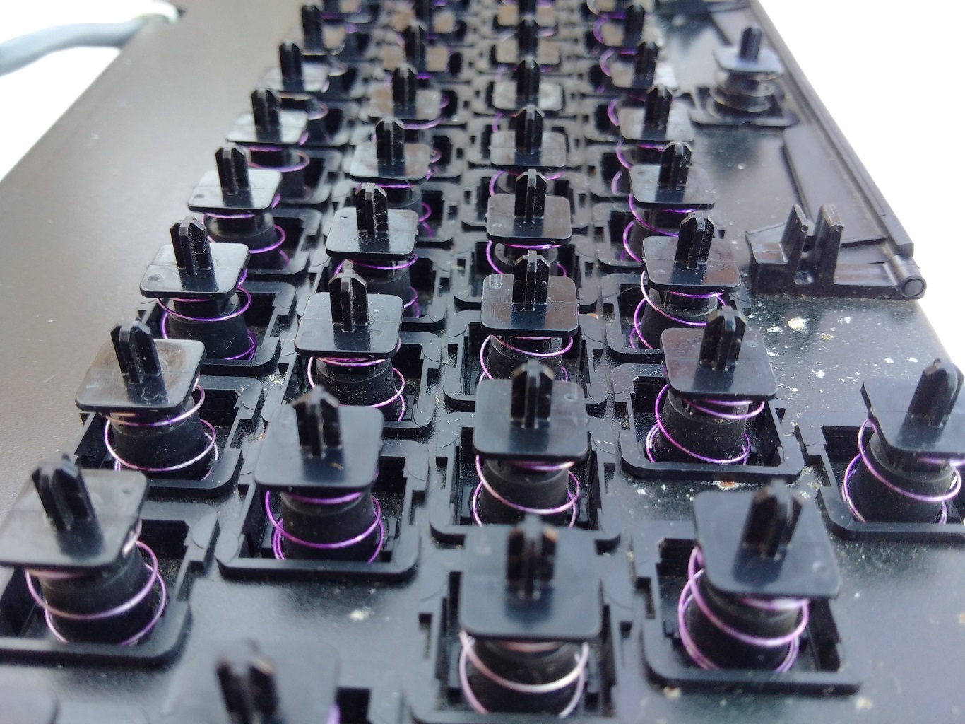

Cray Ampex keyboard - keyboard mechanism top
Cray Ampex keyboard - keyboard mechanism top.jpg (353.73 KiB) Viewed 9108 times
Cray Ampex keyboard - keyboard mechanism bottom
Cray Ampex keyboard - keyboard mechanism bottom.jpg (531.79 KiB) Viewed 9108 times

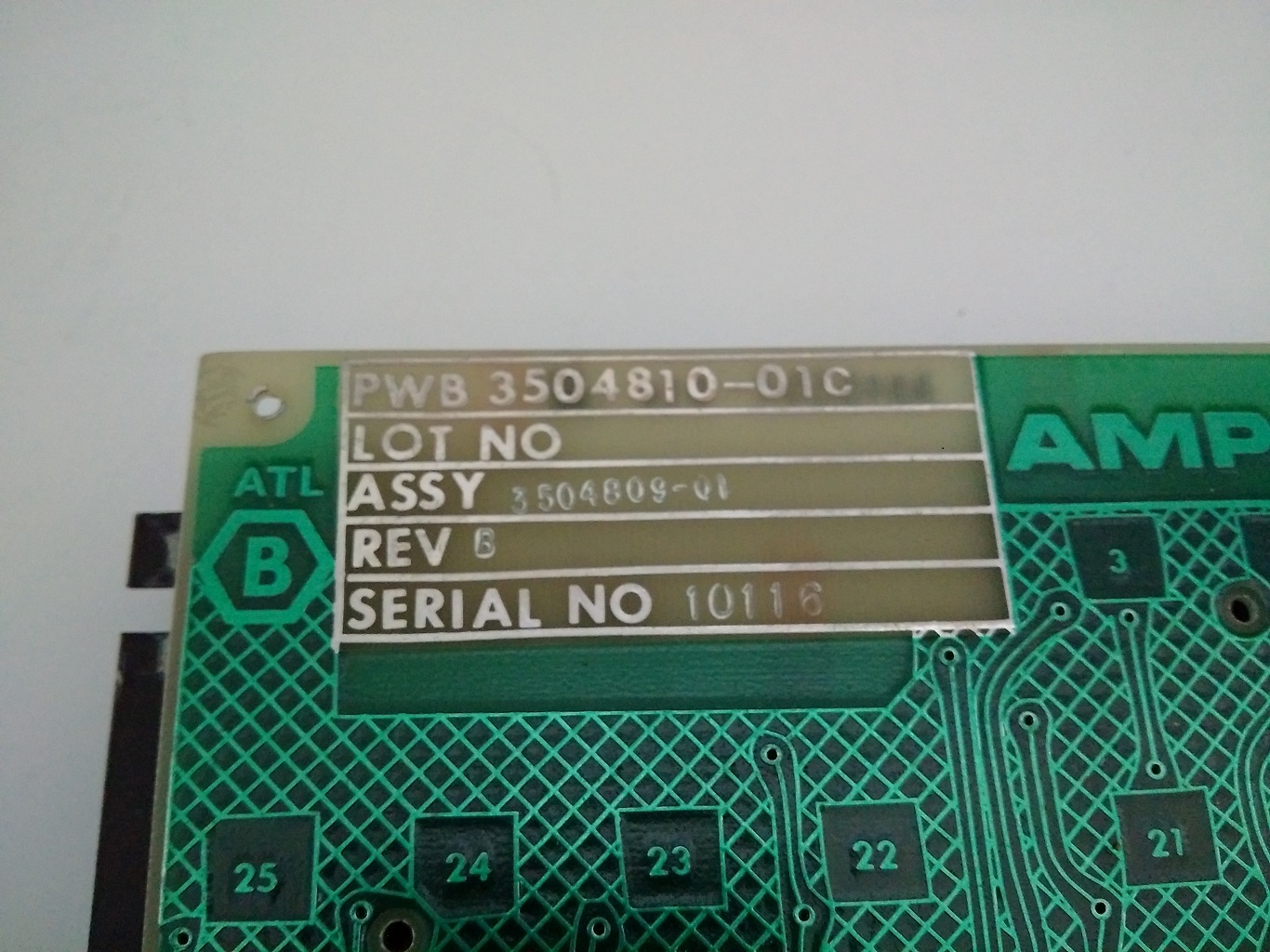

Cray Ampex keyboard - keyboard PCB markings
Cray Ampex keyboard - keyboard PCB markings.jpg (440.98 KiB) Viewed 9108 times

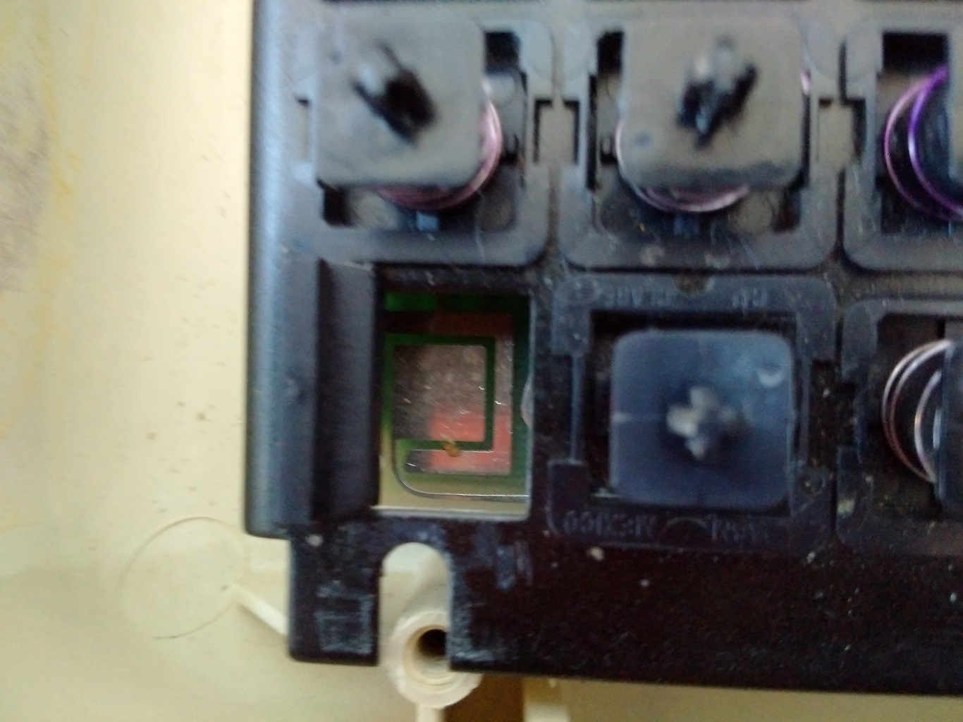

Cray Ampex keyboard - no key switch view of board
Cray Ampex keyboard - no key switch view of board.jpg (346.2 KiB) Viewed 9108 times
Cray Ampex keyboard - key switch markings
Cray Ampex keyboard - key switch markings.jpg (501.62 KiB) Viewed 9108 times

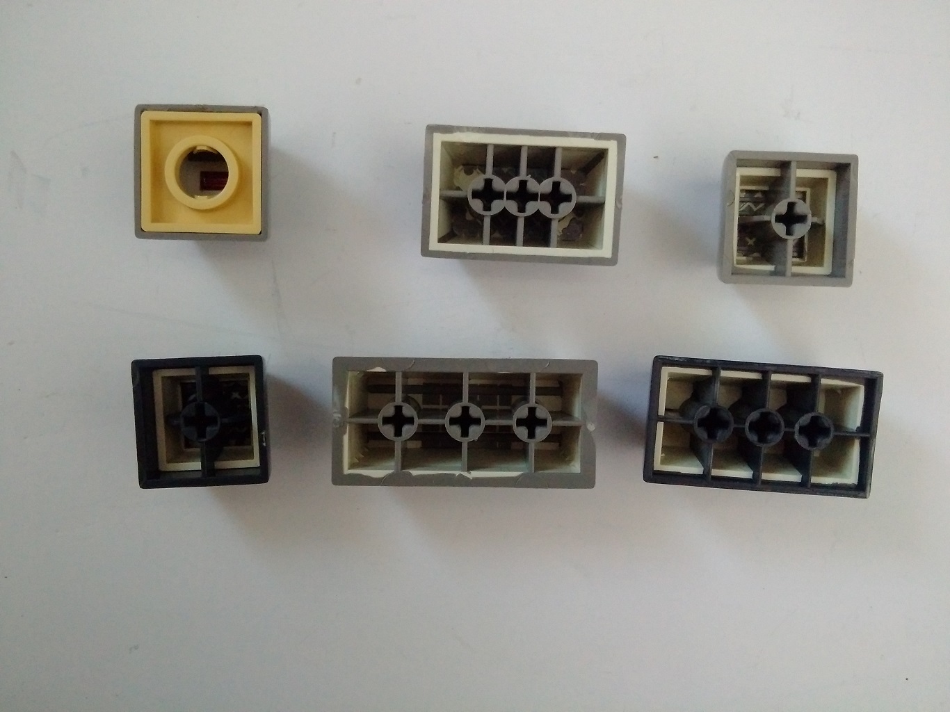

Cray Ampex keyboard - key caps face up
Cray Ampex keyboard - key caps face up.jpg (298.13 KiB) Viewed 9108 times
Cray Ampex keyboard - key caps face down.jpg (316.39 KiB) Viewed 9108 times

You continue to baffle me on a daily basis with your vintage keyboards now snuci! Not too many people here have a collection to do that! Apparently you do. Anyway, I don't own an IBM Beamspring, but that switch looks different IMO. Possibly Clare Pendar yes. The keyboard is nice but that PCB is awesome! :shock:

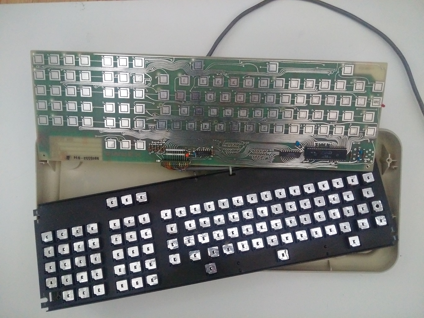

Hmm, I don't know what type of key switch this is. Can you post a photo of the underside of the slider, specifically, the slider PCB interface? It looks like this could be some sort of foam and foil board. The pad arrangement looks like it would support capacitive or conductive sensing.

Most likely made by Clare\Clare Pendar. There's a few threads that show up with a search, like this one which also has CP Clare, but not the same type.
Edit: Maybe this here's the caps lock switch? Looks like the mount is right for that cap. http://telcontar.net/KBK/SwitchCollecti ... php?id=109

XMIT wrote: Hmm, I don't know what type of key switch this is. Can you post a photo of the underside of the slider, specifically, the slider PCB interface? It looks like this could be some sort of foam and foil board. The pad arrangement looks like it would support capacitive or conductive sensing.
It just occurred to me that with the picture of the PCB, it has screws on the bottom like foam and foil. I will take it apart and take a picture. If MUST b foam and foil but it doesn't feel like it. I have an Apple Lisa and a TRS-80 model II with Keytronic foam and foil switches and I've had to replace the foam on those. I'll check it later tonight.
I did some research on "CP Clare" and "ASM Mexico" and it looks to be an evolution of "Clare Pendar" after their manufacturing operation moved to Mexico. I'm surprised there's no Wiki article about it because Daniel Beardsmore wrote about the company here: http://telcontar.net/KBK/Clare-Pendar/

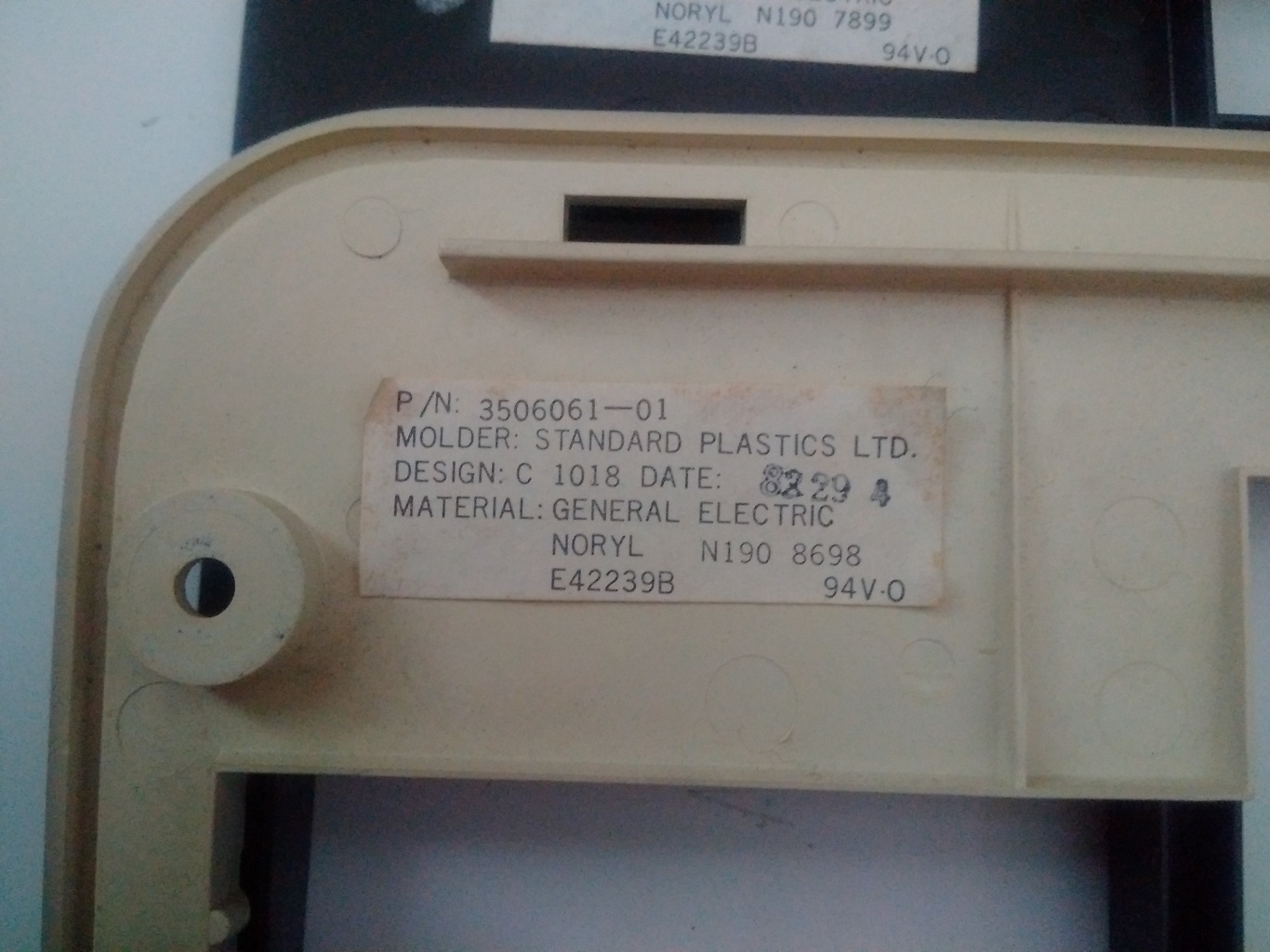

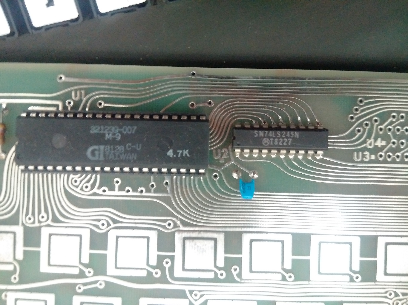

Well, as II and some other here suspected, it turns out that it IS foam and foil but the capacitive pad areas on the board are not two semi-circles like Keytronics but inner and outer squares. The center of each square pad has a hole so that if the key has a light, it will fit through the hole like the Caps Lock key. Has anyone seen this before?
Also, I took a picture of some labels that were affixed to each of the plastic parts. I was confused by "General Electric" until I looked up "General Electric Noryl" that is the plastic used in molding the parts. It also dates the keyboard to around mid 1982. the logic on board also looks custom?

Cray Ampex keyboard - foam and foil revealed
Cray Ampex keyboard - foam and foil revealed.jpg (532.61 KiB) Viewed 8930 times
Cray Ampex keyboard - keyboard logic
Cray Ampex keyboard - keyboard logic.jpg (449.62 KiB) Viewed 8930 times

I love that picture with the springs. They really pop. Look quite nice.
