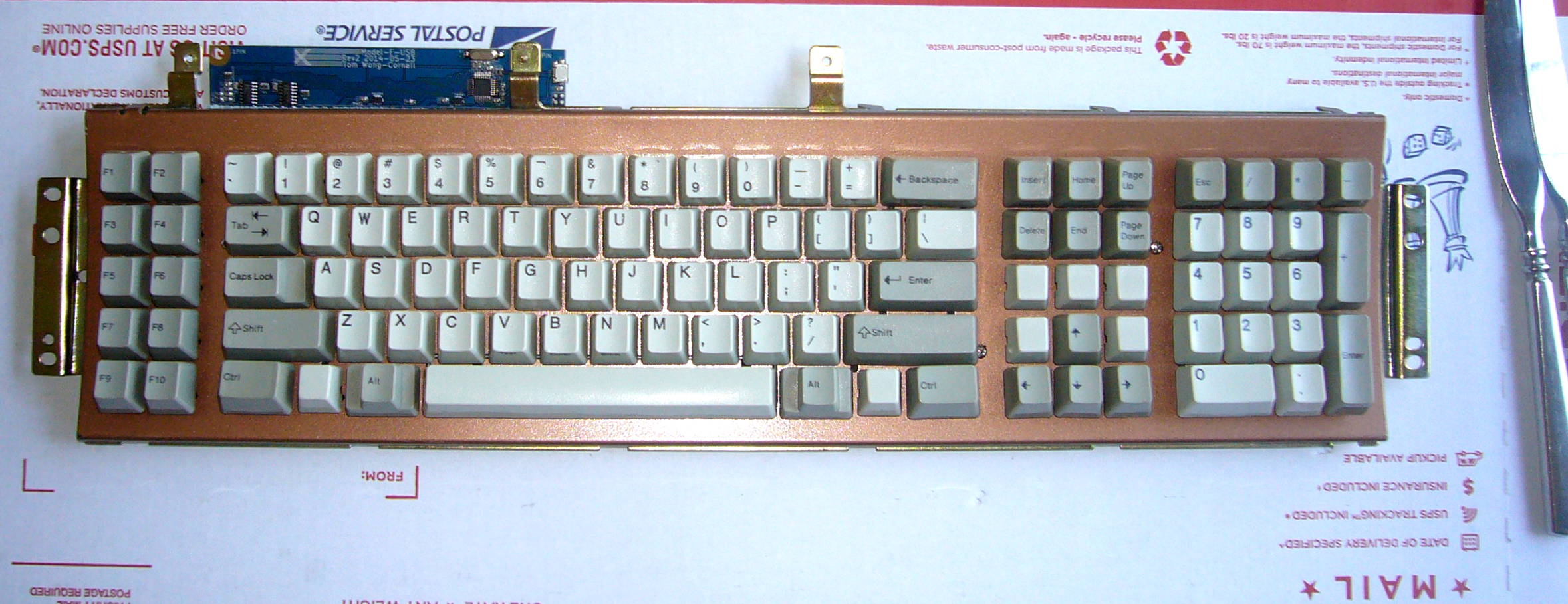

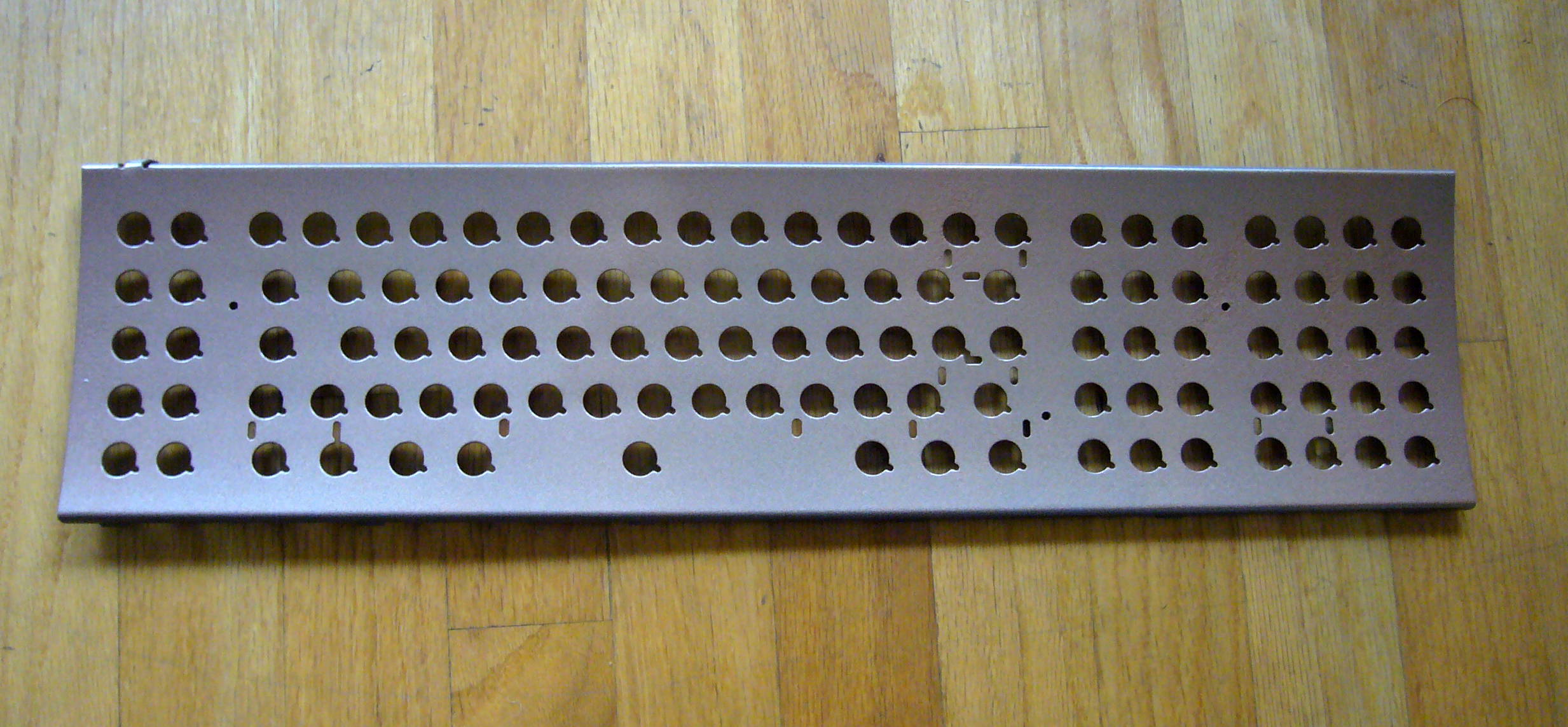

Very shortly I will be posting an abbreviated build log for my F-107, but attached are a couple that might help.
Except for the XT, and possibly the AT, I have come to believe that the Model Fs suffer from variations in curvature between the inner plates after being taken apart and put back together. Obviously, the thicker and stiffer the foam, the greater the problem.
I have concluded that in just about any Model F reconditioning job, a small number of bolts somewhere near the centerline of curvature is a huge help. They really tighten the whole thing up considerably. Obviously, be cautious to avoid traces when you drill your holes!
See the attached photos of my 3 bolt locations. One near the bottom left of Tab, one at the right end of Right Shift, and one near the bottom right of Page Down. On the shot of the plate, you can see the holes, and you can see the screw heads poking out on the one with the keys installed.

Hmm very interesting fohat. I have only ever dis- and reassembled one Model F being a 3104 Terminal board but I had some problems with the plates when lining them up for reassembly. It worked out in the end but I had to use force and slightly bend two of the hinges which really bothered me at the time. Of course I did not drill at all. Anyway yours looks like a phenomenal job.

hammelgammler wrote: But the bolt-mod is a great idea, I think this is even better with it. But I don't really have the tools for that...
I have a hand-held drill (decades-old, heavy, with a cord) and all you need is a fresh sharp bit. If it is a "wood/plastic/metal" bit from the hardware store it will wear out rather quickly, but drilling 3 holes should be no problem. I believe that I used M3x12 machine screws and nuts.
I put the PCB on the back plate and drill from the PCB side where there are no traces. Afterwards, I attach front plate and drill back in the other direction.
