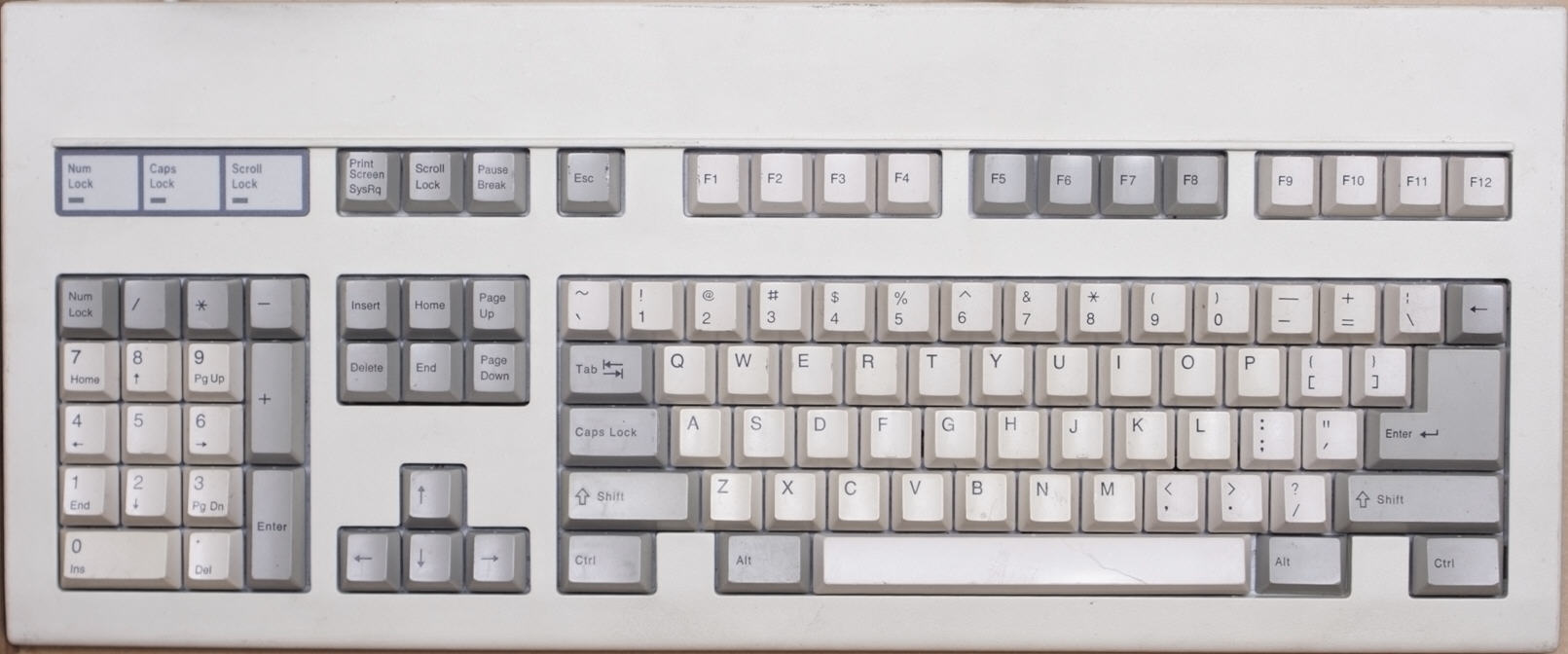

2. The "ErgoCanada.com" shop master said he has beige and black version of this model. We don't say the yellowed ABS keyboard with "Begie"(you can see his keyboard is white), but the folk would said that beige. Actually this model released white and black version only.

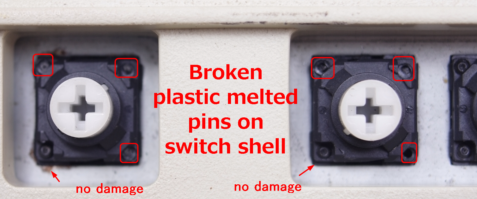

4. My Sejin SKM-1040 keyboard also have linear on F1 & Esc, but it seems like a damage or someone took out the metal leaf with that broken plastic melted pins on switch shell.
Seee photo, you"ll know that.

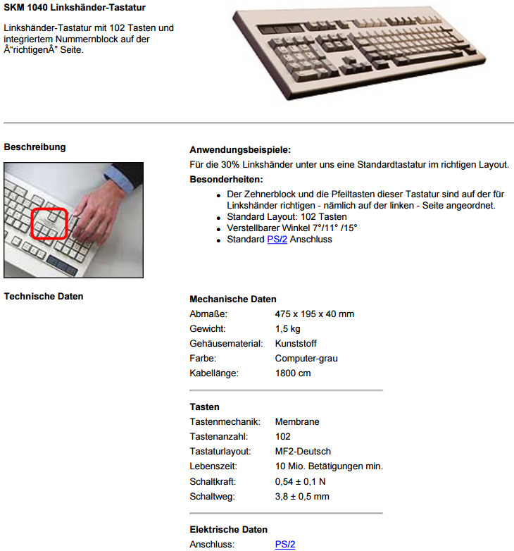

002: I got the evidence to proof "ErgoCanada.com" left-hand keyboard wasn't mechanical. That's the newer membrane keyboard only! Please take a look under the function keys area from following pictures.
"ErgoCanada.com"' left-hand keyboard:
The Germany pdf said it's membrane:
source: http://img.gebe.net/wtc3/download/skm-1040-linksh.pdf
The membrane keyboard model actually called "Sejin EAT1040". The facts is the "ErgoCanada.com"' didn't say the brand and model name for the left-hand keyboard.
source: http://uk.rs-online.com/web/p/keyboards/4358072/
Why "ErgoCanada.com" said it's mechanical? Because he saw the "SE·JIN Futaba dome" slider looked like mechanical!!
