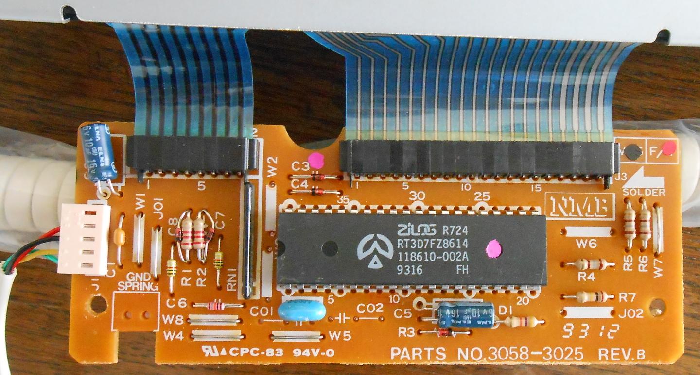

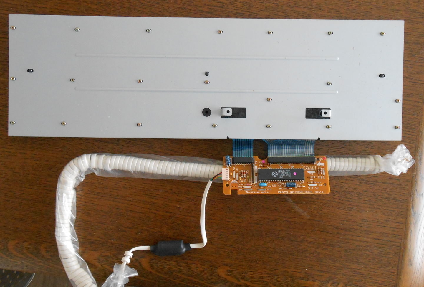

It looks unused and in great condition. For some reason I didn't take pictures of the board before I took it apart, but If someone is interested I can do that.

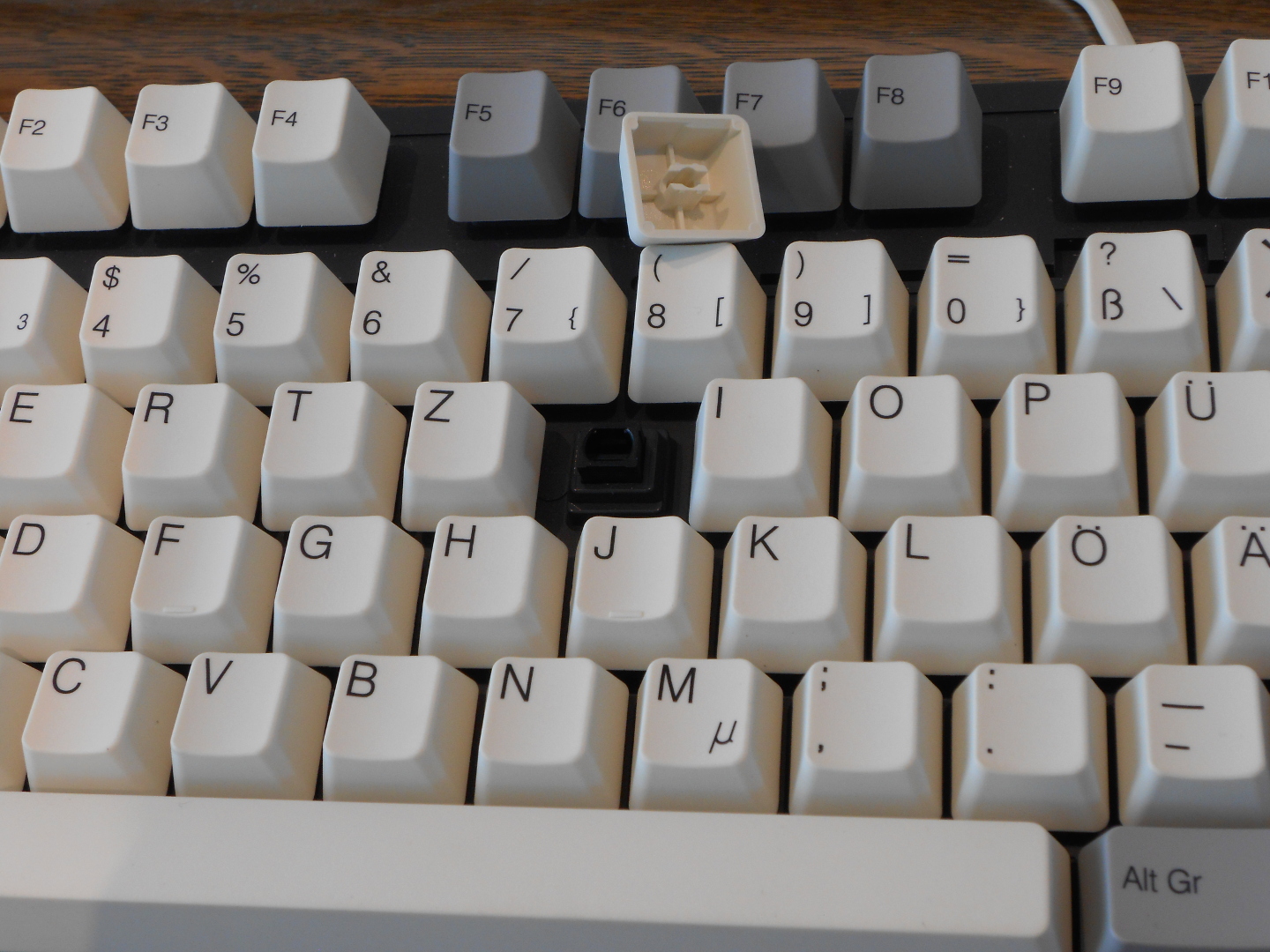

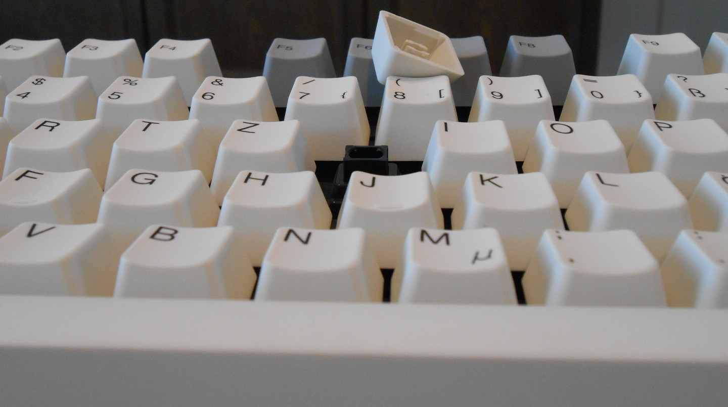

Especially the keycaps look and feel so nice, I was sad after pulling one. Neither MX nor Alps mount :(
It is a NMB slider over dome. Basically http://deskthority.net/wiki/Digital_RT102 but in clean, unused condition.
Unlike the AppleDesign Keyboard its domes are dark green, not yellow. They feel very consistent between keys and not that awful, but not mech either.
I really like the legends. My pictures don't do them justice. They are sharp, high contrast and absolutely flat on the caps. I wonder if they are dyesub or just really good pad printed.
Also the plastic structure on the top side of the keycaps has a very nice feel. Finer grained than cherry keycaps. I would expect them to be shiny really soon if they are made of ABS.
F, J and 5 are deep dished and nubbed.
Metal plate included
Definately a NMB OEM. I think this is the exact same board as the Digital RT102 on the wiki, but branded Qume.

On a side note it looks like you also got yourself a nice Topre set. If these are the same they do fit Topre, they don't mount as firmly as the real deal.
