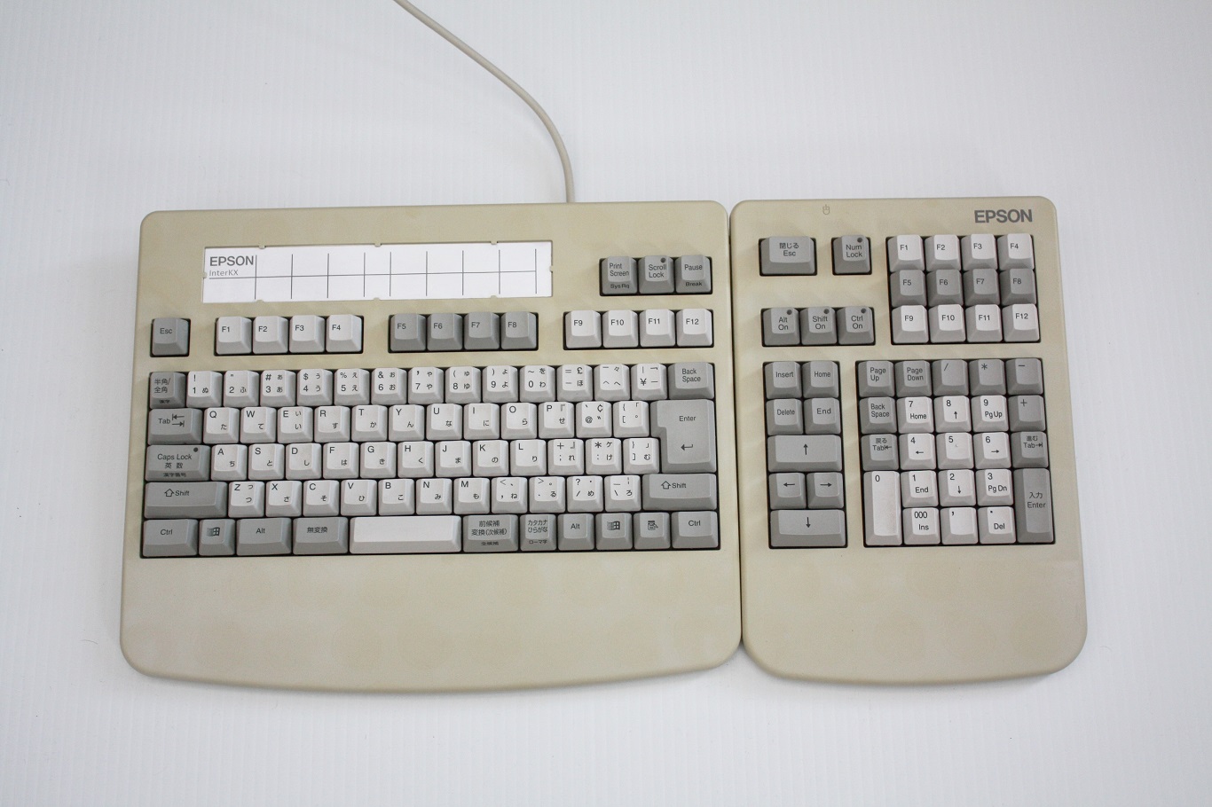

I also acquired one of these and that area in the top left seemed empty so I cut a thick transparent sheet and added a key label sheet so it looks like it was always there. Haata, pcaro, 002, if you want the file, I can send it to you.
Epson InterKX (Business Full)with key template
Epson Topre InterKX.jpg (285.86 KiB) Viewed 4481 times

snuci wrote:I also acquired one of these and that area in the top left seemed empty so I cut a thick transparent sheet and added a key label sheet so it looks like it was always there. Haata, pcaro, 002, if you want the file, I can send it to you.
Yes. It looks very well. I am interested in the file, thanks.
