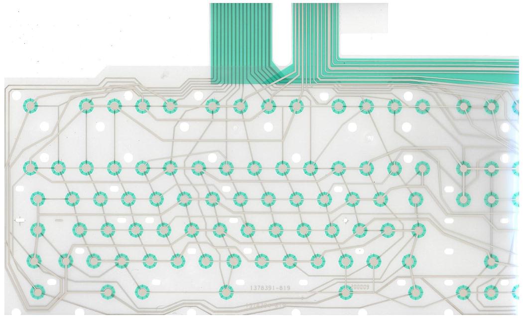

Have a look at the Model M membrane, which hasn't changed in layout in 30 years. This is the best photo I could find quickly:
The keys you mention - `, 1, q, a, z - are all on one "column". Did you spill anything into the keyboard?
