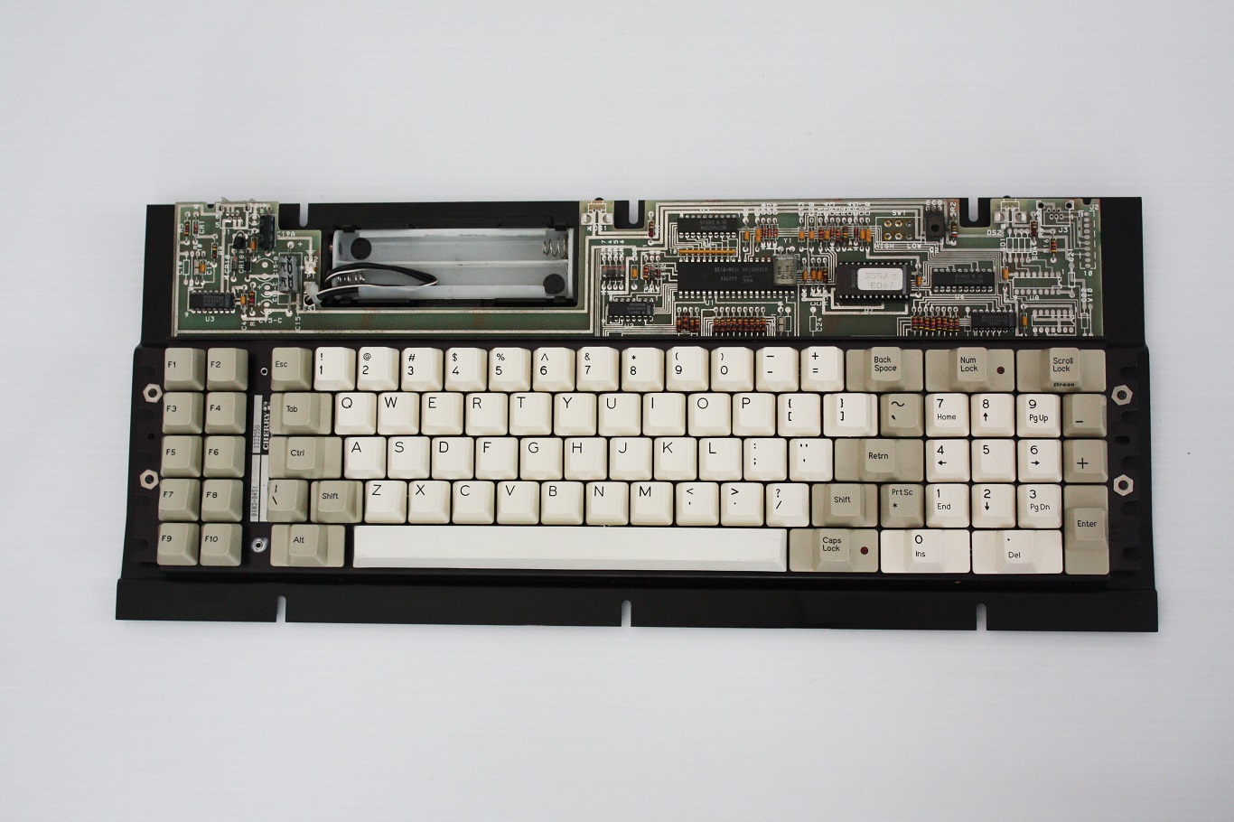

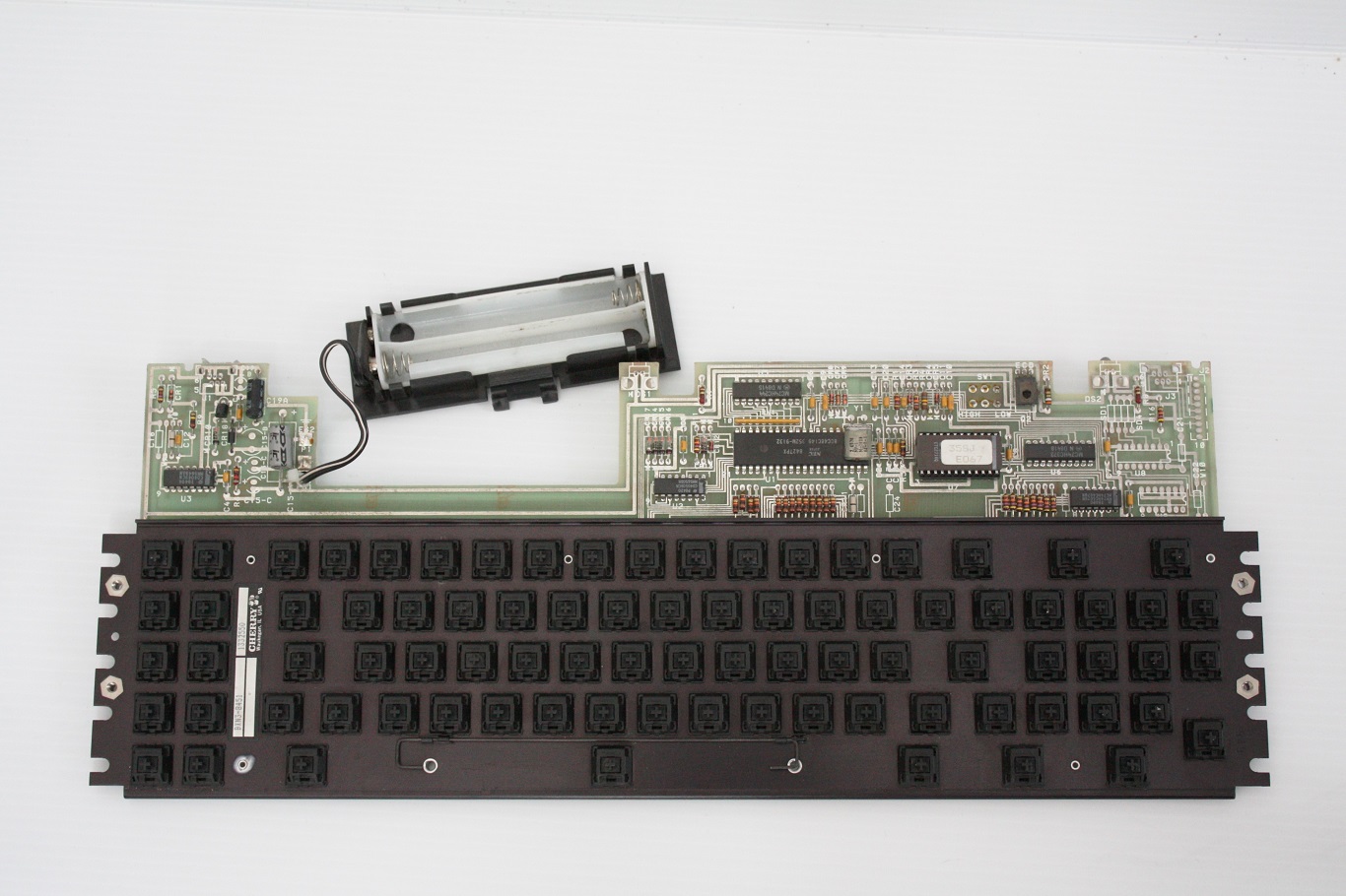

I recently posted a couple of Cherry solid-state capacitive keyboards here and here and bought this one thinking that I was going to get another to see which of the two switches was more common (out of three keyboards in total). Turns out, it's a different type, even thought the internal construction is very similar (aside from the wireless difference).
I believe this is a Cherry brand IBM PCjr computer replacement keyboard. It has IR built in (hence the need for the batteries) but also has an RJ-11 interface (like an old phone plug). A switch on the back of the keyboard indicates it switchable from "Jr" to "Sr". There is no IBM PCsr unless they are referring to the IBM PC? Unfortunately, I don't have the RJ11 cable to try it. Now I just have to find an IBM PCjr.

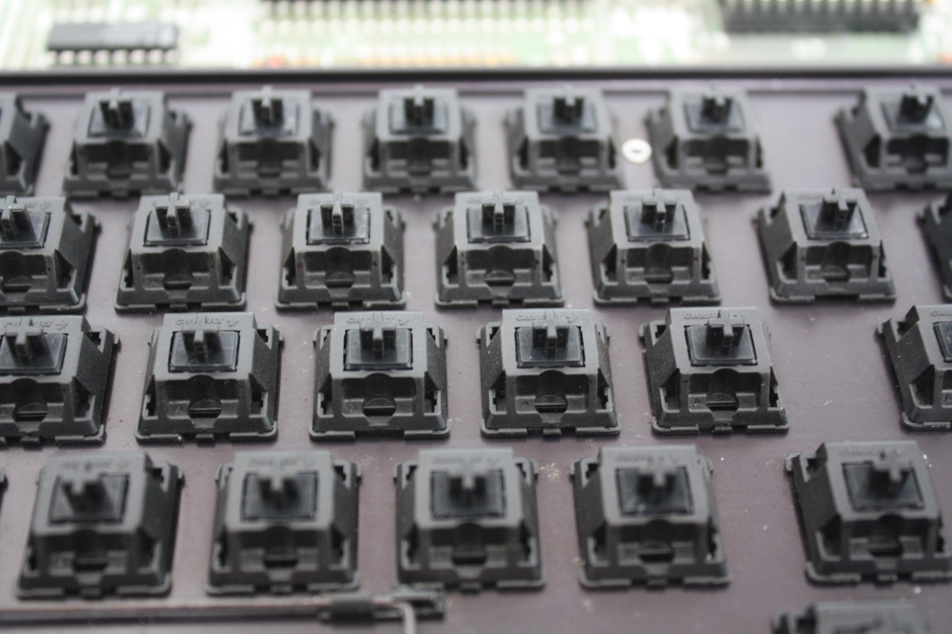

This keyboard features early Cherry MX Black switches from mid-1984. They are really smooth. You will notice the space bar is also MX Black but the back side reveals a red dot that is only on the space bar key switch. I might have to take that apart as see what's inside.
The construction is almost identical to the two Cherry capactitive XT keyboards linked above except for the wireless IR and rear plate holes for the switch and battery cover. It is so close that I tried to fit it into the outer shell of one of the other XT keyboards but it is taller and a hair wider. This keyboard also has 84 keys vs 83 keys but uses an almost identical keypad footprint.
You may notice that the Caps lock key cap and some others have red indicator LED windows. These are non-functional because there are no LEDs behind them. This particular keyboard also has thin double-shot key caps marked "DCS 1-1". I think they may be PBT but I'm not sure what the numbering means. Being from 1984, this would be before Signature Plastics.
I'm surprised these keyboards are not more prevalent because the IBM PCjr chicklet keyboard and their IR keyboard were not hits. This keyboard is quite amazing compared to those. It must have been costly, originally. Anyway, here are some pics:
Cherry PCjr MX - keyboard
Cherry PCjr MX - keyboard.JPG (317.95 KiB) Viewed 9250 times

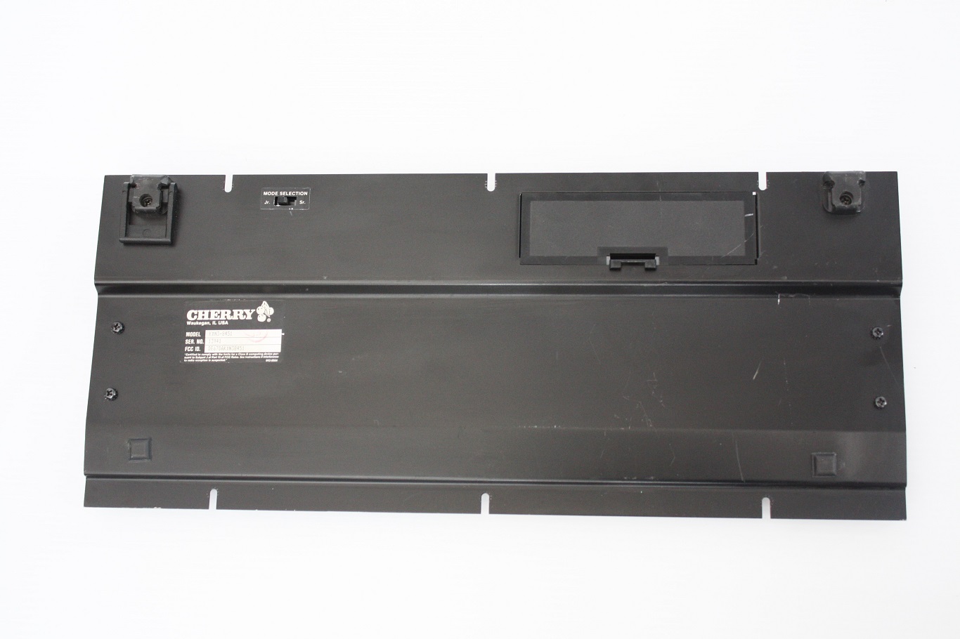

Cherry PCjr MX - back
Cherry PCjr MX - back.JPG (201.77 KiB) Viewed 9250 times

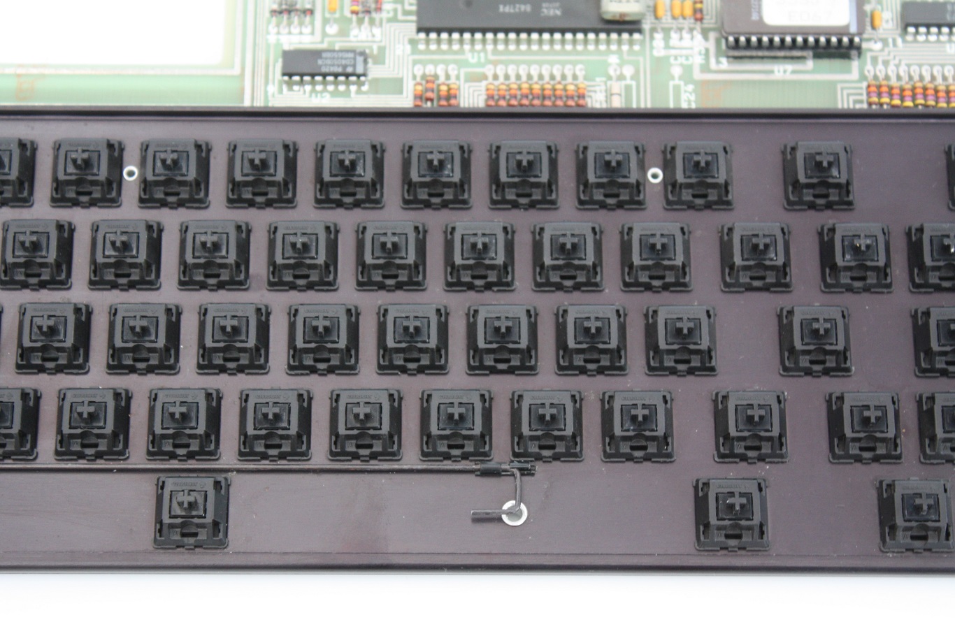

Cherry PCjr MX - key caps removed
Cherry PCjr MX - key caps removed.JPG (297.59 KiB) Viewed 9250 times

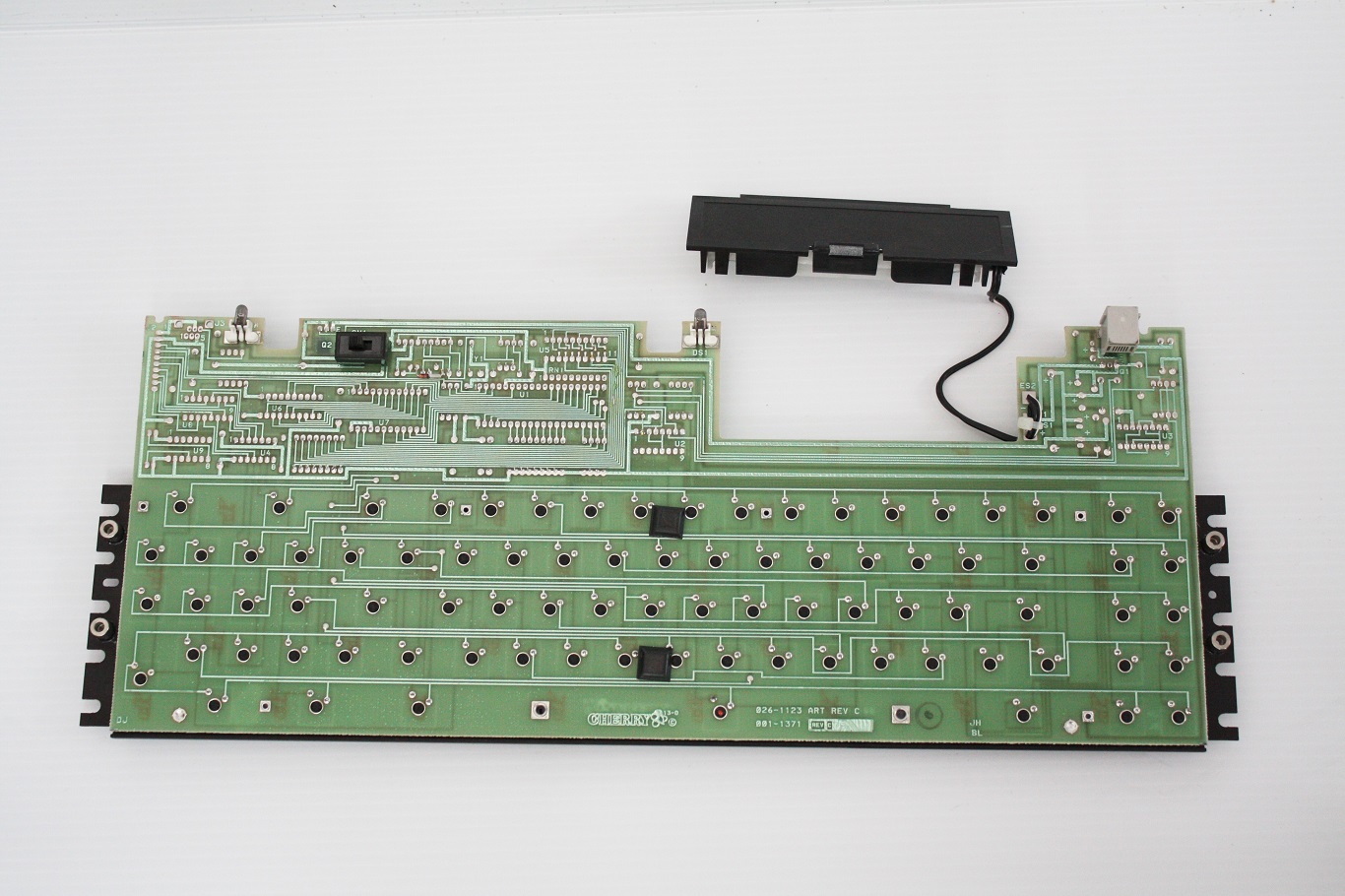

Cherry PCjr MX - back of PCB
Cherry PCjr MX - back of PCB.JPG (343.42 KiB) Viewed 9250 times
Cherry PCjr MX - MX blacks
Cherry PCjr MX - MX blacks.JPG (304.75 KiB) Viewed 9250 times

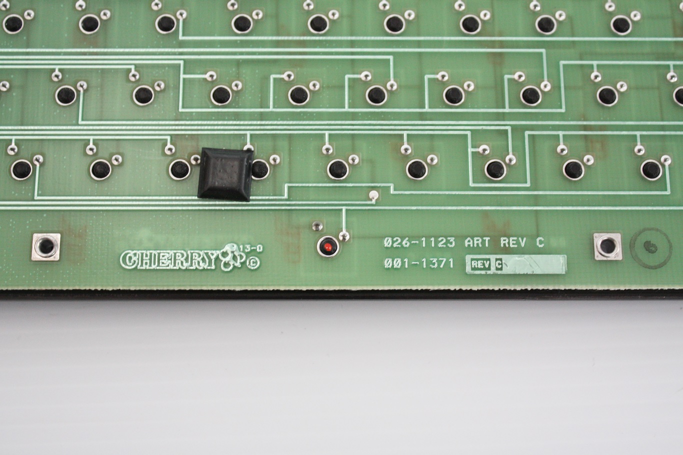

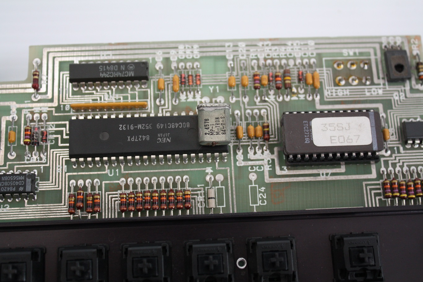

Cherry PCjr MX - PCB markings
Cherry PCjr MX - PCB markings.JPG (329.45 KiB) Viewed 9250 times

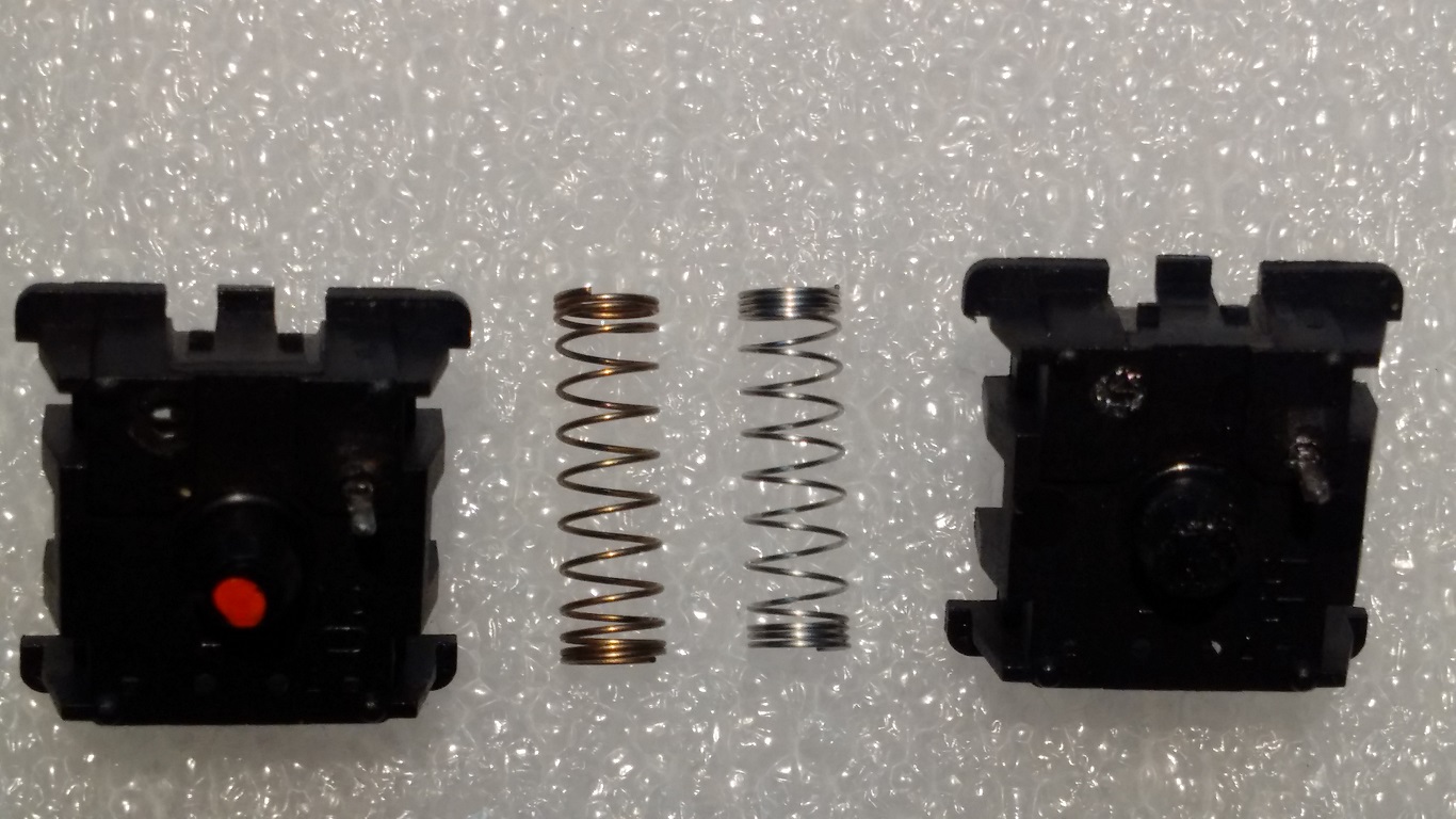

Cherry PCjr MX - view of space bar area and no LEDs
Cherry PCjr MX - view of space bar area and no LEDs.JPG (347.19 KiB) Viewed 9250 times

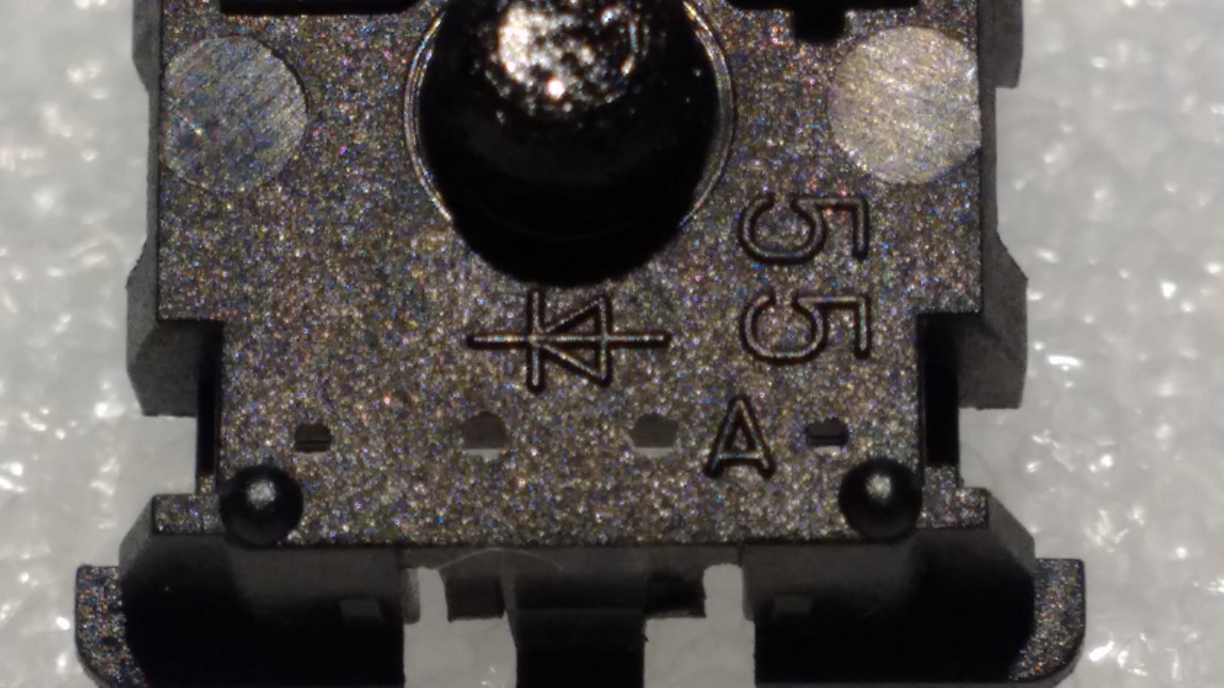

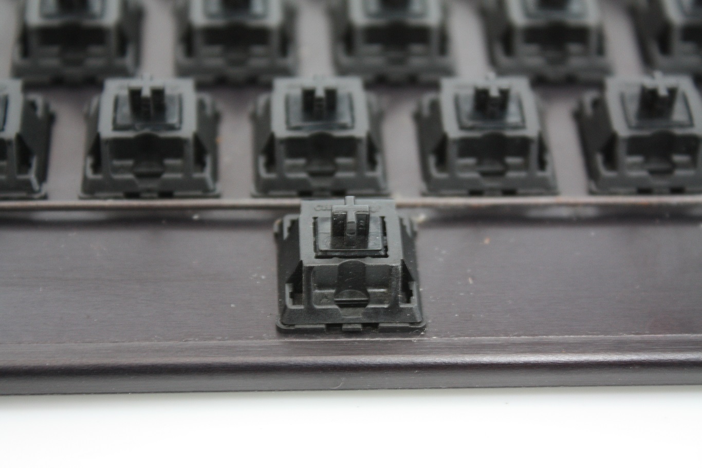

Cherry PCjr MX - space bar MX black switch
Cherry PCjr MX - space bar MX black switch.JPG (243.3 KiB) Viewed 9250 times

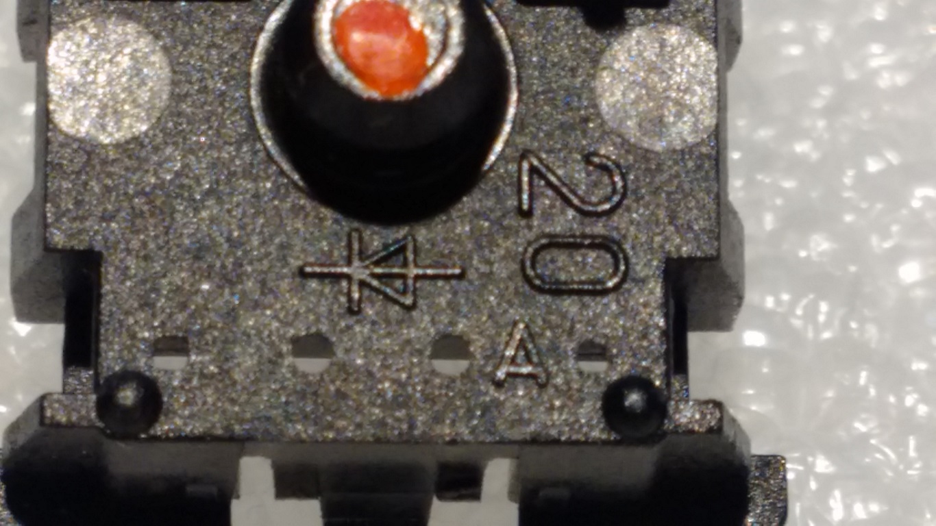

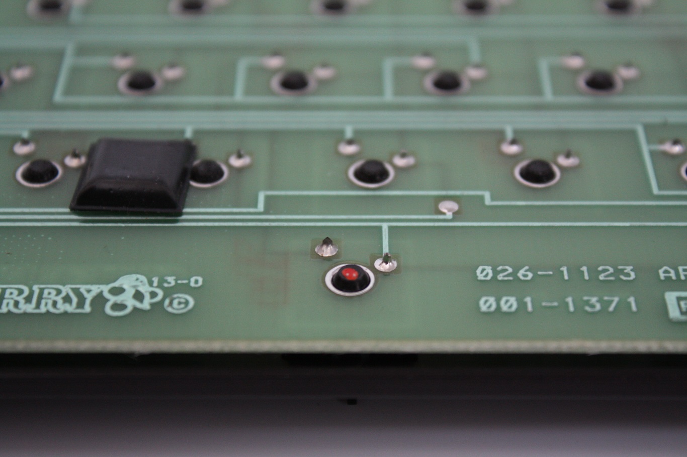

Cherry PCjr MX - red dot on space bar MX black switch
Cherry PCjr MX - red dot on space bar MX black switch.JPG (254.52 KiB) Viewed 9250 times
Cherry PCjr MX - ICs and dates (mid-late 1984)
Cherry PCjr MX - ICs with dates.JPG (348.13 KiB) Viewed 9250 times

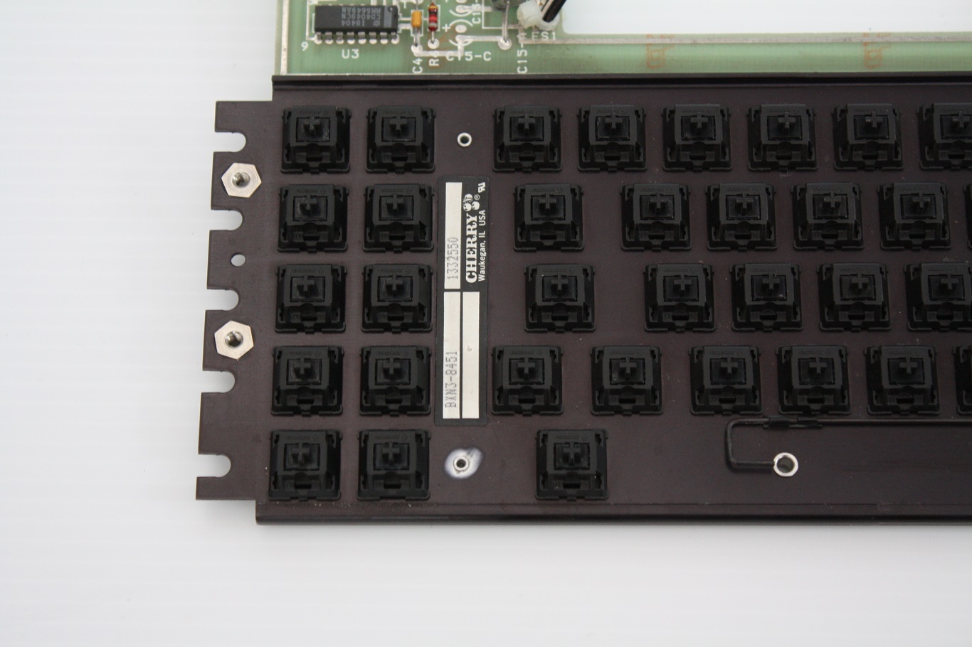

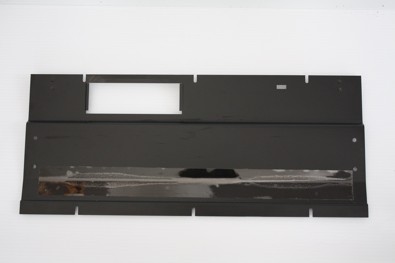

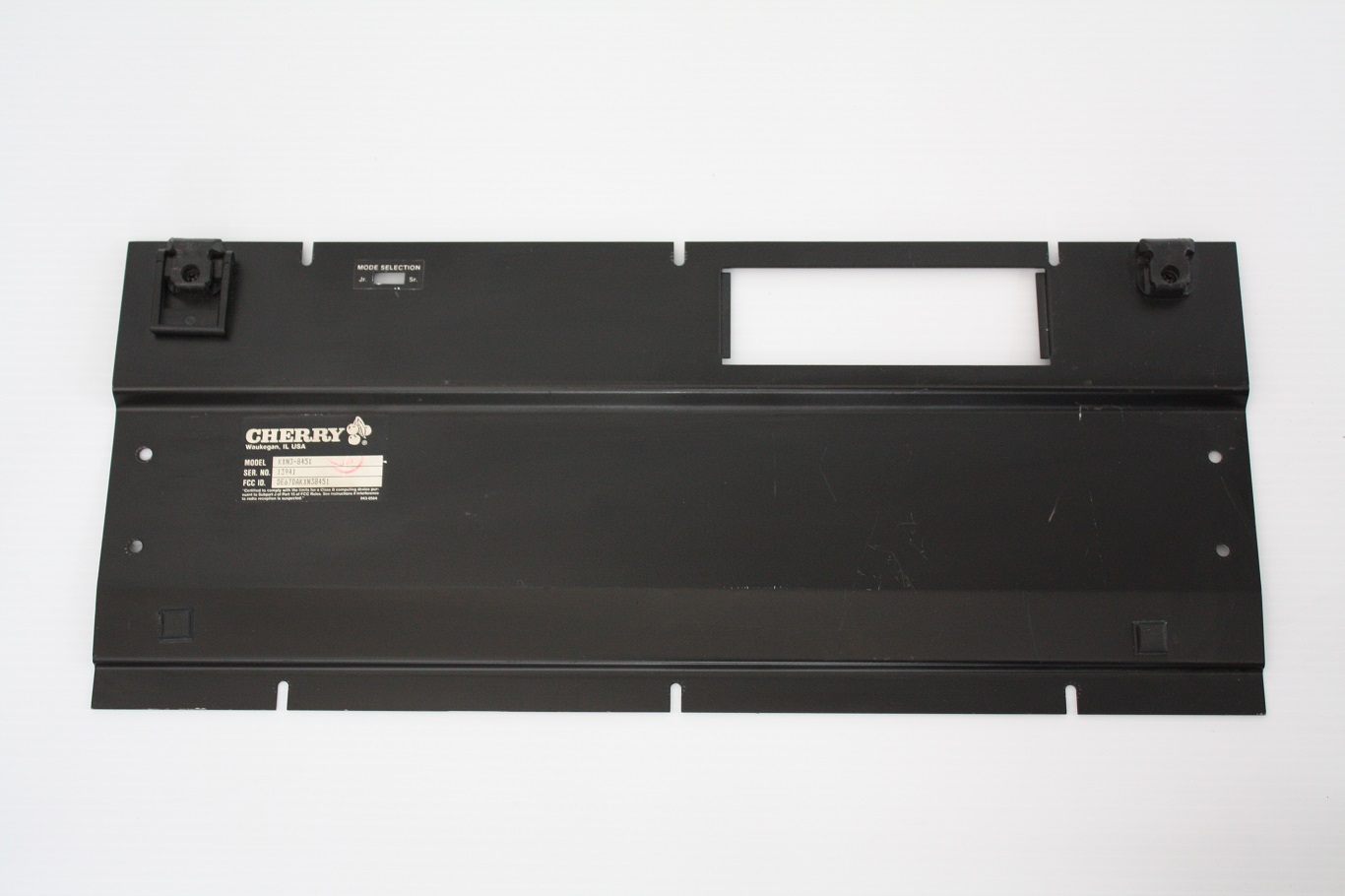

Cherry PCjr MX - Inside bottom plate
Cherry PCjr MX - Inside bottom plate.JPG (174.18 KiB) Viewed 9239 times
Cherry PCjr MX - Bottom plate
Cherry PCjr MX - Bottom plate.JPG (159.56 KiB) Viewed 9239 times

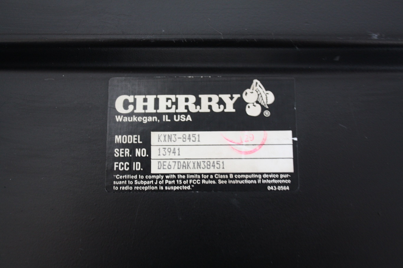

Cherry PCjr MX - keyboard model number
Cherry PCjr MX - keyboard model number.JPG (256.68 KiB) Viewed 9239 times

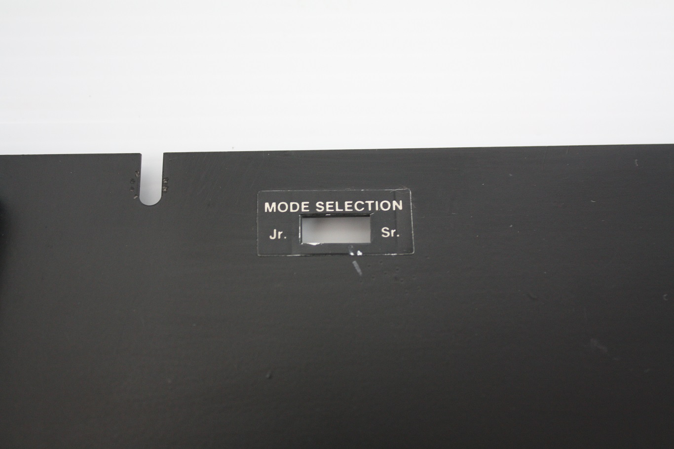

Cherry PCjr MX - Jr/Sr switch
Cherry PCjr MX - Jr-Sr switch.JPG (174.07 KiB) Viewed 9239 times

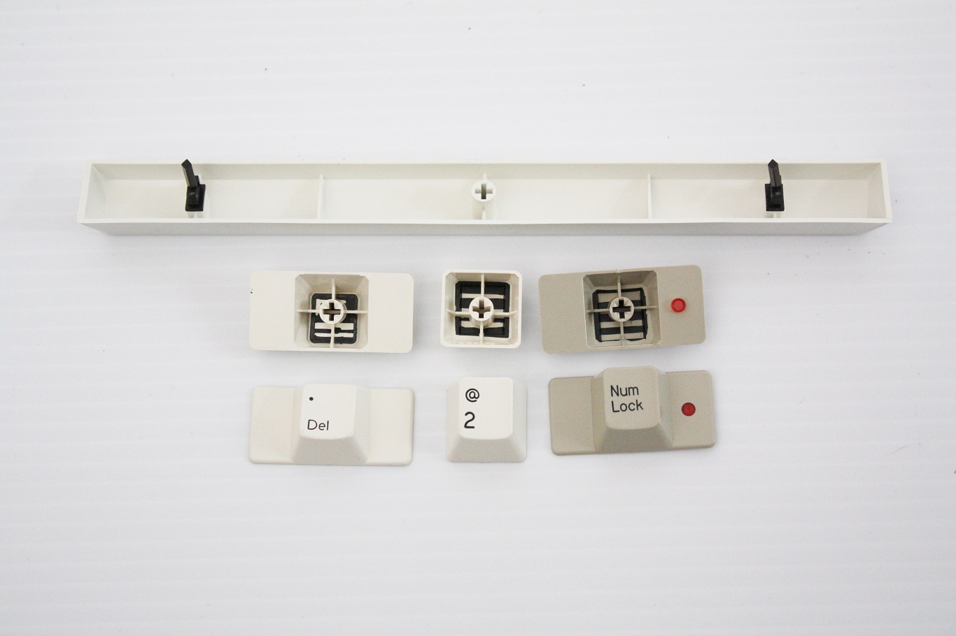

Cherry PCjr MX - key caps.JPG (208.8 KiB) Viewed 9239 times

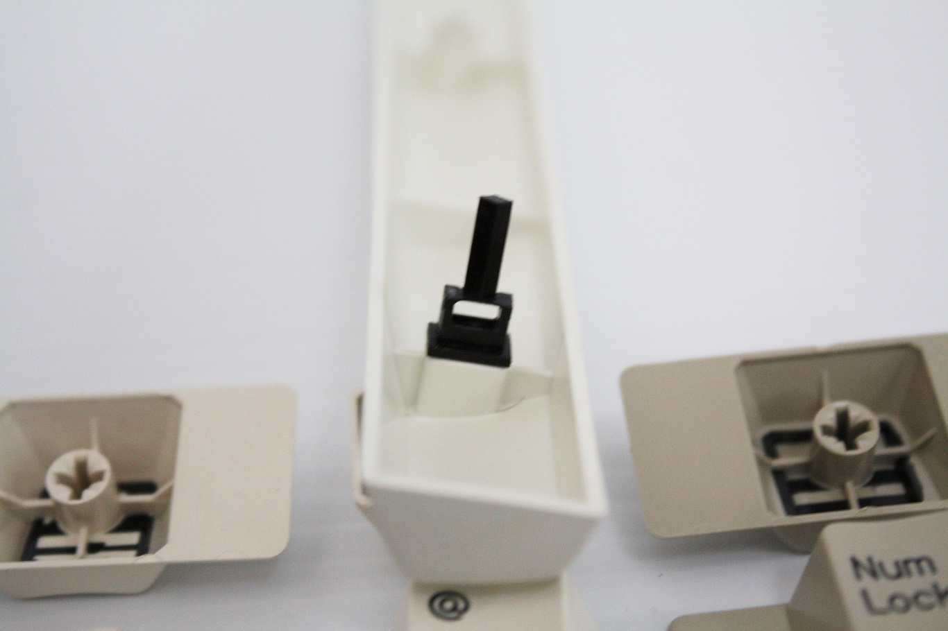

Cherry PCjr MX - space bar stabalizer
Cherry PCjr MX - space bar stabalizer.JPG (227.88 KiB) Viewed 9239 times

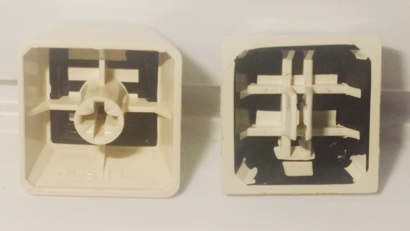

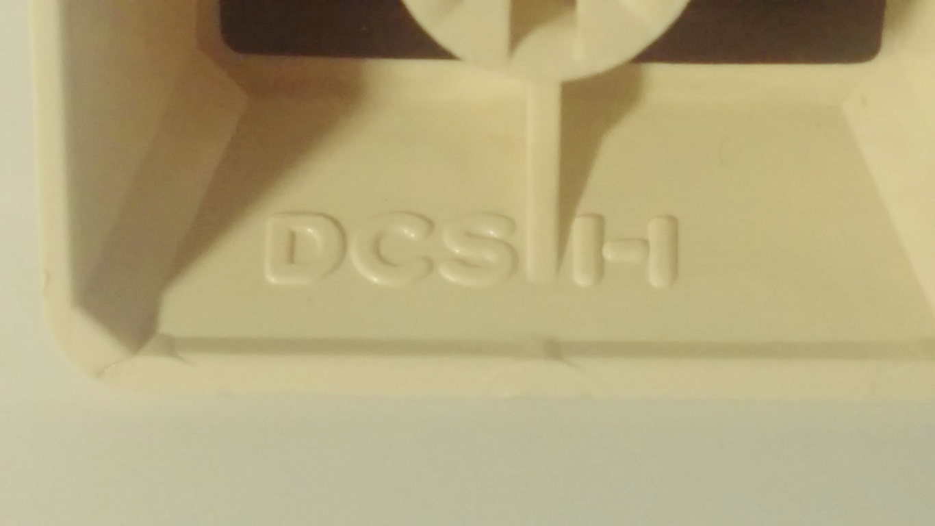

Cherry PCjr MX - DCS 1-1 key cap markings
Cherry PCjr MX - DCS 1-1 key cap markings.jpg (195.35 KiB) Viewed 9239 times
Cherry PCjr MX - comparison (left) to solid-state capacitive key cap (right)
Cherry PCjr MX - comparison (left) to solid-state capacitive key cap (right).jpg (231.96 KiB) Viewed 9239 times

I would assume the Sr means XT protocol, or similar.
Thanks for taking all the great pictures!
Mid-1980s MX switches are so much nicer than mid–2010s MX switches.
My guess is that the spacebar has an extra heavy spring, and the marking is to make sure they soldered it in the right spot? Can you feel a difference?

Neat! that must be some of the earliest MX Blacks around, and the SP caps are interesting.

Great pictures and great cleaning job as always.The Jr Sr switch is great.
The layout is interesting. Its slightly different from the IBM PC/XT layout, but identical to one of the Key Tronic XT layouts, right down to the led windows. Not sure if Key Tronic originated this layout.

Yeah I would have assumed this was Keytronic foam and foil if not for the Cherry marking. The LED windows are a dead giveaway for Keytronic 95% of the time.

jacobolus wrote: My guess is that the spacebar has an extra heavy spring, and the marking is to make sure they soldered it in the right spot? Can you feel a difference?
I can't really feel a difference and I was going to try to take this and a normal switch apart to see if there is any difference but I suck at trying to take MX switches apart that are already mounted.
Blaise170 wrote: Yeah I would have assumed this was Keytronic foam and foil if not for the Cherry marking. The LED windows are a dead giveaway for Keytronic 95% of the time.
Perhaps the key caps were both made by Comptec (pre SP)? I can;'t figure out why there would be LED indicator windows without LEDs. If I paid money for such a keyboard, I would want LEDs there!

snuci wrote: I can't really feel a difference and I was going to try to take this and a normal switch apart to see if there is any difference but I suck at trying to take MX switches apart that are already mounted.
Pretty sure you need to desolder it.

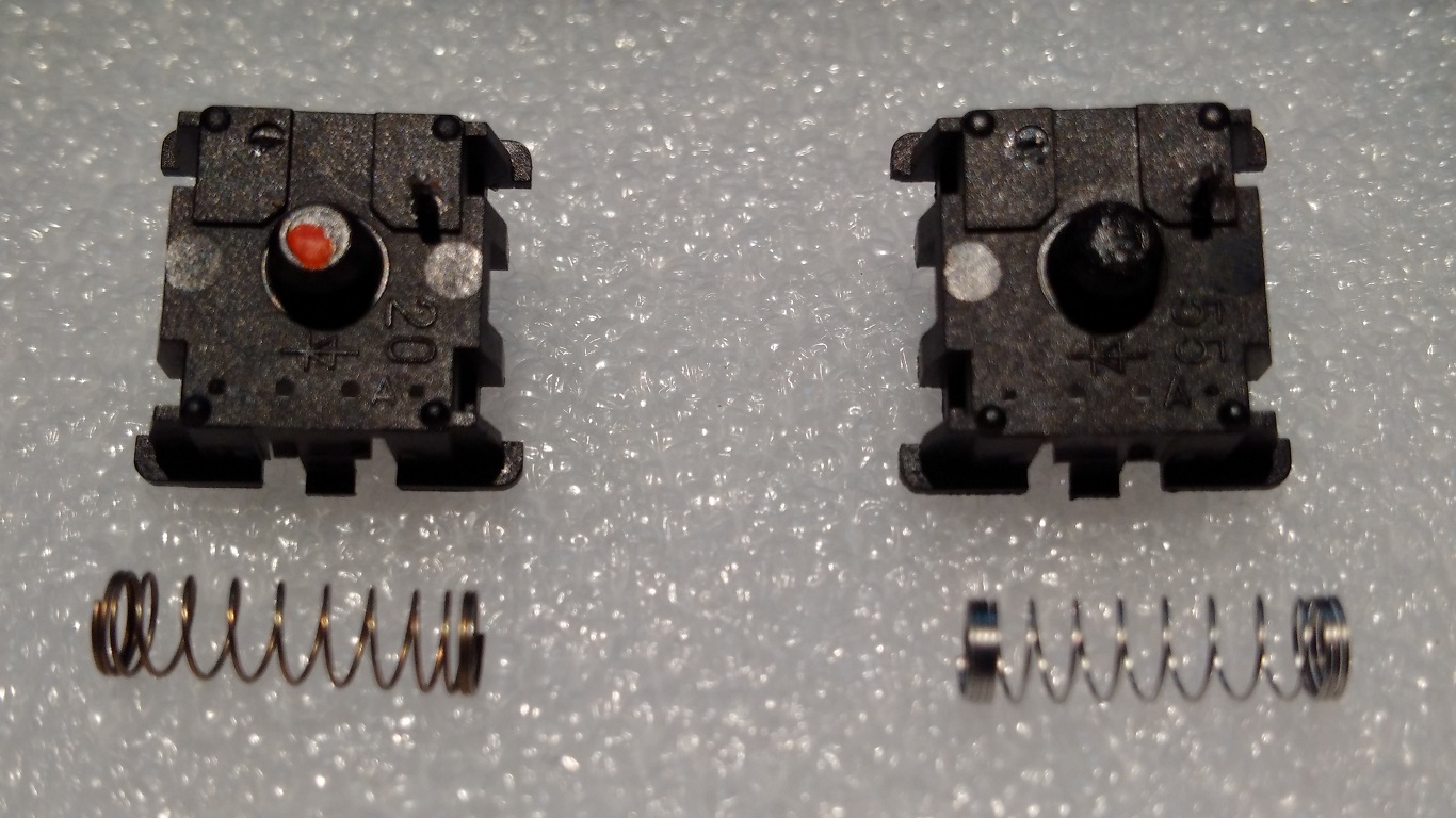

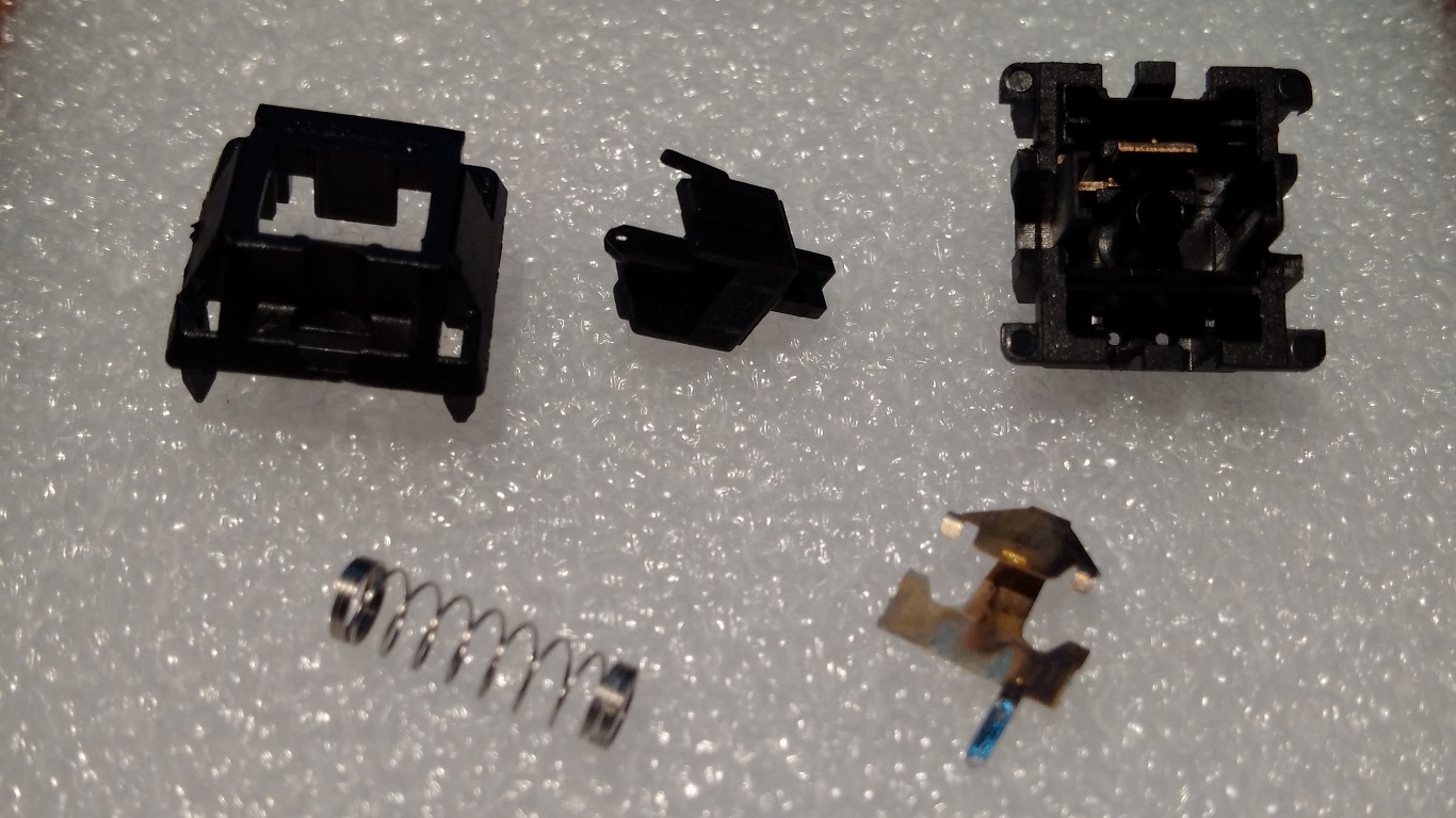

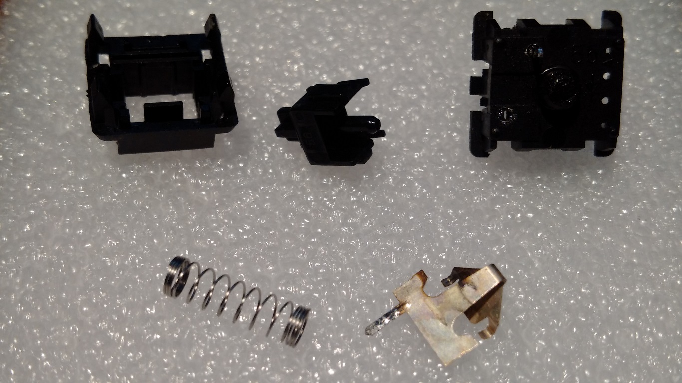

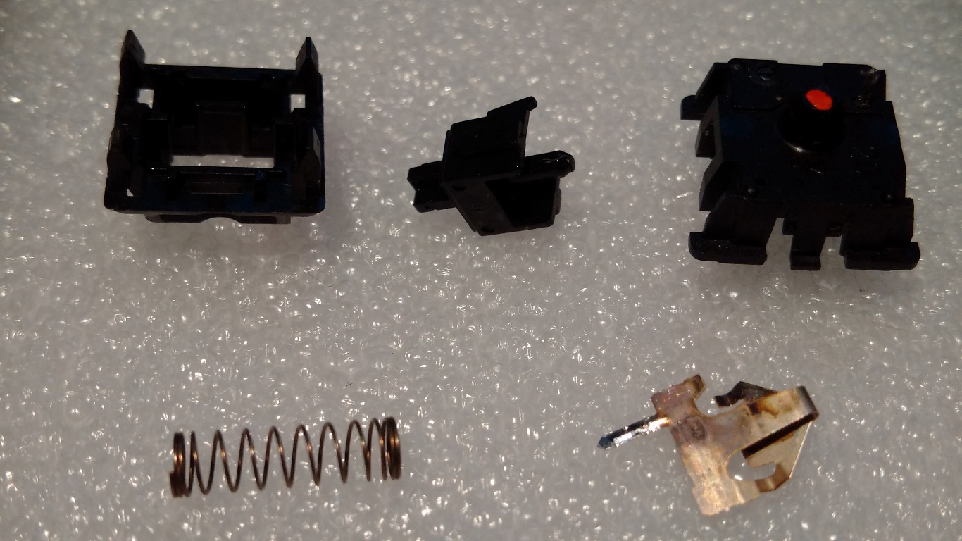

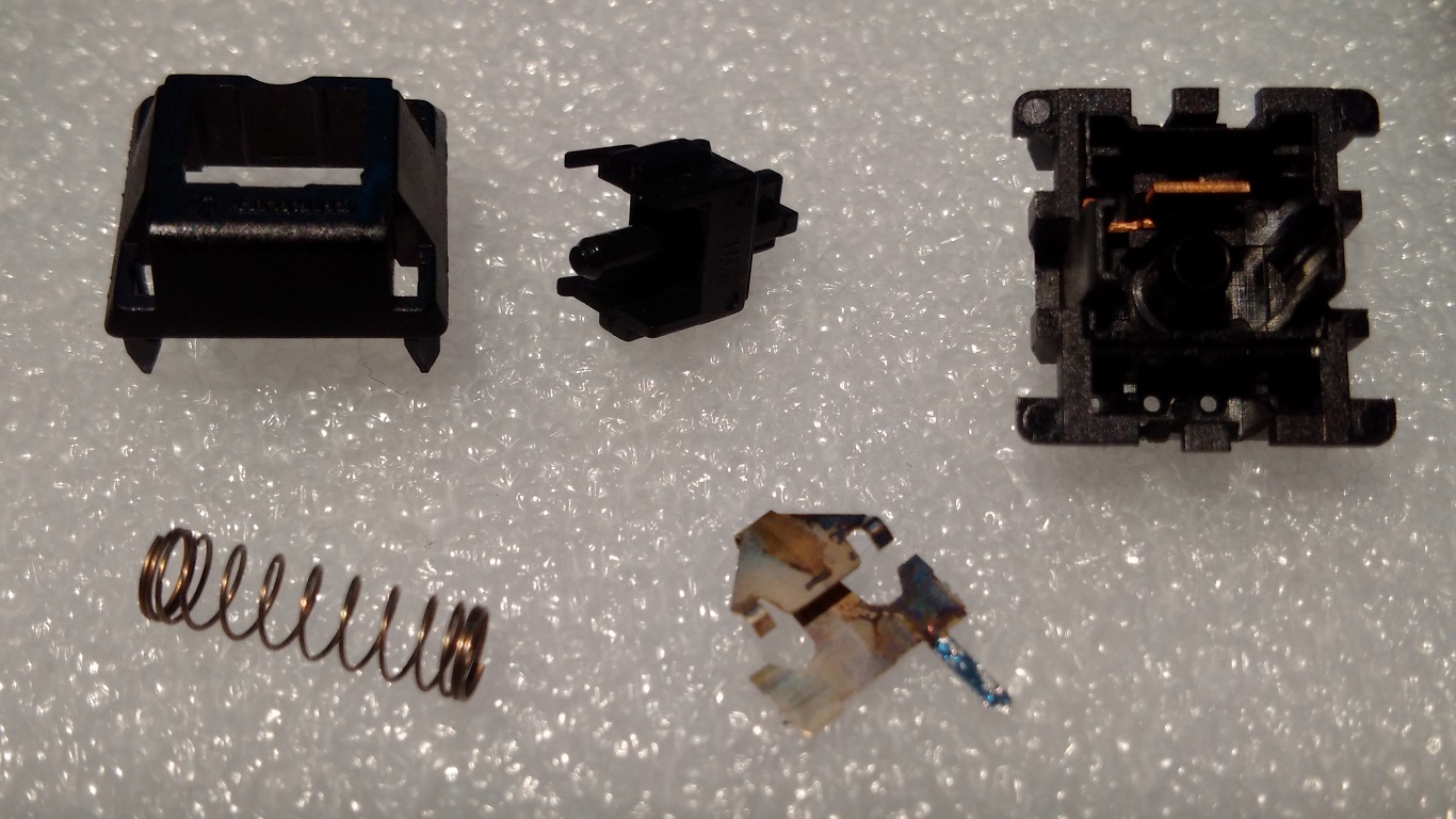

Here are some pics with the two different types of Cherry MX Black switches taken apart.
The first type is the space bar key switch marked with a red dot from the factory. The second type is the "normal" one used on all of the other keys. Oddly enough, the space bar doesn't seem significantly different in weight when installed but the spring is definitely heavier when squeezing by hand when dismantled. The lengths are slightly different and I believe the gauge of the steel is slightly thicker on the space bar switch. The normal key turns are more numerous at the edges as well. I wonder if the "red dot" MX Black turned into the MX Grey?
I apologize for the dark pics but I just can't get the switch top plate and internals to display because of the black colour. They are identical internally and I could not remove the last plate inside the switch so I left it alone before I broke something.
Here's some pics:
Cherry MX Black Normal 1
Cherry MX Black Normal 1.jpg (341.55 KiB) Viewed 8701 times
Cherry MX Black Normal 2
Cherry MX Black Normal 2.jpg (328.82 KiB) Viewed 8701 times
Cherry MX Black Spacebar 1
Cherry MX Black Spacebar 1.jpg (326.26 KiB) Viewed 8701 times
Cherry MX Black Spacebar 2
Cherry MX Black Spacebar 2.jpg (339.26 KiB) Viewed 8701 times
Cherry MX Normal close-up
Cherry MX Normal close-up.jpg (318.9 KiB) Viewed 8701 times
Cherry MX Spacebar close-up
Cherry MX Spacebar close-up.jpg (301.89 KiB) Viewed 8701 times
Cherry MX spacebar (left) normal (right)
Cherry MX spacebar (left) normal (right).jpg (349.14 KiB) Viewed 8701 times
Cherry MX spring spacebar (left) normal (right)
Cherry MX spring spacebar (left) normal (right).jpg (317.75 KiB) Viewed 8701 times

Nice matrix
