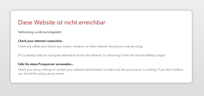

It's working for me seebart, otherwise just google UB88, pcwaishe should be the first link
20 Apr 2016, 15:07
Dra wrote: It's working for me seebart, otherwise just google UB88, pcwaishe should be the first link
In German just for you. :mrgreen:
