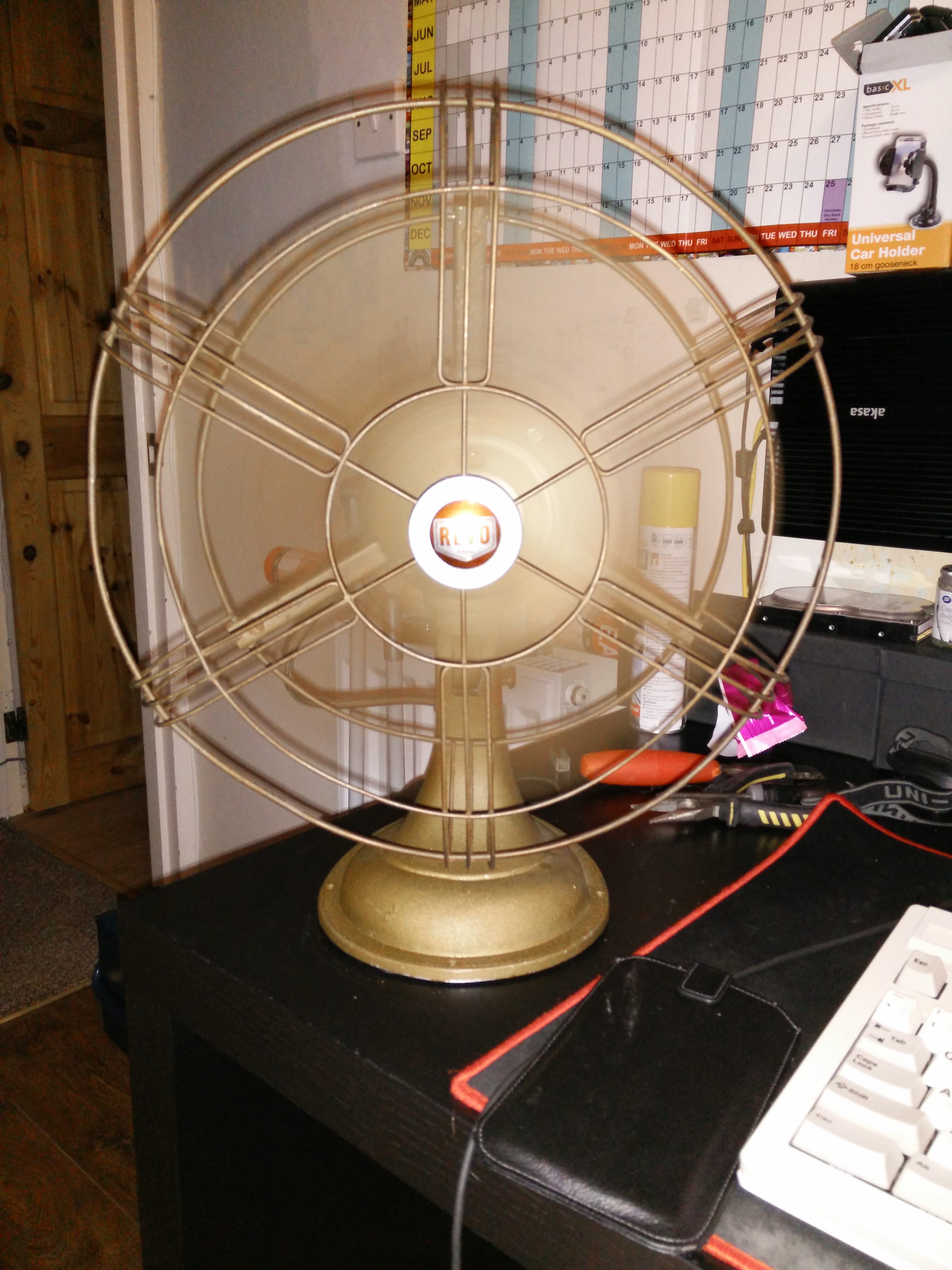

Well a few months ( or was it a year i don't know now) i showed off my loverly vintage desk fan.
Well this one was nice and easy , after a clean and oil she was good to go, still missing some washers to hold the rotor in place but she works fine. She was however a very dirty girl.
Screen Shot 2016-06-17 at 09.28.58.png (612.63 KiB) Viewed 2121 times
But , i decided i needed a smaller fan to sit on my desk as this one is too big , it works well for the bedroom , and thats where she lives now.
Introducing the "NEW" vintage fan!
I will post some more detailed photos and a description of what was done to get her running well. She looked ok in the ebay listing but looks can be dissipative! Much to my surprise you can no longer buy new bearings for a 68 year old desk fan , so i had to get creative with the superglue!
