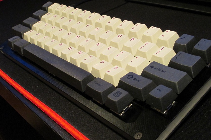

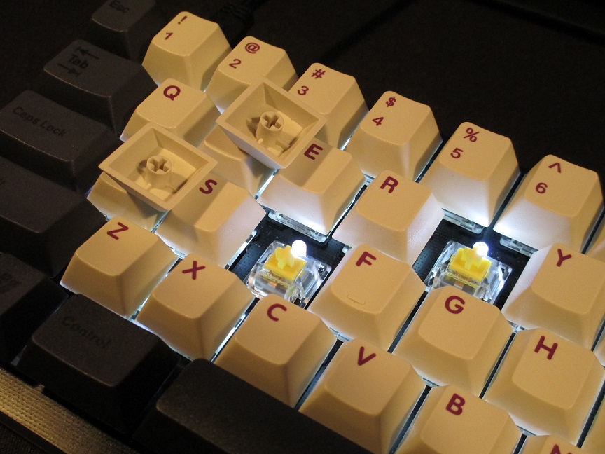

Shown below are two pics of the keyboard:
Close-up of the Gateron dye-sub PBT keycaps, Gateron Yellow Clear-Top switches with White LEDs.
Note that the white Gateron PBT caps are sufficiently thick and/or dense that they do not allow the LED light to shine through. Similarly, light does not penetrate the Originative black PBT keycaps. Incidentally, I tried some white Ducky PBT caps, and these did allow some light transmission.
View of keyboard showing the HHKB layout.
Apart from the Backtick/Tilde, Tab, Enter/Return, Left Shift, Right Shift, and Fn keys, the legends on the Originative caps do not match the HHKB layout. However, this is not noticeable in dim light. For those who prefer the correct legends, these are provided on the white lasered PBT caps that come with the keyboard.

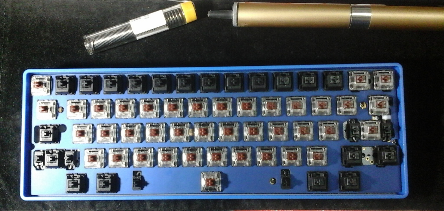

Thanks a lot for the sweet review. This really looks like a nice offering to me. Does the plate allow opening of the switches for a little modding?
Khers
21 Jul 2016, 09:12
Looking at the second pic in the ebay listing, I'd guess no. Besides, LEDs seem soldered in (at least there is no mention of SIP-sockets) so it would be a little pointless. However, if you want to mod your switches, just order it without assembly.

@Wodan: I have not tried opening the switches, but I think that the LEDs are soldered in, so that it would require desoldering before being able to open the switches. However, you could order the unassembled kit or presumably order it without LEDs.

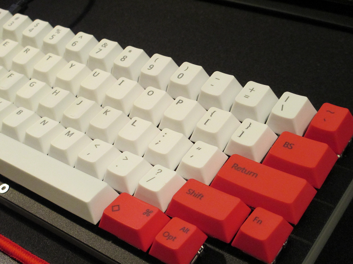

Update: Here is a pic of a selection of the lasered PBT keycaps that were included with the SA60HH keyboard:
They are OEM profile and have a similar thickness (~ 1.5 mm) and texture as Gateron PBT caps. They are not as rough as Keycool PBT caps that I have tried or as smooth as Ducky PBT caps. The lasered legends result in a palpable roughness in the area of the legend on some, but not all, of the caps. Unlike the Gateron caps, the stock caps transmit some light, making the legends visible with the white LEDs.
Note that the legends mimic those of the HHKB Pro 2, including the front legends. There are also some extra front legends, such as those describing the LED controls on the Z-row. Of course, don't expect the excellent fit and finish of the dye-sublimated PBT caps that come with an actual HHKB Pro 2, but the stock caps on the SA60HH get the job done for those who want the top and front infomation of the HHKB layout printed on the caps.

Those keycaps - they seem to be these ones: http://www.aliexpress.com/item/New-Arri ... 43821.html
I ordered a black set today, since I have a blue plate matching exactly that hhkb profile (7u spacebar etc.)
Thanks for the picture, I didn't know how thick they are :)
